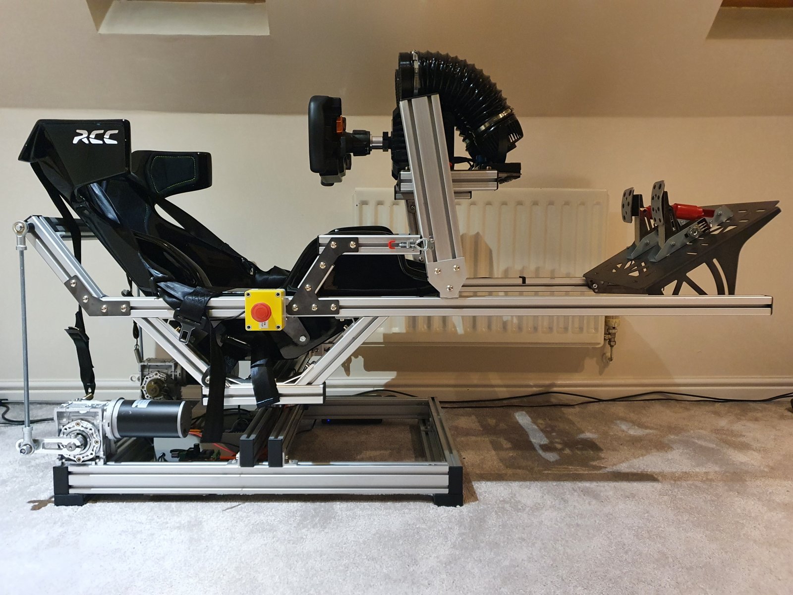

    Updated the rig to an Ali frame - huge improvement in rigidity. Also repositioned the motors for more mechanical advantage and the overall movement is much improved. Also swapped out the ibt2's for a sabertooth 2x32.

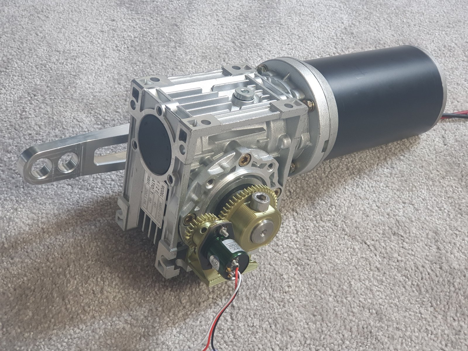

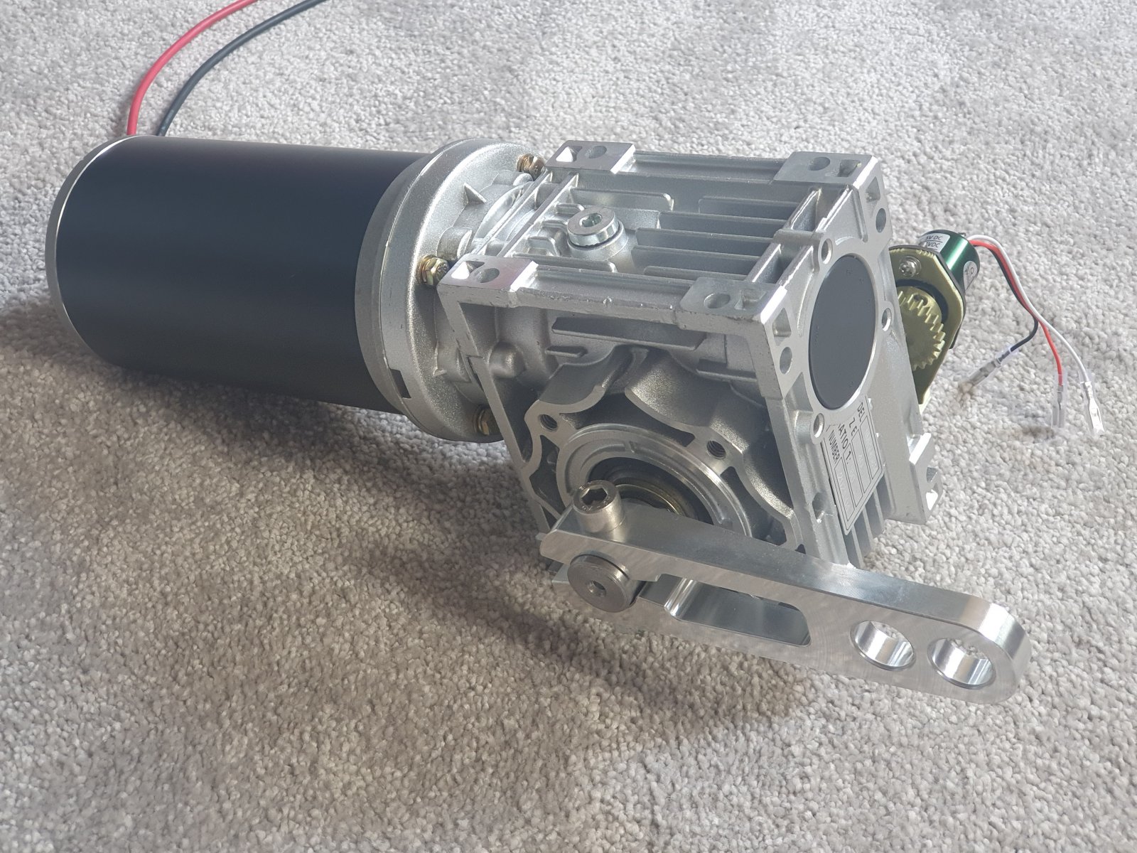

    very nice project.. can I ask you where did you find the motors? I can't find them anywhere

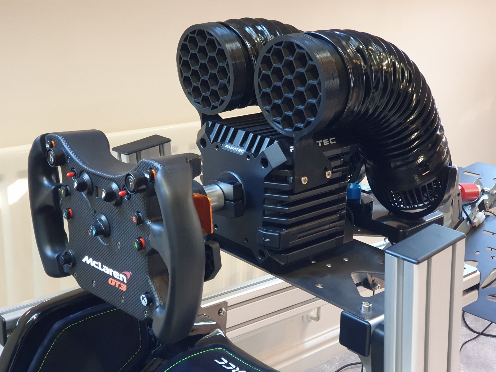

    Slight design change with mods to wind sim due to DD upgrade (after running a G27 for about 6 years).

    Can you kindly share the dimensions of your 2 dof sim? I really want to know.

    Is your ventilation system really good? I hesitate to make one

    Pedal upgrade is on the cards. I have the truebrake mod fitted to these G27 pedals which I really like, so in no hurry. Wind sim is hands down one of the best immersion boosters, especially in vr, and it's cheap to do, about £25

    indeed not expensive. Do you have a link or you could give me or some explanations on your installation please. Your photo and your comment makes me want to try

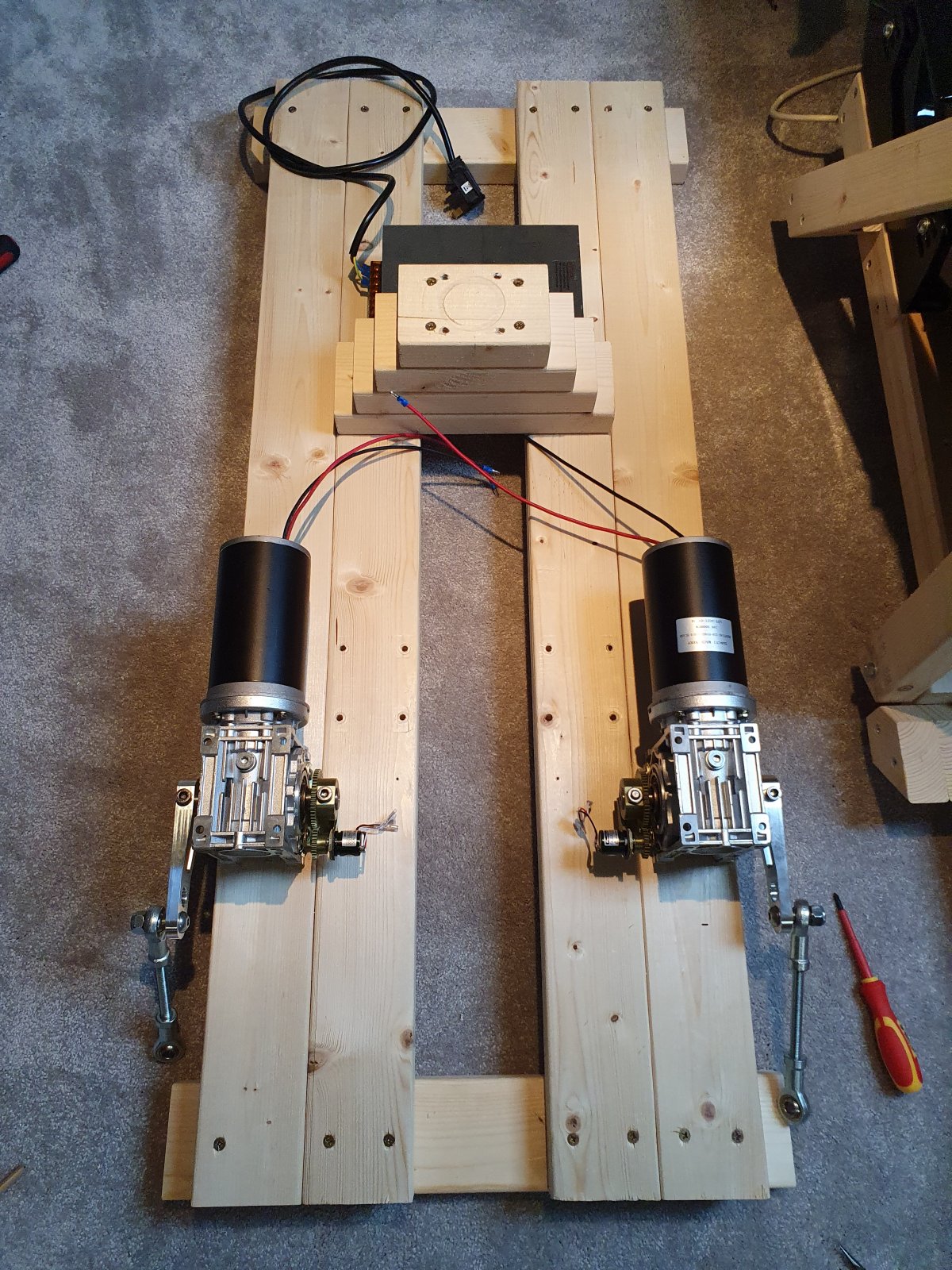

    Can you explain how you screw the ujoint with the base?
    I have issues, it loose and rotate the whole rig.
    Can you share please your simtools settings and for the plugin? THX

    When it was a wooden rig I used long m10 coach screws, but I still had some play like you are showing

    Thank you for your information. I consider to make the base in Aluminium or steal.

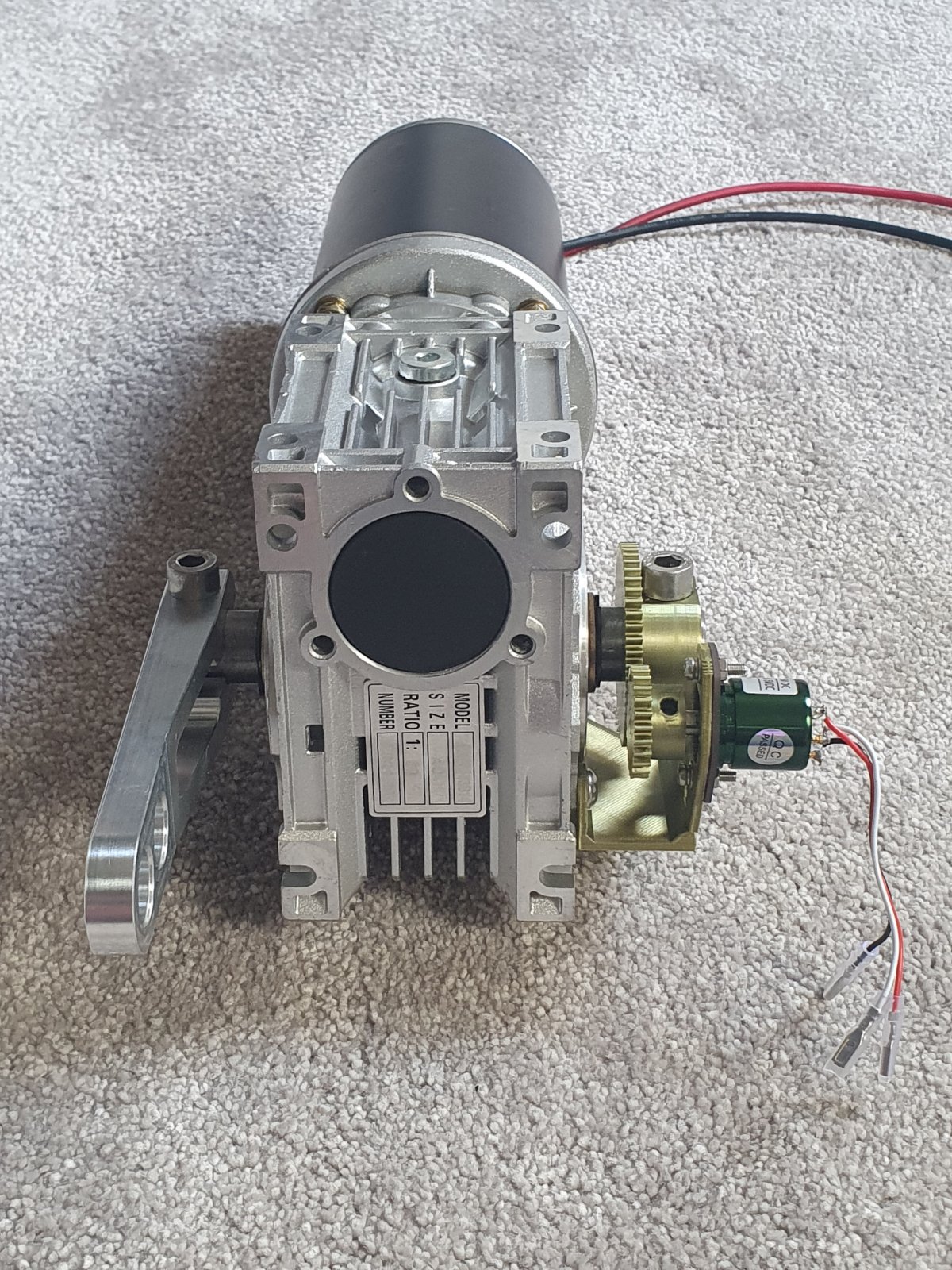

    Can you please say all the components you did use. If not say which motor you used

    What is the purpose of that small motor attached with the big gear motor?
    I find out such a motor in our region
