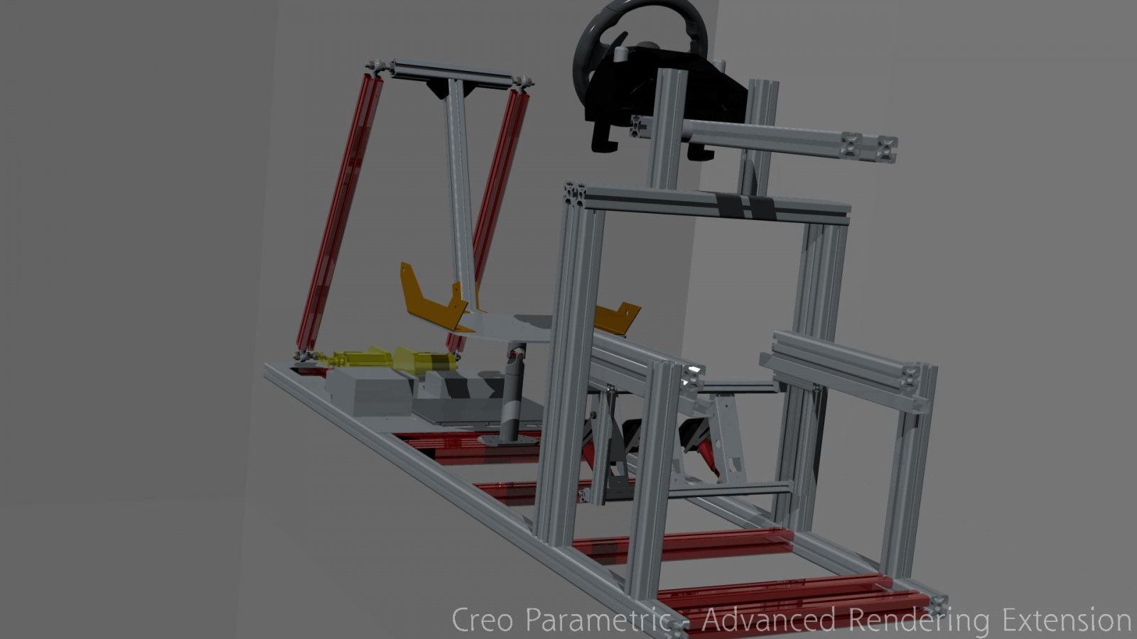

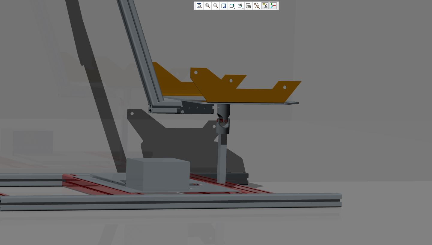

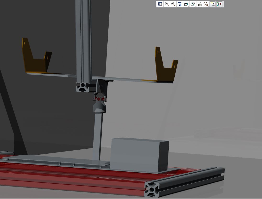

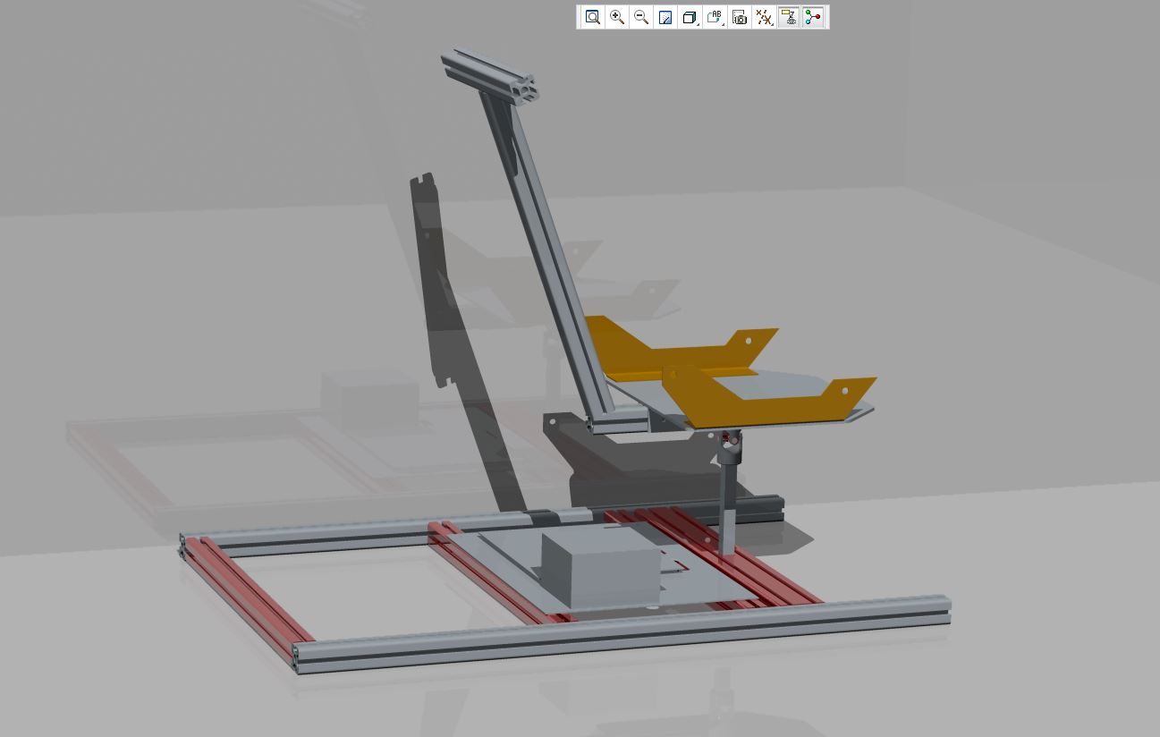

  1. Nick Moxley
    17,056Coins
    +2,506 / 30 / -2

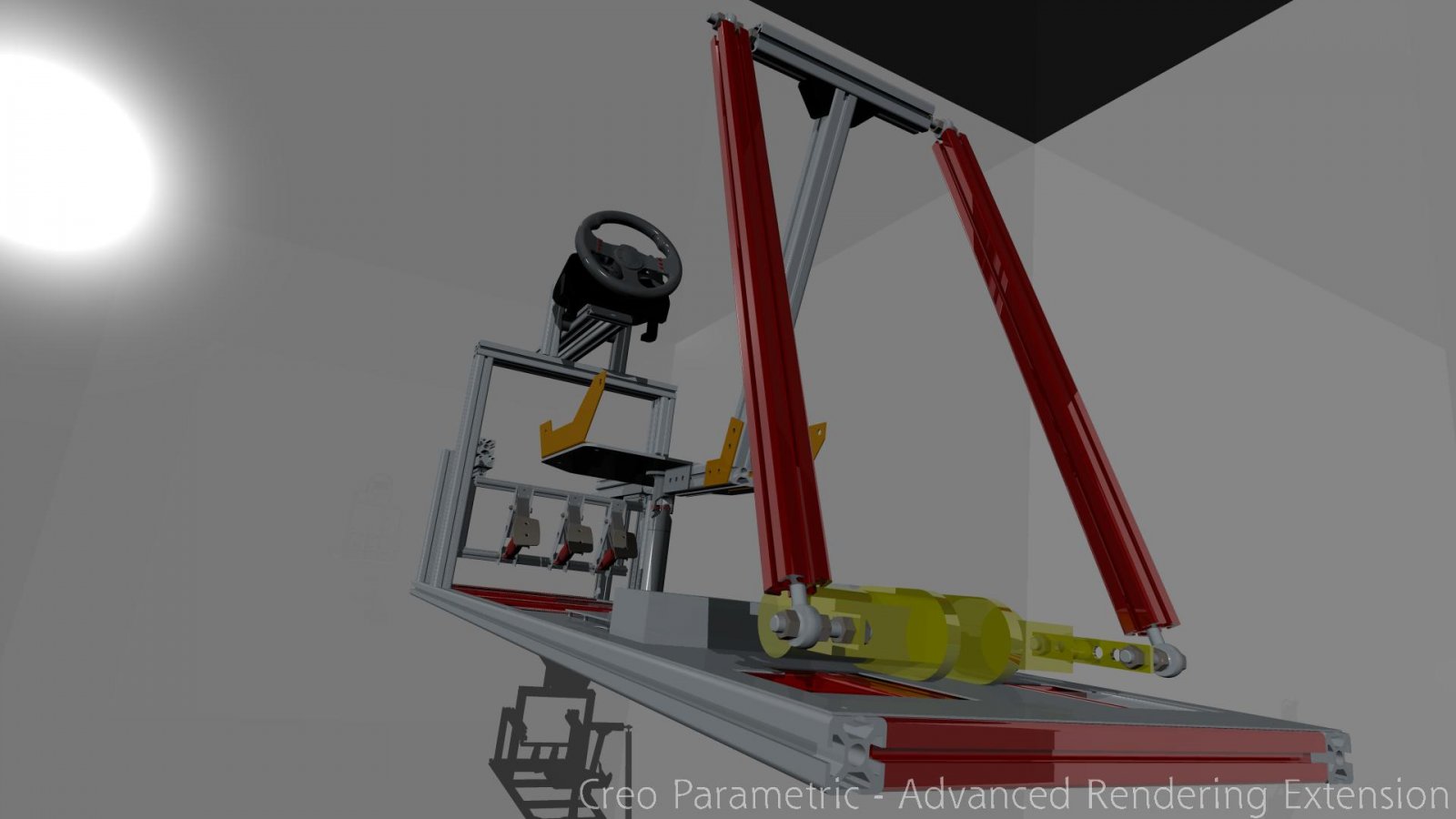

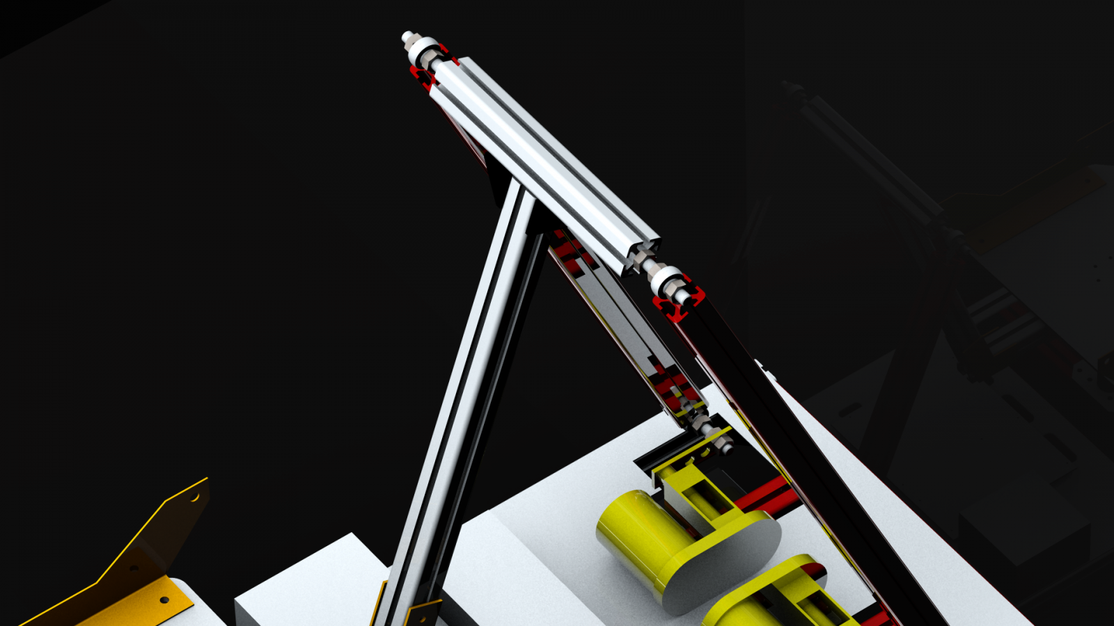

    No body else mentioned it which im kinda surprised about but that seat frame is very much under supported. Unless your using a Super Thick Base plate you will have some big time flex. Highly suggest you go back to the drawing board and make an actual frame of 80-20 rather than the Single Spine you have in the render.
  2. bsft
    A bit of 18mm thick plywood should fix it
  3. Nick Moxley
    17,056Coins
    +2,506 / 30 / -2
    3/4" ply would also Flex in that situation.

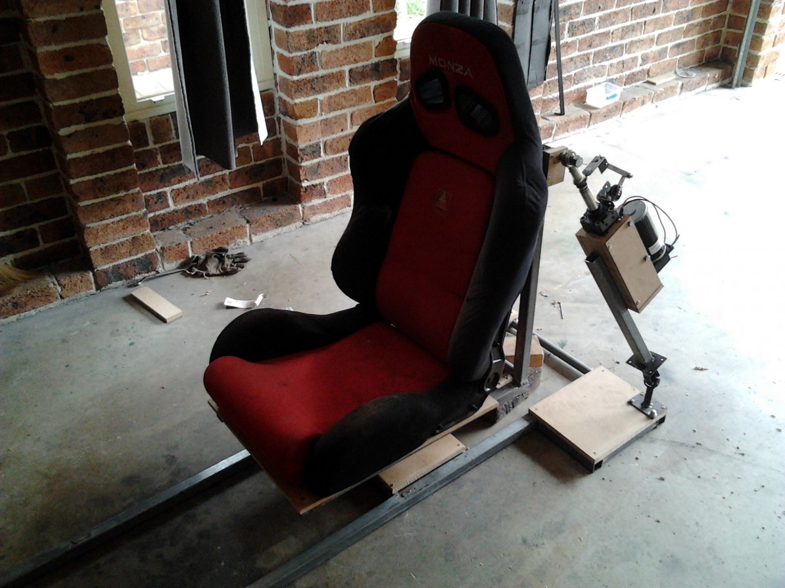

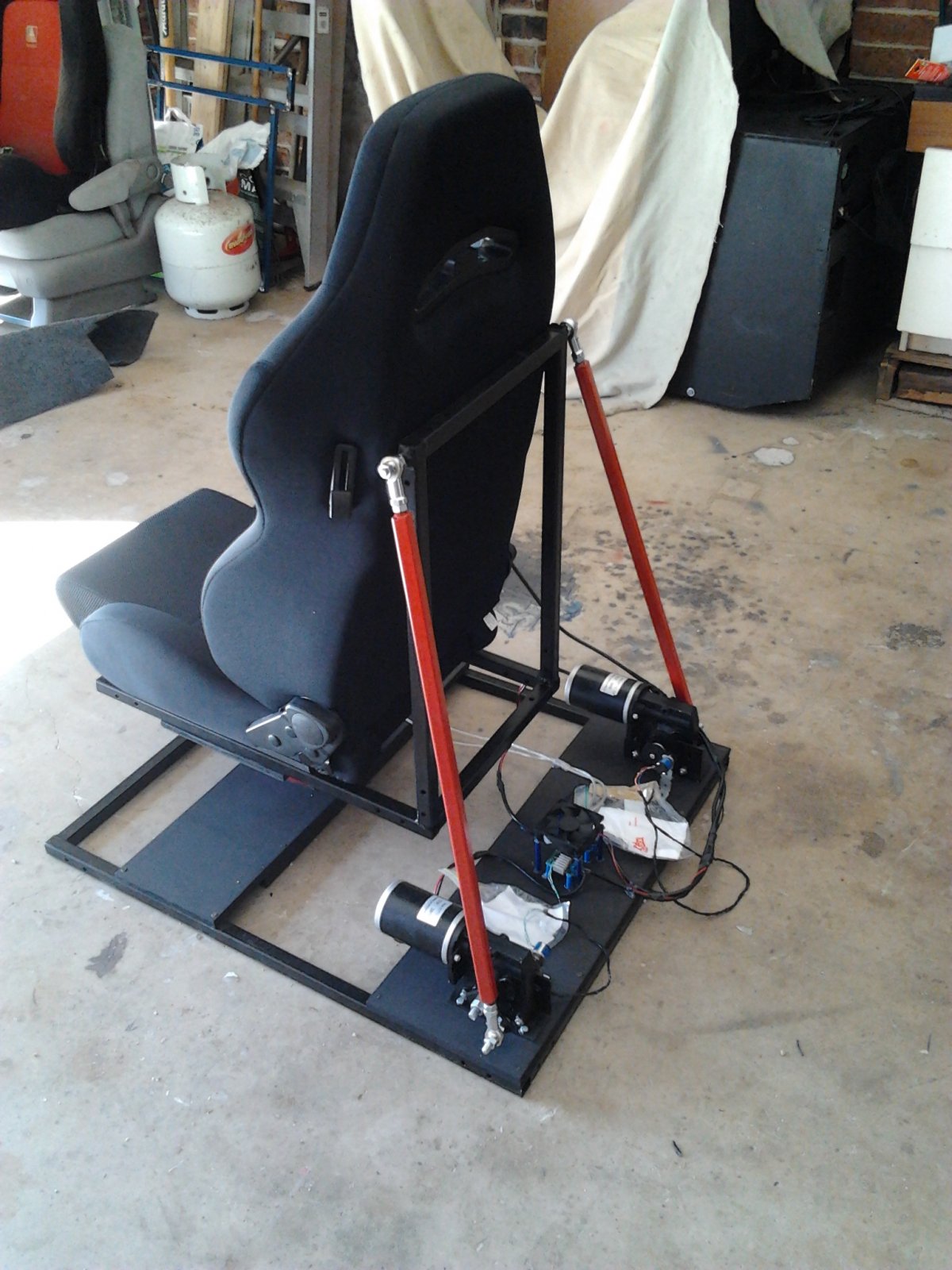

  4. bsft

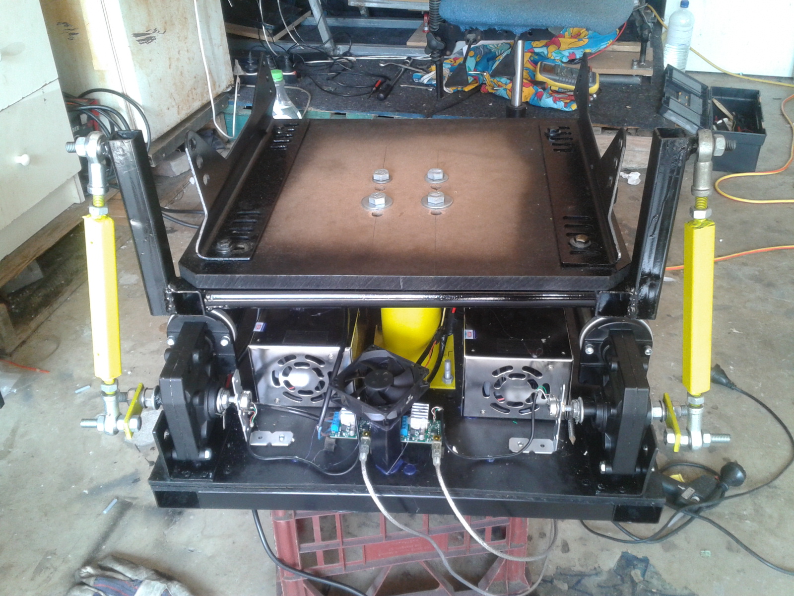

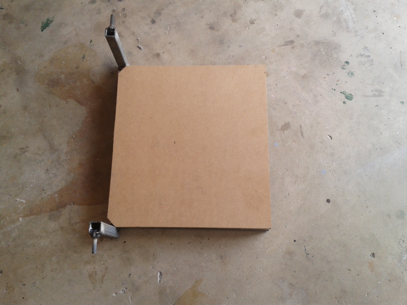

    Ok, maybe Ive just had success in my builds. For all of them I build a 25mm box steel frame under the seat and screw a sheet of 16mm MDF to it , then I bolt the uni joint to it. Its never flexed or given me issues, be it full frame or seat mover.
  5. Nick Moxley
    17,056Coins
    +2,506 / 30 / -2
    Did you look at his render ?
  6. bsft
    Yes I did, hence a suggestion of a steel box frame like I added. Because his rendered frame would flex like a bastard.
    Unless I missed something..........
  7. bsft

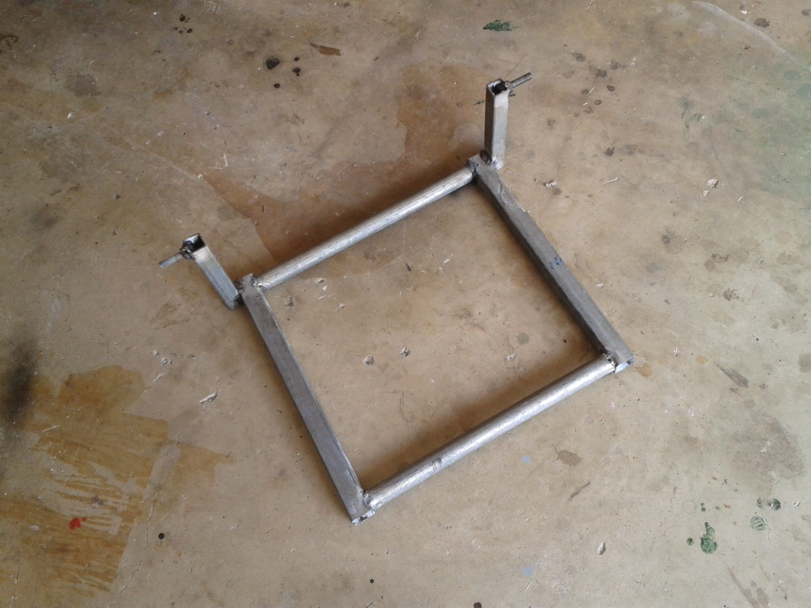

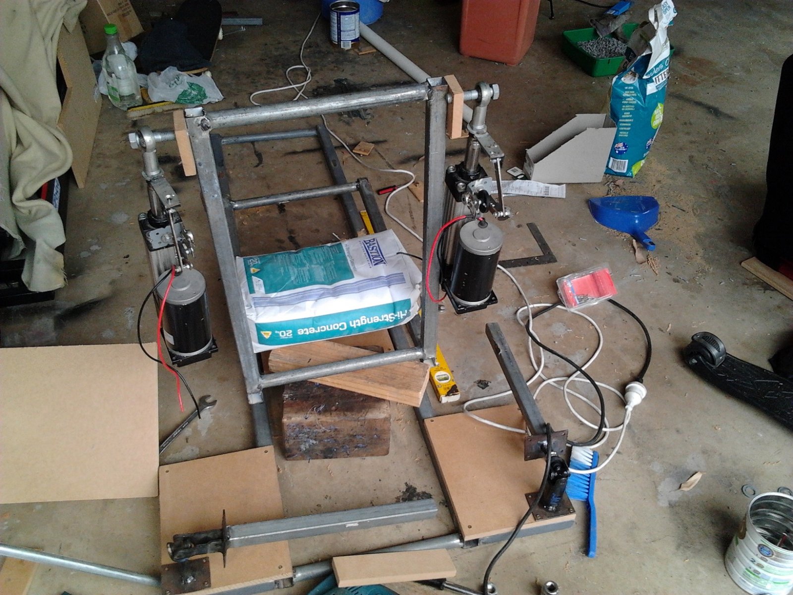

    Its not too clear as there is a bag of cement in the way, but my seat mover frame is 25mm x 25mm steel with 16mm MDF screwed to the top of it, and the uni joint bolts to it. Heres some other pics of frames as well.
    2014-01-21 10.21.02.jpg 2014-01-21 12.26.10.jpg 2013-08-06 12.55.09.jpg IMG_20120707_103932.jpg
    This has never flexed on me at all. Maybe @IJOJOI can implement something like this in the design, because, as you say, his rendered design, if built, will flex like crazy
  8. IJOJOI
    IJOJOI Member
    Oct 20, 2015
    46
    Austria
    523Coins
    +23 / 0 / -0
    SCN5
    I just ran my 3D through Finite Elements, and it seems like it is moving quite a bit...
    I'll all a frame to it and see how it will change it.
    Thank you very much for advice @bsft, totally forgot about that!

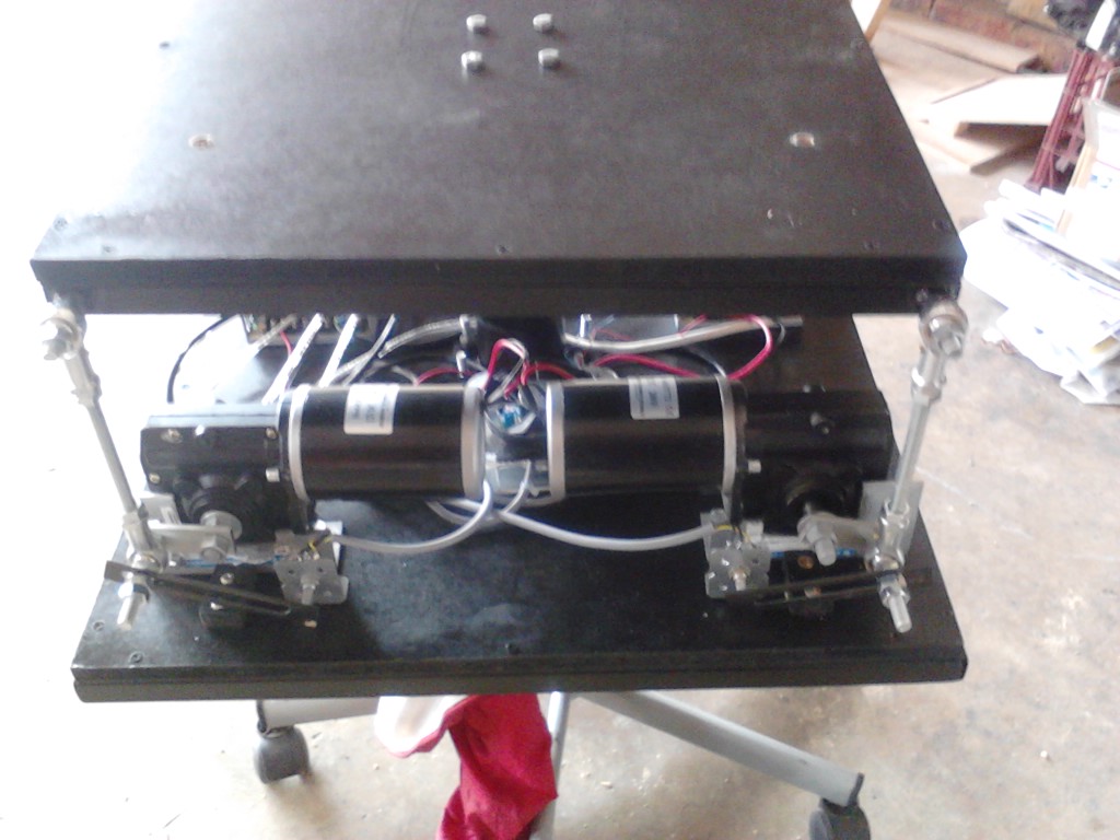

    I eliminated the seat frame all together by using a premolded poly seat from summit racing. Added padding and a leather cover. Cost back then was around $70. Bolted my universal to a piece of 3/4 plywood that bolted to the botton of the seat. Bolted a cross bar through the upper back of seat for the actuators. 7yrs later, never had a problem. http://www.summitracing.com/parts/sum-g2100

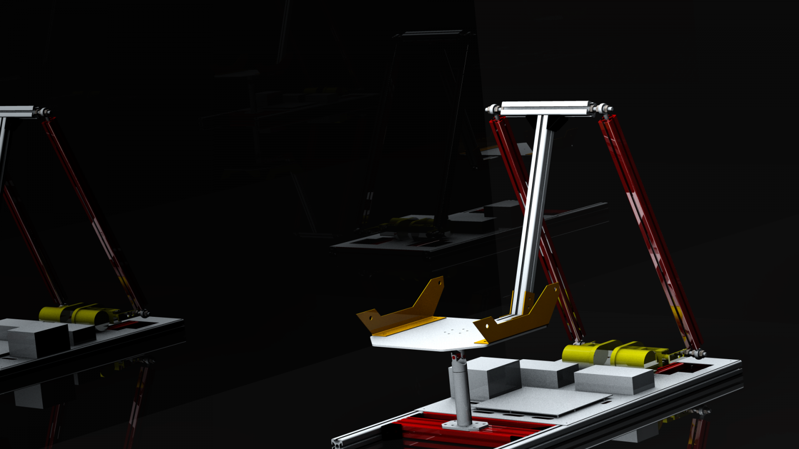

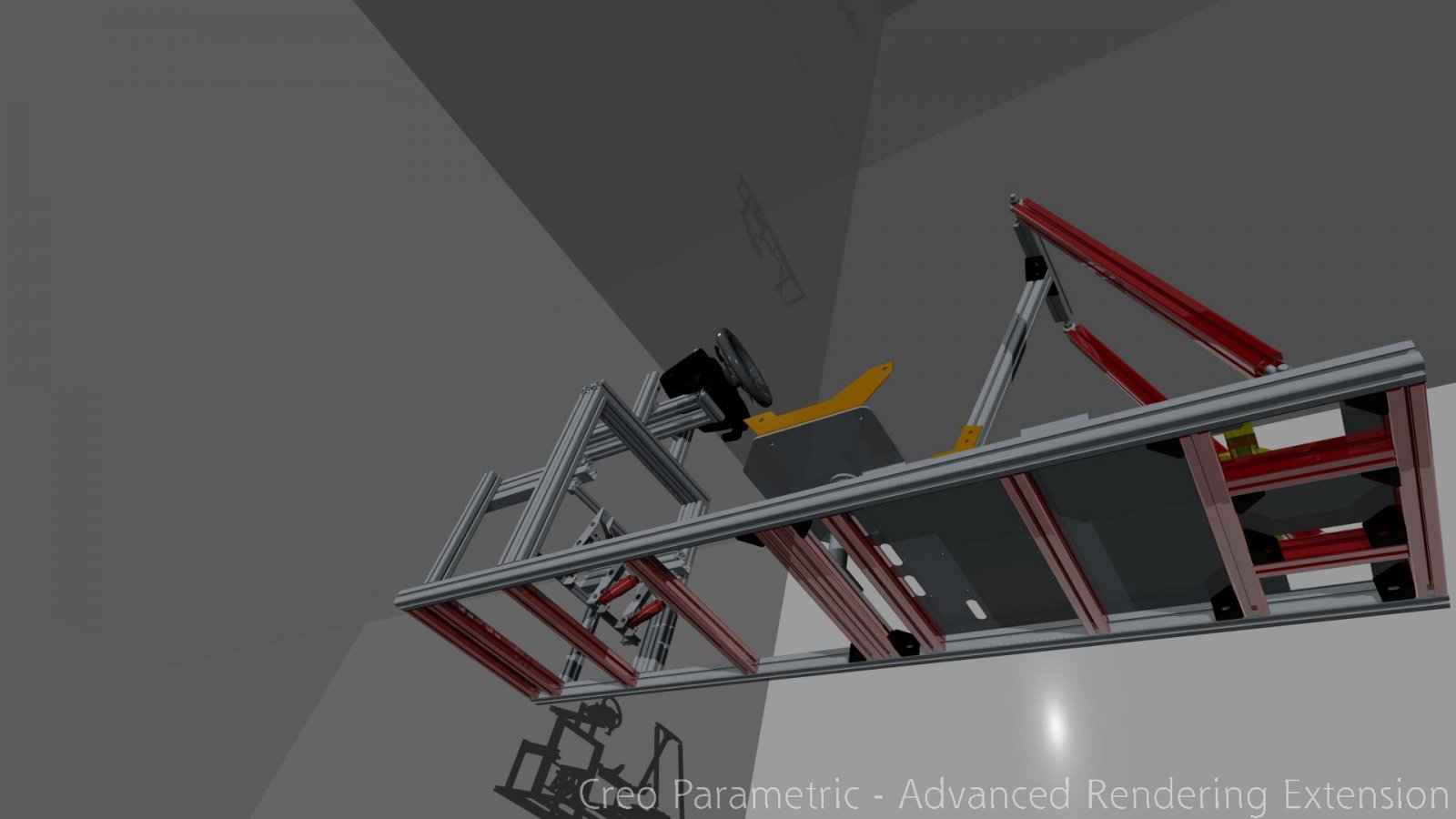

    So here is the promised update guys ;)
    Enjoy
    4k_ganz_0.png 4k_ganz_1.png FAHRSIMULATOR.jpg FAHRSIMULATOR_0.jpg FAHRSIMULATOR_1.jpg
