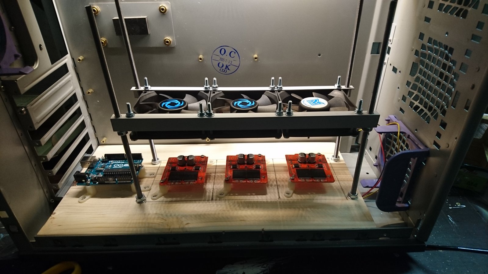

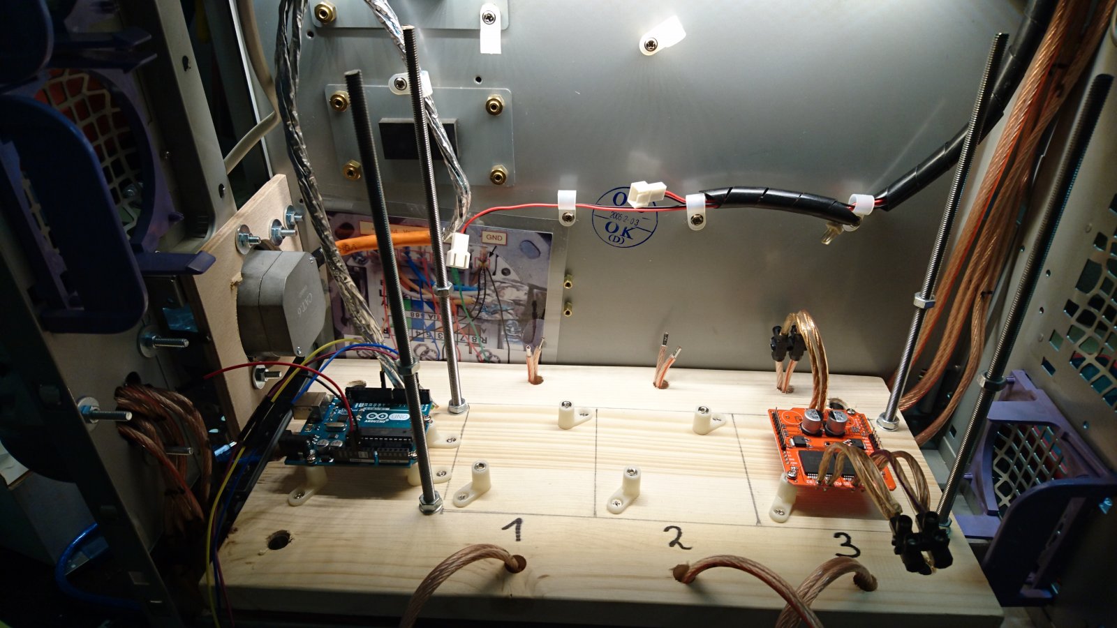

    I will install 3 Monster Moto Shild. Since they are relatively cheap and space is available, I will block one per engine. Since I have read in the forum that you can burden them so much and they should not be so hot.
    I'm currently building a 2 DOF Sim, but maybe in the future an axis will come ...
    And if one should break, I quickly have a replacement ..... :)

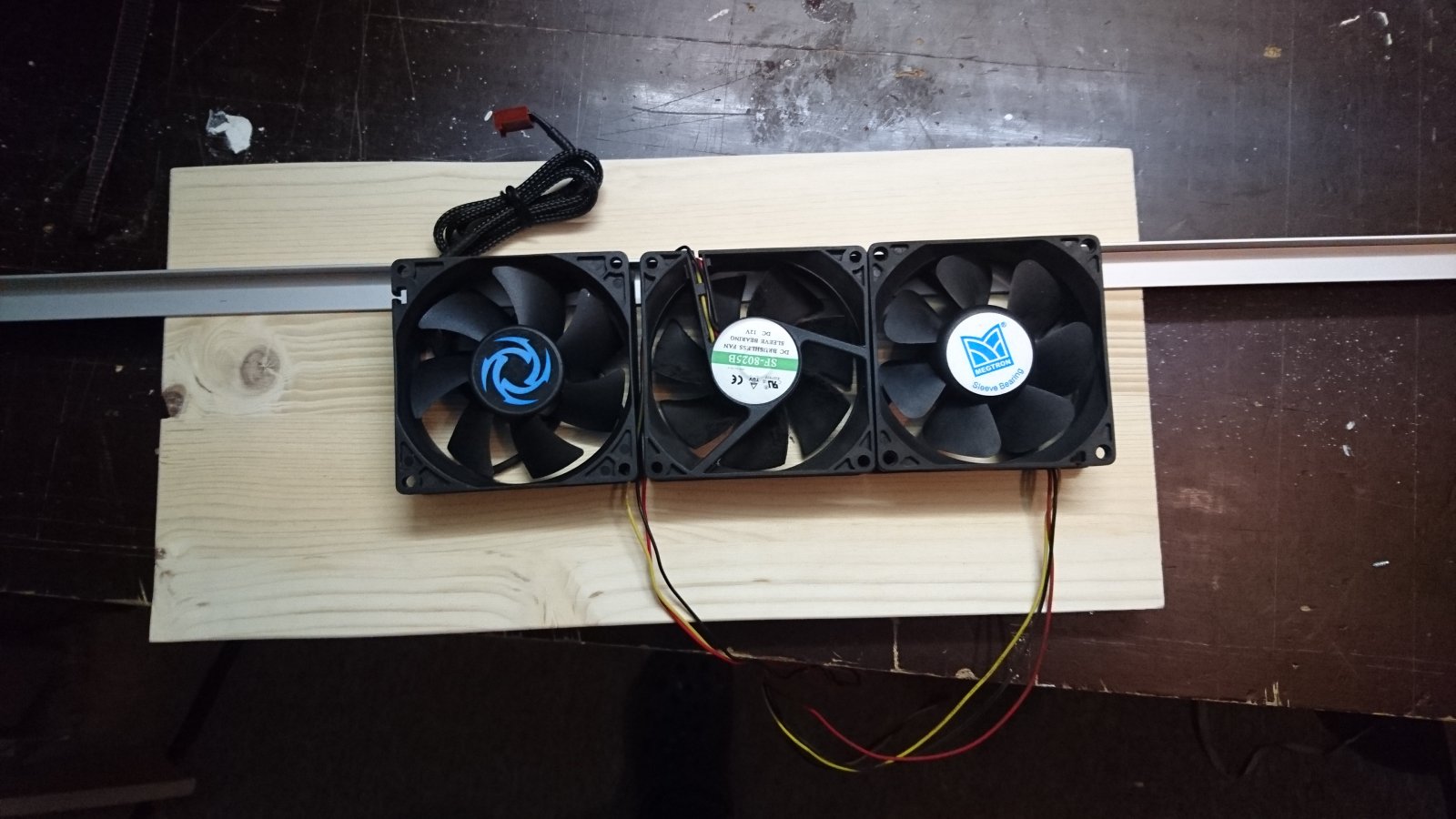

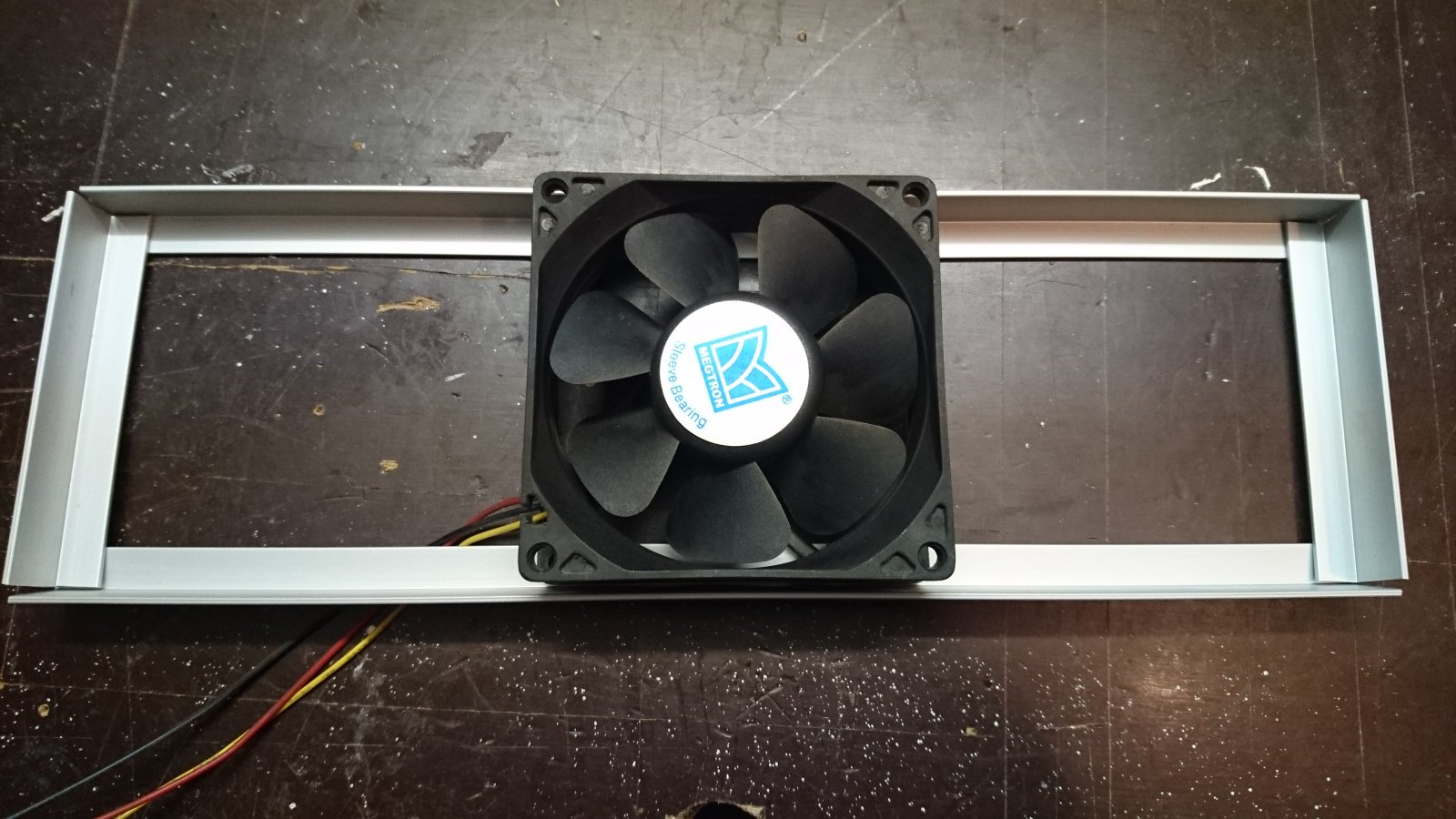

    2DOF, 3DOF, Arduino

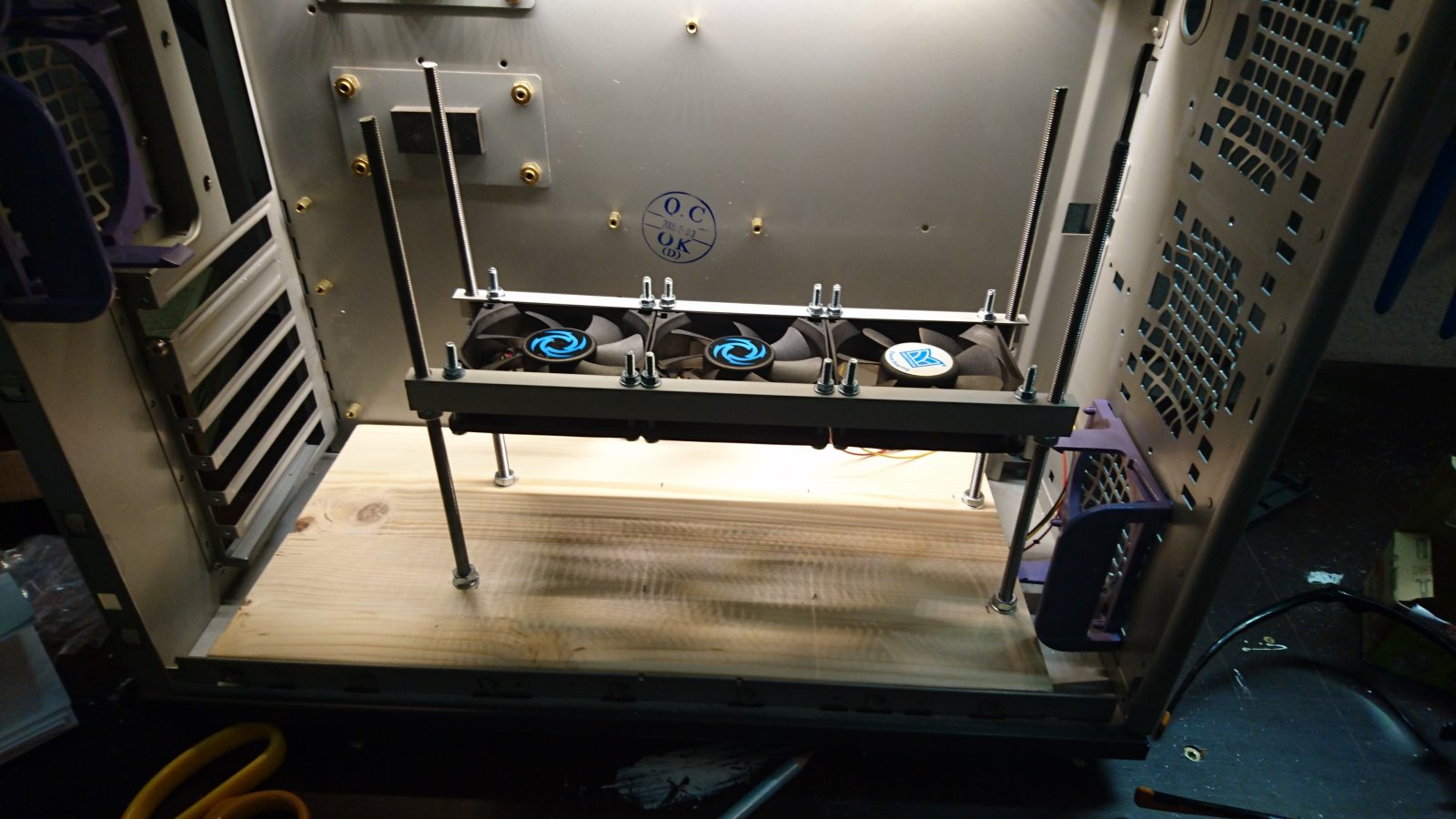

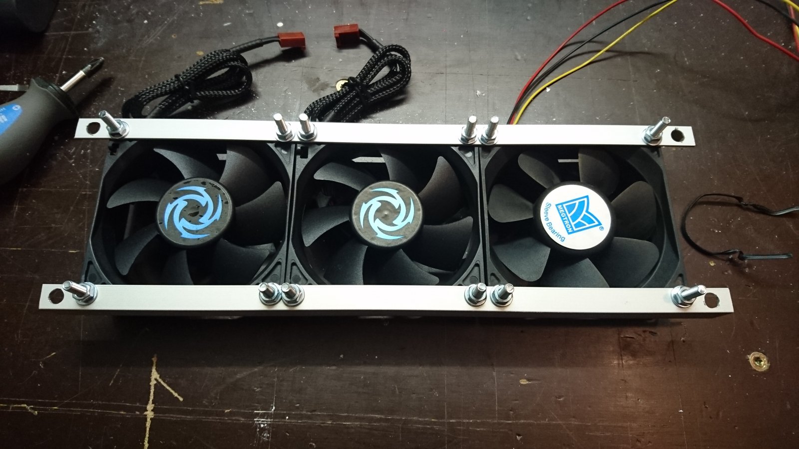

    To be cooled, the Monster Moto with 3 80x80mm fan.(6.- Euro per piece)

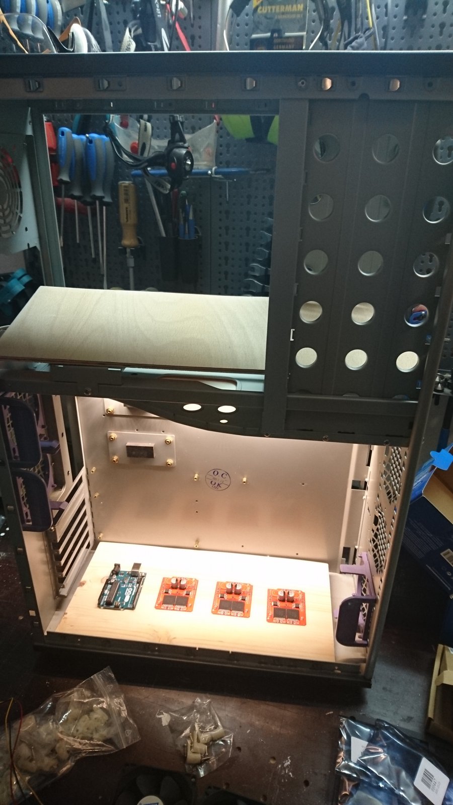

  5. Papapetrus
    Papapetrus Member Gold Contributor
    Feb 20, 2018
    84
    Austria
    61Coins
    +47 / 0 / -0

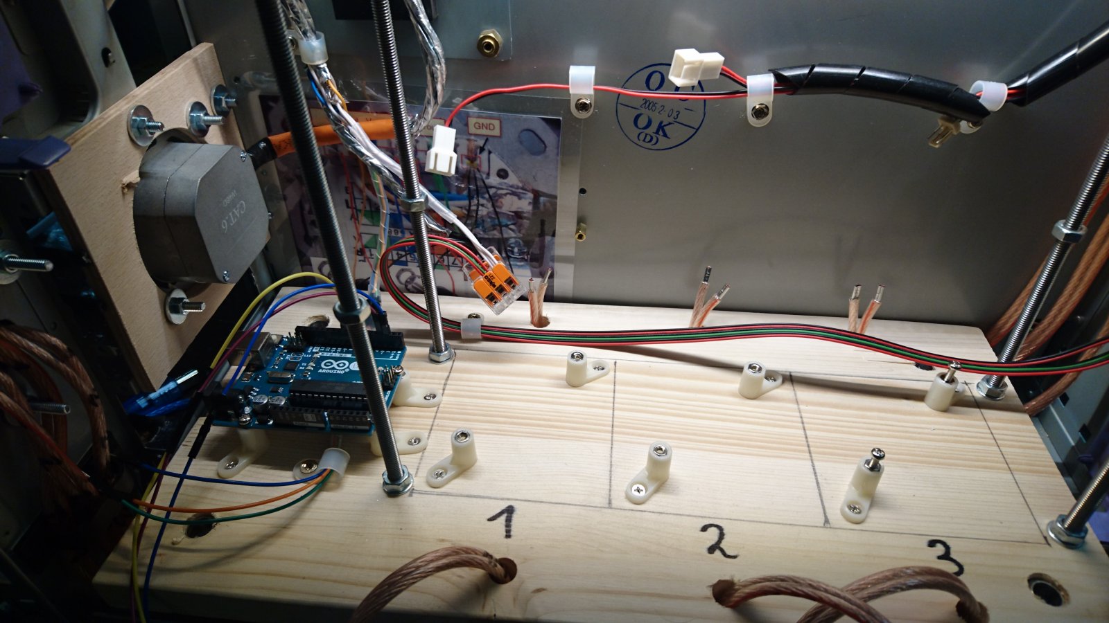

    2DOF, 3DOF, Arduino

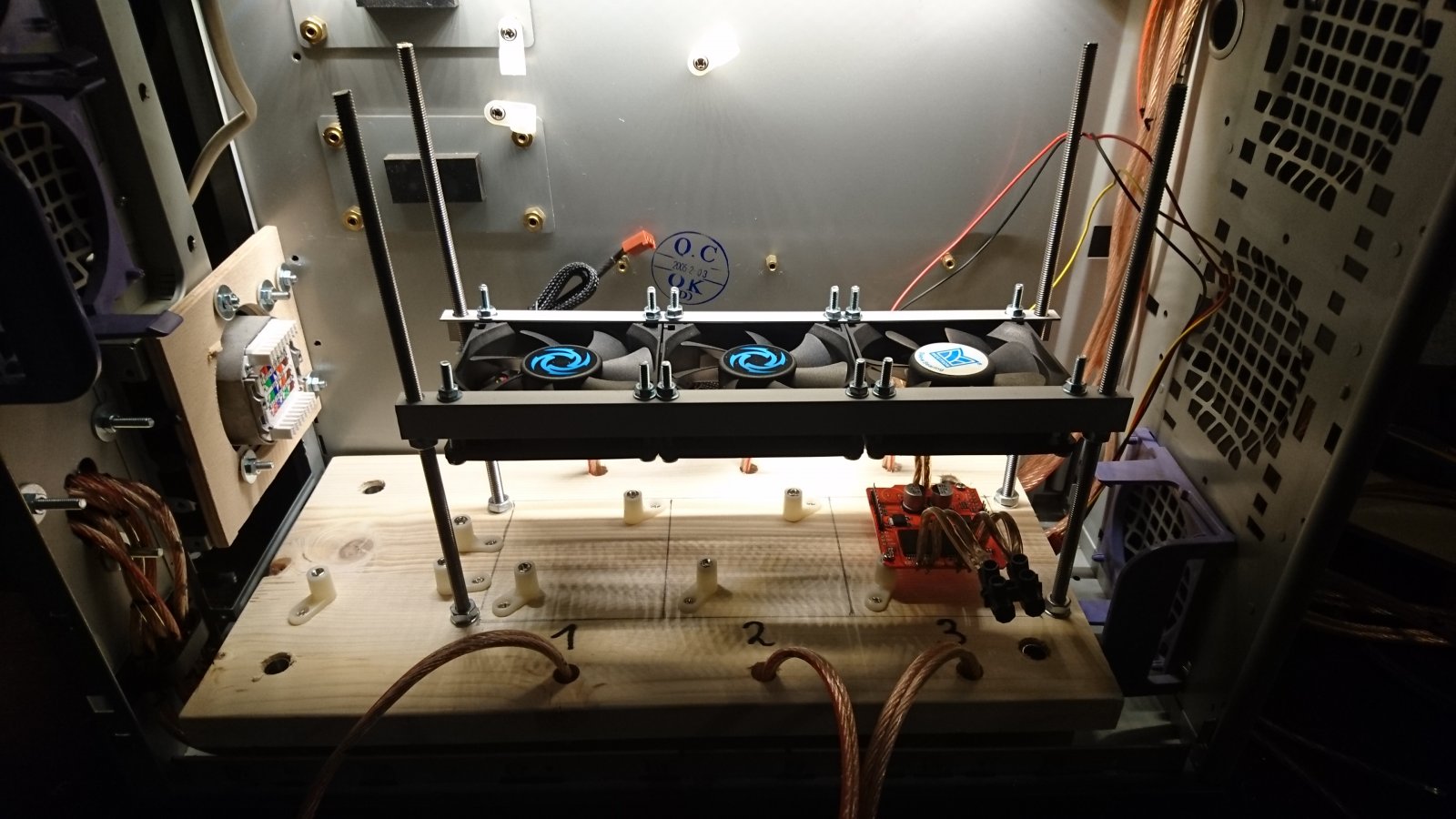

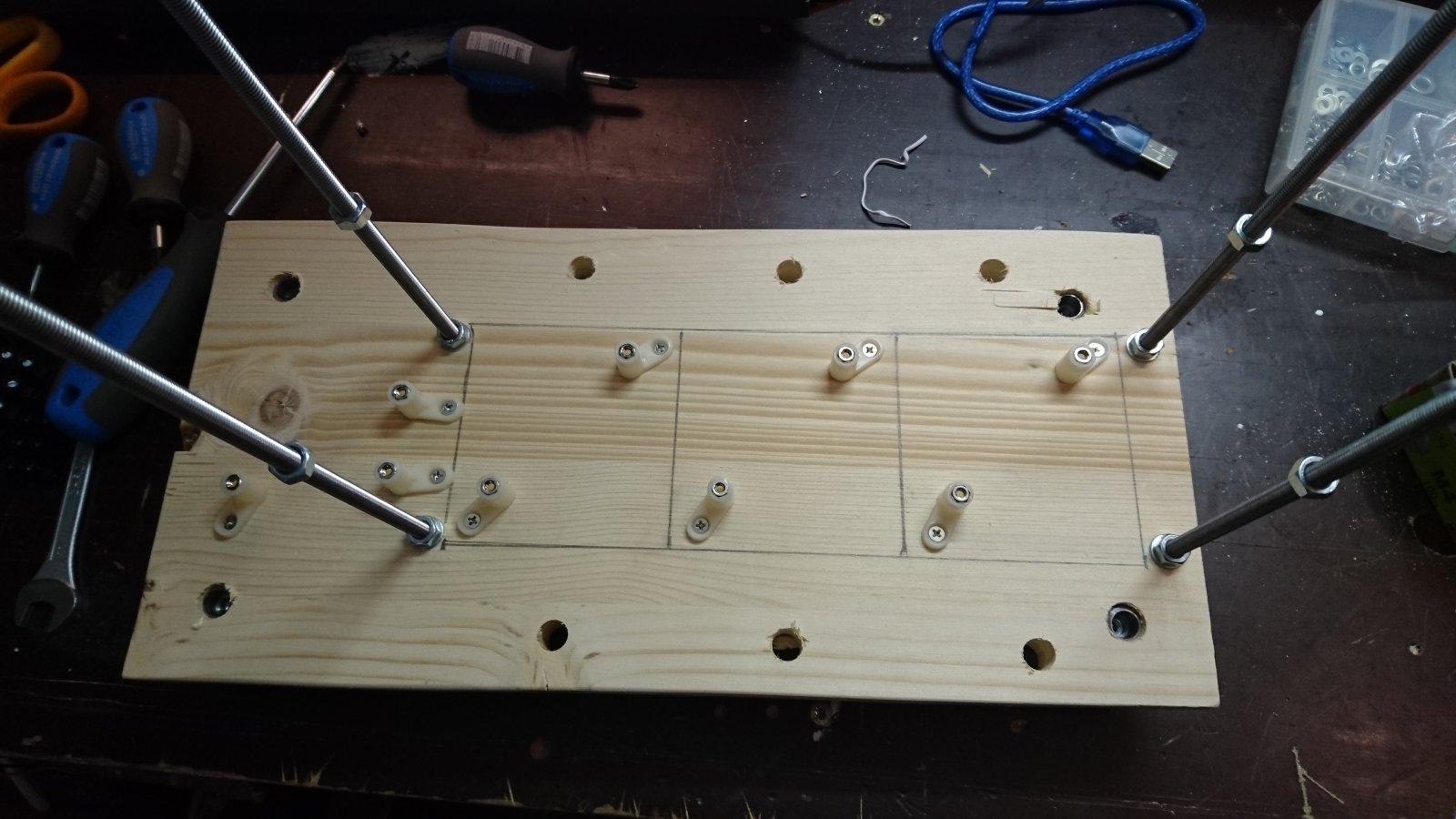

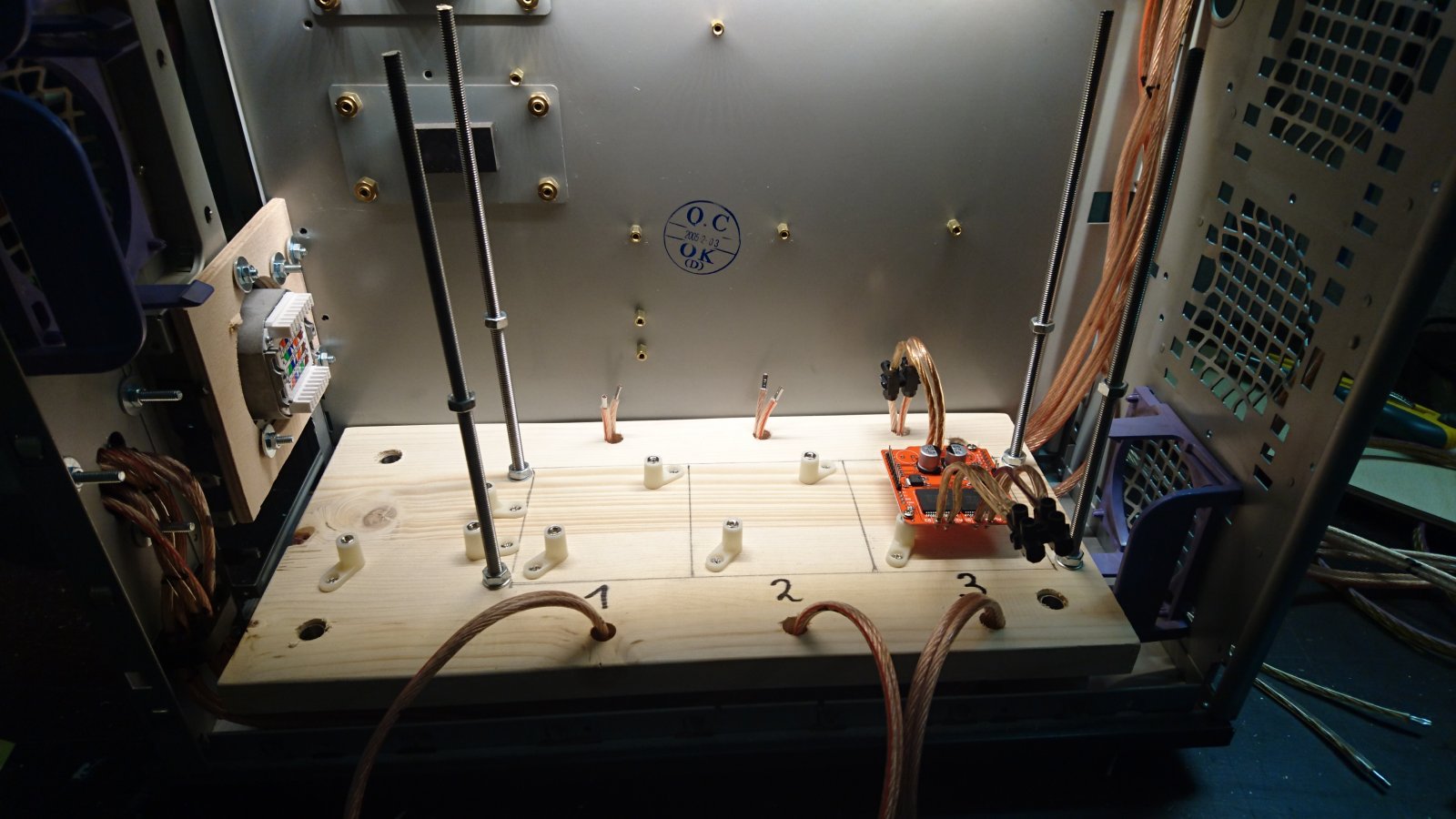

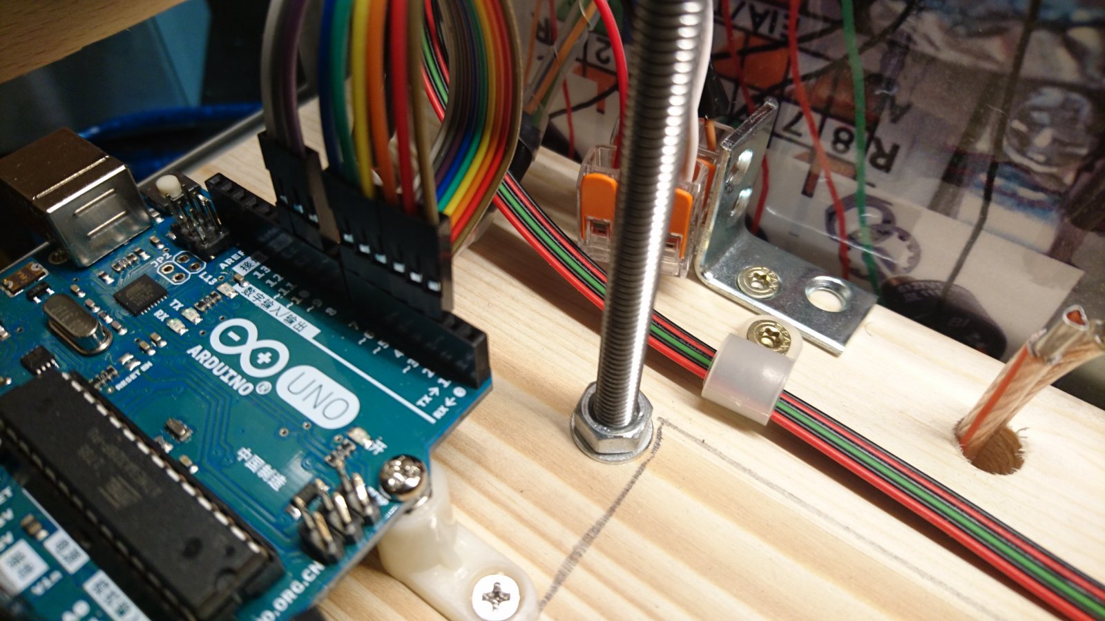

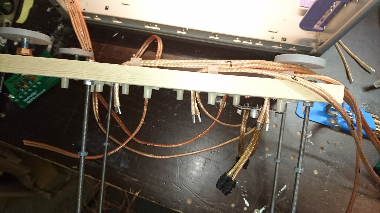

    As a platform for the Ardurino and Monster Moto, I use a wooden plate and as a carrier for the fan unit I use M6 threaded rods.
    So I can adjust it later in the height and adjust the cooling something, .... DSC_3753.JPG

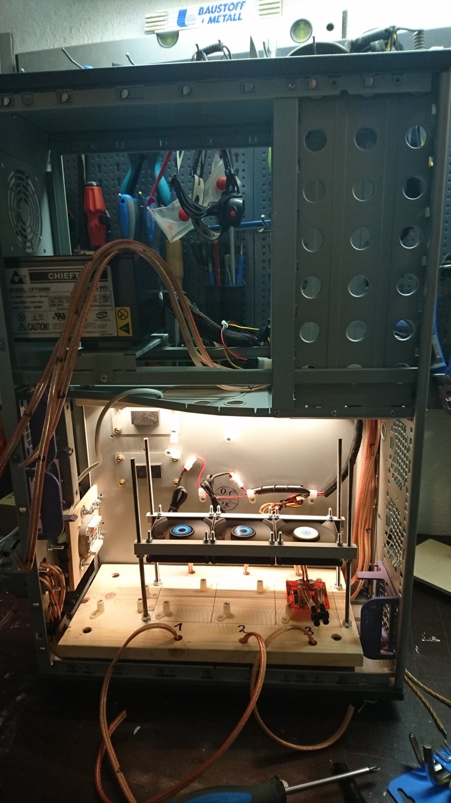

  6. Papapetrus
    Feb 20, 2018
    84
    Austria
    61Coins
    +47 / 0 / -0
    2DOF, 3DOF, Arduino

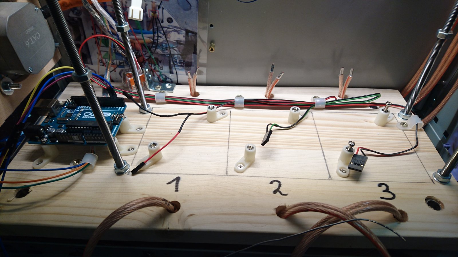

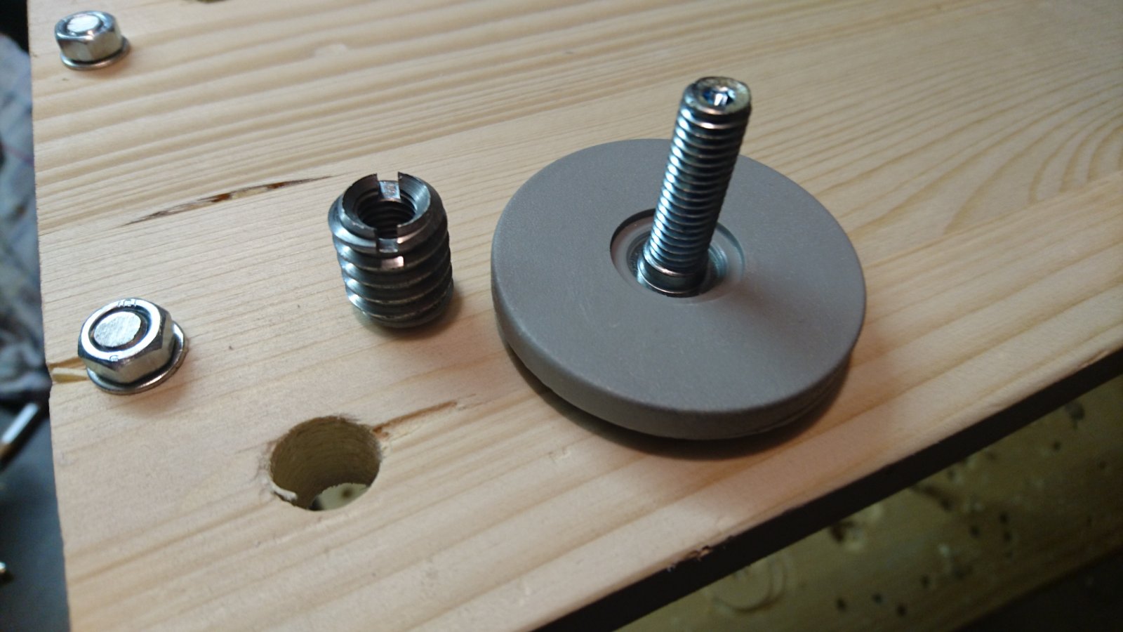

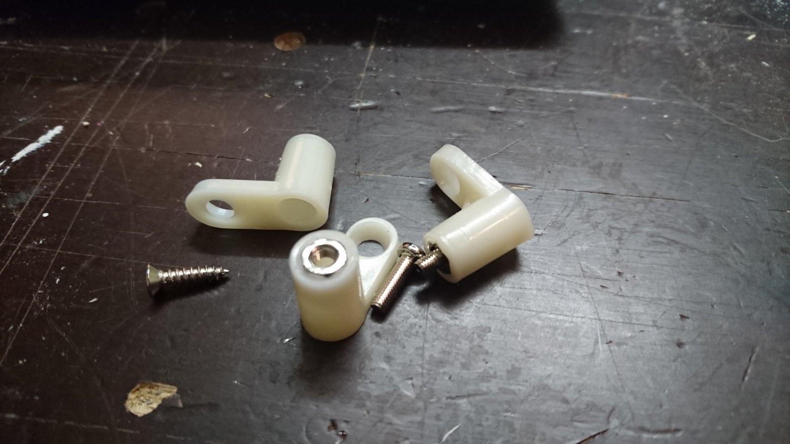

    Of course, Ikea screw feet should not be missing!Besides, everyone has their own home!:)
    So I have enough space under the wooden board to lay some cables, ...

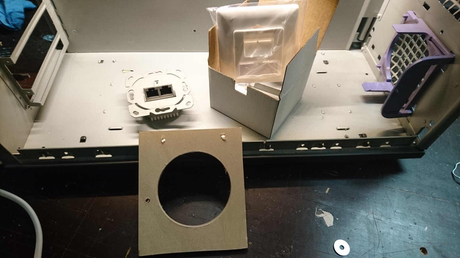

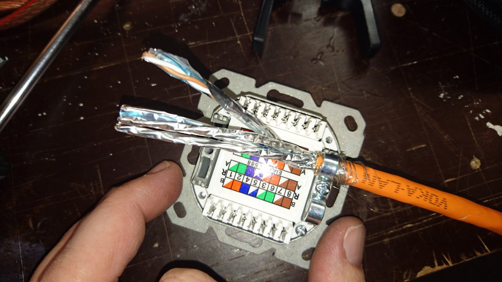

    2DOF, 3DOF, Arduino

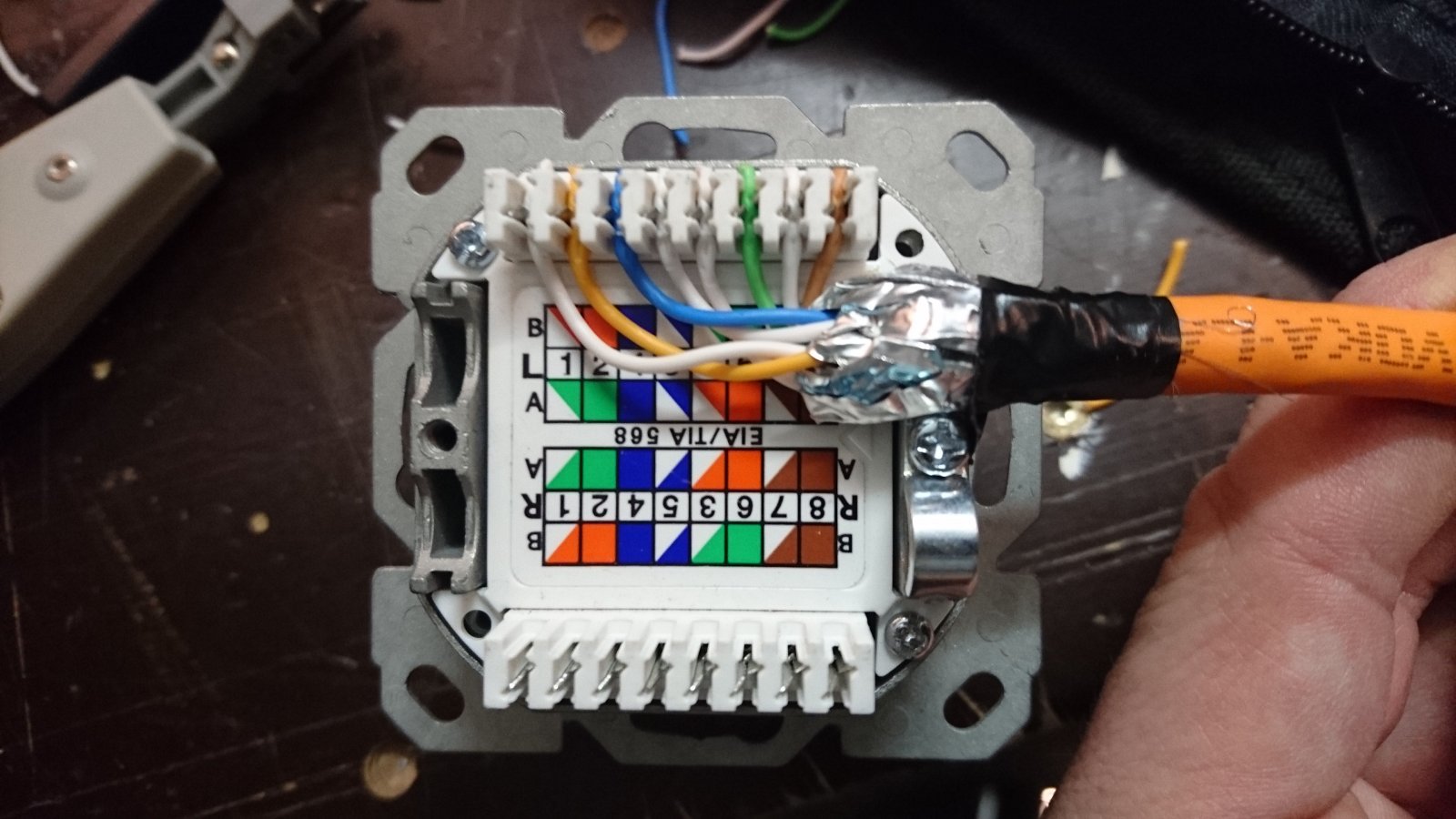

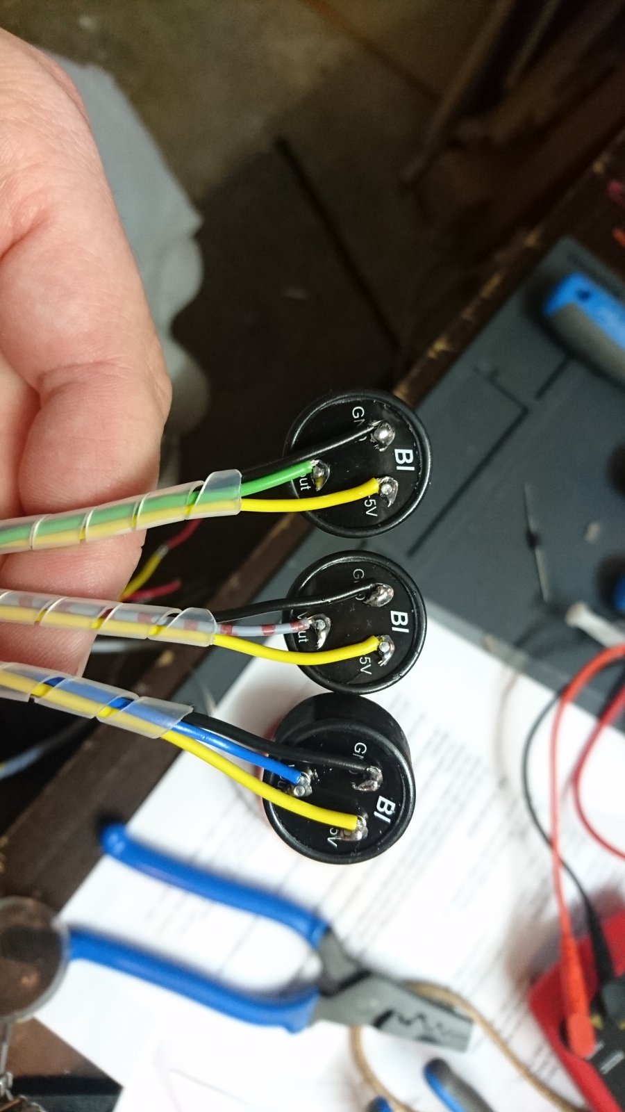

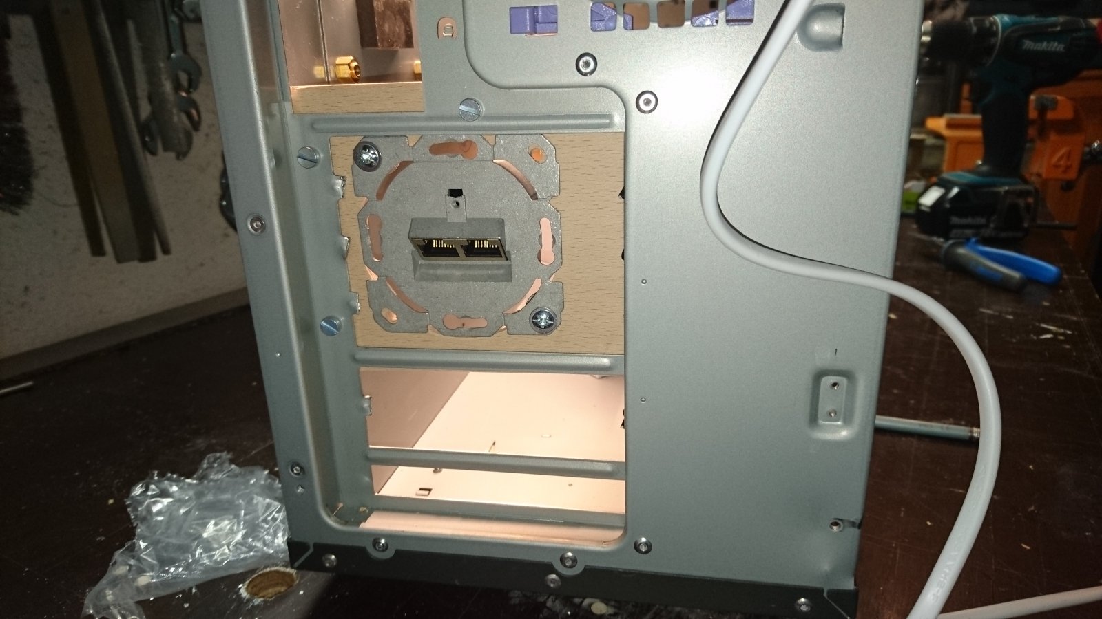

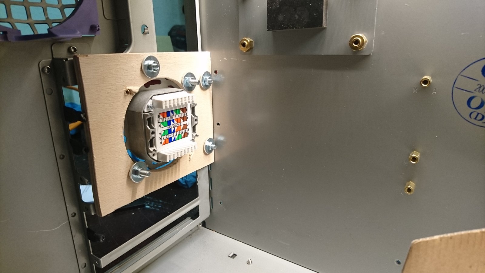

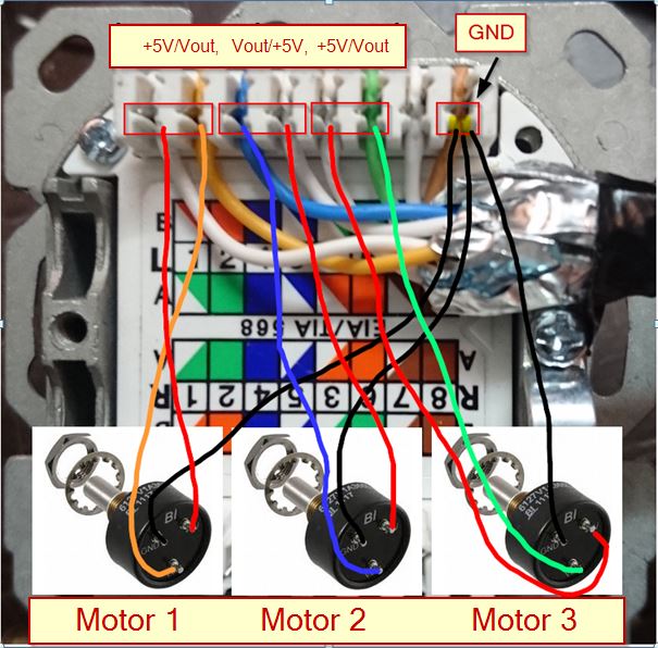

    For the connection of the Hall sensors, I use a network connection box.
    I hope that will not cause any problems later, but we will see ... DSC_3756.JPG

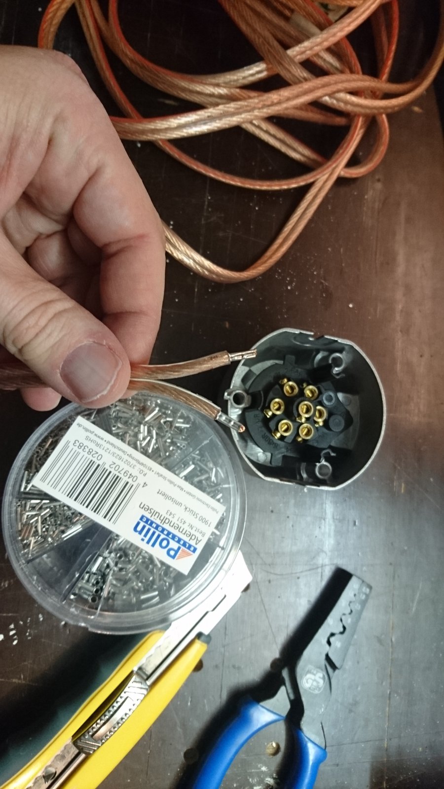

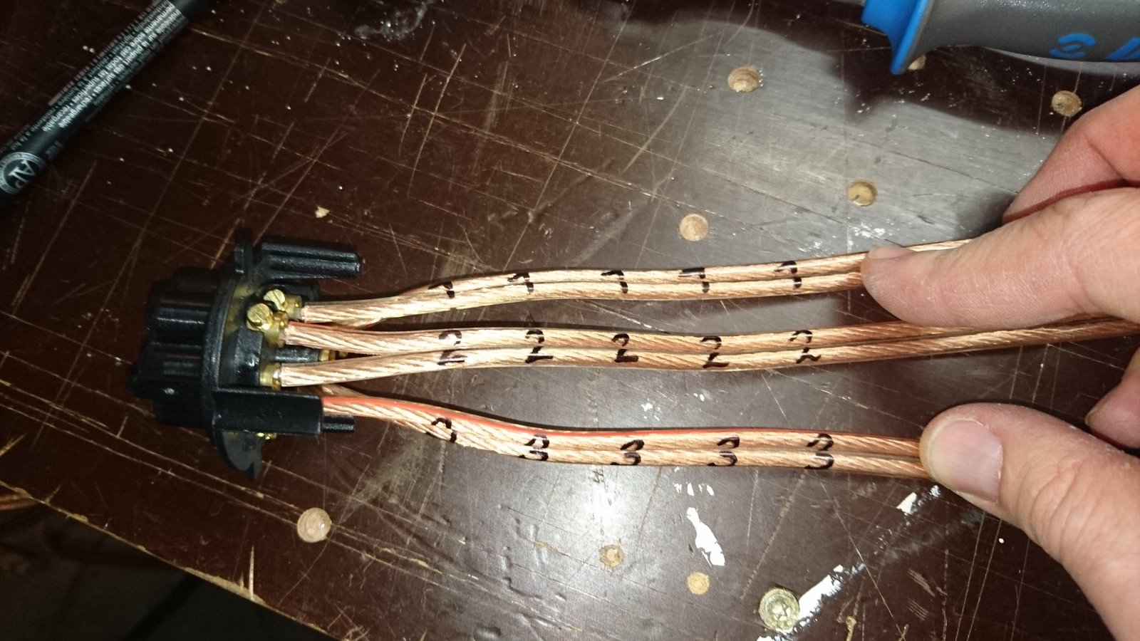

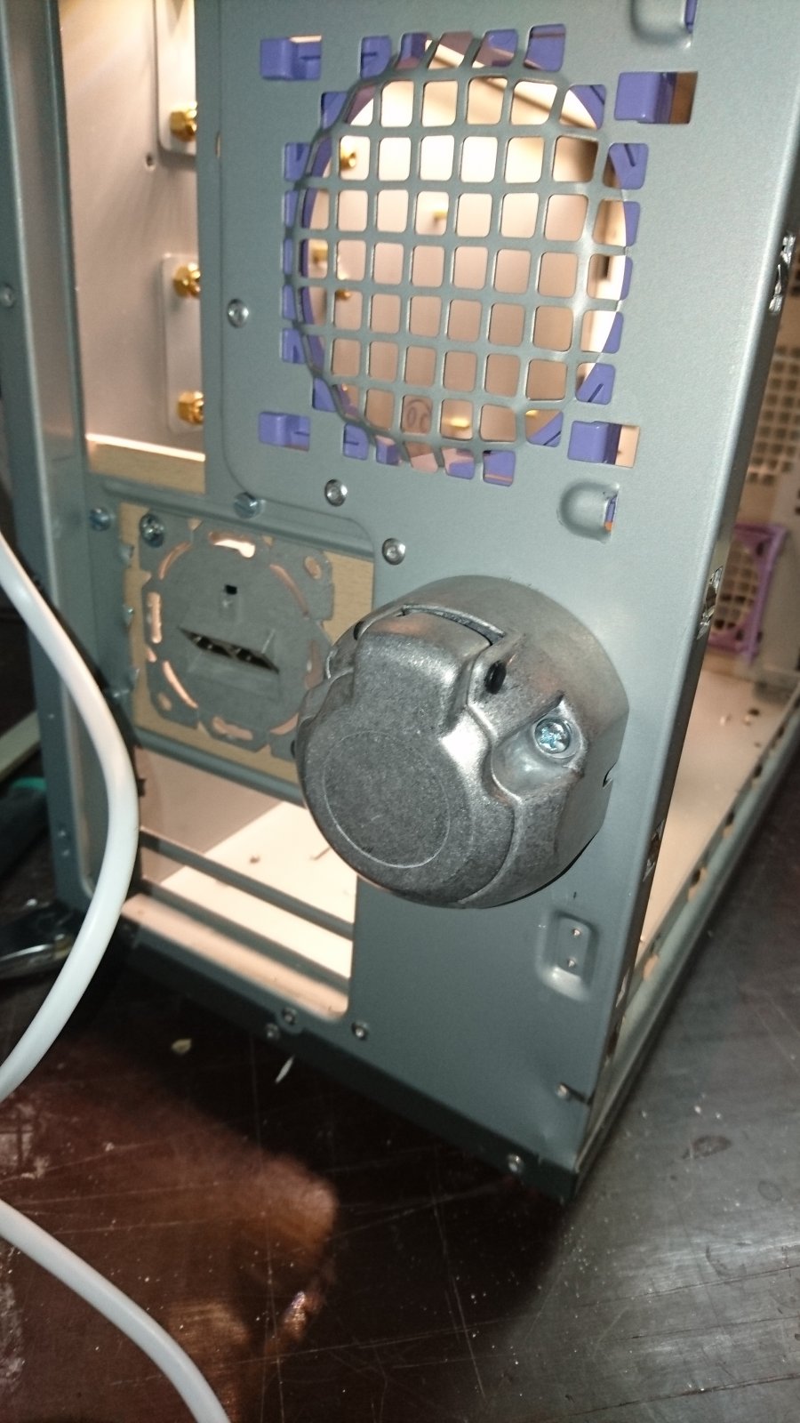

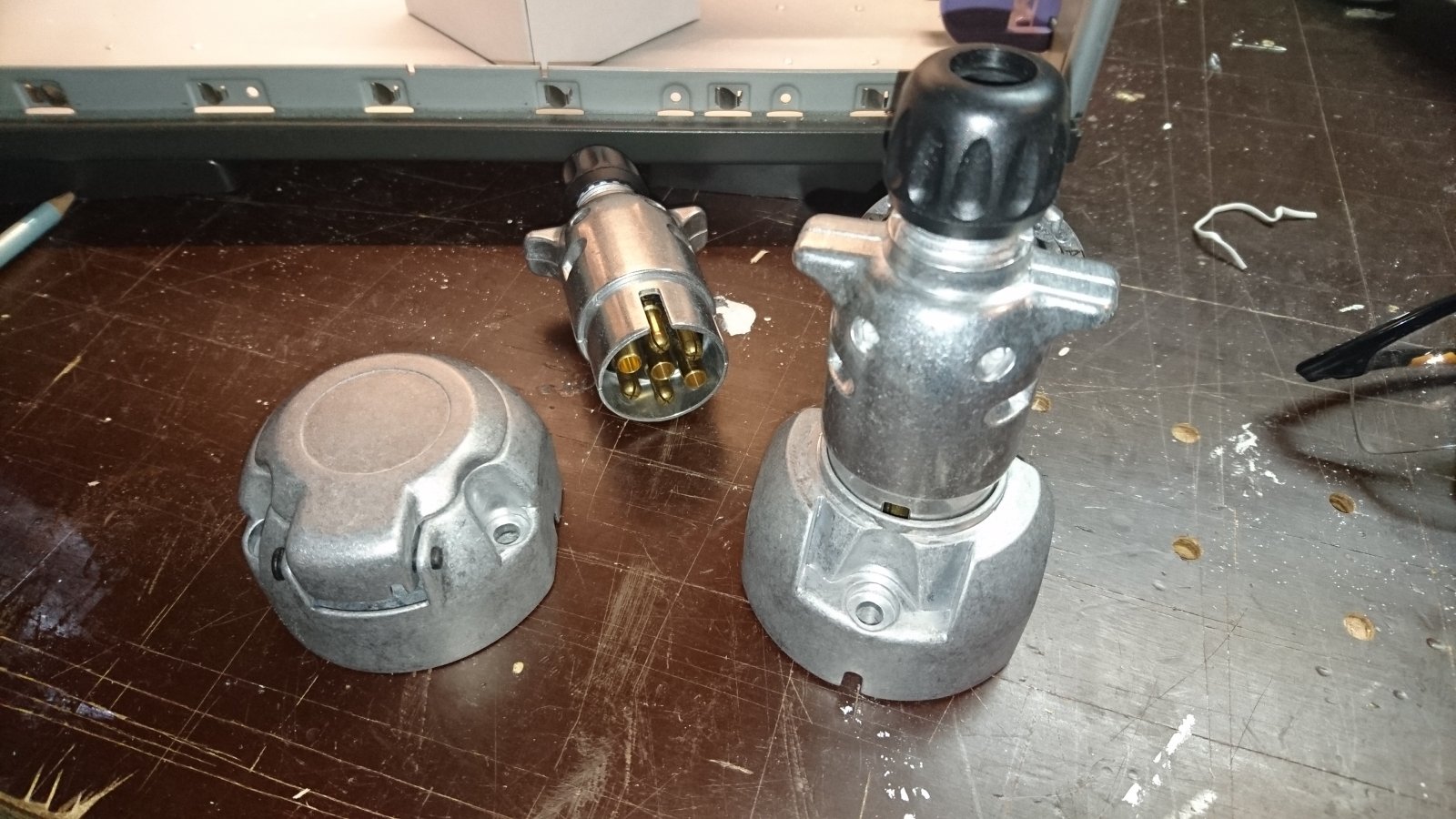

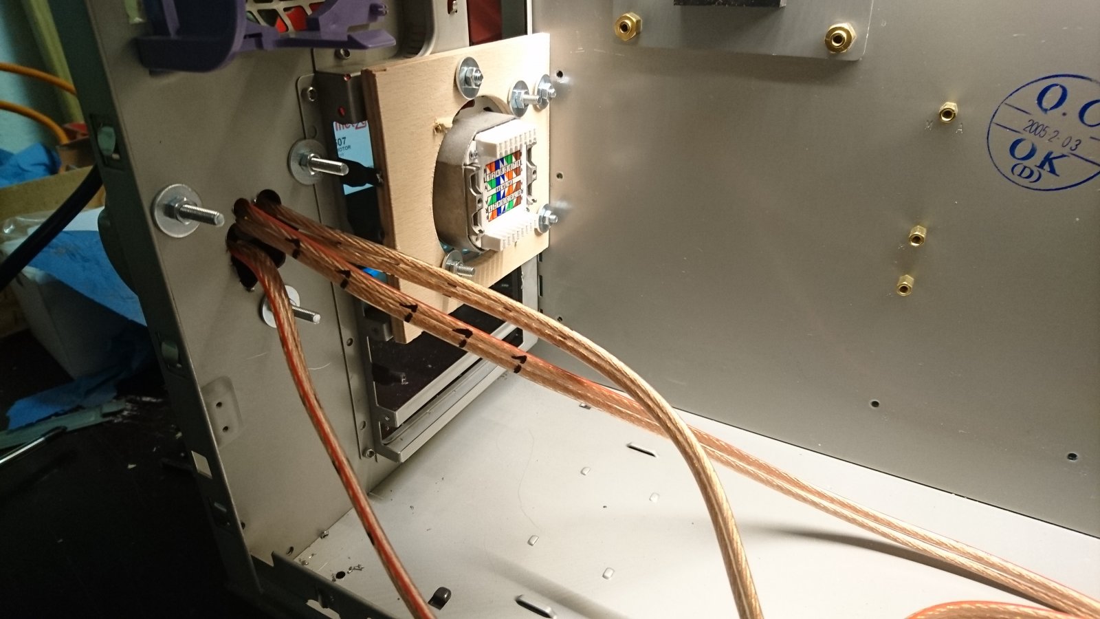

    for the connection to the engines I use plug and socket for car trailer, .... (8, - Euro per pc.) DSC_3758.JPG

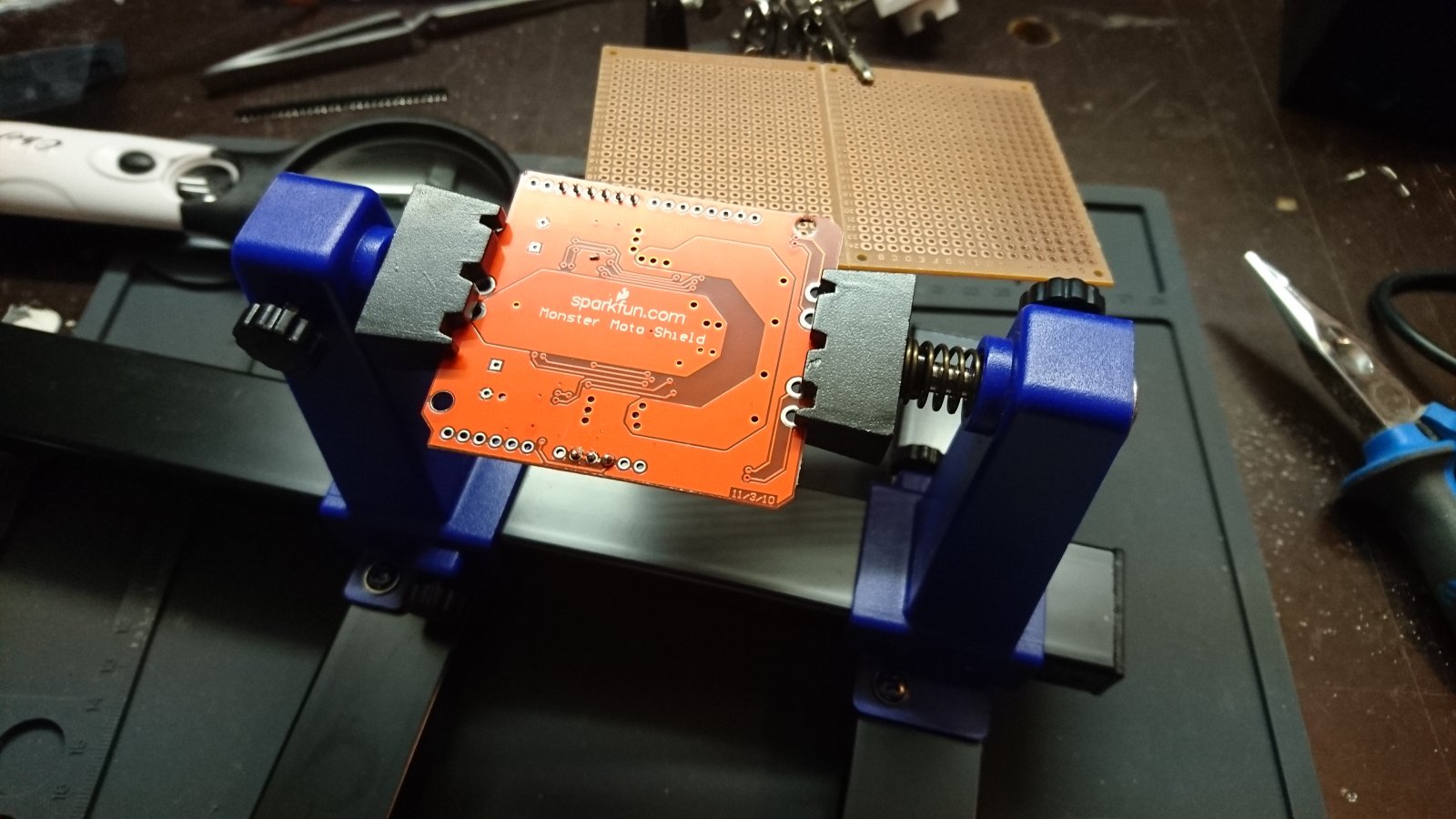

  11. Papapetrus
    Feb 20, 2018
    84
    Austria
    61Coins
    +47 / 0 / -0
    2DOF, 3DOF, Arduino
  12. Papapetrus
    Feb 20, 2018
    84
    Austria
    61Coins
    +47 / 0 / -0
    2DOF, 3DOF, Arduino

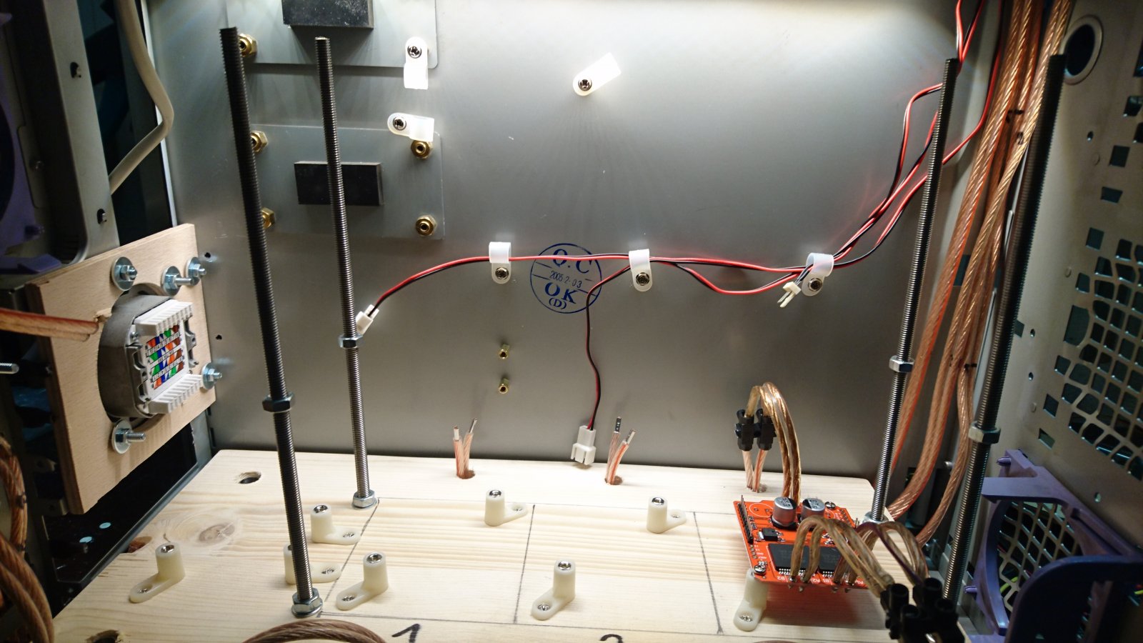

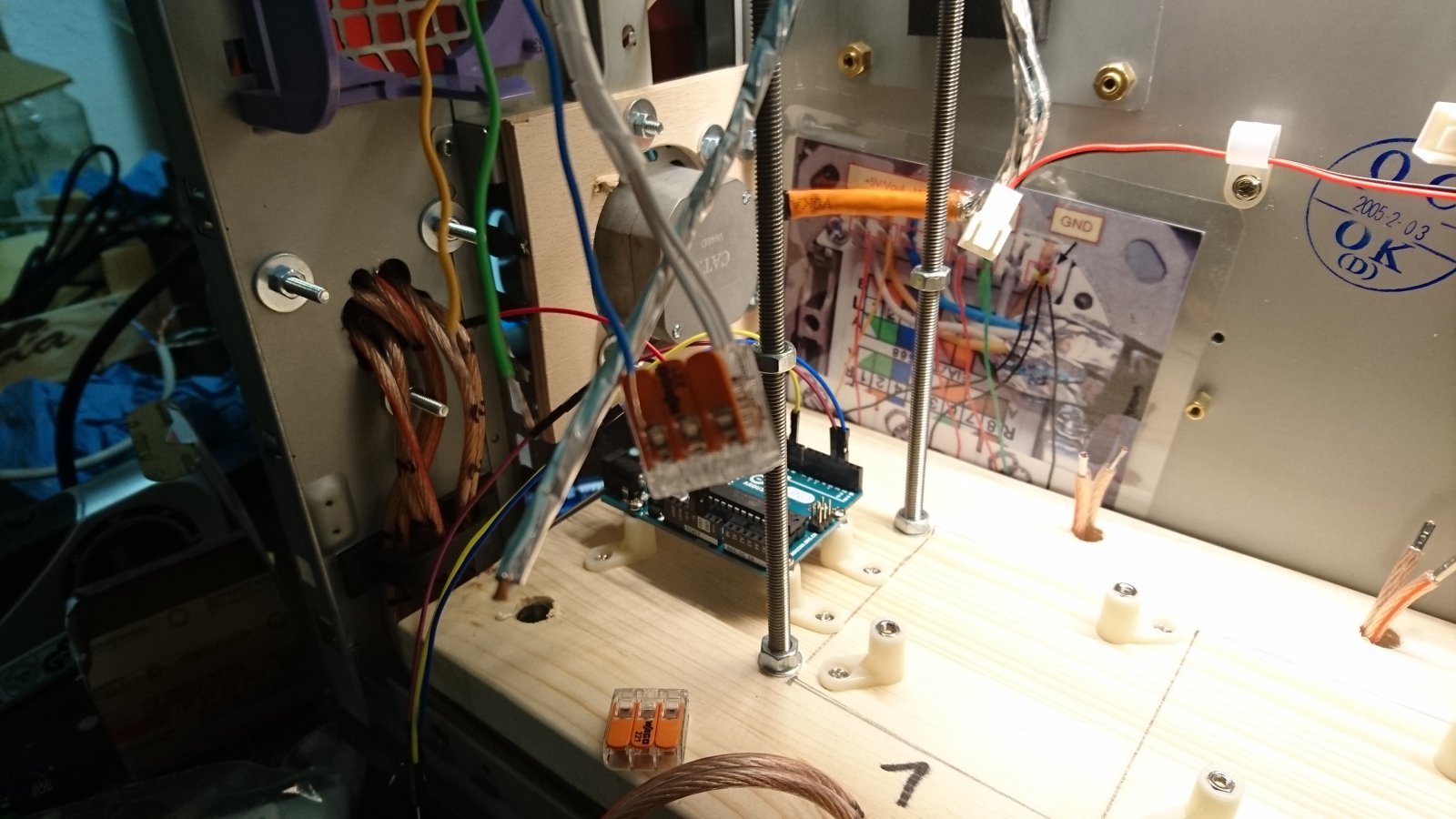

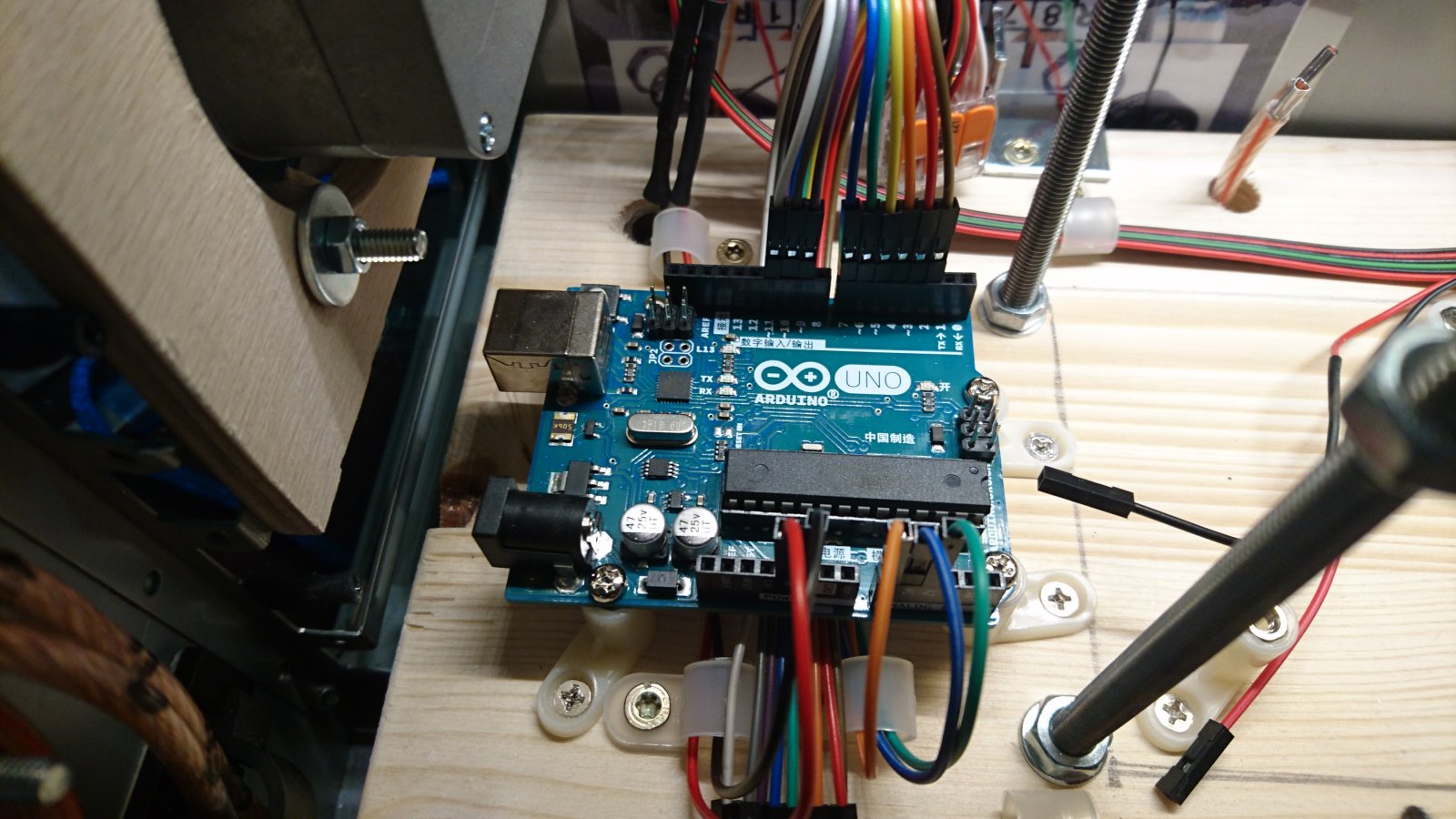

  14. Papapetrus
    Feb 20, 2018
    84
    Austria
    61Coins
    +47 / 0 / -0

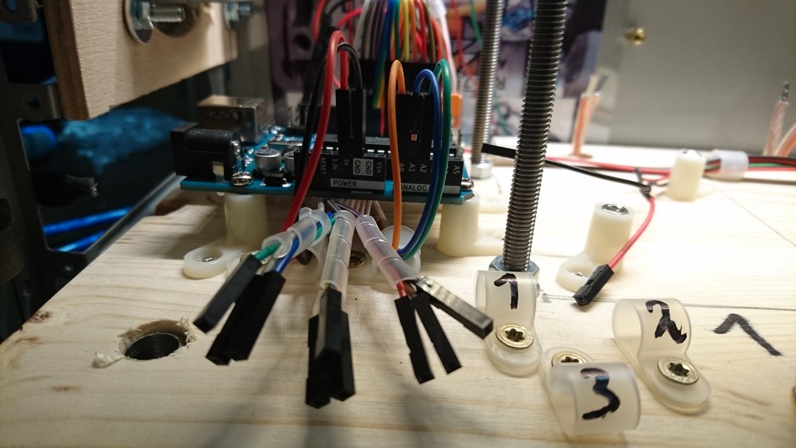

    2DOF, 3DOF, Arduino

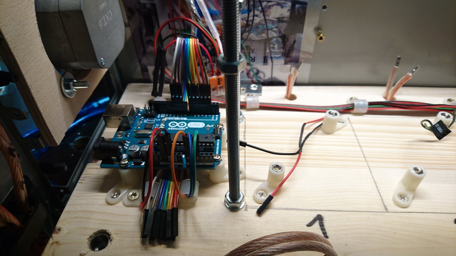

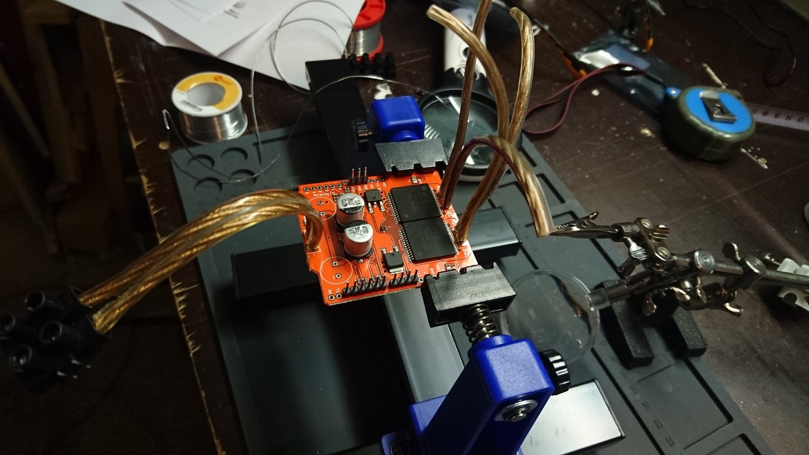

  15. Papapetrus
    Feb 20, 2018
    84
    Austria
    61Coins
    +47 / 0 / -0
    2DOF, 3DOF, Arduino

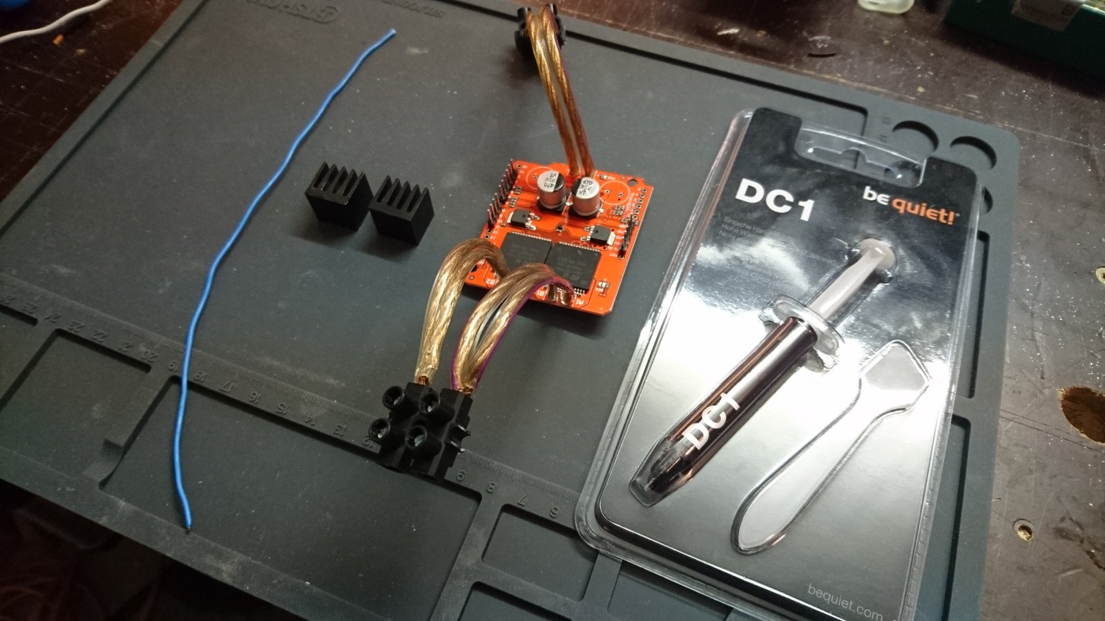

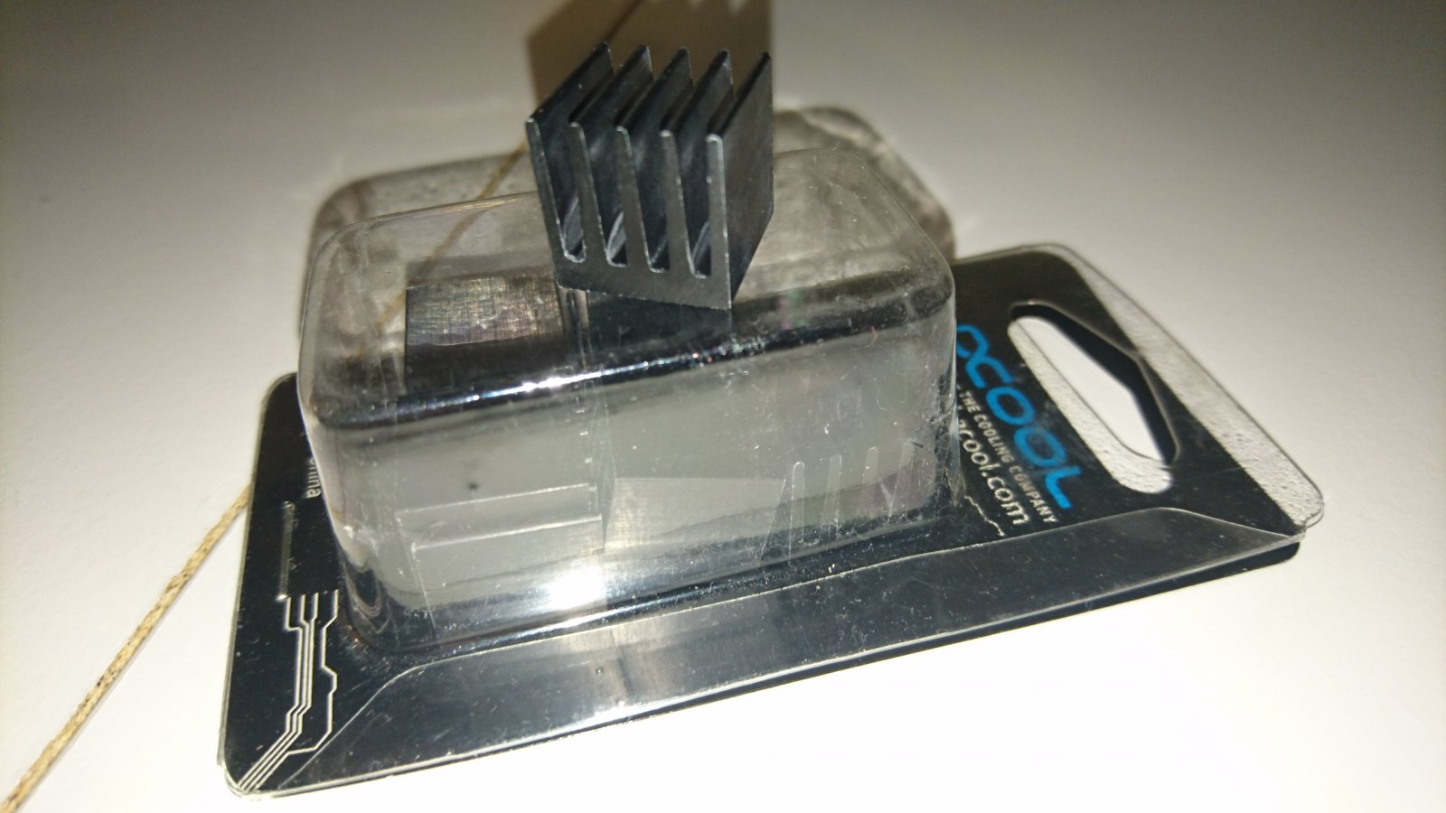

    Do not forget the heat sink, ... ( 9,- Euro)
    with thermal grease, ... ( 6,-Euro)
    let's see if that's enough ...

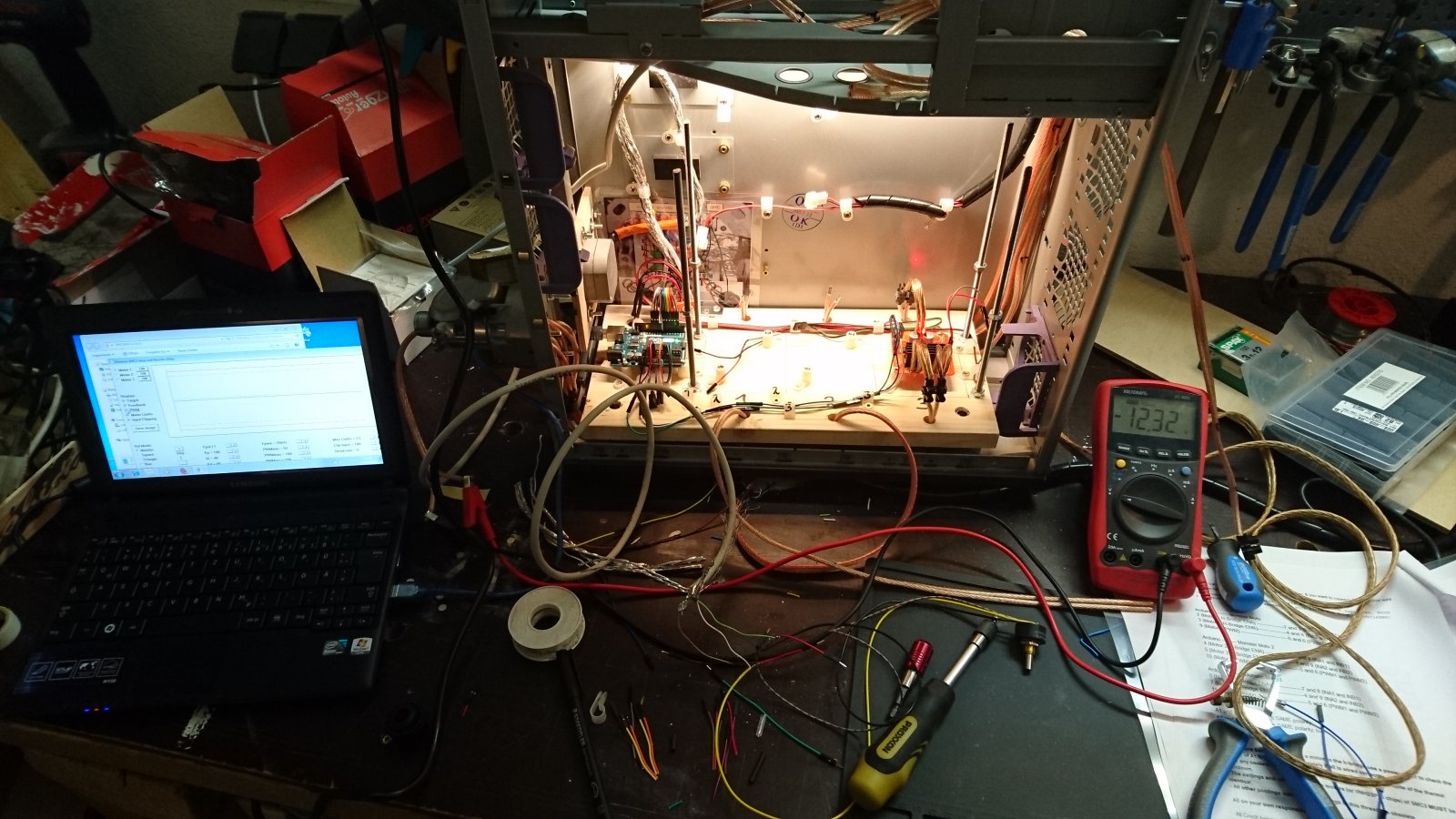

    First test without motors successful, ... :) DSC_3793.JPG

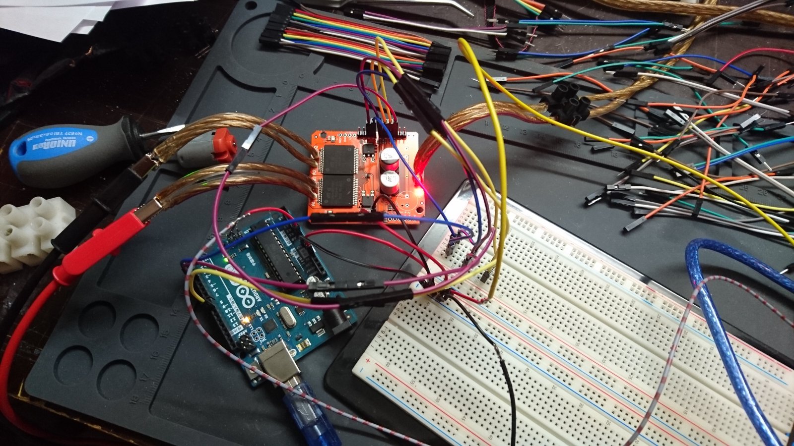

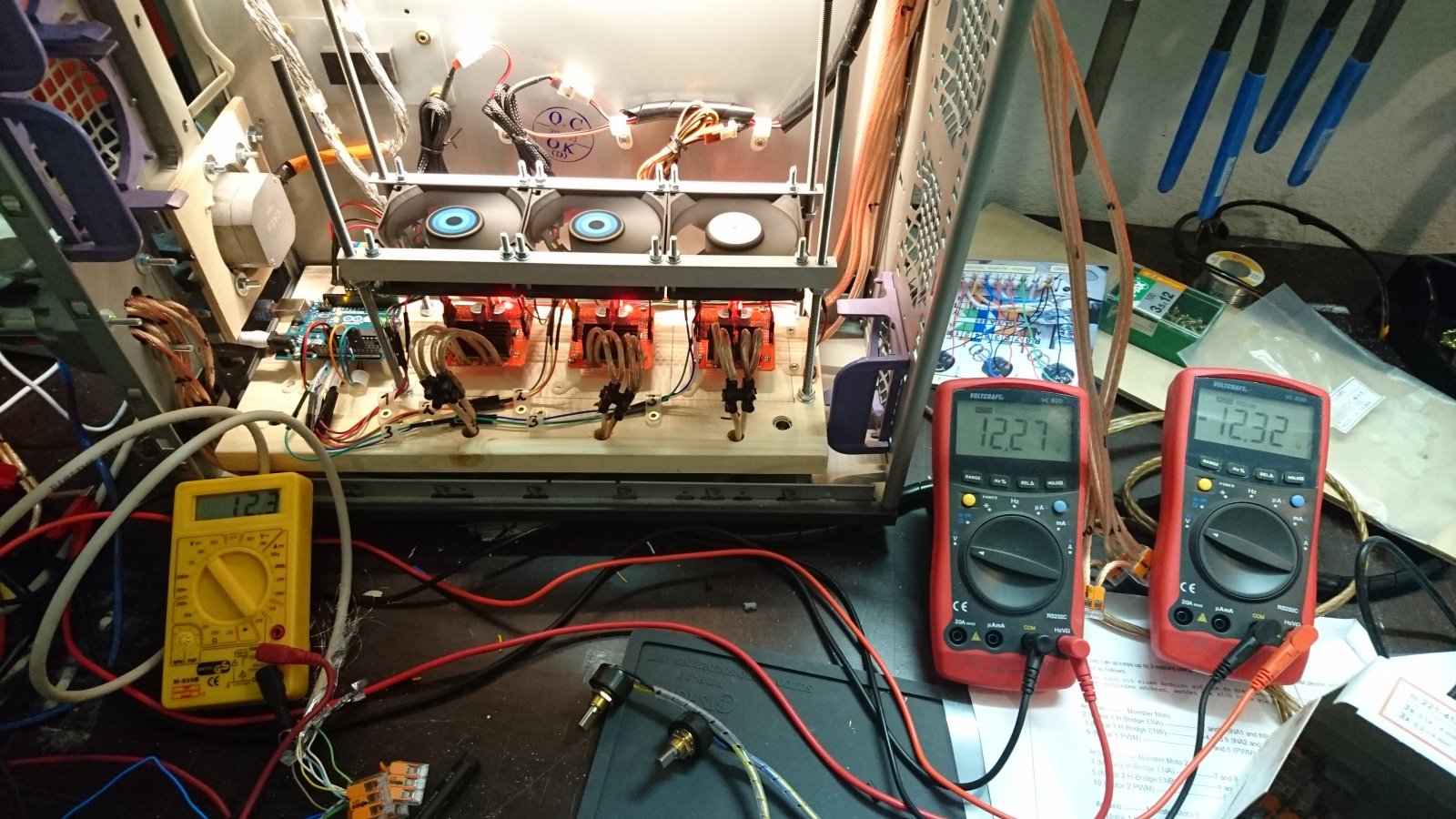

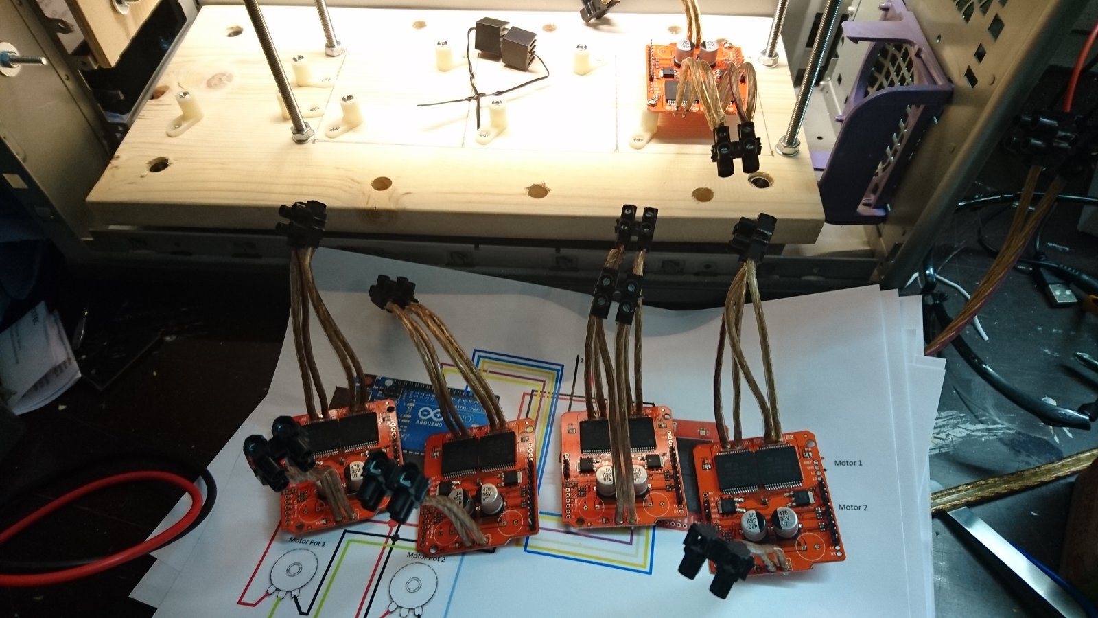

  18. Papapetrus
    Feb 20, 2018
    84
    Austria
    61Coins
    +47 / 0 / -0
    2DOF, 3DOF, Arduino
  20. Papapetrus
    Feb 20, 2018
    84
    Austria
    61Coins
    +47 / 0 / -0
    2DOF, 3DOF, Arduino

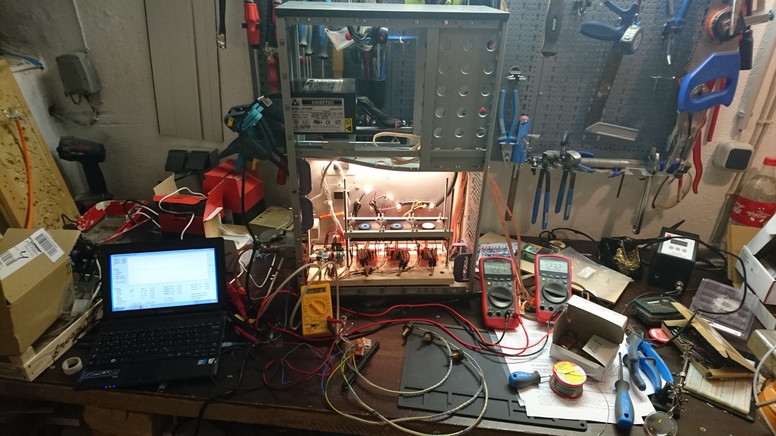

    all Motomonster drivers seem to work, ... :) DSC_3805.JPG
