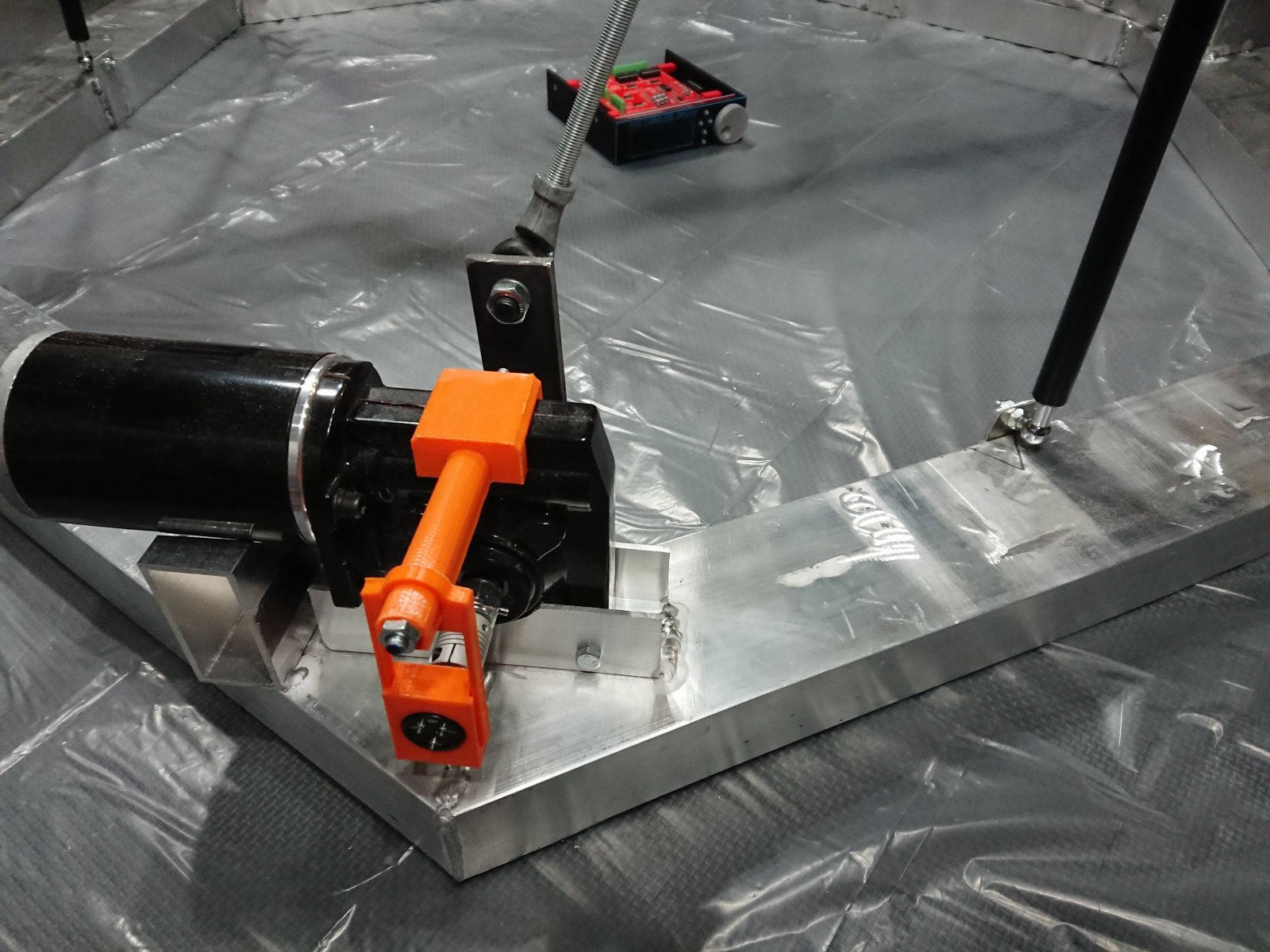

    Thanks, @Zed! I'm not worried about heat as I'll be welding small tabs to the frame about midway between each set of motors. And definitely no electronics connected at this point. I was trying to wrap my head around whether or not the motors would be part of the circuit. If I attach my "ground clamp" to the tab I'm welding, I should be good to go, yes?

    I would think so. As long as the motor leads aren’t touching anything I would think you would be fine.

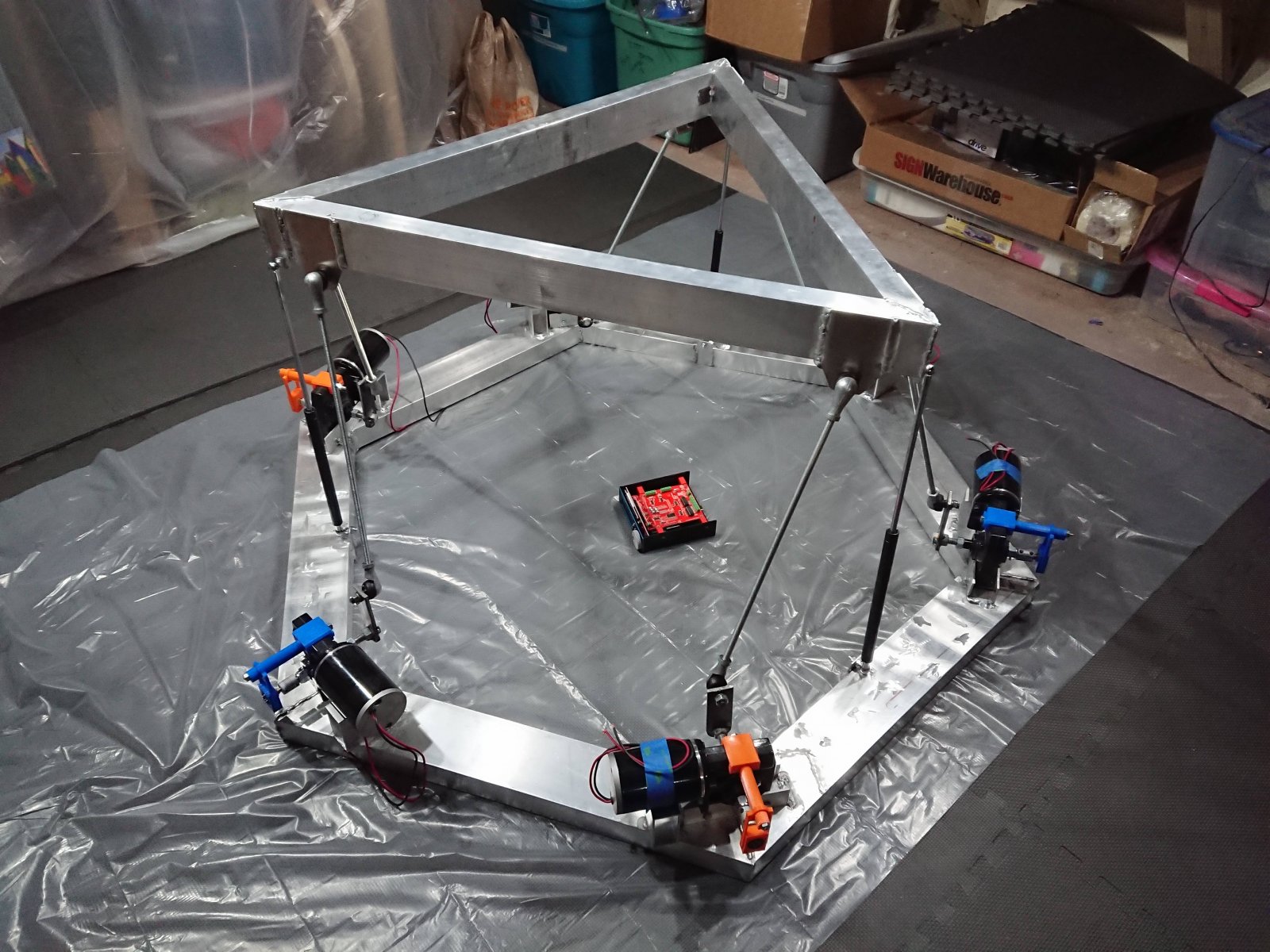

    Phase one complete. It's pretty ugly. I think I'll make it a rule that all riders put on the Oculus before approaching the rig.
    Now on to the electronics. Reading through @SilentChill's experience with motor drivers, I'm thinking that Sabertooths are probably worth the investment. Any advice on 2X32 vs 2X60? I am using 12V crab pot puller motors. If I read correctly, I can control 2 motors with each Sabertooth, correct? And is there a consensus (or at least a plurality) on whether it's better to use capacitors or a car battery (I think @SilentChill used just one)?
    Anyway, thanks for all the help and advice so far. Here are some photos:

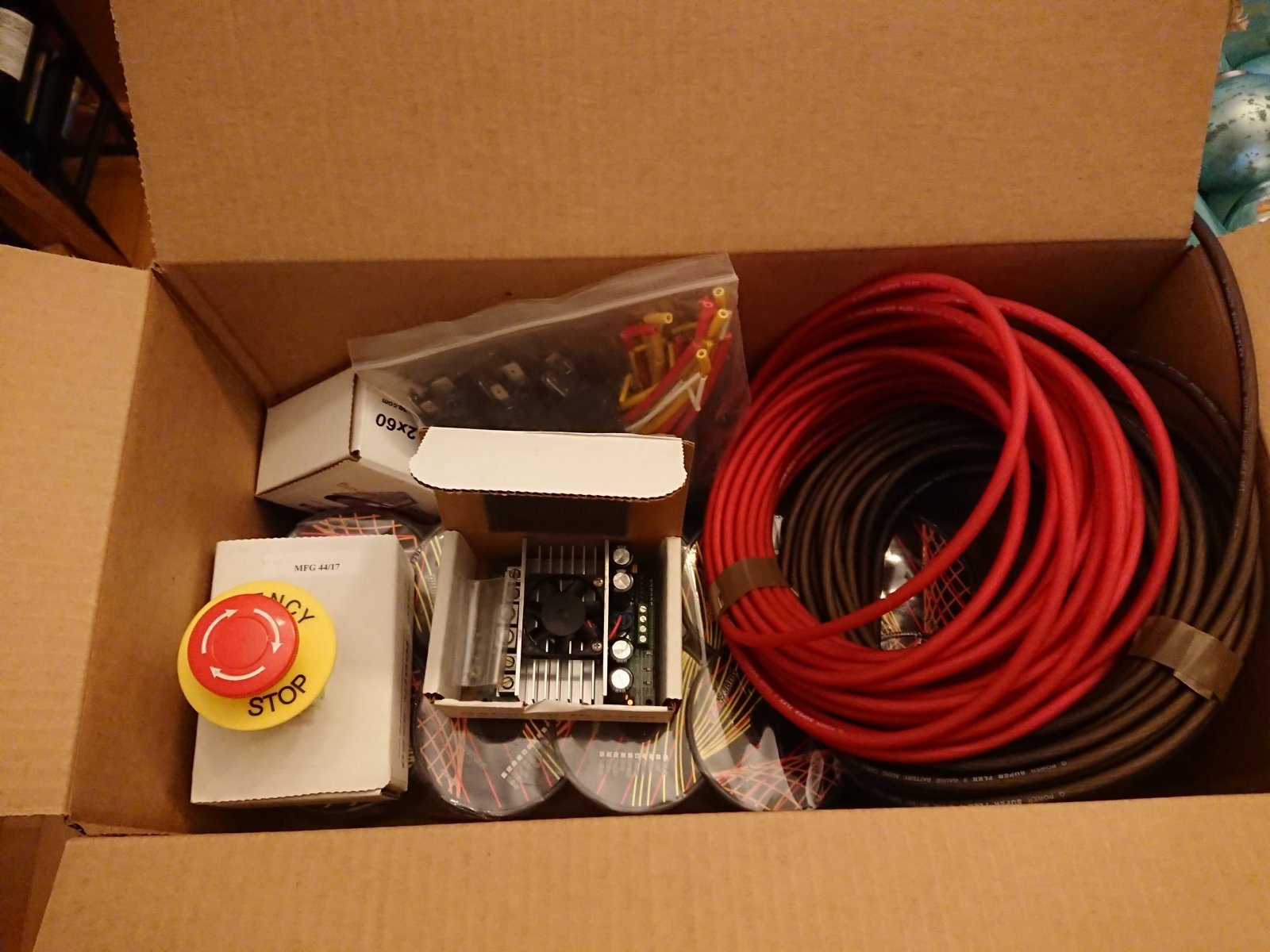

    Thanks, @noorbeast. The Sabertooths arrived today, and the power supplies and assorted relays, kill switches, etc. are on hand. Hoping to wire it up this weekend.

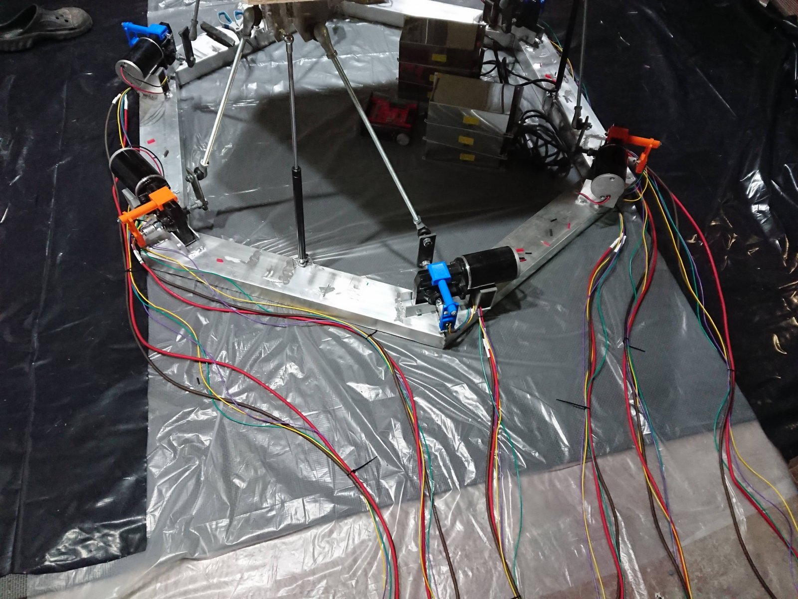

    One power supply DOA, so a little bit of disappointment and a slight delay while waiting for a replacement, but the rough wiring is done, and I am in possession of a DIY key! Soon...

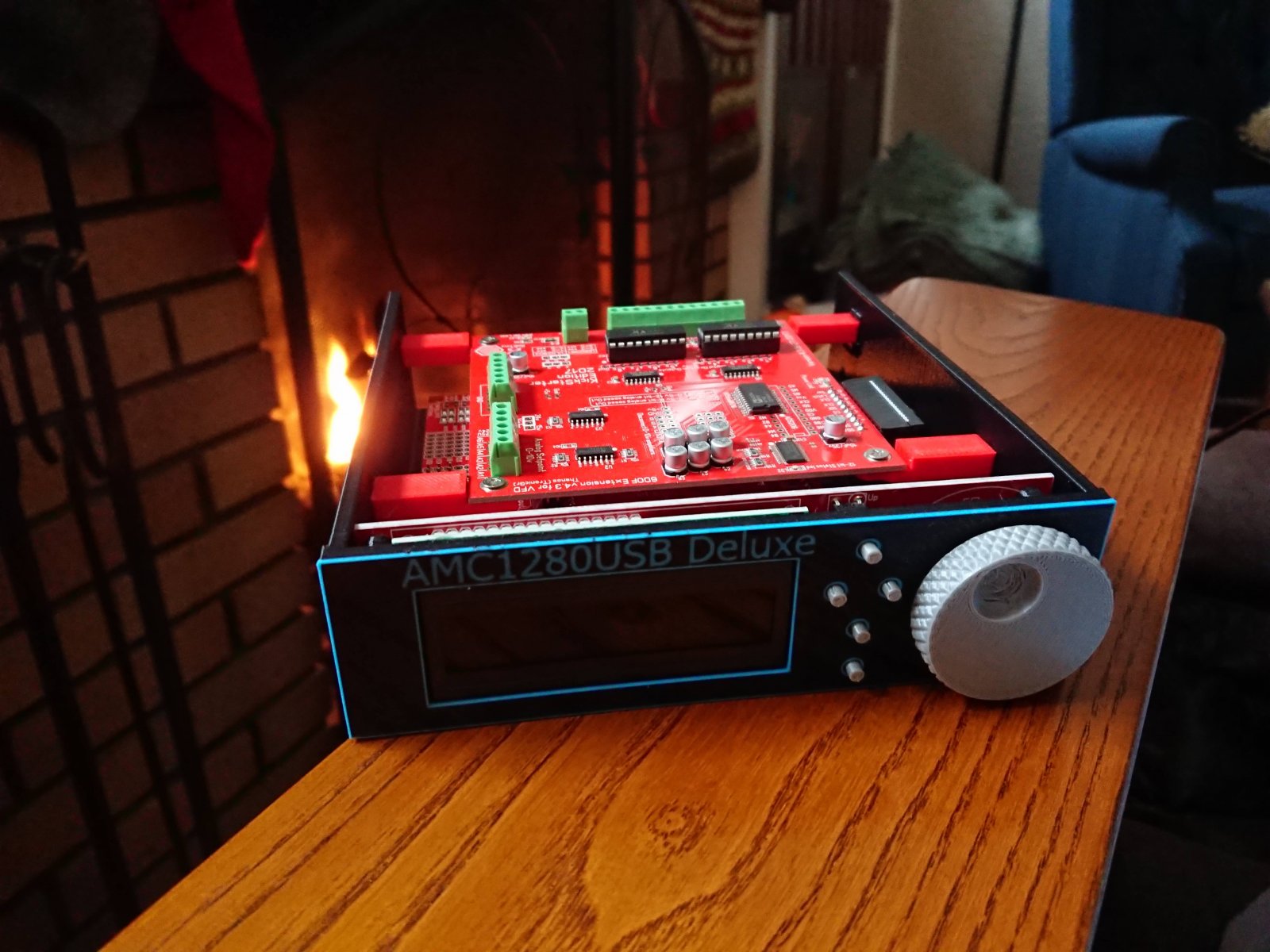

    Is anyone else using Thanos' AMC1280USB controller?
    I've reached this point in my wiring, and while I've read through Thanos' blogspot and watched some of his YouTube videos, I can't seem to find a user manual. So if anyone else has experience with this, I have some questions...
    EDIT: Never mind. I found a dropbox link where Thanos has posted some diagrams. Here goes nothin'. Hold my beer...

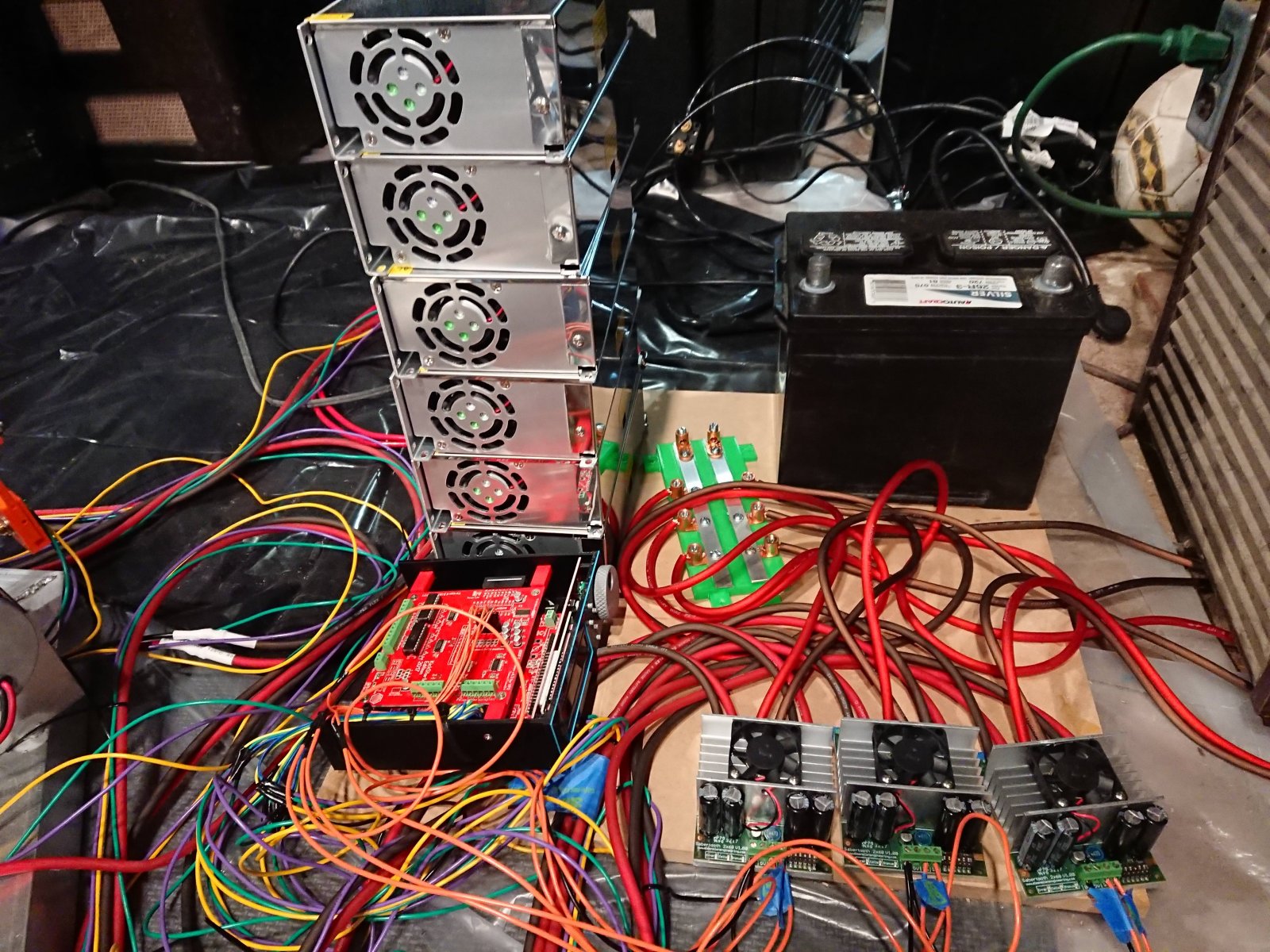

    Rigged for maximum smoke. Holiday festivities and obligations will delay testing for a bit, though. Happy holidays to all, and thanks for the help and support you've provided!

    Well, 9:00 on Christmas Eve is probably not the ideal time for a first test. Good news is that the motors all seem to be working, and were unable to break the platform or bend any rods while spinning though 360 degrees. Also, no magic smoke was released. Bad news is that I did not have any control of them through the SimTools Output Testing interface. I used the settings provided by Thanos in this link: https://www.xsimulator.net/community/threads/thanos-amc1280-help.6045/
    The interface did find a com port (6). I imagine there is more than one important thing that I'm missing, but, as I said, this probably isn't a great time for testing. I'll appreciate any suggestions, but in the meantime I'll breathe a sigh of relief that nothing broke or burned up the first time power was applied.
