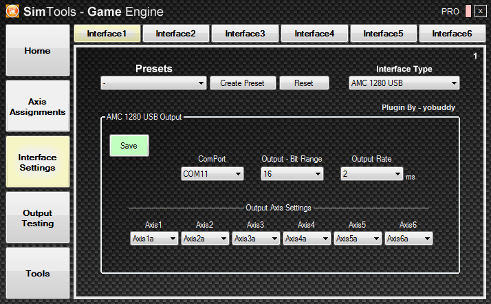

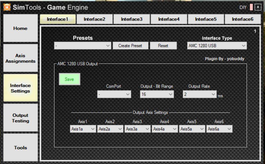

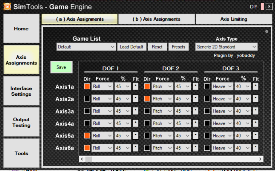

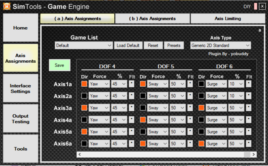

    Just to double check can you please post pictures of all of your current settings.
  2. Squonk
    Squonk Member
    Aug 29, 2017
    93
    USA
    482Coins
    +86 / 0 / -0
    The axis set-up I copied from @Thanos' post mentioned above. I'm not sure about the "Axis Type" as I couldn't find a reference to that in the game engine documentation. Right now, there are two options in that drop down - Generic 2D Basic and Standard.
    21,714
    151,919Coins
    +11,061 / 56 / -2
    There is no com port selected in the Interface Settings you posted, try selecting the appropriate comport then save the settings, like this:

    Right. I took those screen captures when the Thanos controller was not attached. When attached, it uses Com port 6, and I've saved that configuration.

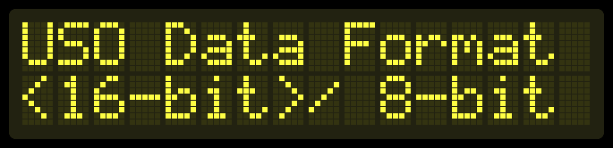

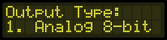

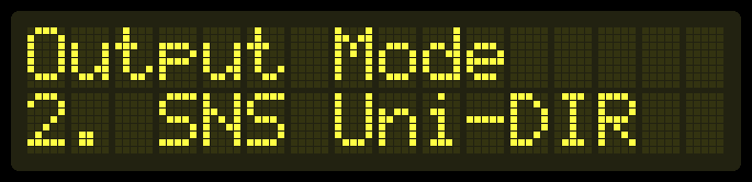

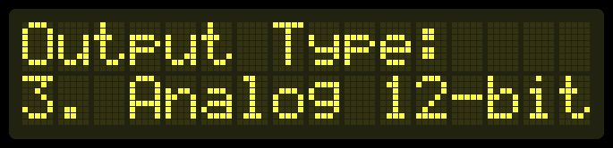

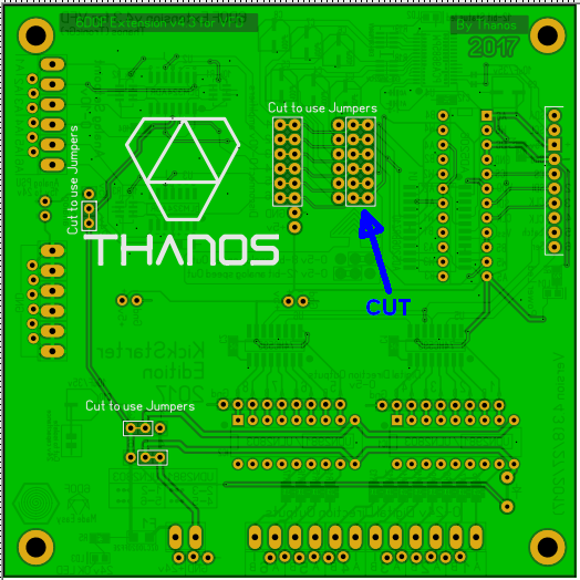

    Hi

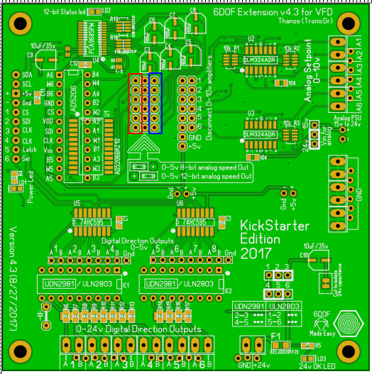

    You can connect the Sabetooth analog signal to either 8bit or 12bit outputs.
    But make sure to cut the traces on the bottom of the board:
    Then make sure you choose the correct resolution and output mode:
    For detection issues on simtools, make sure to set the AMC1280USB in "motion only" setting
    Thanos

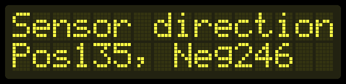

    The Motion Only option is in the second menu option under the USO Data parameter:
    Enter that menu option and enter second time and select:

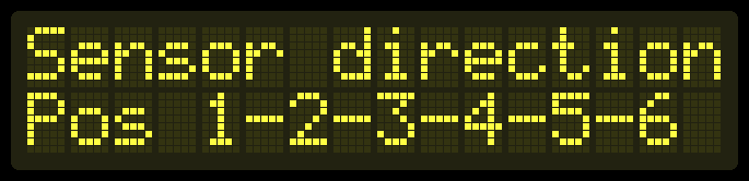

    Did you try to move the position sensor manually to see if you can adjust the motor speed and direction?
    What kind of analog sensor you are using? If its a simple potentiometer you may just reverse the positive-negative connection to reverse the way it reads the position. Maybe this is why the motor keeps running 360 degrees. Try swaping the motor connection so the motor runs the other way around.
    If you are using the Magnetic Hall effect sensors you might not be able to just reverse the positive-negative (it will damage the sensor). In that case you will have to reverse the sensor reading using:
    to this (for 6DOF with motors placed in facing pairs):

    Its hard tell if you are reading correctly the position sensors. In the video they look as if they are either High or Low, not voltage. Are you sure the sensors are set to 10-bit?
    Also set the max motor speed to 10 or 15%, the motors turn too fast to see the sensor indication bars.
    If you click enter while showing the bars on the lcd, it will display numeric values.
    Also set PID to 10,0,0

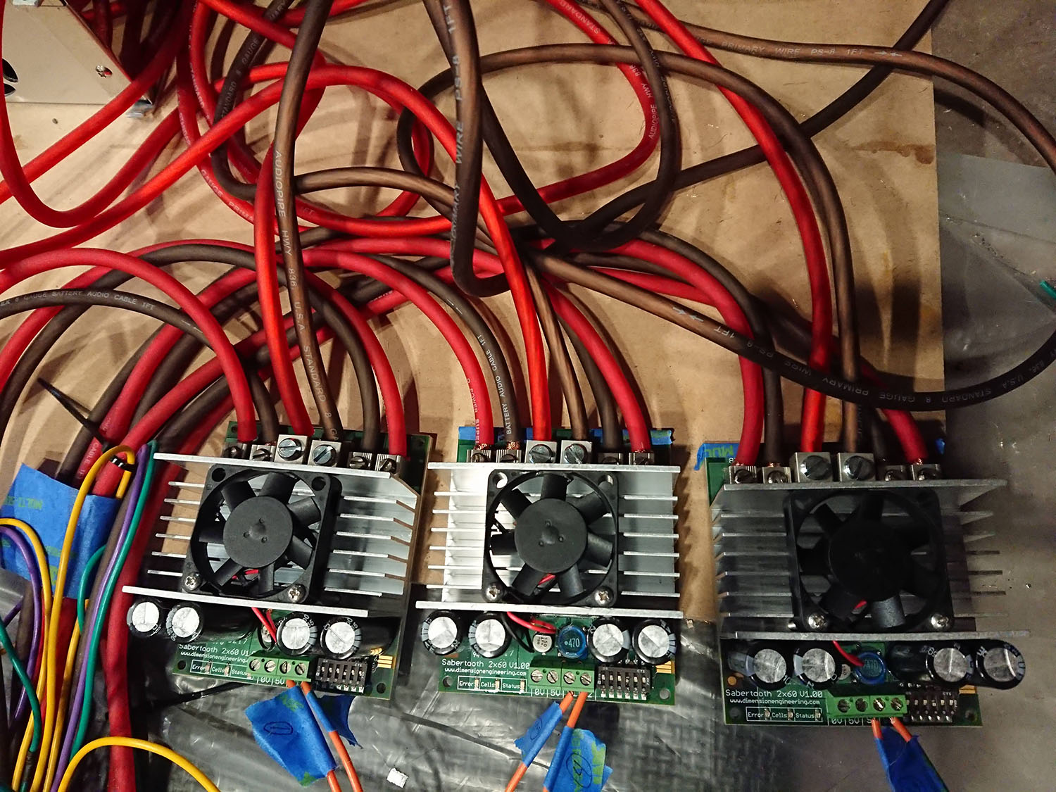

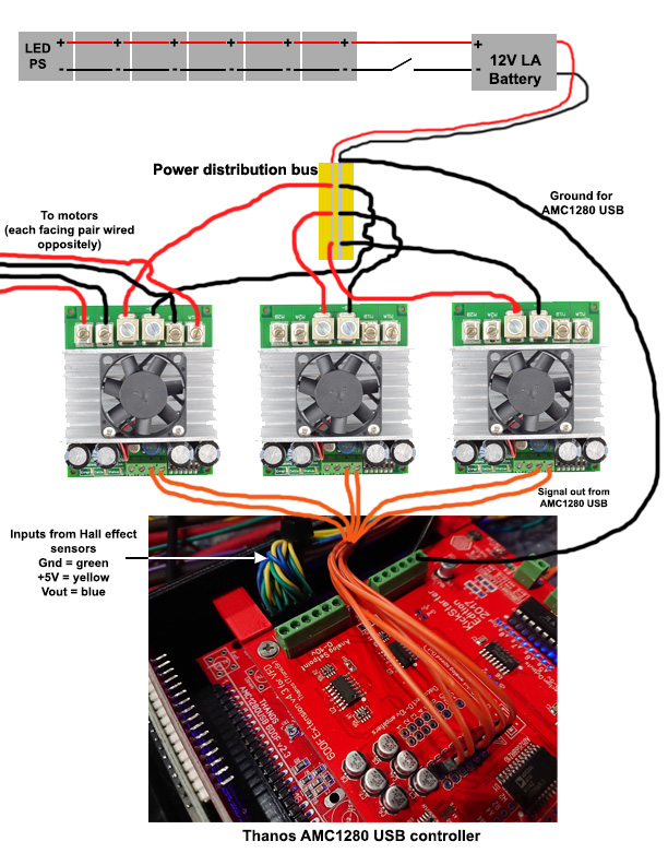

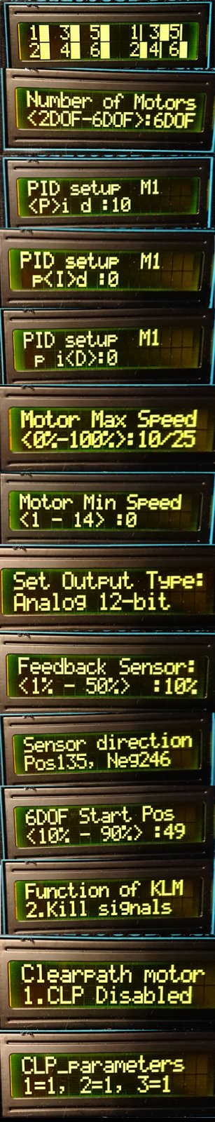

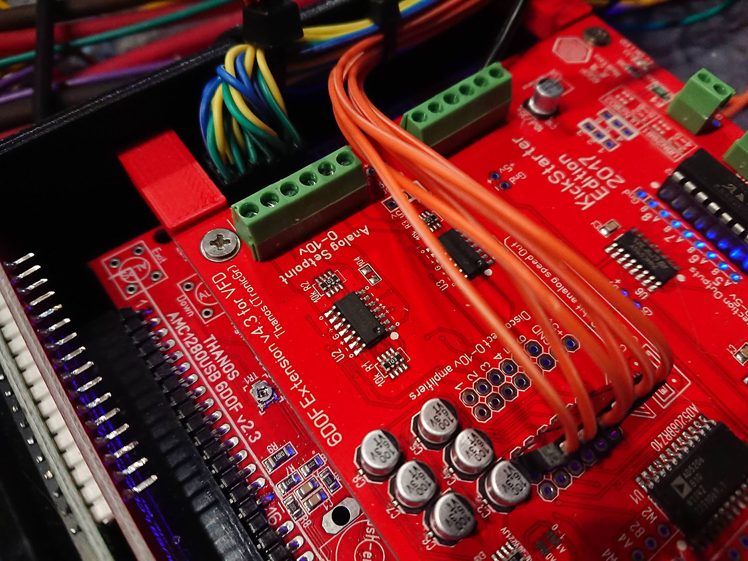

    Well... it was a good project until I hit the wall. :) Back at it after a few days away. While I was gone, I talked myself into hoping the problem was as simple as a ground loop. I made some adjustments to the signal ground today so that the ground for the AMC1280 and those for the Sabertooths come together at a common point, but I get exactly the same behavior, so that clearly wasn't the problem. I'm going to post some photos here in the hopes that someone will see something that I've done wrong. (I'm also having a problem with one of the Sabertooths - its fan doesn't spin, though it drives the motors. That problem follows the Sabertooth, no matter where I have it wired in, so the unit is being sent back. I doubt it's my main problem, anyway).
    The photos are as follows: First the display screens of my Thanos controller. Some of the setting have been adjusted per @Thanos's suggestions above, but most are the "factory presets." Second, photos of the Thanos controller and the Sabertooths. Third a crude wiring diagram. Thanks in advance for any suggestions. It occurs to me that this thread should not have a "Showroom" classification... :blush

    Have you tried to reverse the + and - phases of your engines? I know that on my 350w engines some are constantly looping the solution is to reverse the + and - phases on the sabertooth.

    Thanks for the suggestion. I tried it, but got the same results I've been getting. To take things to the simplest level, I disconnected the rod from the motor #1 and disconnected power to all motors except #1. Regardless of the polarity at the Sabertooth, when I applied power, the motor just spun continuously (though obviously in a different direction depending on polarity).
    @Thanos, you mentioned that you couldn't tell from my video if the sensors were being read correctly ("Its hard tell if you are reading correctly the position sensors. In the video they look as if they are either High or Low, not voltage. Are you sure the sensors are set to 10-bit?"). I took the Hall effect sensor off the motor shaft and tried turning it by hand. When turning clockwise, and watching the controller display, I saw the values increment from 3 to 95. Then there was a dead spot for a quarter turn and then the display went back to 3 began to increment again. I don't know if that is what it should be reading, but it's definitely not just High and Low as it appeared in the video above.
  20. SeatTime
    2,573
    Mine works perfectly with my 2 x 60 sabertooths, but I am using the barebones board. Your obviously missing something simple, one thing I noted is convention would have you take a earth wire from a signal Earth on the 1280 to each of the sabertooths 0V analog inputs and get rid of the wire directly from the battery. Not saying it will fix your issue, but it just looks wrong..to me. What are your switch settings on the Sabertooth?
