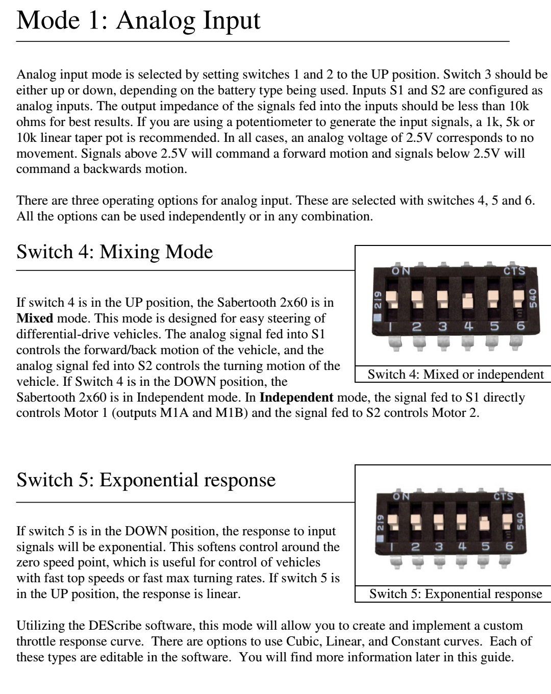

    Take a clear photo of the dip switches on your sabertooths.
    It looks like you have dip no4 down which explains the erratical motion. Set it like this:
    Thanos
  3. SeatTime
    2,572
    Sorry, but I have to disagree @Thanos, Switch 4 must be down, or you will be mixing the signals - which you don't want to do and also the motor outputs polarities will also be required to be different ( switch 4 must also reverse one of the signal inputs o_O) - I do have a running system ;).

    You are right... their manual is confusing...
    5 should be down as well

    3. My current dip switch settings are up, up, up, down, up, up. I can try setting #5 down, but I think that won't address the bigger problem, which is that the motors do not seem to be seeing any control from the Sabertooths.

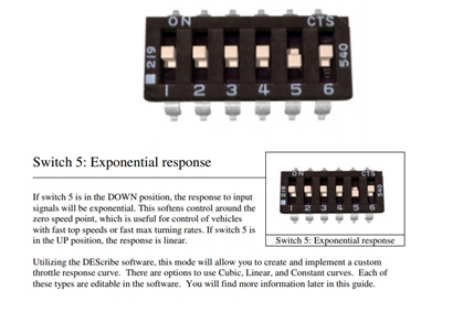

    The sabertooth manual says for switch 5
    Switch 5: Exponential response
    If switch 5 is in the DOWN position, the response to input
    signals will be exponential. This softens control around the
    zero speed point
    , which is useful for control of vehicles
    with fast top speeds or fast max turning rates. If switch 5 is
    in the UP position, the response is linear.
    The softening of the control around the zero point is not what you want in a simulator (maybe OK for steering a car etc). I have tried both of course just to be sure and found that the manual is correct therefore linear is the better selection for a sim.
    Not trying to make you look bad or anything @Thanos and I do love the 1280's, but I know you don't have working sabertooths to try this out. So much easier to test all this in a working sim :).
    Unfortunately @Squonk , this won't really help your current situation.

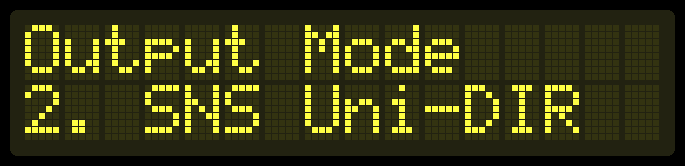

    Can you verify you set the output as unidirectional?

    Thanks, Thanos. Yes, it is set to unidirectional. I posted a photo of all the display screens above, but it's probably hard to see. I was thinking this morning, that maybe it's as simple as having the outputs to the Sabertooths plugged in in the wrong order on the controller board, as I don't recall seeing any silk screened numbers on the board. That's a long shot, and I'm not particularly hopeful, but I'll give it a shot when I get home this evening.
