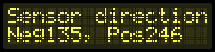

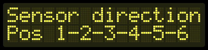

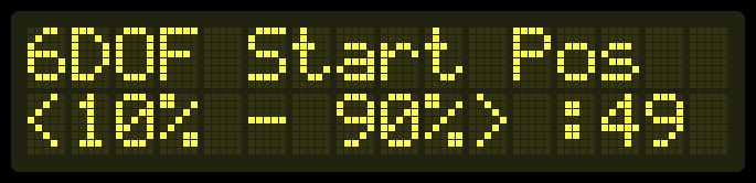

    Just to answer a few of the above... the numbers 03 to 95 are Percents not actual positions (03% and 95%). No need to have to display the whole numeric value that is 4 characters, 1024 for 10bit or 4096 for 12bit.
    The Sensor direction setting shows which of the six sensors will be negative reading or positive reading direction. The direction is changed in software as many sensors output analog voltage that cannot be reversed mechanically. So after expanding the Sensor Direction parameter it means:
    POS135, NEG246 = Positive direction Sensor1 Sensor3 Sensor5, Negative direction Sensor2 Sensor4 Sensor6
    There is not much space on the LCD for otherwise fitting this setting ;)
    Again, in many locations I use percent as representation as for example on the 6DOF Start Position (Home position of the motors when offline). Again, if you change the value with the menu encoder, it will give you 255 steps to change it. I could use 65535 steps to change it but then you would have to make countless turns on the menu encoder to set it to the exact value you want, so I use a percent approximation.
