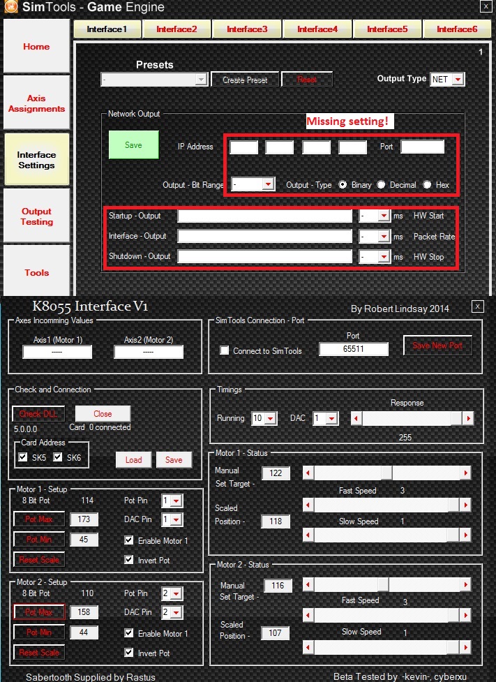

  7. eaorobbie
    20,507Coins
    +1,687 / 23 / -2
    Nearly there guys , just cleaning it up.
    And waiting test results before releasing the final product:
    Spoiler alert:
    Just need prettying up and final checks , but working on my PC, Both motors.:nerd

  13. eaorobbie
    20,507Coins
    +1,687 / 23 / -2
    This is great news could not have done it with out the support of you guys (@Rastus , @-kevin- , @FurloSim , @billo2404 , @cyberxu, this is what makes this community N01 in DIY Simulators.
    So V1 of the app will be released in the resource section soon, with some proper instructions of setting up and usage for manual testing and game testing.
    V2 will come shortly which has a more user friendly GUI and is built for multithreading, brings it in line,
    plus obtains the super cool carbon fibre look too.
    Sneek Peek V2
    We can happy say now K8055 simulators ARE supported in SimTools.
    Thanks guys.

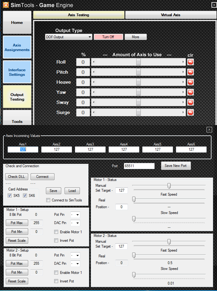

  19. cyberxu
    cyberxu Member
    Nov 22, 2012
    65
    AME Planner
    Ontario, Canada
    522Coins
    +31 / 0 / -0
    2DOF, 3DOF, DC motor, Arduino
    HI Robbie,
    I finally got a chance to try the V2 you send me. I have to start all over...I broke my Pots and now when I started up my Simtool engine, noticed the interface 1 setting are all gone...I try to remember what the output setting and ip setting were.. Would you have happen to have a screenshot of it. I can't believe I lost every thing after a vacation.
    Cyberxu
  20. cyberxu
    cyberxu Member
    Nov 22, 2012
    65
    AME Planner
    Ontario, Canada
    522Coins
    +31 / 0 / -0
    Robbie,
    Here is my screenshot after I setting my pots in neutral position. as soon as I check the connect to simtool box, it went haywire. Could you take a look what have I done wrong or miss? I have patched my FS9 profile no problem. Simtool manager showed connected(green).
    Cyberxu.
