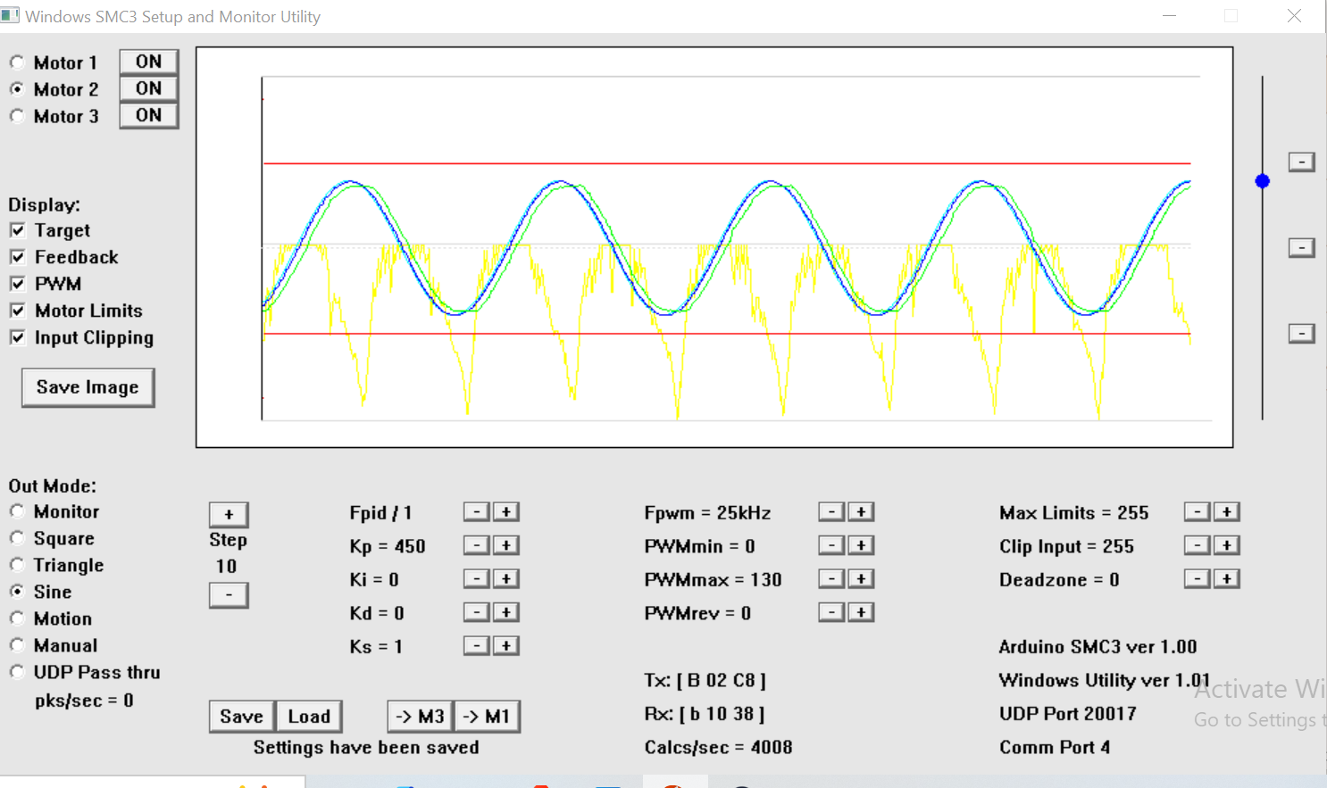

    Long story short, reversing the +- wires for motor 1 fixed it. Or at least they both work now. Screenshot 2025-07-27 155024.png Screenshot 2025-07-27 150643.png
    That was frustrating. Though I do think I had some bad hardware at the beginning.

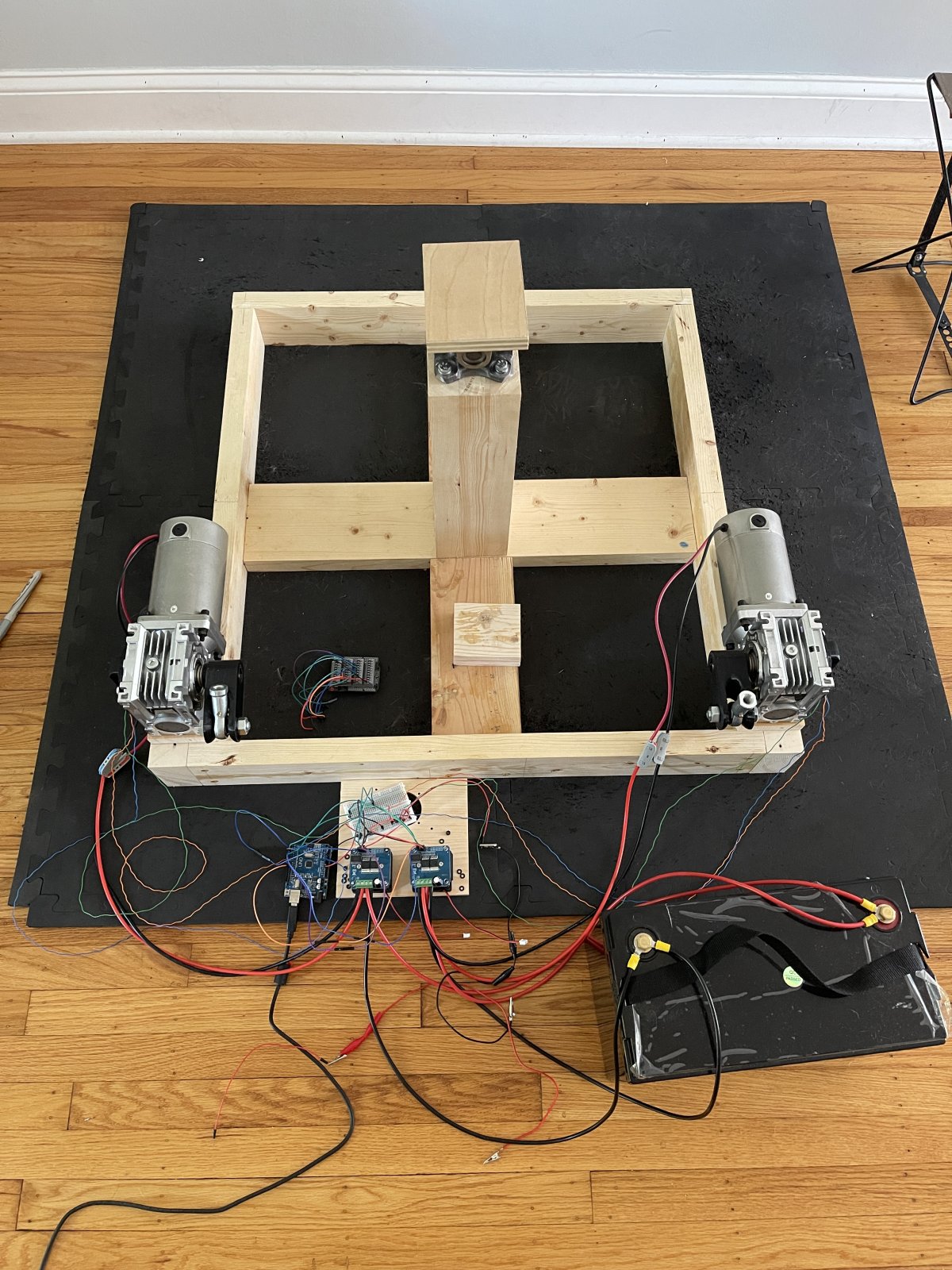

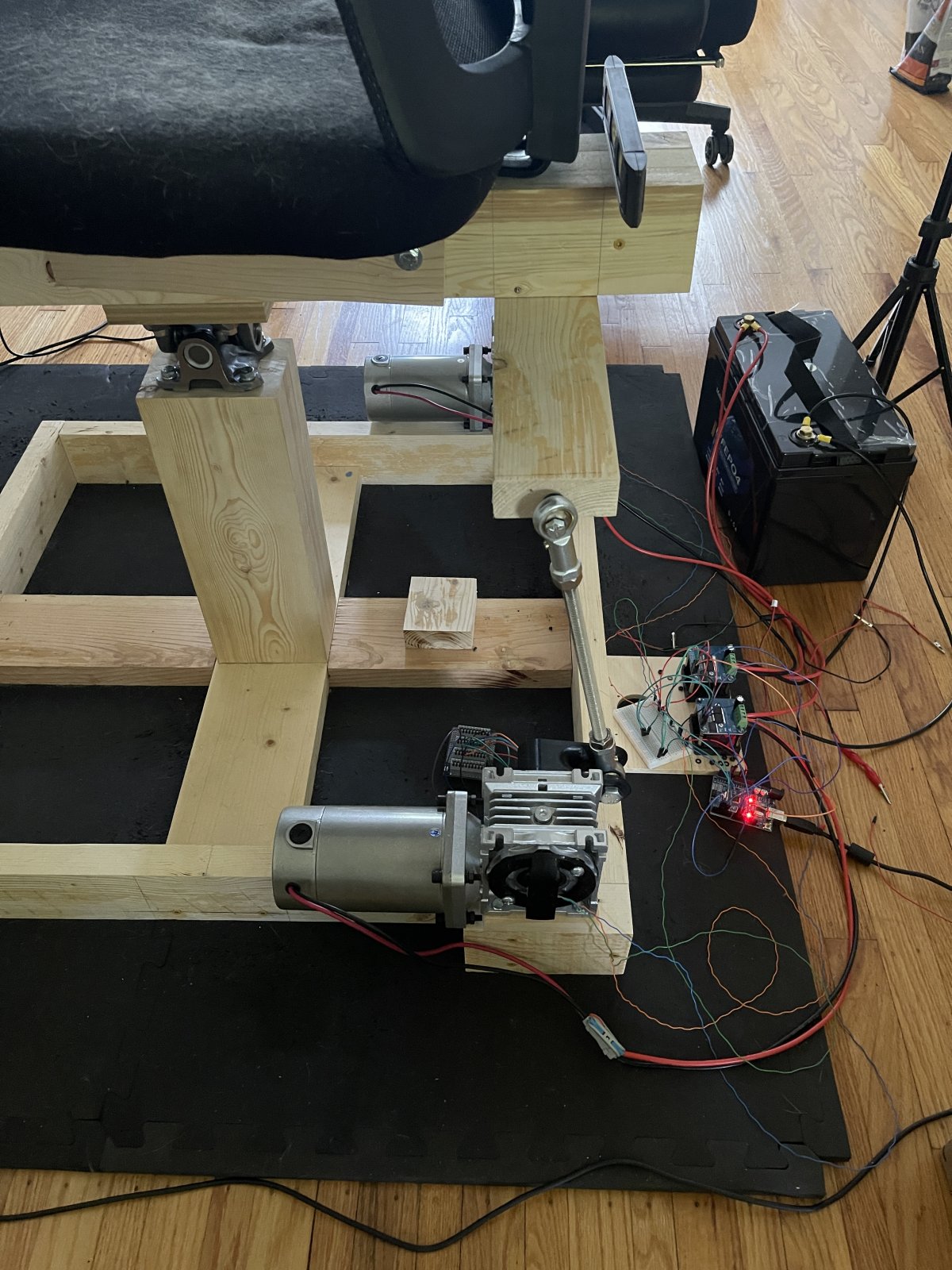

    IMG_6305.JPG IMG_6311.JPG IMG_6312.JPG Very exciting progress, despite many knucklehead errors. Question about SMC3Utils, Max Limits, Clip Input and range of motion. I had been believing that I could/would be limiting my range of motion to 45 degrees up and down, and designed my CTC levers(2.5 inch) with that in mind. 3D printed and they actually hold me, pretty cool. But, I was fooling with manual mode and the limits imposed by having Max Limits and Clip Input set to 255 will let the lever move to almost 90 degrees off "zero", that's fine going up, but on the down stroke, will definitely bend a rod or break a lever. Is there another way to impose a tighter limit? Or will that be a function in FlyPT Mover? Or am I not doing any of this right?
    22,228
    154,837Coins
    +11,227 / 57 / -2
    The SMC3 settings explanations are in the second post, including for adjusting Max Limits and Clip Input: https://www.xsimulator.net/communit...driver-and-windows-utilities.4957/#post-48121
    Clip Input Used to create a band at either limit of the target range beyond which any values sent to the SMC3 are clipped. In addition to this clipping, if the motor feedback does move beyond this range (typically through inertia), the SMC3 will attempt to brake the motors hard by driving them in reverse until they are back out of this limit zone. The value can be anything from 0-255 (however can’t be less than the current limit setting). Reverse braking is applied in the band between the Clip Input and the Max Limit settings. Reverse braking can be disabled - refer to PWMrev.
    Max Limits Used to create a band at either limit of the feedback range beyond which if the motors move (typically through inertia) the SMC3 will automatically shutdown the drivers and keep them disabled until reset. This is essentially a safety mechanism if something goes wrong. The value can be between 0-255 (however can’t be greater than the current clip setting).

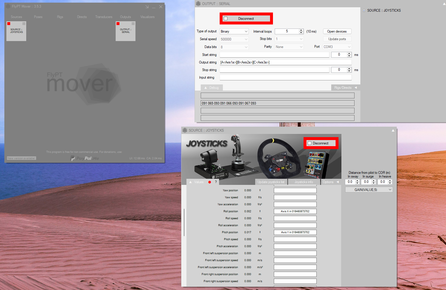

    Just trying to get the rig to move via joystick. As far as I can glean from reading the threads and the FlyPT Mover website, this setup should produce some result. Any input from someone with FlyPT experience would be appreciated.
    Things i know: I'm using Mover 3.5.3 The software is definitely getting inputs from the joystick. When the output is connected, the motors make a little noise, I cannot then open SMC3Utils without getting an error, so at least Mover is tying up that port. And that is it. No Movement. Send Help

    Well sounds like there is not enough power going to the motors. I don’t use FlyPT. Maybe there is a gain factor in flyPT you can adjust.
    It’s possible that Kp or Max PWM are set too low. Try bumping kp up as high as you can without uncontrolled vibrations and see of that helps.
    If you have a second computer I suspect you can set up an Ethernet connection. This allows you to put SMCUtils in pass through mode so you can see what is coming in and the result on your rig. This is described in the first page of the SMC thread. Technically you should be able to set that up using localhost. Especially since there is no game involved.

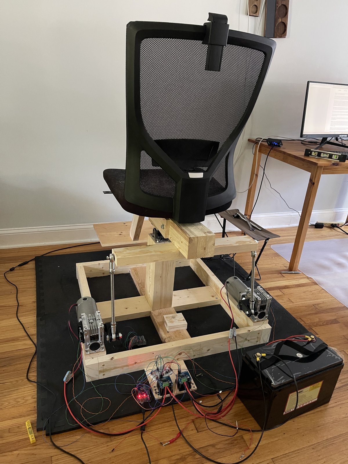

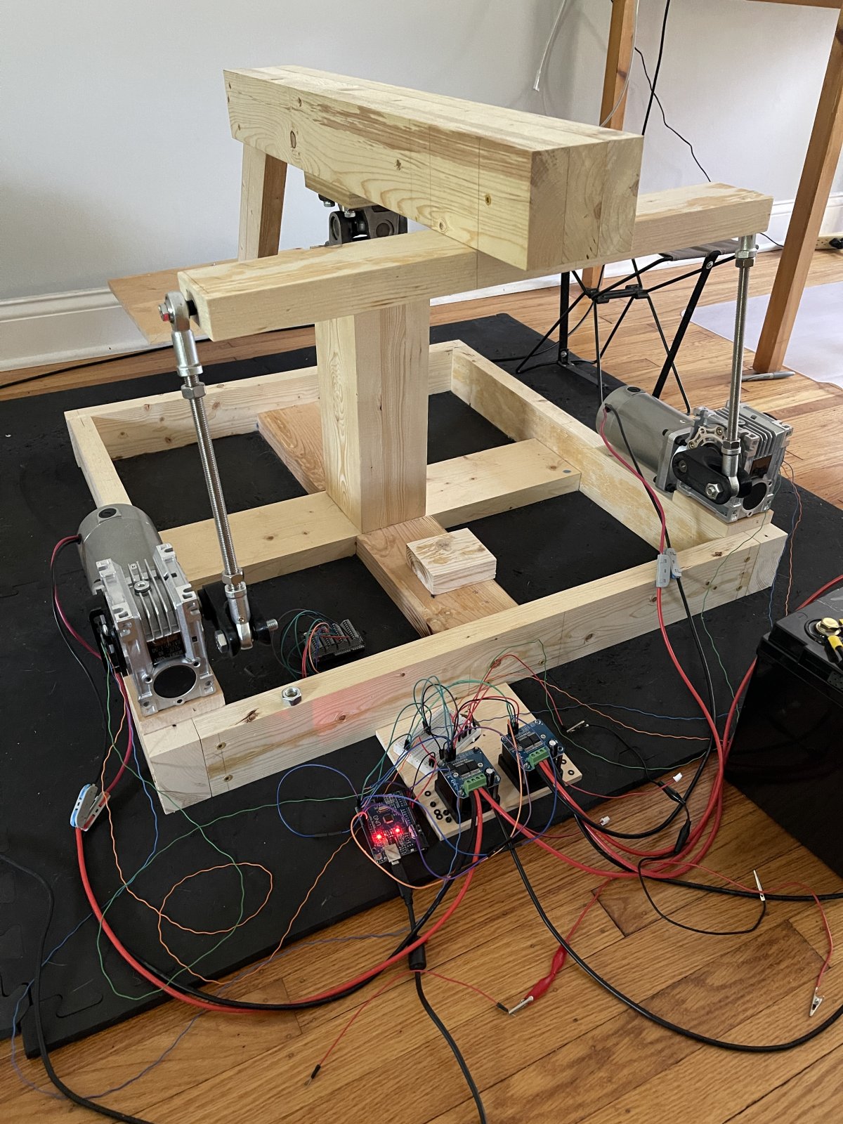

    Now I have something of a geometry issue. I'm not getting near the range of motion I was hoping for, about 7-10 degrees. I'm 3 in pitch and 1.5 in roll. The roll is limited because if you're at full pitch and then go full roll, the lever and rod would bind. This is probably large due to the way I made my CTC levers with a fork style connection. Bear in mind the 3d printed levers were never meant to be the final state, just an easy temporary solution, but even when I get metal ones fabricated I think the fork style is more balanced. So, my thinking is to move the upper rod connection point back to the end of the seat, that should allow for a bigger range of motion, and the Mover software seems to allow for it. Is that the right move, or am I thinking wrong?
