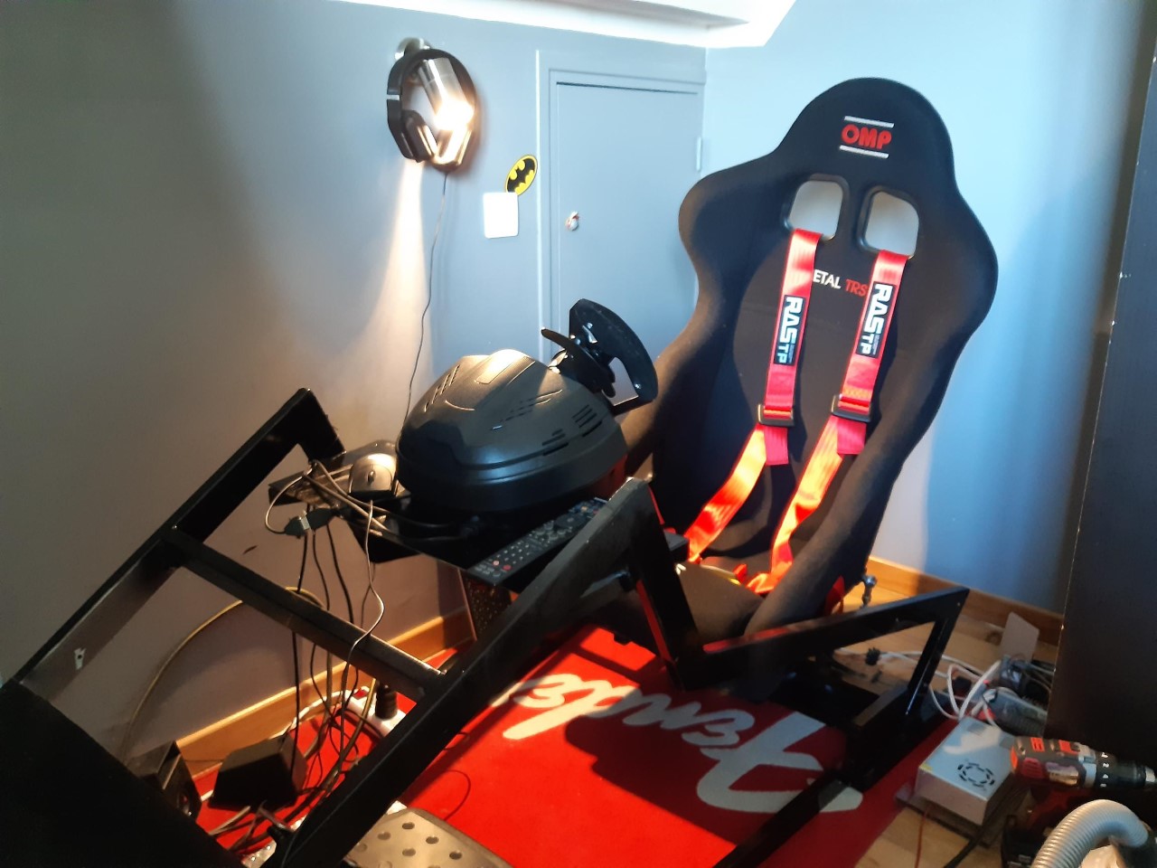

  20. Kenshiro27
    Kenshiro27 Active Member
    Apr 16, 2021
    199
    253Coins
    +81 / 1 / -0
    2DOF, 3DOF, Arduino
    While waiting to solve my computer problems I installed the seat and the belt this morning.We are slowly getting closer to the starting plan / drawing
