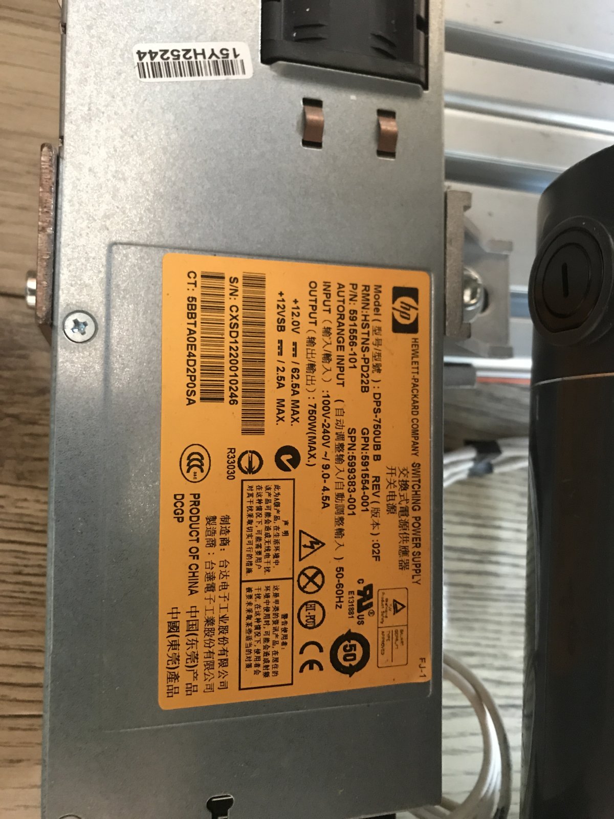

    nice job ..can you tell me the name of the power supply and the motor ... i use car wipermotor with pc power supply butits not good it cant hold the weight

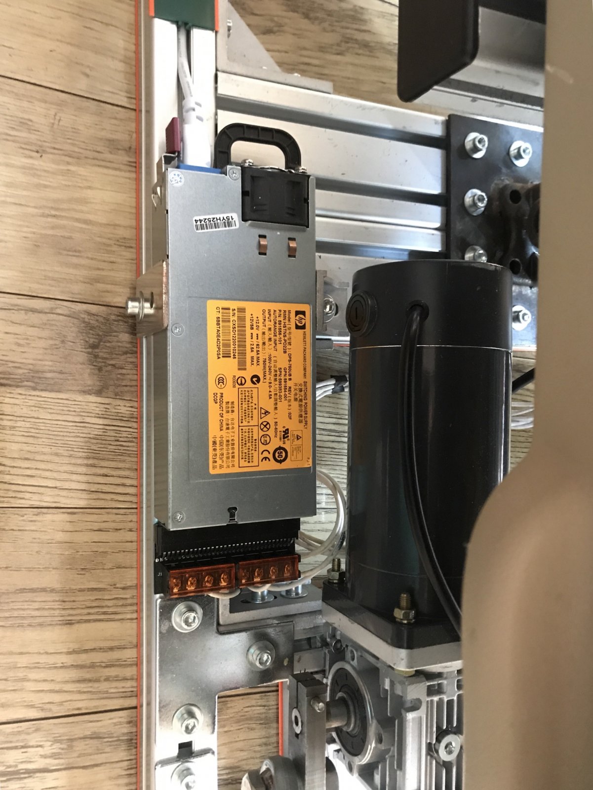

    The previous power supply has been eliminated, and now I use this power supply: HP 750W60A server power supply.
    The electrode uses a "12V200W" turbo worm geared motor with a speed of 1800, a reduction ratio of 30, and 60 rpm.
    If 40 revolutions per minute, there is more torque.
    I'm outside, go back and take pictures for you.

    what is the name of the motor....how much can the motor take weight.. it can get around 200kg?!

    [QUOTE =“ absyfadhel1,post:197001,member:27614”]what is the name of the motor....how much can the motor take weight.. it can get around 200kg?![/ QUOTE]
    200W motor should be able to bear 200kg weight. Mainly depends on the motor output radius and the reduction ratio, which will affect the motor torque.
