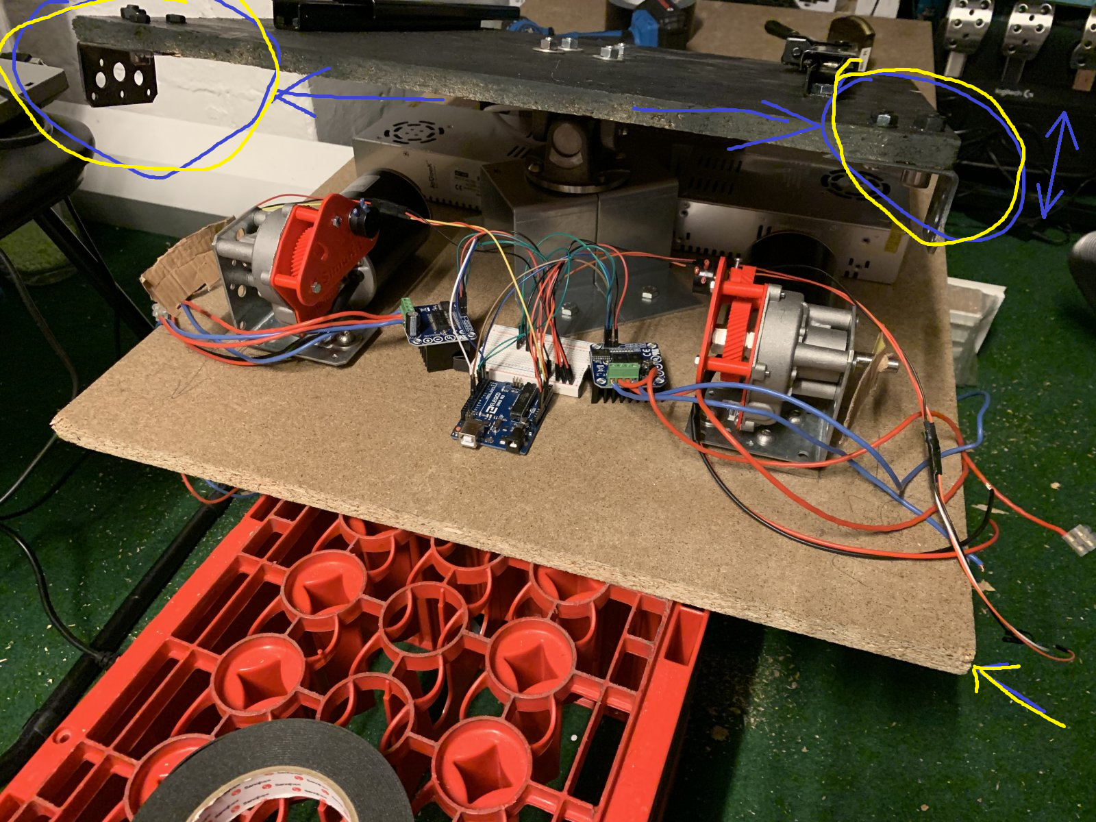

    I had a bad thought seeing how my glued veneer flexes and this is glued saw dust, so I think it will most likely brake on impact... I hope not but be aware of possibility :nerd
    21,629
    151,431Coins
    +11,038 / 56 / -2

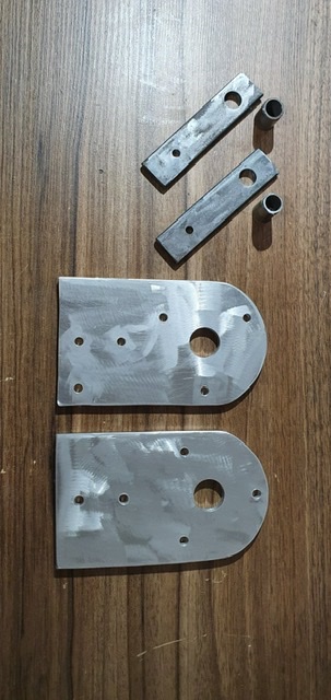

    If there is flex then it will be negatively impacting on the quality of the motion cues.
  3. dieser
    dieser Member
    Jan 20, 2020
    54
    372Coins
    +12 / 0 / -0
    do both of you mean the motorbrackets or the u-joint mount?
    both are 3mm thick steel.
    seemed ok with 12v motors before...
    i will take a look on them and maybe searching for another solution...
    thanks!

    Noorbeast was about brackets and I am talking about material, Im not sure how long it withstand push/pull without cracking, I know for you it's seat mover so there is less stress, but monitor condition of platform. - cracks
    There is usually lots of flex with wood/plywood e.t.c Wood makes noise before cracking but yours might just crack since motors are strong.

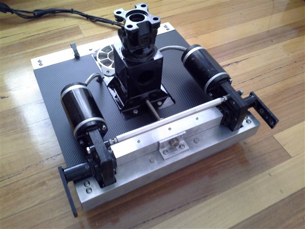

    @noorbeast @Rifly
    i already thought about changing materials in the future to aluminium profiles like this:
    4A1281FF-CAF2-43BC-85DD-2AACA4F2ED92.jpeg A61CFCC7-729C-4F53-B981-8F67F7D9B2FD.jpeg
    (found it on the internet. source:
    http://projectable.me/my-sim-racing-motion-rig-version-2/
    i have no experience with aluminium profiles, but many people using it to build racing rigs...
    but also a flexible material...
    is it a better option for the forces of a motionsim?

    you should reinforce all your brackets and supports, because it will twist when it moves, I have 5 mm steel brackets and I doubled them ...

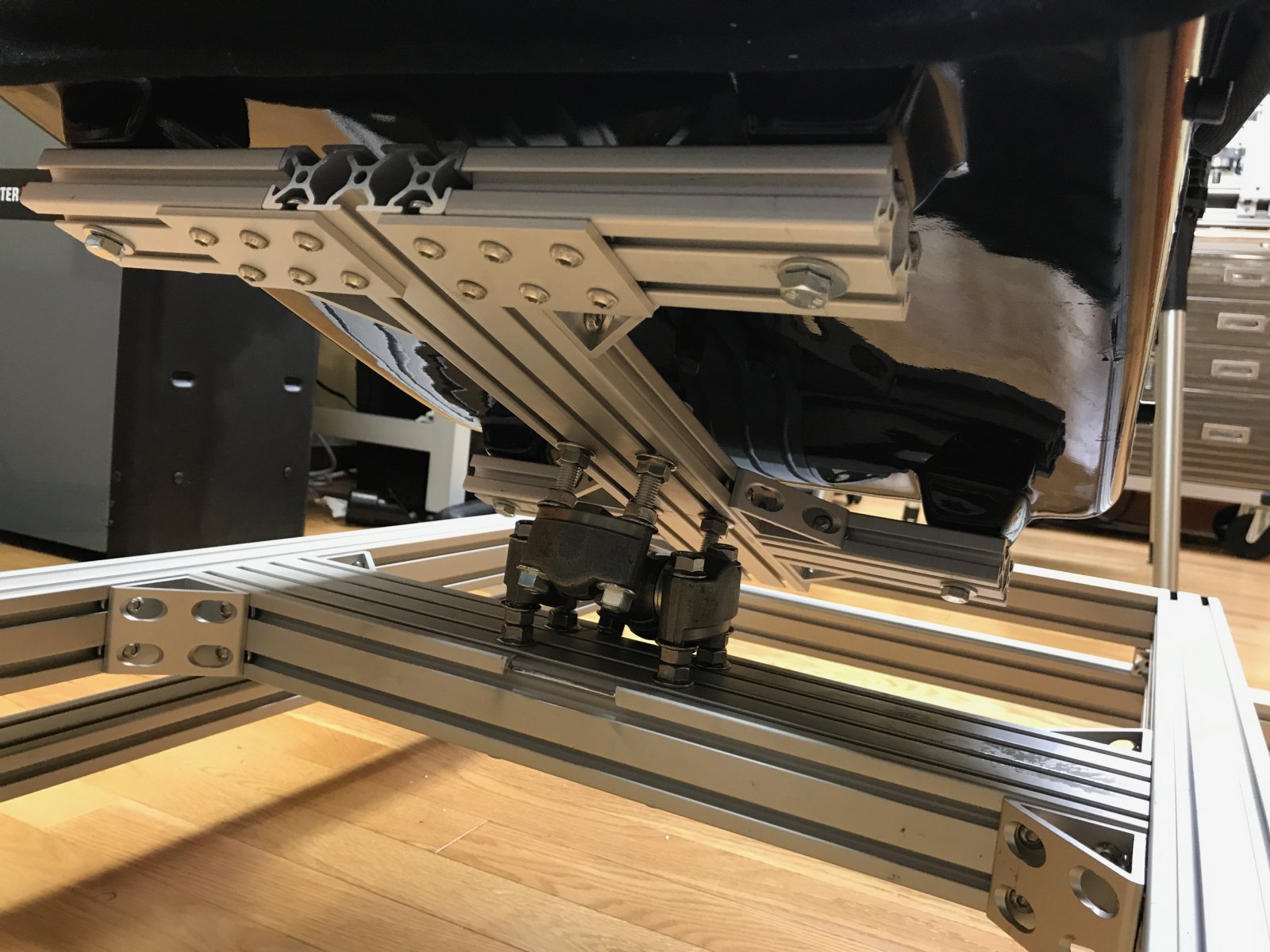

    of course you guys were right and there is to much flex in the build... :rolleyes:
    uncomfortable and unprecise to drive.
    i will change the frame again!
    ordered 40/40 aluminium item profiles now to build a rig and plan to mount the motors on brackets like this
    : 2A6AC234-D565-4EFD-9515-129FABC70BFD.jpeg
    ( found on this forum. build by @Santrovitsch )
    will 5mm aluminium do the job here?
    or should i use steel?
    while i disambled everything i also considered to set the motor position under my knees like f.e. dofreality does.
    is there any advantage doing this?
    greets
