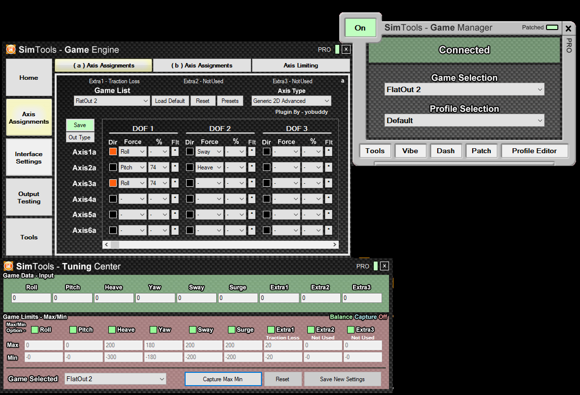

    I own the full game (from GOG) and the plugin just doesn't work.. any idea why ? thanks in advance.
  4. oren ben jacob
    oren ben jacob New Member Gold Contributor
    Jan 20, 2020
    - 39Coins
    I didn't find a way to edit my message so I will just add that I have also the Steam version, and the demo.. all doesn't seem to work :(
    22,202
    154,675Coins
    +11,209 / 57 / -2
    You need to provide way more information.
    Is there telemetry data in the Tuning Center?
    Did the game patch ok and does the game show as connected (top right colored box) in Game Manager when Flatout 2 is running?
  6. oren ben jacob
    Jan 20, 2020
    - 39Coins

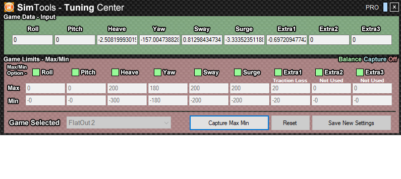

    It does show as connected and it seem to be patched ok yes. I started a game, drived a bit and minimized the game and see numbers are running in the tunig center dame data input.. here's pictures I took:
    22,202
    154,675Coins
    +11,209 / 57 / -2
    It is working fine, but you need to refine your motion profile, in particular capture Max/Min values in the Tuning Center, as the defaults are way too big, see here for tips: https://www.xsimulator.net/community/faq/steps-to-create-a-motion-profile.228/
  8. KydDynoMyte
    KydDynoMyte Fool's Gold Contributor
    Sep 5, 2011
    114
    RTP, NC
    40Coins
    +28 / 2 / -0
    The motion profile defaults might not be too bad. Using only forces (pitch & roll) in axis assignments that the plugin doesn't provide seems to be the problem here.
    22,202
    154,675Coins
    +11,209 / 57 / -2
    Following the tips in the link provided will correct both the Axis Allocations and Tuning Center values, as both are way off.
