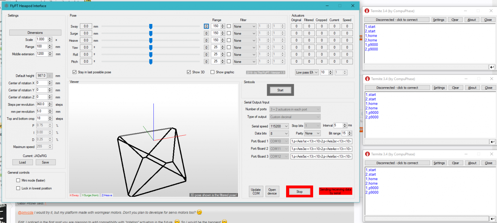

    Hi @pmvcda
    Thanks for making this interface free to us.
    Love your work.
    Ive just completed my build and have achieved basic motions with Simtools.
    Im running sabertooth 2x60 and the kangaroo controller's.
    Now Im ready to be a tester for the serial output with your interface.

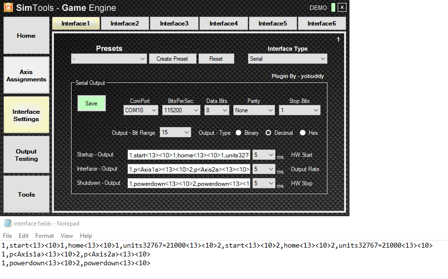

    Hope Im not been too forward straight of the bat like this, but I have a feature request.
    I think I need the startup and shutdown lines just like Simtools.
    For now, I can get by using a separate terminal program to manually go though those steps.
    Could you look at the below and check what I have done. I can't get the serial output to command the controllers at the moment.
    I can get Simtools to connect to your interface, so this side is no problem. Its just the output to serial that seems to be not working for me.
    Below is the startup and shutdown serial commands when outputting direct from Simtools as an example.
    This has proven to work for me so so I have used this exact string in the serial output field in your interface.
    In the below screenshot, I have displayed on the right side the terminal windows to manually type in commands to the controllers. These show that each has been started, homed and centred
    And then I have disconnected each com port in the terminal window before clicking start in the output section of the hexapod interface.
    So at this moment, I dont get any movement.
    I reckon the controllers are OK to receive commands, because I can turn off the hexapod interface, re-connect each terminal again (without re-start or re-home) and type position commands successfully.
    So I think I have something wrong in the output parameters of the interface.
    Would you pls look over and see if you spot the error?
    Thanks.

    Posted on your thread...
    There's a problem with <#> values. It's corrected in version 1.6.3
    Give me 5 minutes to post the new version.
    Download will be at the interface thread. Here: https://www.xsimulator.net/communit...face-for-linear-and-rotating-actuators.12859/

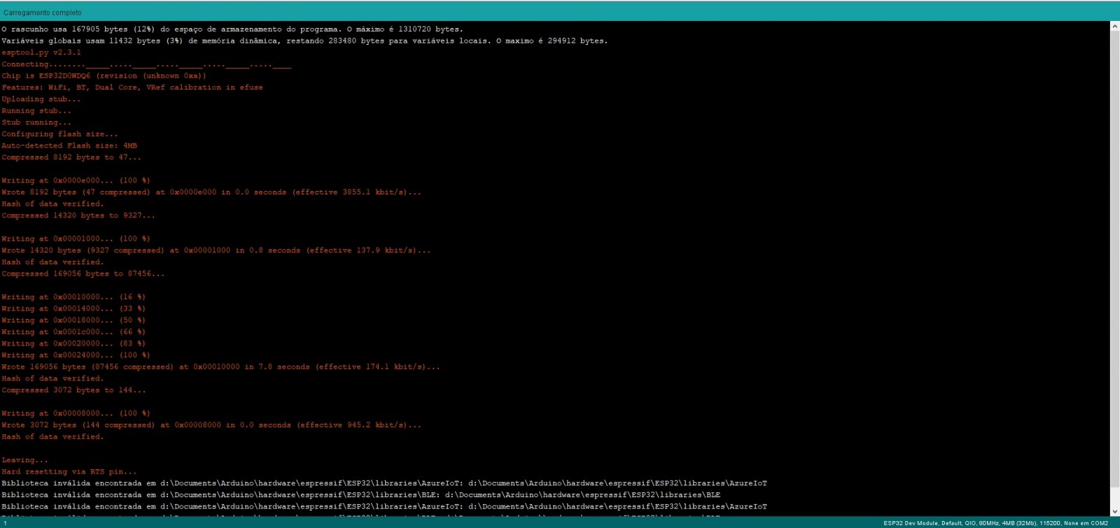

    It was brought to my attention that the code I'm sharing is not compiling on the latest ESP toll from GITHUB.
    So, please use ESP tool 2.3.1 to compile the code:
    I also updated the ESP32 code on the first page of this topic.

    Updated the ESP32 code. (In the first page of this thread)
    After searching for the reason why the ESP32 keeps rebooting with the latest ESP tool for Arduino, it seems the problem is with the loop in the second core.
    I don't give it a chance to run the interrupts, so it crashed and restarted.
    Well, something like that, because I didn't look deep enough to understand the problem.
    Solution was to add a delay in the loop :confused:
    I'm now able to run the code with the latest version of the ESP tool.
    Installing the ESP tool is now easier, just follow this video:
