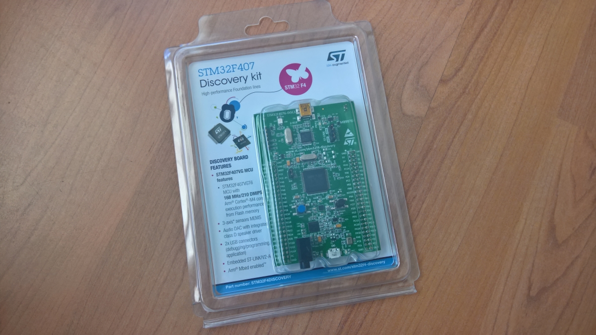

    Just received this on the mail:
    Expect some changes soon.
    Not only in hardware, but also on the interface... ;)

    Is that for an all in one controller of some sort ?

    Well, the idea is to replace both ESP32. That way, I can calculate speed on the board instead of the interface.
    After testing a new code, with speed calculation on the ESP32 boards, everything seems smoother, but since there's no connection between both boards, I can't calculate speed as I wished.
    It's possible to connect both, but I'm feeling lazy for that, and the STM32 opens new opportunities.
    I might add wind and if possible seat flaps (at the speed I implement things, it will take some time...). Let's see what is available after controlling the hexapod.

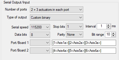

    // DIY 6DOF Motion Sim by FlyPT
    // SimTools2 ESP32 code to control actuators
    // Actuators use brushless motors controlled by BLDC8015A drivers
    // Position is obtained from internall hall sensors
    // This code is made to handle 3 actuators in one board and also made to support 6 in two boards.
    // This code uses the FlyPT Hexapod Interface in standard serial mode without receiving speed or sending current position.
    // It just receives position and everything will be handled internally.
    // So, it's also possible to use this directly with Simtools.
    // Current: Version 7 from 11/02/2019
    // SimTools2 configuration should be:
    // Interface settings:
    // Interface Type: Serial
    // ComPort: The one used by your ESP32
    // BitsPerSec: 115200 (You can change the define to use another speed)
    // Data Bits: 8
    // Parity: None
    // Stop Bits: 1
    // Output - Bit Range: 10
    // Output - Type: Binary
    // Startup - Output: -
    // HW Start: -
    // Interface output for board 1: [1<Axis1a>][2<Axis2a>][3<Axis3a>]
    // Interface output for board 2: [4<Axis4a>][5<Axis5a>][6<Axis6a>]
    // Output Rate: 10ms
    // Shutdown - Output: -
    // HW Stop: -

    This code works like using SMC.
    We just send the pretended position of the actuator and PID is handled on the ESP boards.
    Serial settings on the interface/Simtools, should be:
    I will add this solution on the first page of the thread when I can.

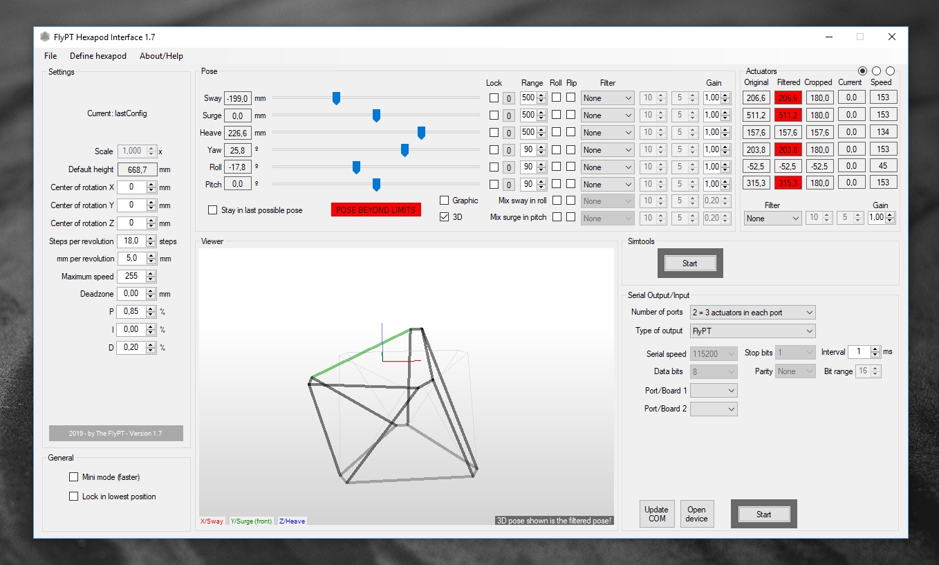

    My total mechanical travel is 450 mm.
    But I loose near 35 mm on top and bottom before activating the switches (could be less).
    Since we don't want to activate switches, I remove around 5 mm top and bottom (by software).
    So total travel is 370 mm or 185 mm to each side, from the middle.
    Until now, I only used it for cars, but I would say that:
    -For racing games I use small travels and more aggressive movements.
    -For air planes, longer travels and softer movements.
    Having more travel available is better, but cost increases.
    When we compose all movements to produce a pose, you reach limits really fast.
    While Yaw can be near 80º departing from middle position on all actuators, it might be reduced to 10º when you have sway + heave + pitch...
    You can test it with the interface I made. (https://www.xsimulator.net/communit...face-for-linear-and-rotating-actuators.12859/)
    -Select linear actuators
    -Put the dimensions (there's actuator range in there, but you need others)
    -On the main screen, use big pose ranges to let actuators reach range limit
    -Uncheck the "Stay in last possible pose" to see the 3D view moving
    -Now try to move the sliders.
    If you receive the "POSE BEYOND LIMITS" message, it's because we are requesting an actuator position beyond the range we have.
    Look at actuators output and you can see in red the actuators that go beyond the range (in the picture, range was 180 mm).

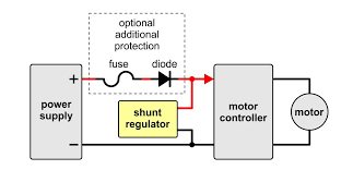

    DC motor, 6DOF
    Hi ,
    Need more info of your problem you had !!!
    On my Rig , now that I have more load with all stuff on it , some drive give me some faults ( red light on my drive) because I have a lot EMF or regeneration problem ! MY QUESTION IS : Can I do the same thing as you ( diode) or I must put a shunt regulator ?
    Thanks!
    Info that I found from Advanced Motion compagny ;
    During motor deceleration or a downward motion of the motor load, conversion of the system’s mechanical
    energy (kinetic and potential) will be regenerated via the servo amplifier back onto the supply in the form of
    electrical energy.
    This regenerative process can charge the capacitors in the power supply to potentially dangerous voltages
    or voltages that may cause an amplifier over-voltage shutdown. Consequently, power supplies should have
    sufficient capacitance to absorb this energy without causing an over-voltage fault. If it is not practical to
    supply enough capacitance, use of a "shunt regulator" may be necessary to dissipate the kinetic and
    potential energy of the load. The shunt regulator is connected to the DC power supply to monitor the
    voltage. When a preset trip voltage is reached, a power resistor R is connected across the DC power
    supply by the shunt regulator circuit to discharge the power supply capacitor. The electric energy, stored in
    the capacitor, is thereby transformed into heat (I2R).
    web info from Advanced Motion ( see section Regeneration) :
    We have a application note 009 that works you through diagnosing a red LED. https://info.a-m-c.com/acton/attachment/33817/f-0035/0/-/-/-/-/AMC_AppNote_009.pdf

    Idea is to put one between motor and controller. Don't know what is going to happen... They will heat up, but not as much as the single one I have.
    The best solution is to use the batteries, but expensive.

    Yes , Batterie will be expensive too for me ! I wil buy one of those SRST80 and see what happen if it good or no for my case .
    I send you this info from (Advanced Motion ) who tell this :
    Hello Eric,
    If your issues are happening during regeneration I would recommend using a shunt regulator. You can place a fuse in the DC mains, but in general we do not recommend a diode in series with it. The fuse should be a slow blow fuse rated for the max power of the lowest power device in the system (power supply, drive, or motor). For the diode we don’t recommend it because it would first need to be a giant diode to handle up to 1.2KW continuous, and also it is going to effectively cut off the power supply capacitance from the drive capacitance during regeneration, causing an unclamped voltage to rise faster.
    For a shunt regulator that clamps at 80VDC please take a look at the SRST80 which can dissipate up to 95W.
    https://www.a-m-c.com/products/?page=product&id=SRST80
  16. BlazinH
