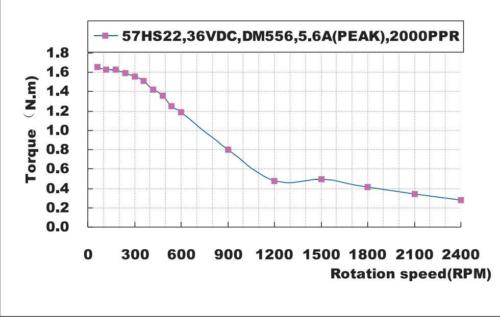

    Hi @pmvcda , I really admire your work and efforts you showed.
    First of all I have to say, I have no experience on this kind of projects before. And by the help of your previous descriptions, I want to build my own FLIGHT Sim at home.
    So my questions may come to you really basic and stupid. Sorry for my ignorance in advance. :)
    At first, I would like to build a sim with esp32 +nema23- 3A-2.2Nm+ tb6600 drivers which are easy to find + and LRS-350 Meanwell 36V 9.7A power supplies (cheaper ones)
    Is that possible to make it with those tools above by using your codes?
    Many thanks in advance for your attention.
    Looking forward to hearing from you soon. :)
  8. pmvcda
    pmvcda aka FlyPT
    Nov 3, 2010
    2,237
    Portugal
    15,702Coins
    +2,674 / 17 / -0
    Hi, welcome to the forum!
    What you have there, is stepper motors.
    It's completely different from the BLDC (BL from brush less and DC for continuous current) motors I use.
    Right away, I would say that those motors are not good for this kind of application.
    They have a good torque, but at low speeds. Look at the graphic:
    A stepper motor similar to what you have (https://www.ebay.co.uk/itm/Leadshin...699596?hash=item3d1dd7fe0c:g:610AAOSwBPNXRpq~).
    I know it might be heavy, but take a look at this paper: https://core.ac.uk/download/pdf/147045512.pdf
    It's a comparison of different types of motors. You can go straight to the end and see the conclusions.
    I choose the BLDC for the following reasons:
    -Speed
    -Smaller in size for the same specs compared to brushed DC motors
    -Durability, because brushes although replaceable, have a limited lifetime, specially in this type of application where we are constantly changing speed and direction
    -Cheap controller available
    -And, last but not least, easy to control with an Arduino/ESP32, using the internal sensors that most of those motors expose (now I can say this, since I was able to make it work).
    This last item, makes the system cheaper, because you don't need anything more to determine the position of the motor relative to a classic brushed motor.
    I know of people working with scooter BLDC motors, more powerful, but requiring expensive controllers, and better power sources.
    Stepper motors are cheap, the slow speed (they loose steps at higher speeds) makes them more suitable for CNC machines, where we move slowly and need high torques.
    I would recommend you to use the BLDC solution or go with a brushed motor, like most have done in the forum (you get more feedback with this solution and it works).

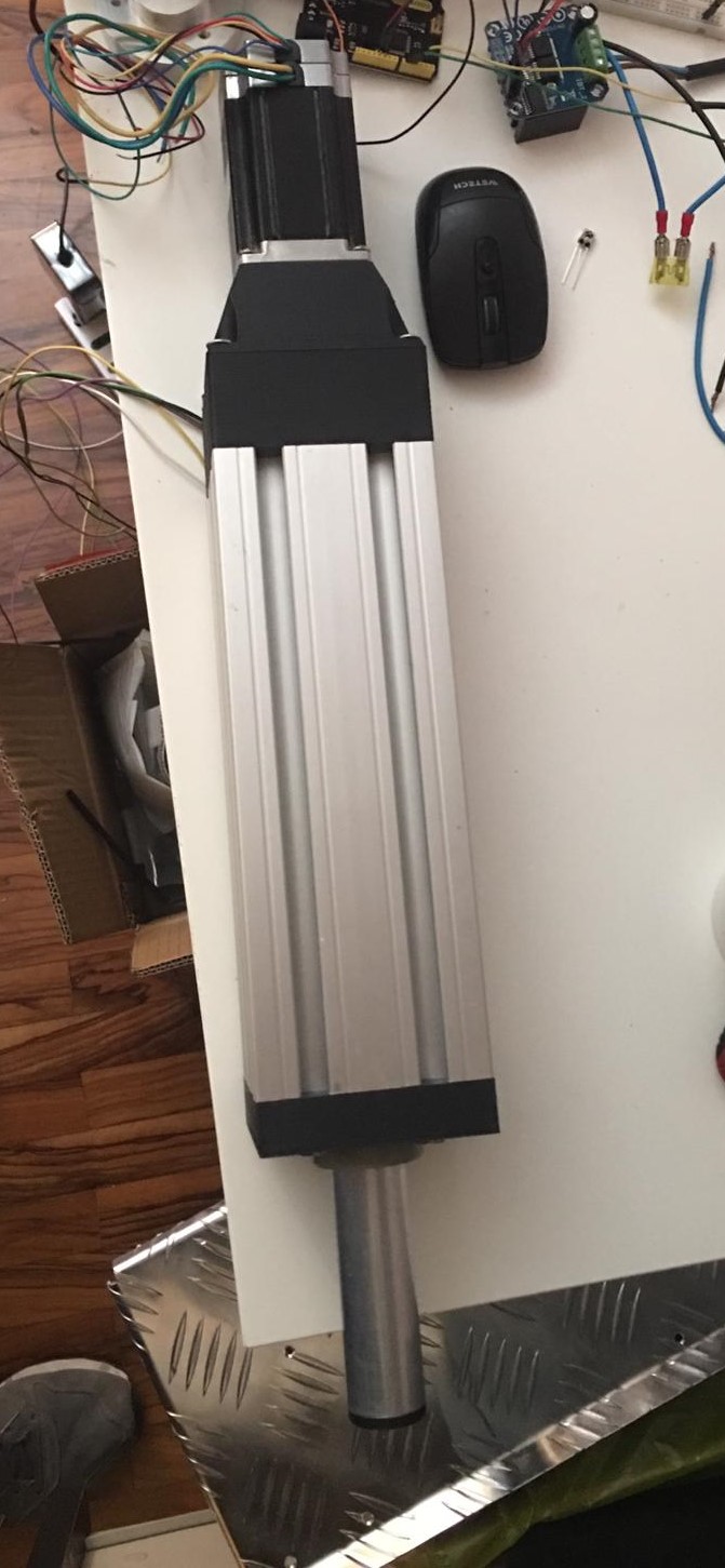

    hello guys, what do you think? I will use them for a driving simulator. just missing the electronics and trying it.
    I accept advice if you see something wrong
  12. pmvcda
    pmvcda aka FlyPT
    Nov 3, 2010
    2,237
    Portugal
    15,702Coins
    +2,674 / 17 / -0
    Is that a 57BLF03?

  14. pmvcda
    pmvcda aka FlyPT
    Nov 3, 2010
    2,237
    Portugal
    15,702Coins
    +2,674 / 17 / -0
    So you can use it with my code and the ESP32.

    Are you making a 4DOF?
  17. luky_90
    luky_90 Member
    Mar 3, 2016
    106
    276Coins
    +16 / 0 / -0
    yes, this is the first piston built the second I will try to take more detailed photos of the construction
