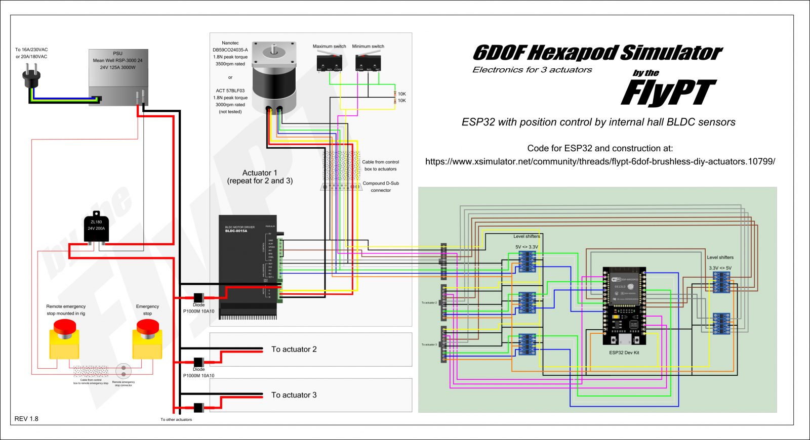

    should I connect only 2 actuators on this scheme I can do it?
    can someone help me?
  4. pmvcda
    pmvcda aka FlyPT
    Nov 3, 2010
    2,272
    Portugal
    15,902Coins
    +2,716 / 18 / -0
    Yes, you can.
    Just ignore the wiring for the third one, or don't connect the actuator.

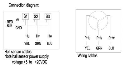

    hi guys, my engine has wires with different colors do you help me?
    for the signal it has:
    black will be connected to black
    green will be connected to green
    blue will be connected to blue
    yellow to which thread of the scheme I connect it?
    red to which thread of the scheme I connect it?
    for the power I have
    blue, green, yellow how do I connect them?
    the problem with the ESP32 seems to be solved thanks

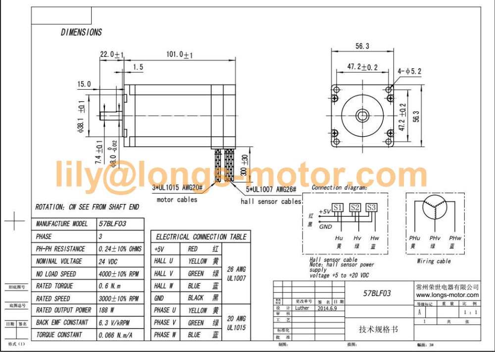

    BLF motor. Hall sensor: red=supply power black=ground, sensor s1,s2,s3=yellow, green, blue. Power phases UVW=yellow, green, blue.

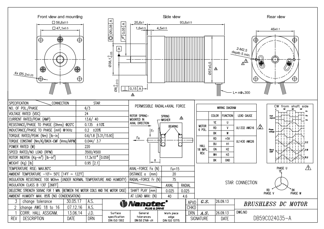

    Your motor:
    My motor in the schematics:
    So I think it's:
    my Hall red = your Hall red
    my Hall blue = your Hall yellow
    my Hall green = your Hall green
    my Hall white = your Hall blue
    my Hall black= your Hall black
    my Current yellow = your Current yellow (phase U)
    my Current red= your Current green (phase V)
    my Current black = your Current blue (phase W)

    Comparing the Nanotec to the Long 57BLF03. the BLF has 8 poles per phase so slower overall speed but the torque constant is 6.6N/cm vs. 4.4 for the Nanotec so technically should have better acceleration?
