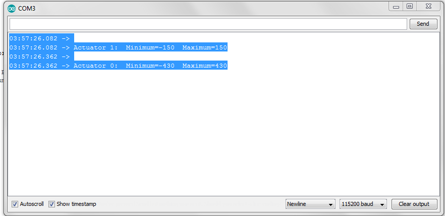

    SUCCESS!!!!!! but I did have to swap the limit pins on actuator 1 and 3 for some reason was really confusing, but I followed the all the diagrams and I now have two working actuators.
    Cant seem to upload video though

    Although I have both actuators moving I have one question, why would the mins/max be different by so much?
    am I missing hall sensor counts somehow??
    I'm using BLDC8015A+57BLF03 motors/drivers
  8. pmvcda
    pmvcda aka FlyPT
    Nov 3, 2010
    2,225
    Portugal
    15,639Coins
    +2,662 / 17 / -0
    Try to swap the actuators.
    0 in 1 and 1 in 0 to see if the counts also swap.
    If they don't, vthen you might have something wrong in the connections. Just swapping one of the hall wires is enough for this difference.

    I think I have a bad hall sensor there's nothing on pin 35 so I get 4,5,1 but not 6,2 and 3 in the sequence

    Could it be a cable or bad connection on the Connector. When you swapped plugs, the error also swapped right?
    If so the problem is in the plug, cable or motor

    Yes the problem followed the cable. I am checking the cable this evening. but I am impressed with the build and your design, very good, once i get this sorted I will attach to you flypt control and see what happens, but yeah thanks I have learnt a lot.

    All working, it was something on the PCB luckily I had made two lol, always have a plan B,

    FYI if the hall sensor pins are swapped U <---->W then the numbers will be swapped
