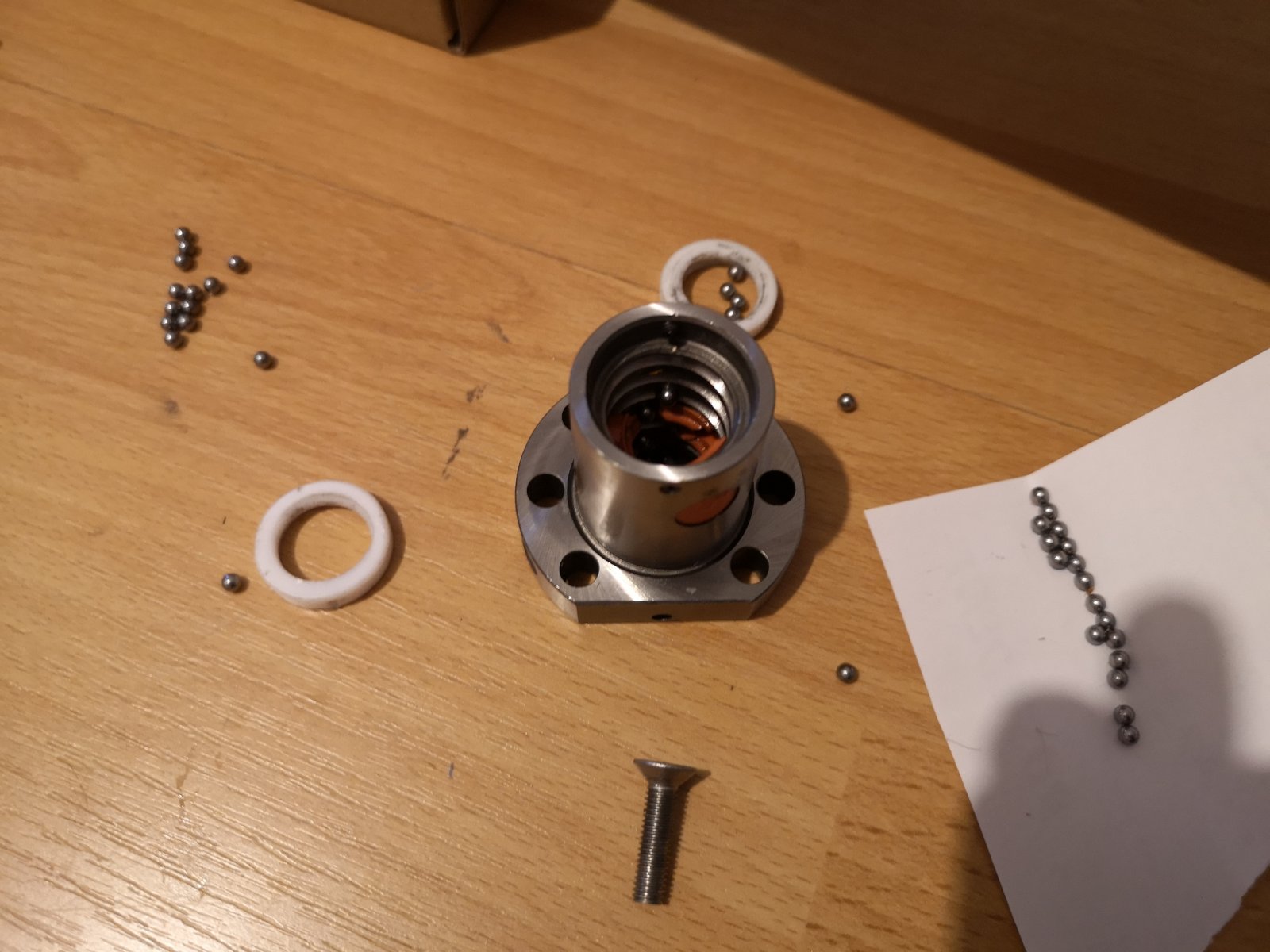

    10bits...there is 10 as default... 15bits and the motor doesn't seem to go crazy... The crawling and searching for the tiny balls can now continue :(

    For the sake of your mental health, Don't try to fix something like this. It is possible and it is working fine, but... just buy a new one.

    Already happen to me!
    Did not want to tell you before you try to repair it. :D

    Just use a little bit of grase to keep them in place, been there done that ;)

    Yep, eventually did that after fiddling around for far too long :mad:
