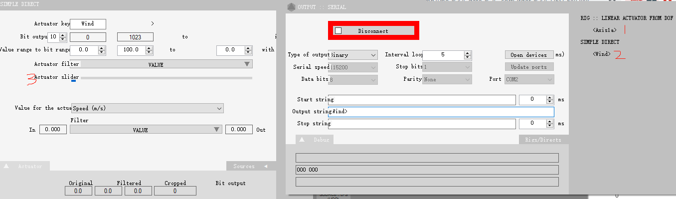

    Would mind tell me where is the mistake during my FlyPT Mover 2.9.5 setting , my problem is the motor almost don't mover although there are some data have sent to them. i use one actuator to operation.
    the situation is i have passed calibration, the the motor stopped when i push the minimum limit switch , but the question is when i send the data from the FlyPT , the motor almost not work . pls check the attachment.
    first, i use the data of Axis1a, the motor move a little . Second, using the simple direct: wind value , at the beginning motor stop, then change the value, no mater how huge of the number , the motor still move a little . how to fix it, hope someone can indicate, thanks a lot .
  10. pmvcda

    Change bit output to 15
    And try again.
    This in the rig window and in the direct
  11. pmvcda

    Also, you should use this string:
    <255><255><axis1a><0><0><0><0>
    Replace axis1a with wind in case of using the direct with the key wind

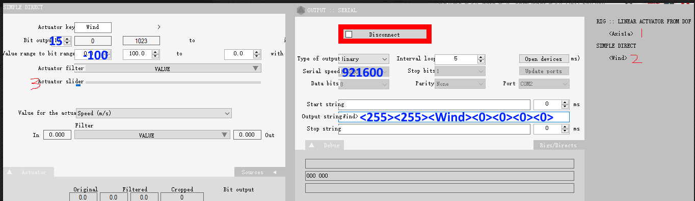

    Don't change anything in the code just this line:
    #define NUMBERACTUATORS 3
    to
    #define NUMBERACTUATORS 1
    In Mover use this:
    The code you show in your post are just comments, not code

    hi pmvcda, thanks for your help , but after change the data as the picture shown , it seems didn't work ,the motor still like before.
    BTW ,the value of min & max range , depend on the time of my push the limit switch , longer maybe min=-1075 max=1075, short, maybe the value is -357 & 357 , does this range will impact the FlyPT interface and make it don't work ?

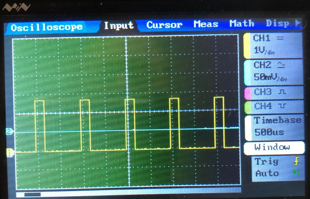

    I put my oscilloscope on the pwm output .
    Below this is the PWM sent by the esp32 for calibration .
    As the process is well done for calibration you can check that the pwm sent from esp32 to driver.
    I connected Mover and the debug window shows me right that data sent to the esp32 when moving the slider .
    But esp32 sent nothing to the driver . I put the oscilloscope and there is no pwm sent .
    I don't know why but this is i noticed .
