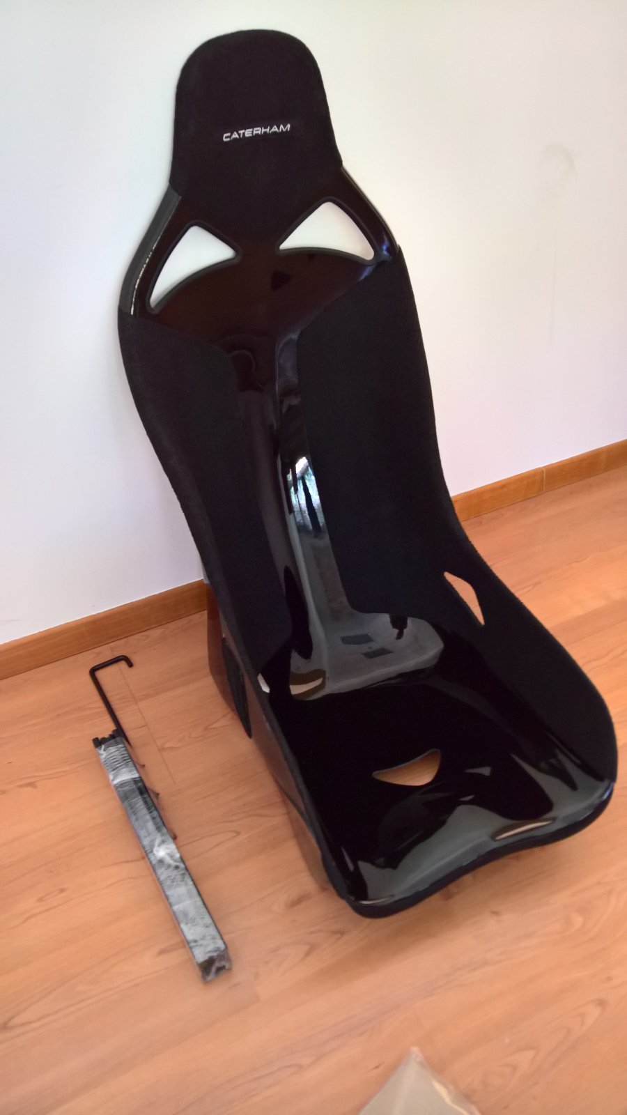

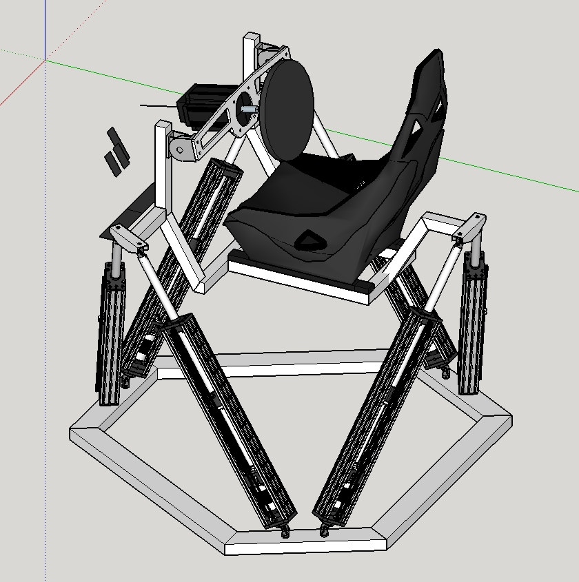

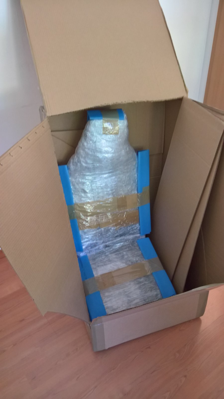

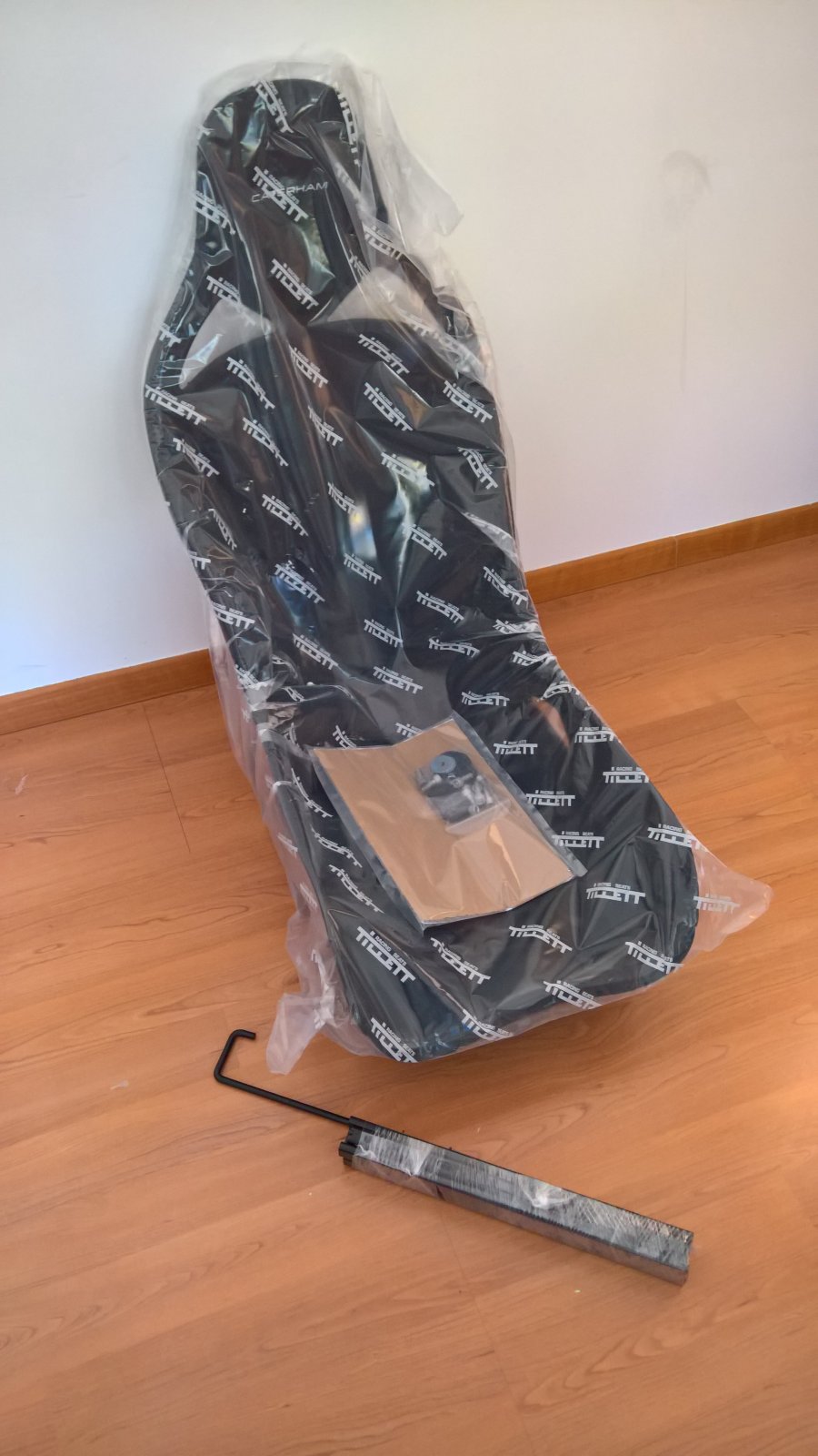

    OK, it's slow progress, but money is also slow (coming in, not out:eek:).
    Some changes in the seat, instead of JKComposites seats, I changed to a Tillett for the Caterham, bought on ebay at jjcraceandrally.
    Simple, no phone calls, no options, no bank transfers, but more expensive.
    Just received it, looks good (around 4,5 kg):
    WP_20171114_10_31_25_Pro.jpg WP_20171114_10_38_33_Pro.jpg WP_20171114_10_42_09_Pro.jpg
    Now I finally can design the rig around the seat and solve all my doubts about the seating position.

    i love that seat, i have been stocking it since forever. :D:D:D:D nice pick

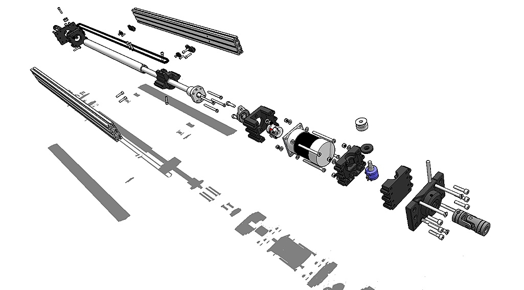

    first of all: Great build! Especially the fact that you are using PET-G for load carrying parts. A bit of a bold move though, but certainly one I will follow closely.
    Please keep us posted as soon as you have a test under a realistic set of loads. It would make my own design quite a bit easier if I could swap all the 8-10mm aluminum plates for PET-G printed parts. That'd allow me a much sleeker and way more integrated design. So far I'm still staying with aluminum for load carrying parts.
    A couple of questions on my mind for you @pmvcda , @SeatTime and @wannabeaflyer2:
    1. Does the single upper bearing take all the bending moments when the actuator is in its fully extended position? I know, that there isn't all THAT much on there, but what IS there needs to go somewhere. I am tempted to use two upper bearings with ~150mm between them, just to be sure. Igus don't cost that much, so the only real consideration I'm giving this feature is the space requirements of it.
    2. Does the loose end of the ballscrew simply dangle around inside the rod? I assume it does, so does it create any audible noise (klonk-klonk) during load changes. Or scraping?
    3. I know, it's a bit of a delicate subject: Are there any features on your designs that you'd do differently if you were to make V2.0 of it? Come on,... you received praise and approval left and right, so show us the "dark" side of your designs :)
    Thank you guys, you saved me months of work!
    Dirty :D
  9. SeatTime
    2,572
    1. Yes, for this Stewart platform design. I have been running them quite hard for around two years now and they are still working fine.
    2. No, there is a nylon spacer on the end of the shaft.
    3. No, I have made plenty of other changes over time with my 6DOF rig, but have never needed to touch the actuators. On reflection a encoder would be nice, but have not had any issues running with just pots.

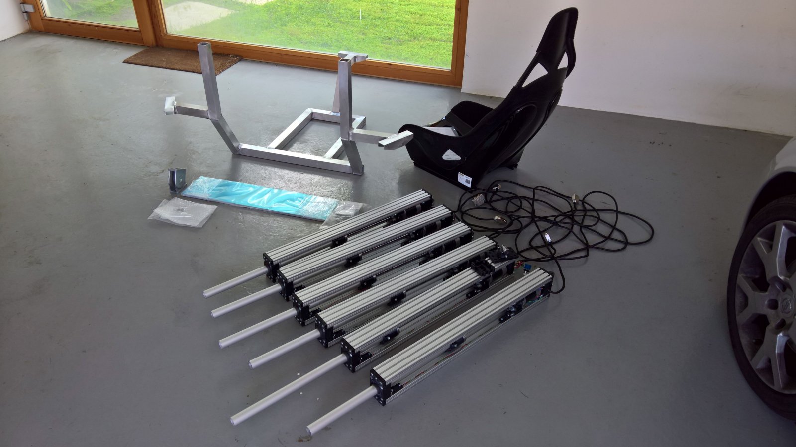

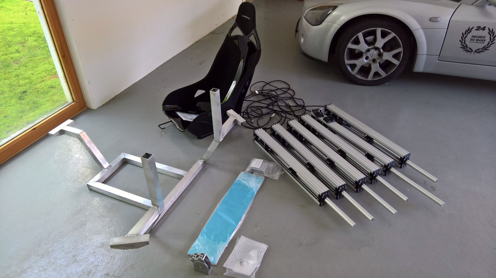

    Well, I'm back. Finally some time to pick this again.
    I'm right now building the aluminium structure for the base and the seat.
    Well, more or less, since I have no tools to weld, so I asked someone nearby to make me this:

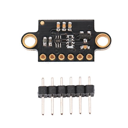

    In another front, I also ordered this:
    It's a " VL53L0X Time-of-Flight ToF Ranging Sensor Laser Distance Measurement Module"
    The idea is to replace the pot for something cheap with absolute positioning, but It needs a good white surface for reflection and needs a conic volume completely free.
    This might take one or two weeks to arrive. If it doesn't work, it will be used in my son robotic projects.

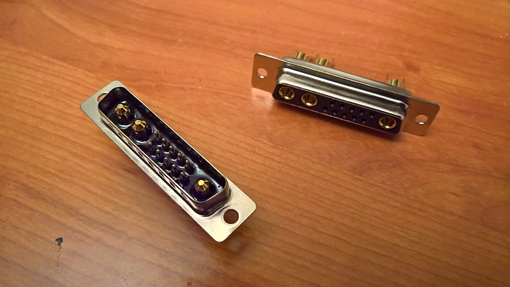

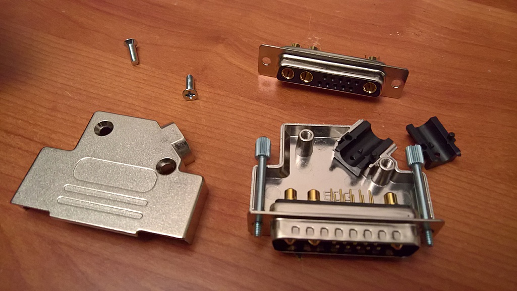

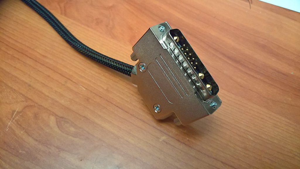

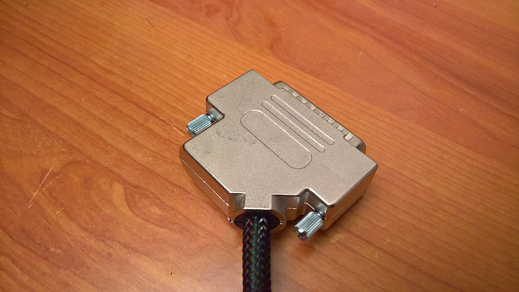

    What is this connector called? Link?

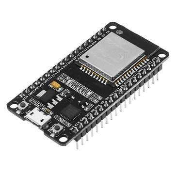

    After some tests, I'm going to ignore this solution.
    It really needs a "big" conic volume.
    It's fast and I could make it work, but I would need to point the sensor outside and have a big target on the slider, increasing the actuator section.
    So it's a no.
    I'm still looking at the hall sensors from the motors.
    Made some tests and was able to count the signals, but I was also able to burn the Arduino... :mad: in a stupid way...
    But I have a new Due and also an Espressif esp32 to try ;).
    The ESP32 is way faster and with lot's of interrupt pins, good to count the signals from the hall sensor (and only 9€ !!!).
    They are 3.3V but I got some logic level shifters for 3.3V <-> 5V.
    Need some free time...

    Finally got the upper structure.
    Not perfect... Asked a professional, but I'm not happy with the welding. But they are strong.
    Needs some cleaning.
    Also bought two articulated joints and an aluminium plate to hold the wheel (still have to drill and cut it).
    Let's join parts to at least see some development:

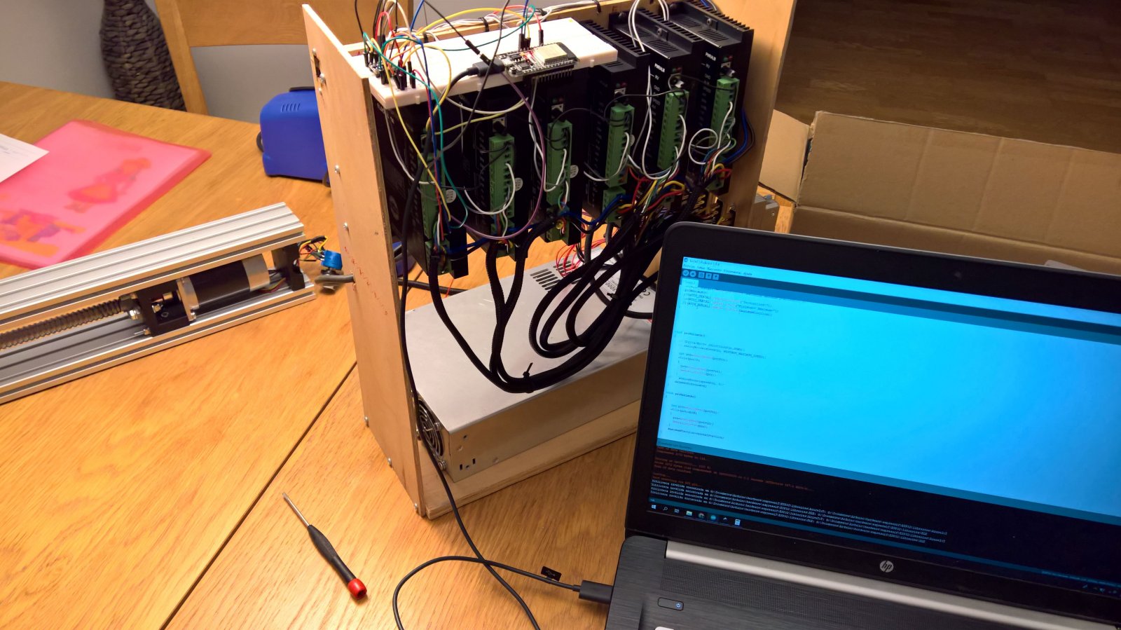

    Meanwhile, working with the ESP32 on a solution to count steps with the hall sensors of the brushless motors.
    I have to deal with 3.3V logic in ESP32 and 5V on the controller, so more work than expected.
    But it's also a way to protect the ESP32.
    But it might work and maybe I Can scrap the pots and the belts. :)

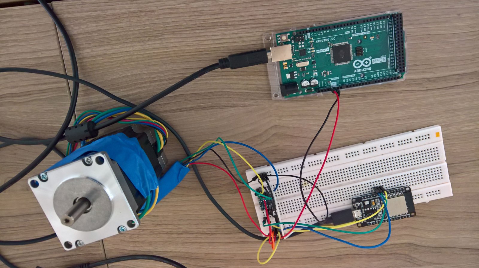

    Well, for now it's working OK, but only moving the motor manually.
    First tests with an extra motor I have. Just tested manually. I achieve 12 interrupts for one turn, so less than 0.5 mm precision, since 1 turn is 5mm.
    (The Arduino was just to get 5V and test the logic level shifter 5V <->3.3V)
    Started changing the code and wiring to test the actuator moving.
    Remember, I have 5V for the motor controllers and 3.3V for the logic, so I have to separate more than I wanted.
    Also, the minimum and maximum switches will be handled as a pot for initial test.
    Minimum will be 0V, maximum 3.3V. For the test, the pot gives around half the value (+- 1.8V fixed).
    If this works, I might use interrupts for the switches.

    I think it will work.
    I'm afraid of loosing the position with time. So I must keep the limit switches to handle a severe error.
    Now let's change the code... Wiring is done for one actuator.
