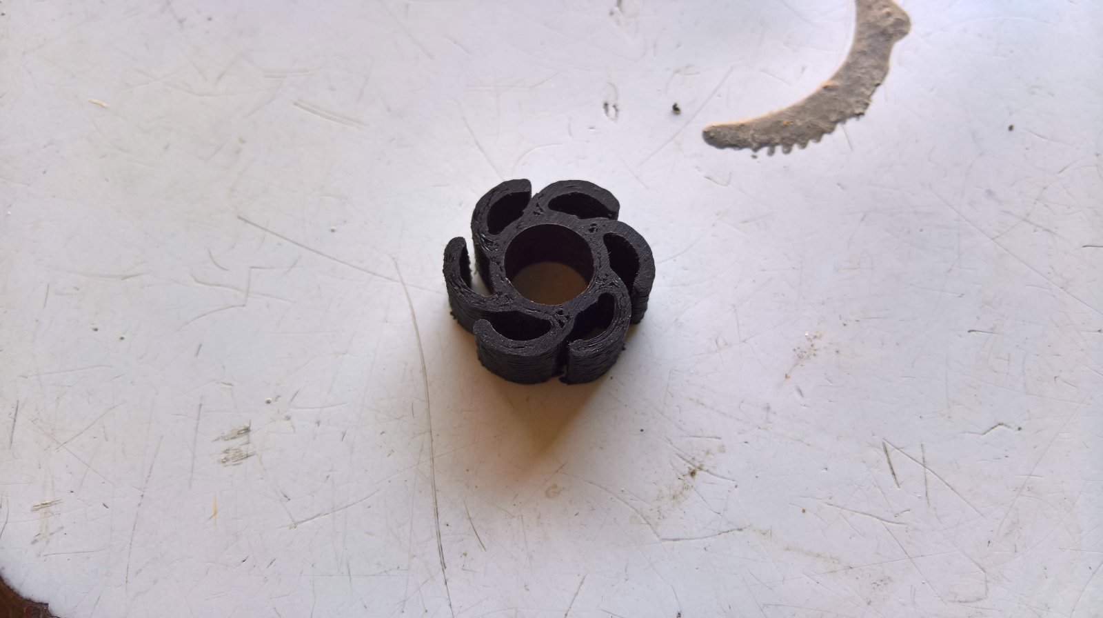

    I would like to try different anti wobble ring on my rig and I can't see any file STL from your, can you send me one !
  12. pmvcda
    pmvcda aka FlyPT
    Nov 3, 2010
    2,225
    Portugal
    15,639Coins
    +2,662 / 17 / -0
    I have to search the file.
    It's somewhere in the drive of the old laptop...
