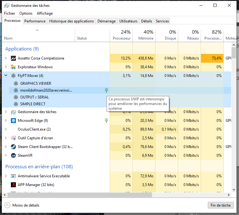

    Tested 2.9.7 with the 2 boards Thanos and esp32 .
    Got the error transmission and the message . But curiously the esp32 disconnecting by itself ( not Thanos board ) . And after the app didn’t freeze and I could follow only with Thanos board . Will check the new release 2.9.8 !
    Below a screenshot .

    Trying to re-connect but mover 297 freezes , I click on the connect button , just show starting but mover freezes !
    Install Mover 2.9.8 and exactly the same problem . To make mover working again and I could after make a few turns with both boards connected , I unplugged the esp32 and plugged it again and it worked .
    If that could help

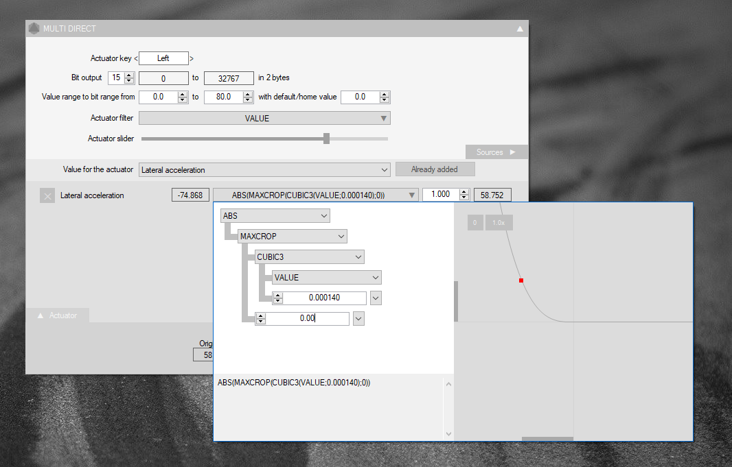

  10. benmax
    Oct 15, 2013
    188
    1,552Coins
    +59 / 0 / -0
    Hi Flypt ,

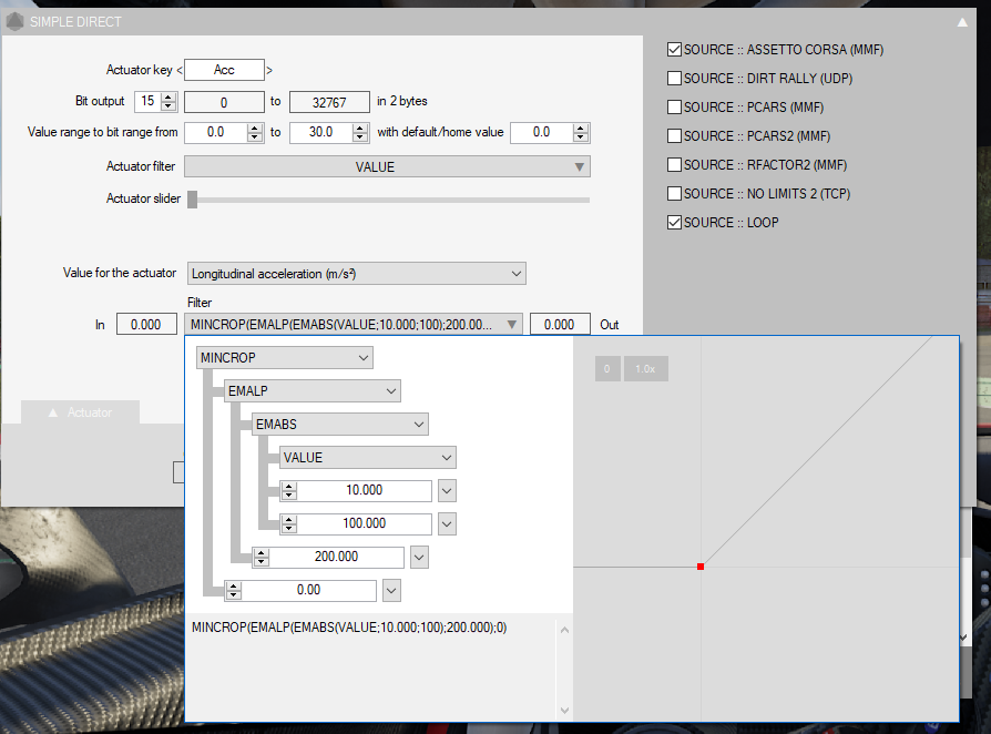

    I always test my pneumatic actuator for acceleration
    I quoted the message you made explaining how to setup a direct or multi direct for acceleration .
    First was is the difference between direct and multio direct input ?
    in my setup i tested with also simple direct , just to test .

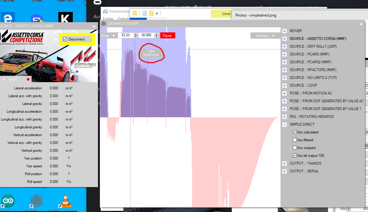

    I tested with asseto corsa competizione .
    Below in the first pic my setup (simple direct ) .
    The problem i'm facing is that i setup on my actuator a range from 0 to 30 , that means according your quoted message that the max acceleration / decceleration could be 30 m/ s2 .But with this setup and i checked in the input plugin , the max acceleration won't go over 10 m/s2 , but my actuator reaches anyway the max limit switch .If the maximum travel actuator is mapped with 30 m/s2 , i didn't never reach the max limit switch with 10 m/s2.
    Look at the other pic attached showing the graphics view wtih max acceleration value 7,xx m/s2.
    Normally it should be for me more than 7,xx because above one G it's not correct (may be a scale down value ?).
    There is somethiong i didn't yet understood why my actuator reaches this limit .
    An another thing i didn't understand also is when i move the slider and test manually my actuator , i reach the limit switch above the max travel on the window .is it normal ?
    Last point i got some serial error data (esp32). A good thing is when waiting mover seems to work again (not necessary to close it ) . And when I got the error and the serial has been disconnected by itself , i took a screen shot from task manager . If that could help .
    Thx
  11. pmvcda
    pmvcda aka FlyPT
    Nov 3, 2010
    2,237
    Portugal
    15,702Coins
    +2,674 / 17 / -0
    Simple vs Multi
    Simple direct, allows you to move an actuator with one of the source values. You can apply filters to that value.
    Multi direct, allows you to add the effect of multiple source values and apply filters to each one of them, and also to the final actuator movement.
    So in reality, the simple is a special case of the multi. It's there to simplify, but it's causing more confusion than helping.
    Also, simple calculates faster then multi, but it is not significantly faster.
    Honestly, I already thought of eliminating the simple and might do it.
    Reaching the limit
    That's strange.
    Are you sure you have a good actuator calibration?
    Let's consider we have a 8bit actuator resolution. Goes from 0 to 255.
    After calibration, 0 is the minimum and 255 maximum travel.
    This is just a remap of values from one range to the other.
    When you say value is 0 to 30m/s^2, you are saying it should send bit value 0 for 0m/s^2 and bit 255 for 30m/s^2.
    If you are reaching limit with 10, something is wrong on the actuator calibration.
    You can see the bit output to the actuator in the window. And it never goes above the maximum bit value.
    If you reach limit with 30, it's normal to touch the switch, since in calibration, the maximum is defined by touching it.
    Unless there's a bug somewhere. There was an error in the mapping, but should be already solved.
    Just tested your values and they seem ok.

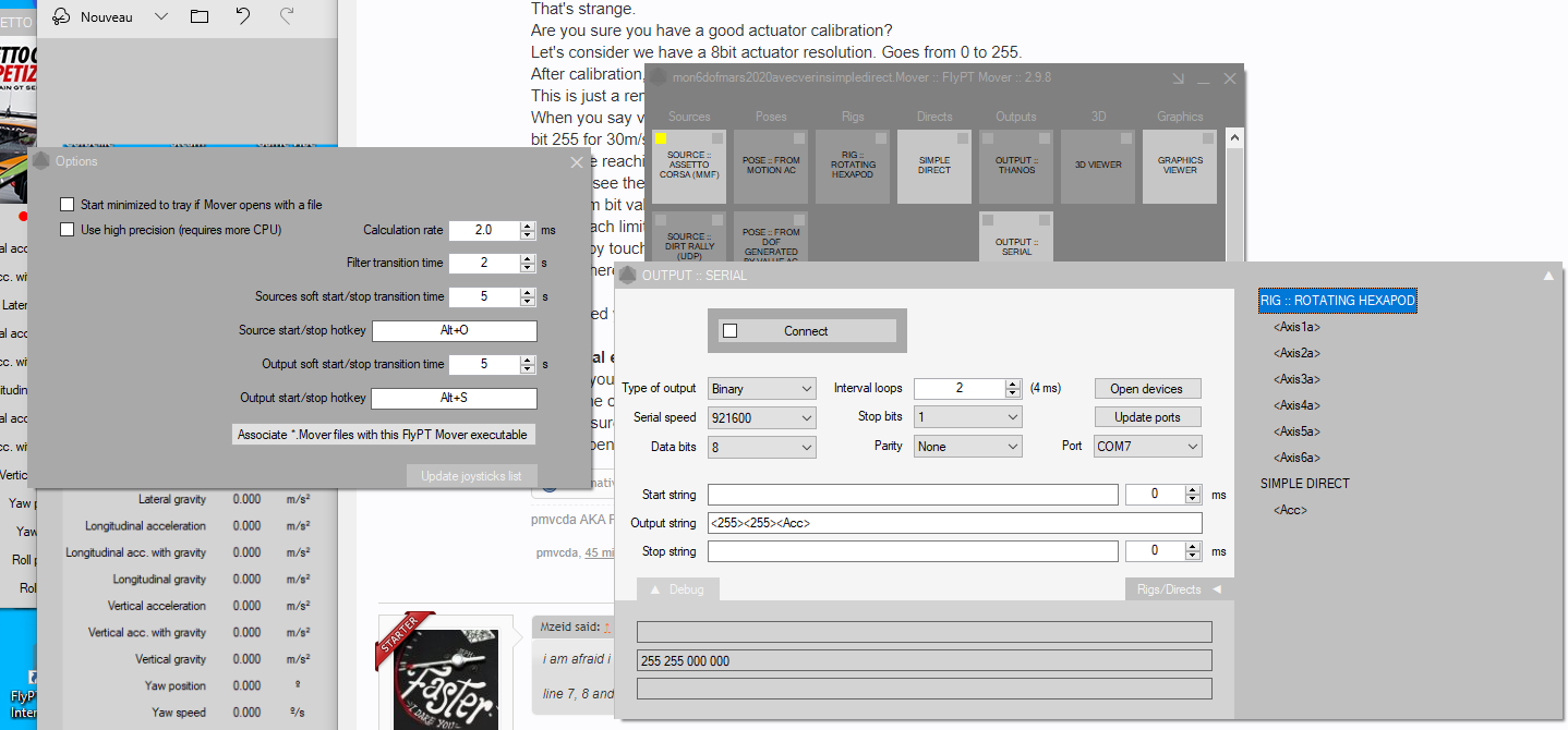

    The serial error:
    What is your calculation rate?
    And in the outputs, can you show me a shot of them.
    Are you sure you did not disconnect the cable with the rig movement (just asking because it has happened to me).

  13. benmax
    Oct 15, 2013
    188
    1,552Coins
    +59 / 0 / -0
    you will find attached the screen shot for the calculation rate and no disconnection from cable.
    tested one more time the actuator and alwalys for me something wrong .
    First the max limit switch reached above the travel of the slider when playing with the mouse .
    when touching the max limit switch the motor goes in the other direction quickly (seems ok ) . but after that it's like the origin is completly wrong .
    Fot exempler when i move the slider again to zero , The actuator isn't physically near the mini limit switch .
    it's like an origin offset !
    When you use a rig for the pose you have security to make that yoiu can't reach the limit . With direct input is it possible to setup the same ( dead zone ? etc ...)

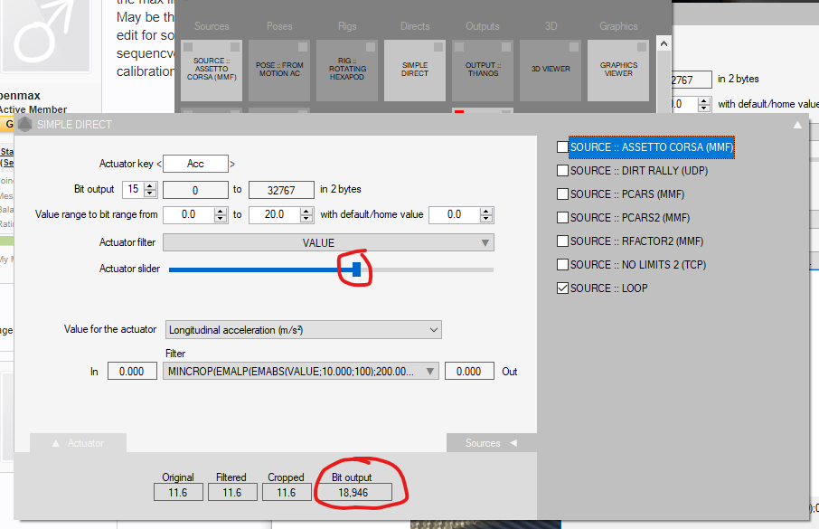

    made another test .
    First calibration sequence OK.
    connected mover
    direct input window and moved the slider
    reached the max limit switch at 18946 (look at the pic )
    And after that the behavior of the actuator became crazy some forwerd reverse turns at high speed .
    Si in confirm that there slider travel not matching to the physically stroke.
    And after hitting the max limlit switch behavior crazy and the position slider still the same on mover but real actuator posdition different from position slider . it's like the mapping is offseted ??
    Edit 2 : ok i understood that manually if i don't move the slider unable to gety back a normal situation . To make it working again i have to disconnect esp , move back the slider to zero and i 've got a new proper situation . And in this case i 've got again the problem i hit the max limit switch at bit output 19000 like always . Problem is always here .
