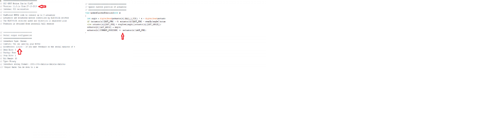

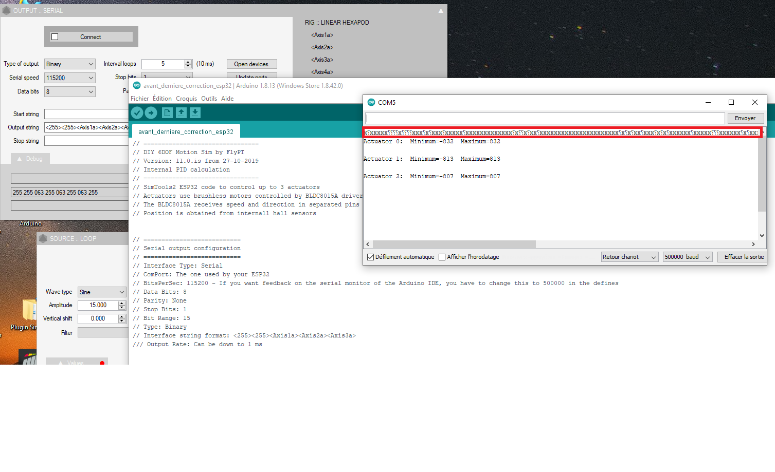

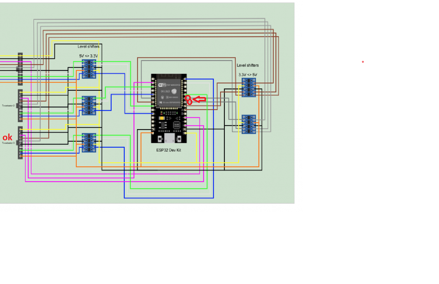

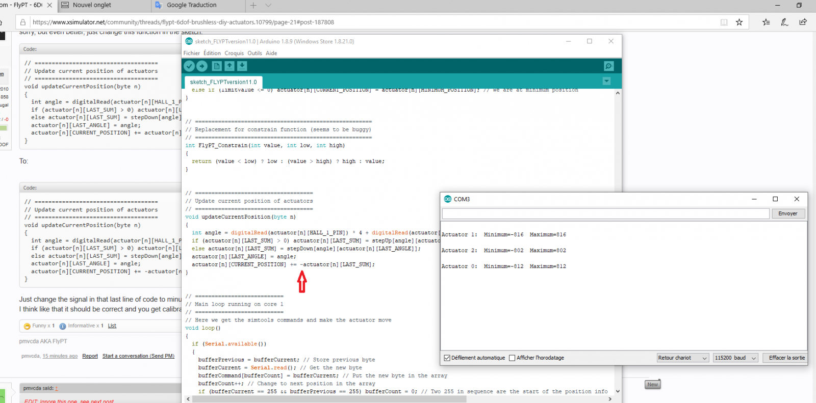

    I have a problem with my simulator, since I changed my two esp32 cards and other small modifications nothing works perfectly as before. I tried to go back to correct my problem but nothing works. I cannot put my finger on the problem :mad:. I know this is a simple problem. :think I put a list of what I did to correct the problem.
    Like Pedro says so well, I will Win :D
    Thanks for your help!!
    Video of this probleme (like you can see , actuator 1 missing something and when I push on him , he return on low position and number 2 goes up position and number 3 goes well with source loop :
    1 -Things strange : see red square in source serie.
    Set up with Motion sim version 27-10-2019 , speed 115200 and ( - ) here
    actuator[n][CURRENT_POSITION] += -actuator[n][LAST_SUM];

    Do you receive that info in the red square on both esp32?

    I have completely removed the esp 32 from the game (only the card alone) and I have the same red square on my monitor series when I reset it!
    I never had this before !!!!

    You might have them damaged. It's strange,, because that's not happening on mine.
    Unless... I have to test this... Data might be scrambled, because you are using an higher speed, and on boot the ESP32 are at a lower speed, so the serial monitor shows garbage until you set the speed in the code equal to the one in the serial monitor

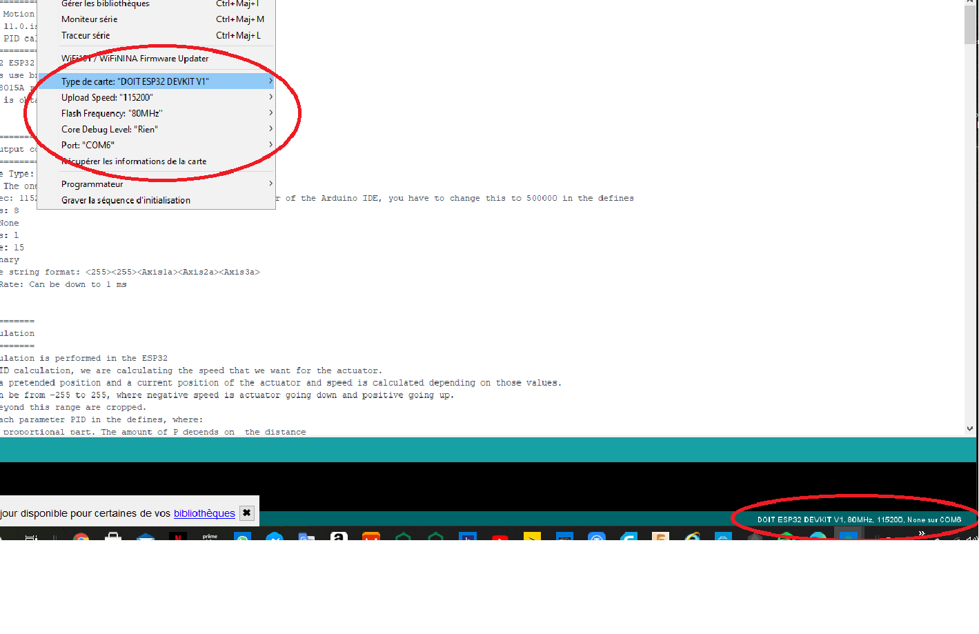

    My set up communication with esp23 ( see pic):

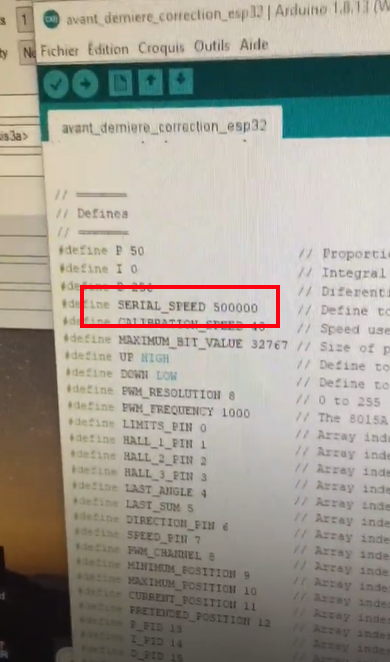

    Replace 500000 with 115200 and try again please

    :( the same with 115200 ..
    I did windows up date ( shutdown PC ) and it's the same.
    I changed the usb port (direct with the smal cable) = same prob...

    @pmvcda , look here .... ( pic) I don't have this scrap on monitor series ,,,,...:think ( old discution with you page 22 )

    Hi ,
    @pmvcda ,@benmax
    Finally I found my problem !!!:nerd
    That why actuators one and two had some confusion!!
    I had swap two gray wires on the electric plan .:blush on each board !!! I must buy me a new pair of glass:cool: to see better !! see pic.
  20. pmvcda
    pmvcda aka FlyPT
    Nov 3, 2010
    2,225
    Portugal
    15,639Coins
    +2,662 / 17 / -0
    With a schematic like this, it's easy to do it wrong :think
