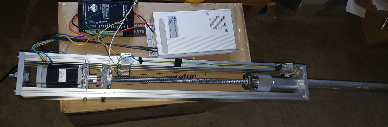

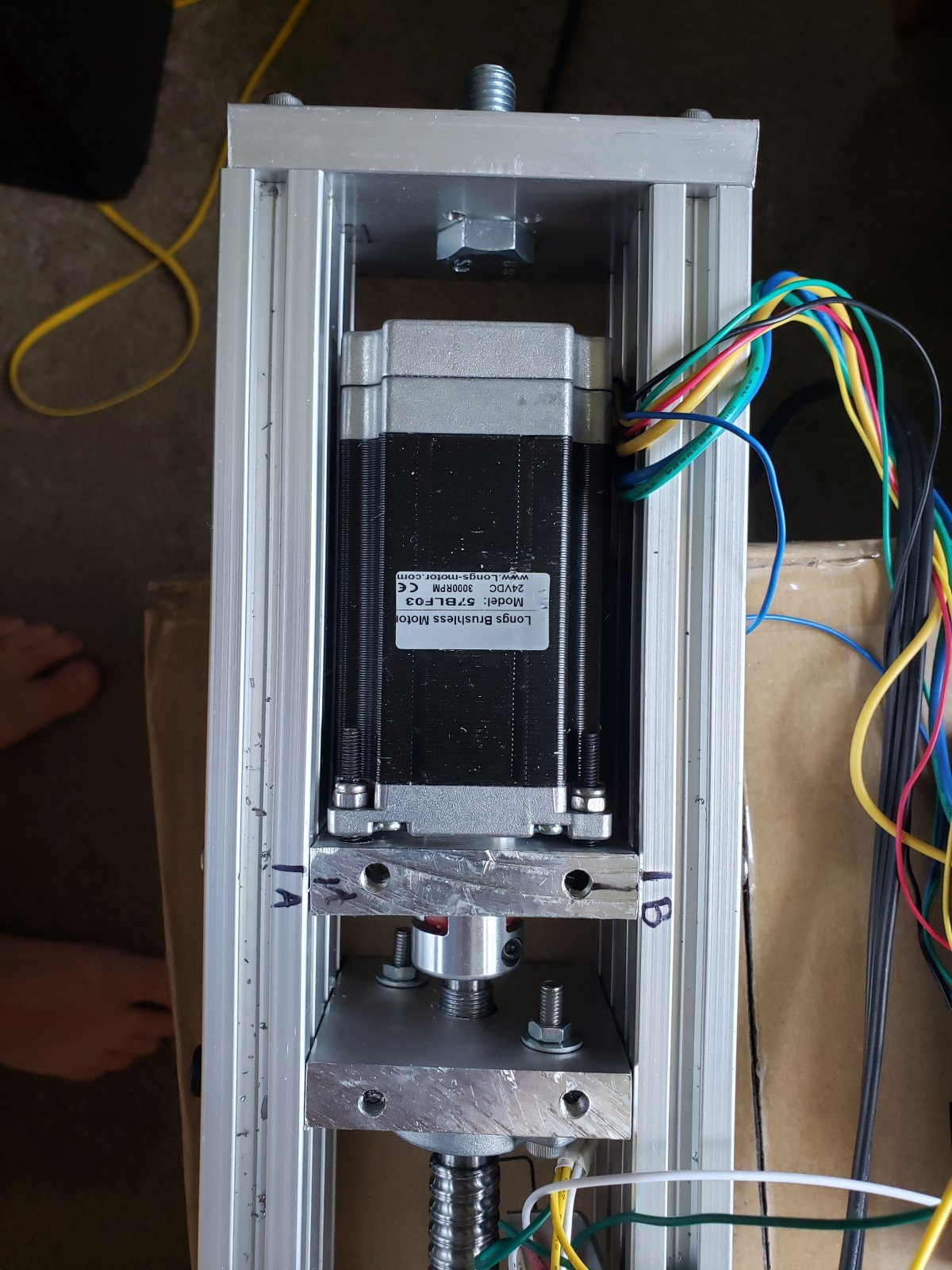

    Here are a few pictures of my Actuator build. All metal design - no printed parts. And no need to CNC Aluminum the way I did it. Everything is made from Aluminum stock, cut to size and drilled (and threaded as necessary). top view.jpg TOP VIEW
    Motor Detail
    Simple rectangular Aluminum plates, drilled to allow the shaft and coupler. Threaded on the sides (left and right in this picture) so that bolts can hold the plates in place.

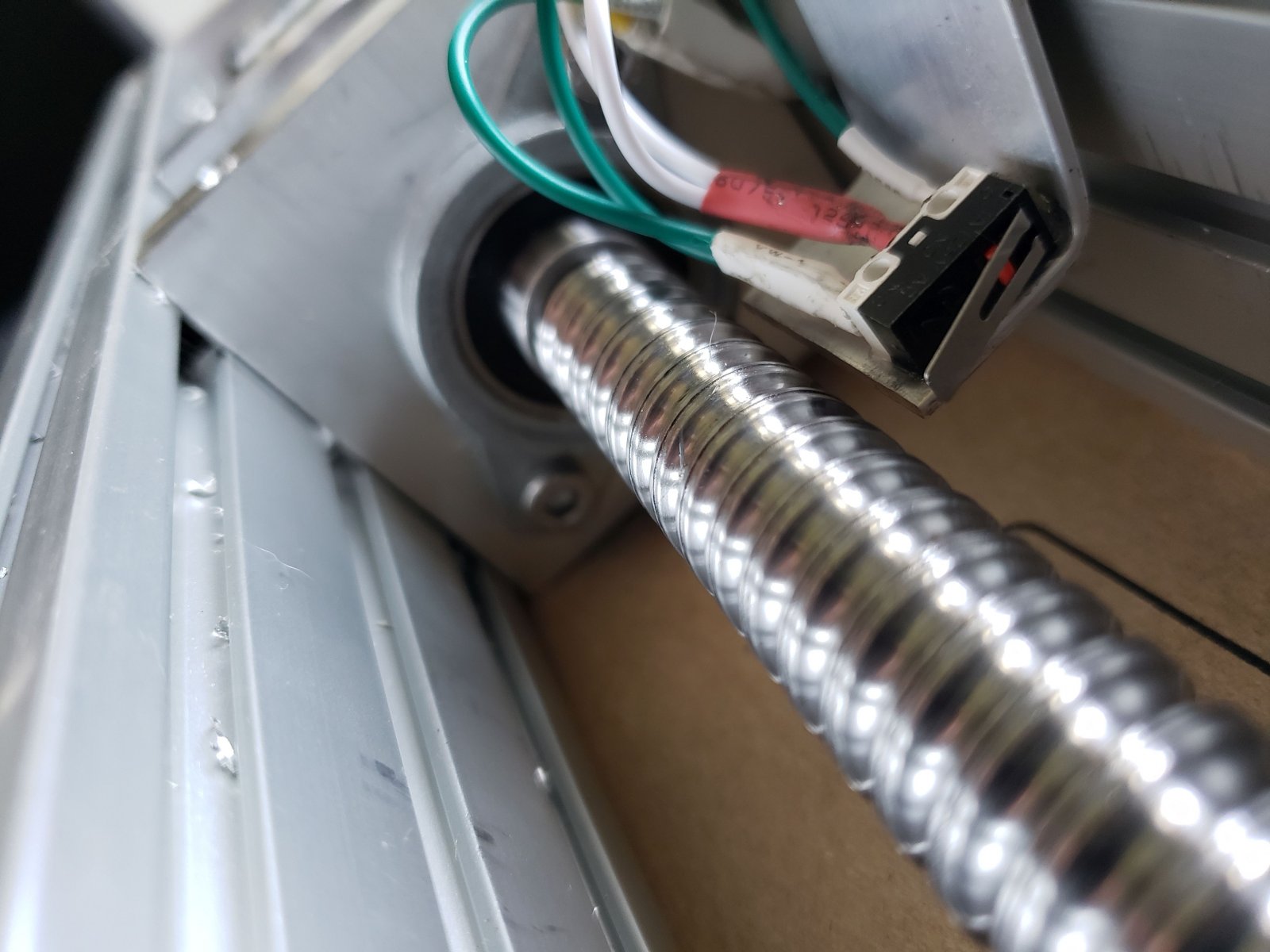

    CLOSE UP OF SCREW PILLOW BEARING
    On the right you can see the microswitch mounting. Simply thin Aluminum bent into shape. The microswitch is epoxied on.

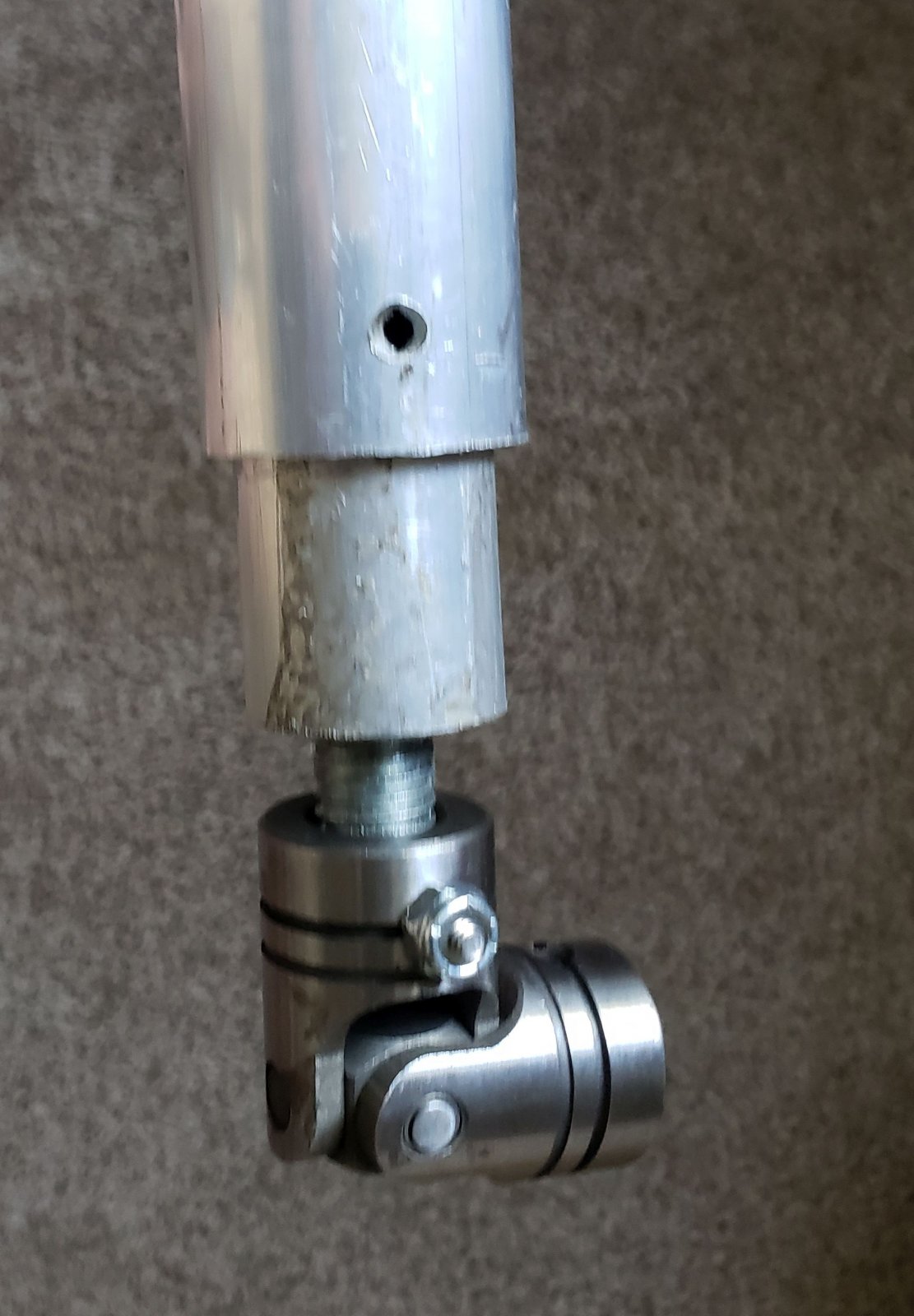

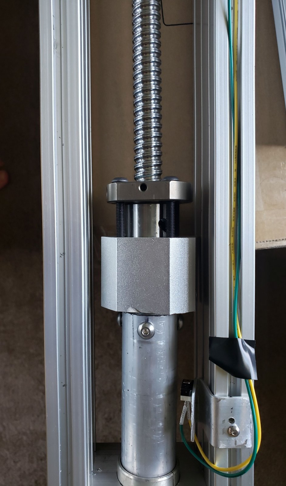

    ball screw to rod connection.jpg CONNECTION OF BALL SCREW CARRIAGE TO ROD
    I used the hardware that came with the ball screw assembly. Not visible in the picture is where the rod joins the carriage, I added a smaller size tube to allow the rod to mate with the carriage (the rod diameter was too great to fit into the hole). Note that the carriage can rotate at the moment because there is no connection between the carriage and the side walls of the actuator. It works as is, but I may screw bolt into the carriage and slide the head of the bolt into the channel in the side walls. You can also see the upper-limit microswitch here.
    ROD END
    This end of the rod also uses a smaller tube to allow attachment to the rod. The M12 bolt head was ground down so it just fit inside the smaller tube. The entire tube was then filled with Polycarbonate resin to hold the bolt in place, with the end projecting out as you see in the photo.
    TOP DETAIL
    You can see the teflon coated flange which ensures the rid travels smoothly.

    Man that looks very nice. Great job. Thanks for sharing your progress and explanations. Getting amped up wanting to drop the hammer and start ordering everything. Just need to pay off a couple thing first. Keep us posted on your progress and let us know how the movement goes.
