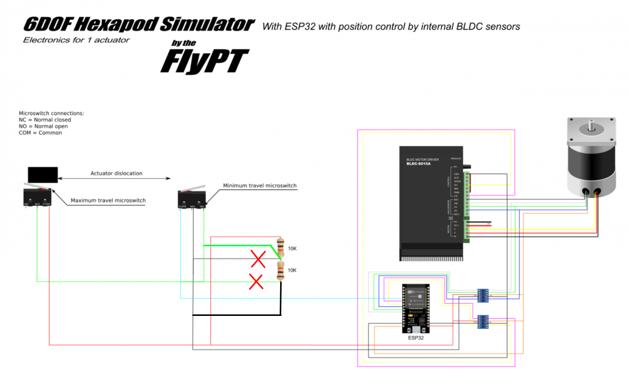

    Guys, how does everything work for you ?! Don't you think that the voltage divider on the circuit is drawn incorrectly? The green wire must be between the resistors. Black (gnd) and red (plus) around the edges. Then the voltage on green will be half as much as on red.

    I think there is an updated schematic on page 26 that shows the correct arrangement.

    Thank you. It's just that the information on the first page is not corrected, so I was mistaken at first :)

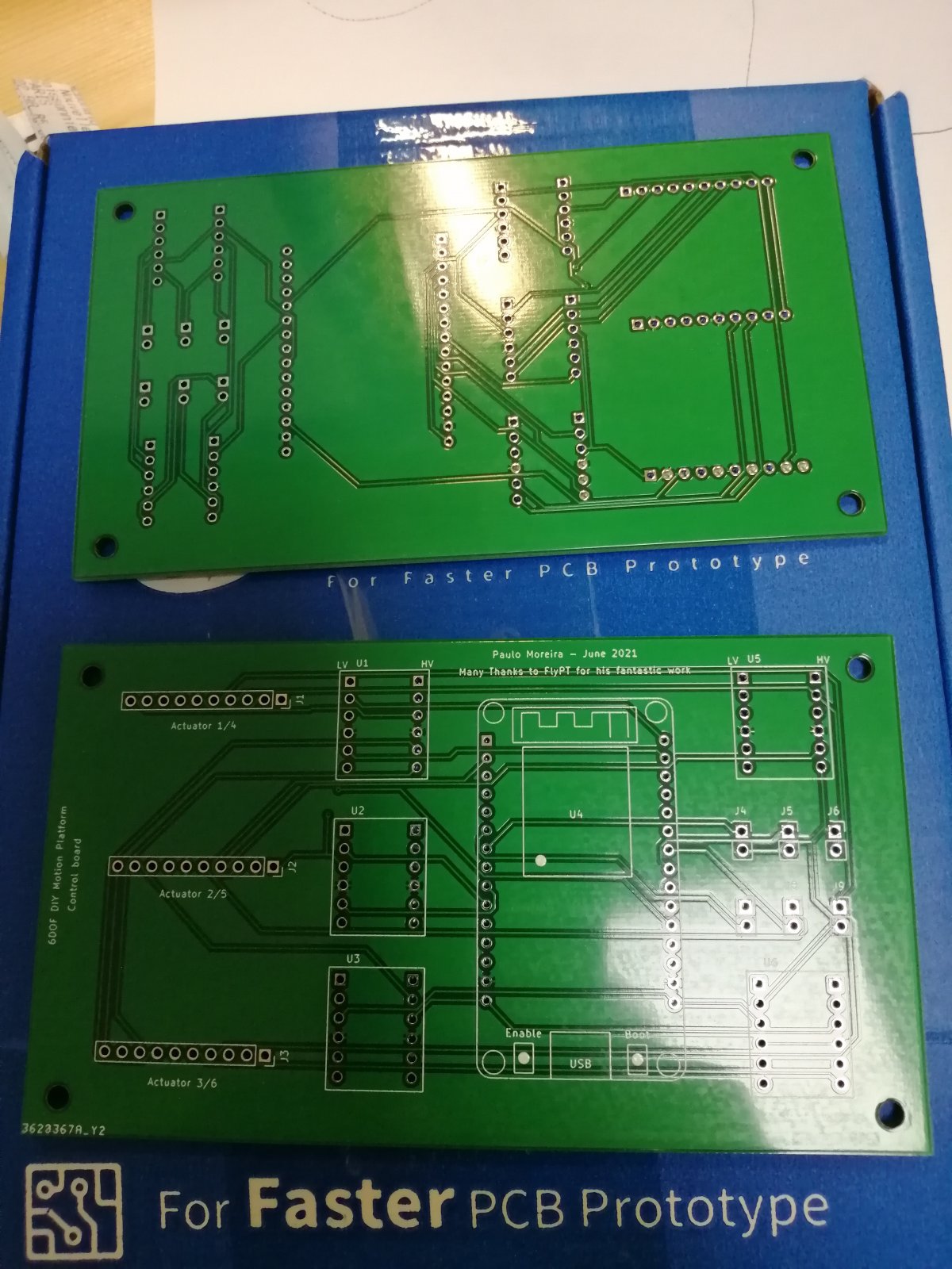

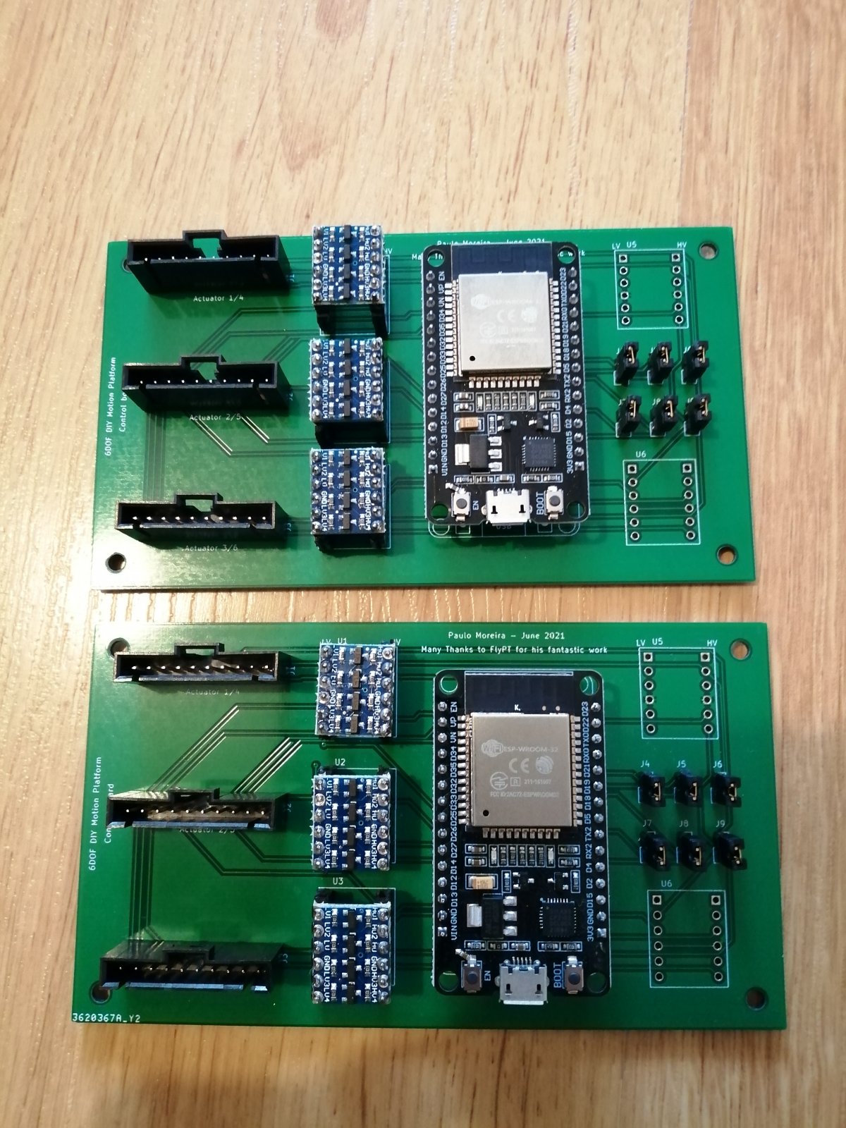

    Hi guys

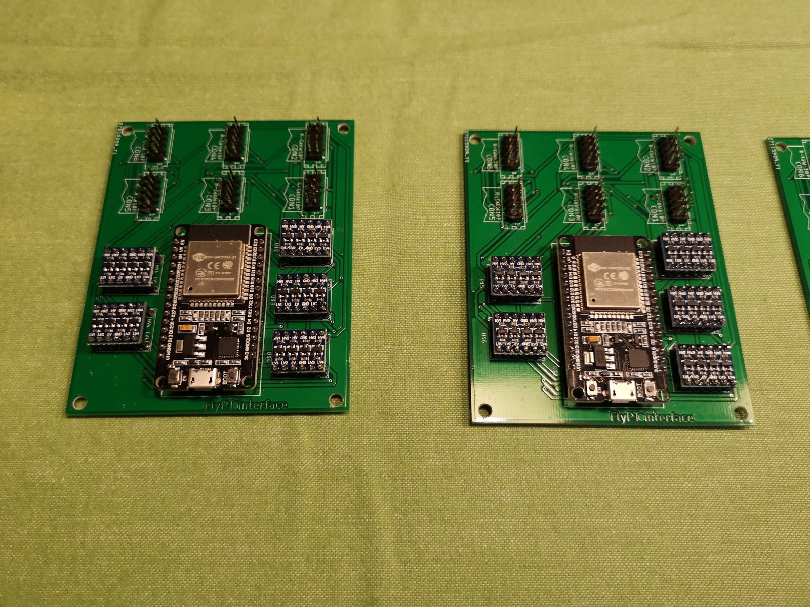

    Just received the PCBs from JLCPCB. 16 euros for 5 boards, including shipping. I can now start soldering and make sure that the board's are good.
    Edited: The boards are validated, everything is good. To the guys that want to use this PCB Design, pay attention to the level shifters position. All 3.3v MUST be on the left side, for all level shifters.

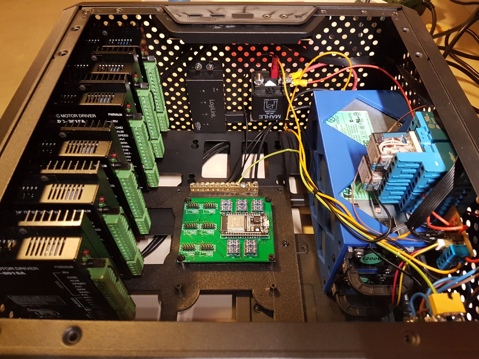

    Hi @Gabor Pittner
    Can you provide what box did you use to put all the electronics ? It's very good. I was thinking in making one in wood, but that you have is very nice.

    The 2 boards are soldered.
    Meanwhile, I have to wait for the mechanical pieces, so can anyone explain me the Excel file that FlyPT has created ? What parameters do I have to set to get my platform dimensions (top and bottom bases) ? IMG_20210702_193743.jpg

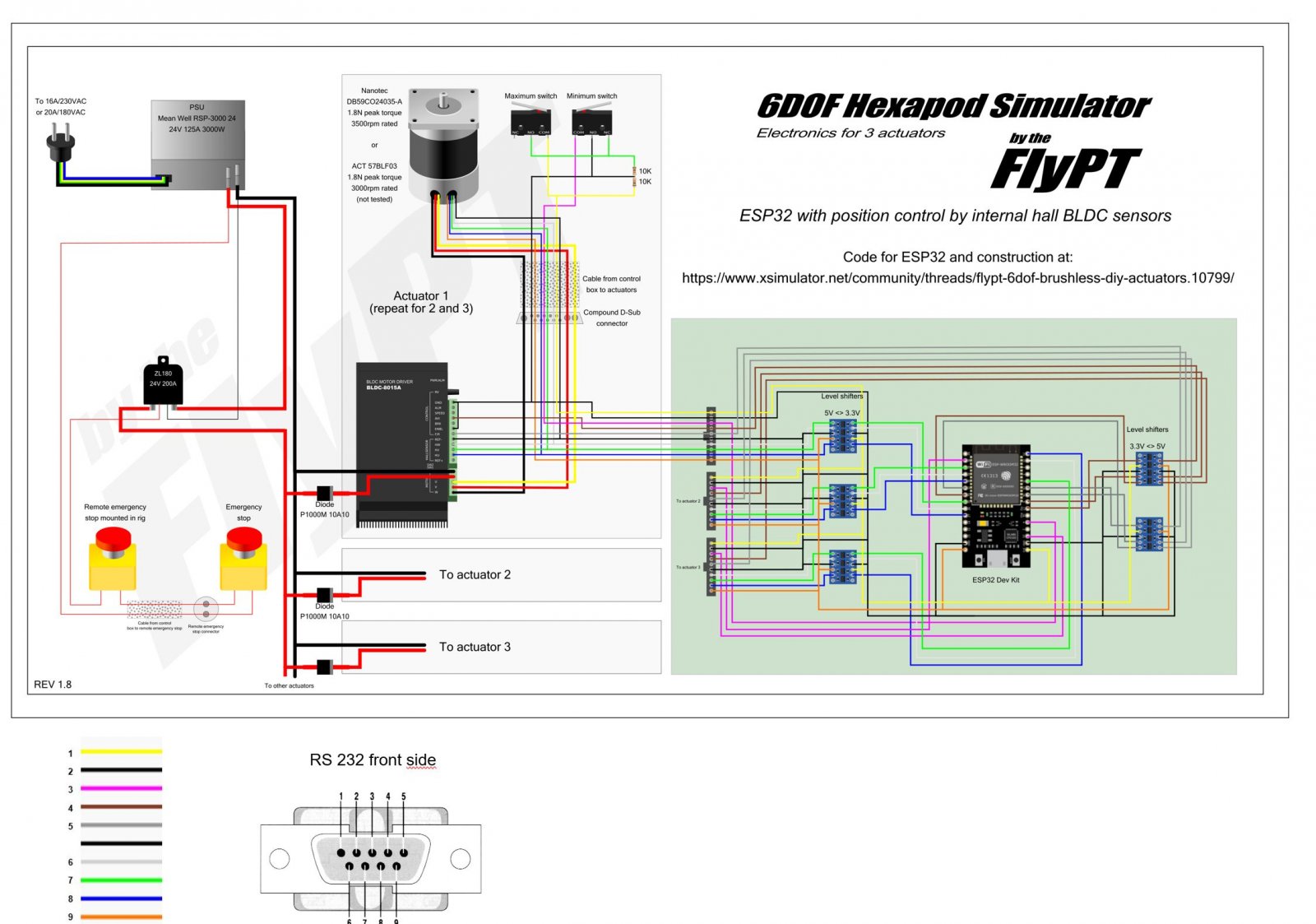

    I currently have a 3DOF which works well (3X BLDC 400W mounted in rotation, with MMT-DPW controllers), and I find the realization of FlyPT so interesting, that it makes me want to switch mine to linear 6DOF by recovering a maximum of my current pieces ...
    I have a simple question: I saw that you need 2 cards controlling 3 motors each, or 3 cards controlling 2 motors each.
    for organizational reasons in my box, I want to opt for 3 cards with 2 motors. my question is: is it also efficient? because I have read all the threads and I have not seen anyone use this configuration ...
    in this case, I suppose that it is necessary to put "numberactuator = 2" and that it is necessary to use the first 2 of each card, and of course, to redefine 3 cards with axis1a, axis2a / axis3a, axis4a etc ... in the software

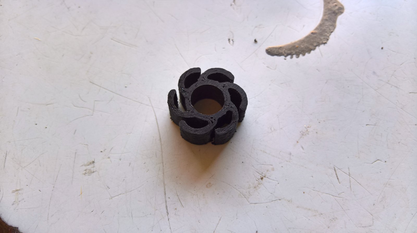

    What I also wanted to ask...what are your long term experiences with it? Do you use Grease a bit?
  14. pmvcda
    pmvcda aka FlyPT
    Nov 3, 2010
    2,225
    Portugal
    15,639Coins
    +2,662 / 17 / -0
    I don't use them...
    I made a measure error and at shortest length, they touch the limit and fall inside the tube.
    But never noticed the screw touching the tube, so never corrected the problem.
    Might be a bit more noisy, but I'm now using headphones and in the garage, so not a problem for me.
    I still have 2 actuators with them, they never got out.
    Grease:
    I use a grease in spray. Don't remember the specs from memory, I can take a look by the end of the week (I'm not at home right now).
    I tried a grease in paste, but it was to much. When rotating, and being an open system, it goes everywhere...
    So if you use grease, get some in spray and don't put to much.

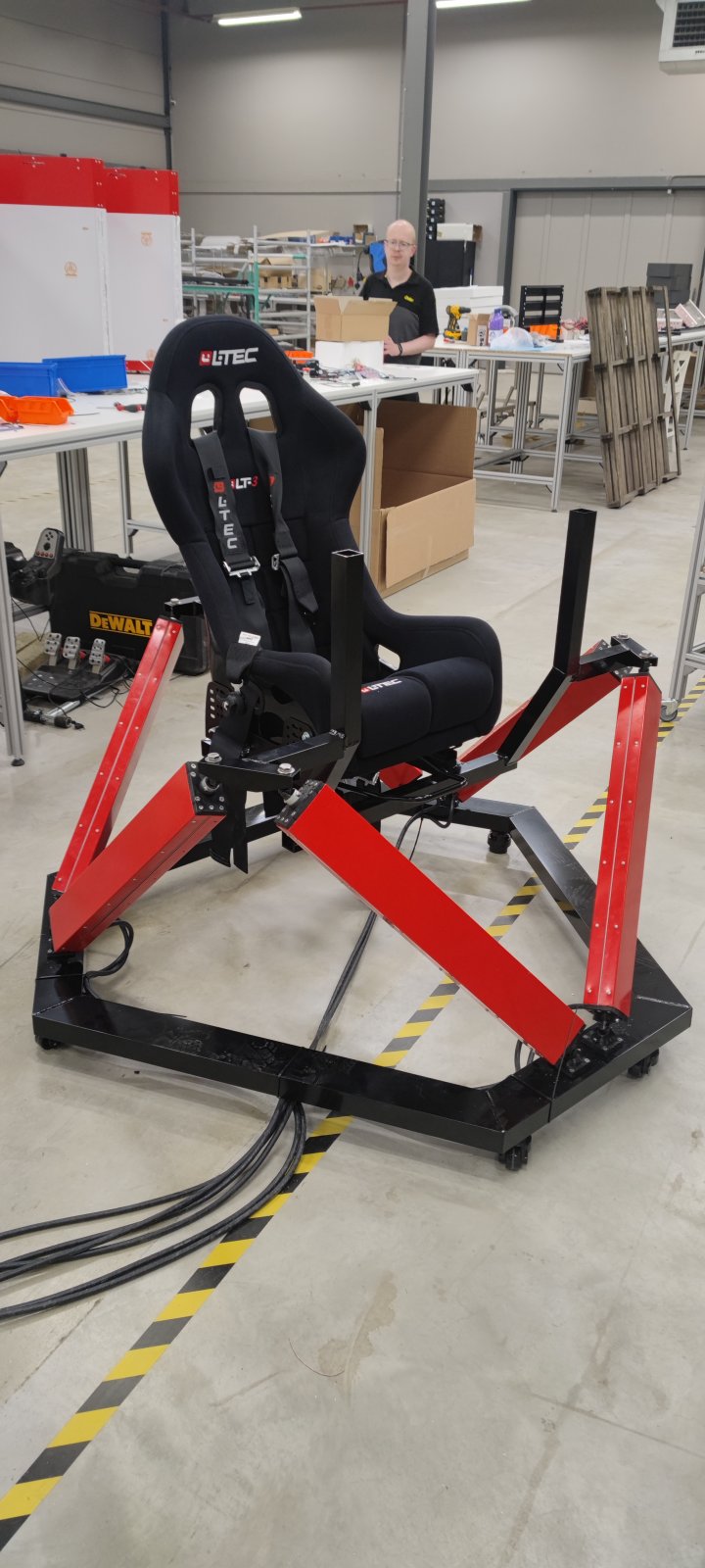

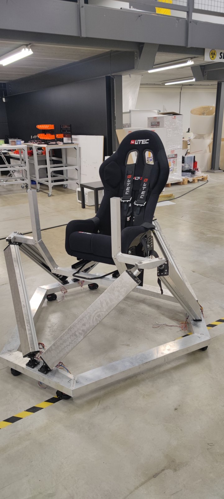

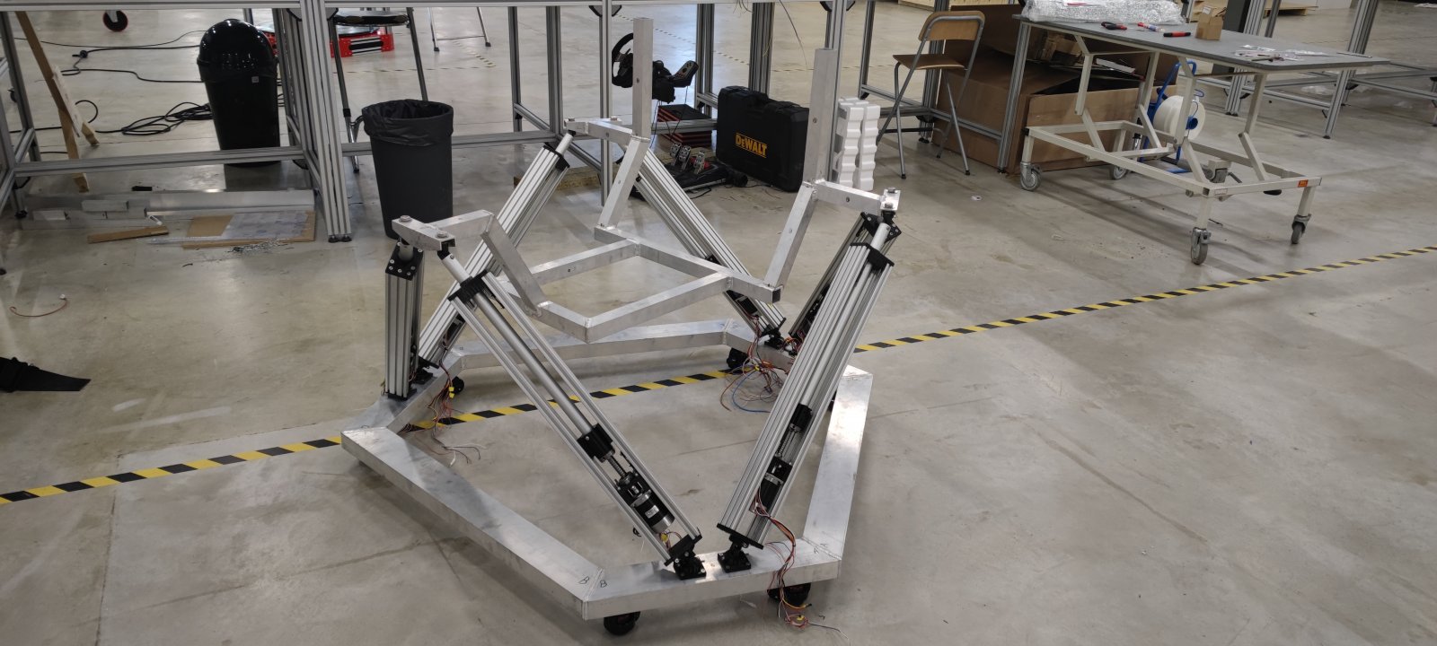

    Our build is going very slowly but its getting along.
    The rig was first build by an intern at our company
    After fitting everything correctly we tried the caps on the actuators
    Looking a bit better... so everything works so far
    Now we give it a shot at the powdercoating company we work with.
    So far so good.
    Everything works like homing the unit etc.
    Hardest part is now finding the right filters and settings in mover software.
    When i skip the filters it works but very very shaky and not smooth.
    When i use the EMALP and EMAHP filters like 200, 50 it's not reacting at all at the moment.
    What we changed in the firmware of the ESP (We use the Lolin32 ESP units).
    PWM_RESOLUTION 4 (at 8 it was not reacting and calibrating that smooth)
    Everything else is still stock and we slowly getting the settings... it's a fun and sometimes frustrating project.

    Good Work! What material was used for the sheathing?
  18. Daniel van Mourik
    Daniel van Mourik New Member
    Jul 13, 2020
    8
    117Coins
    We used 1mm aluminium for sheeting.
