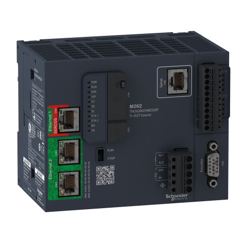

    @pmvcda I use Schneider plc (Modicon 262)
    The issue is sending commands from flypt mover to plc, I am thinking of using UDP, I don’t know if you have any more ideas!

    @katy77 this?
    This one is motion control 8 axes

    yes exactly

    Do you have any idea How I can communicate it with flyptmover?

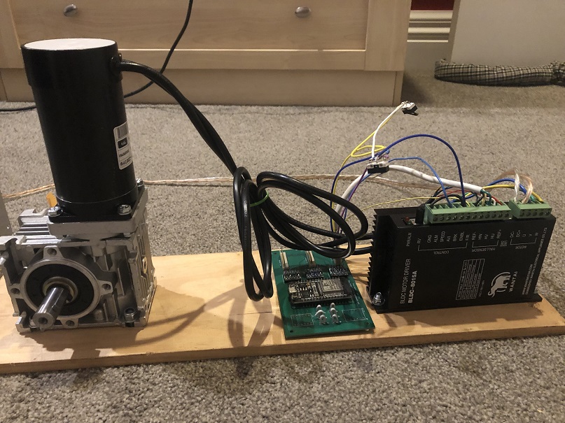

    Hi guys.
    I've been trying unsuccessfully to get a single BLDC motor with wormdrive working with the esp32 (this is a proof-of-concept before I start physical construction).
    The motor has a built-in Hall sensor (yay!), I have the same Wantai motor driver, PCBs from an earlier post in this thread, and I have uploaded the correct sketch from the fist page of this thread to the ESP32 using the Arduino IDE. I also wired and checked the limiter switches and resister as per the post on page 26.
    When I power it on the motor turns smoothly, the FR pin of the motor driver has +3 volts on it. If I press the minimum limiter switch then the motor stops (I can see in the code that it has been recognised), and at this point the FR pin on the motor driver has zero volts on it.
    Should the motor reverse at that point? I'm expecting it to and I can't figure out why it doesn't. Is it possible that I have my hall sensor wires and power wires in the wrong order on the motor driver? I did have this exact issue on a different motor driver I was trying, so would be surprised if I got it wrong on both of them.
    Any help on why my motor is not reversing at that point would be REALLY appreciated? Am I right that it should reverse?
    Thanks a lot
    John

  16. John Snell
    John Snell Member
    May 31, 2021
    63
    192Coins
    +60 / 1 / -0
    Hi @pmvcda. Thanks so much for taking the time to reply.
    EDIT: I have set the number of actuators to 1, this is important to get through the calibration loops.
    Then I realised that the motor was in fact reversing, as it should, upon reaching the Max limit, but immediately thought it has also found the Min limit and so stopped rotating... this pointed to something being wrong with the limit switch wiring. I did know that an update had been posted on page 26 by @Richh999, but I didn't realise (didn't notice) that it is still a little different to the diagram currently on page 1. Correct diagram is here:
    https://www.xsimulator.net/communit...hless-diy-actuators.10799/page-26#post-192260
    By changing the wiring to match the updated diagram I seem to have successful motor calibration now.

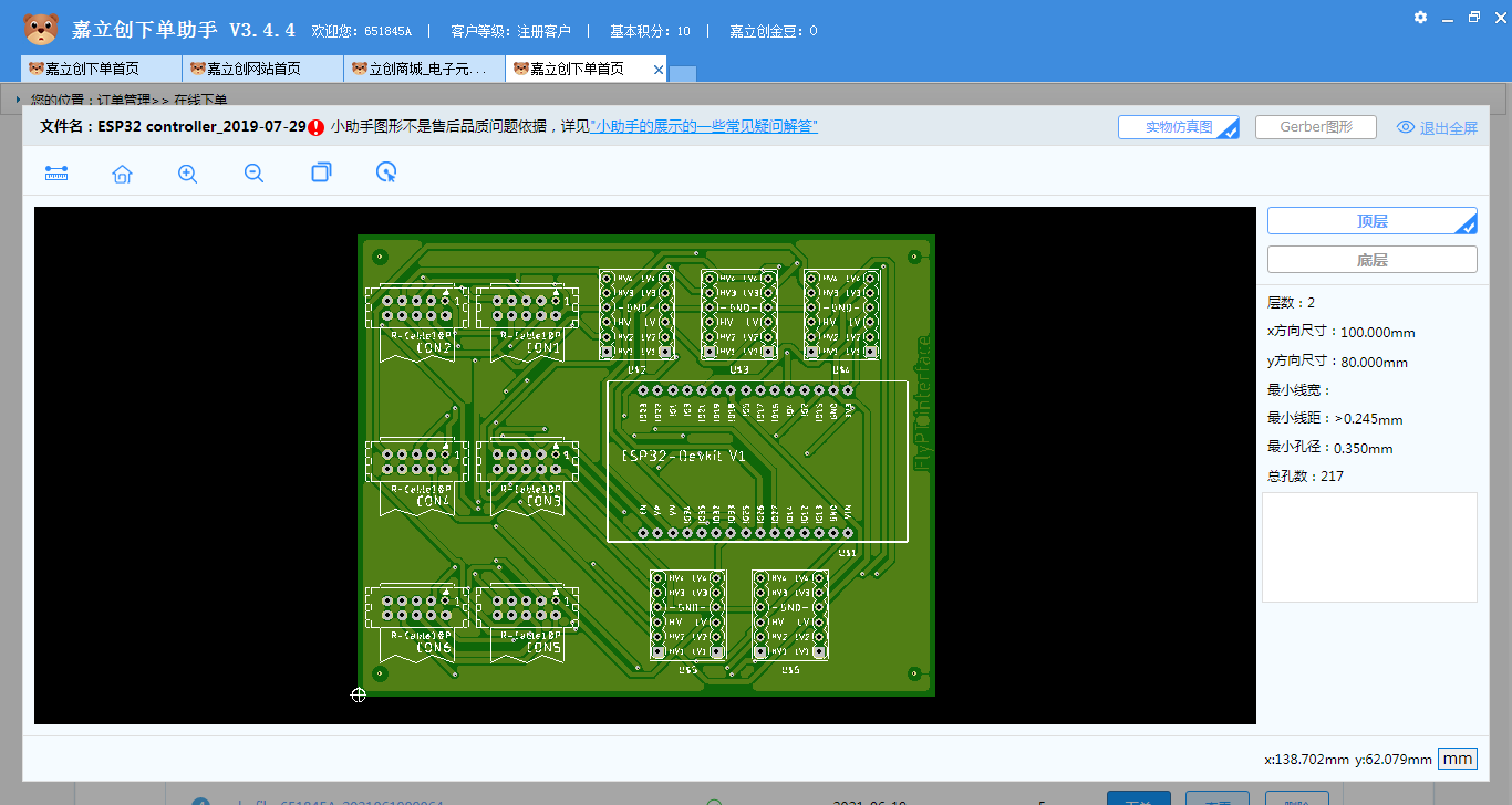

    Racerr87 New Member
    May 5, 2012
    6Coins
    Awesome thread for reading and massive respect for the DIY!
    I was wondering why did you choose an esp32 instead of arduino uno? Would it be possible to control more actuators with the esp?
    Thanks!

    @C.Y and @Racerr87 , the ESP32 is way faster compared to the Arduino.
    Using the AASD15A is simpler and easier to build and with lot's of power.
