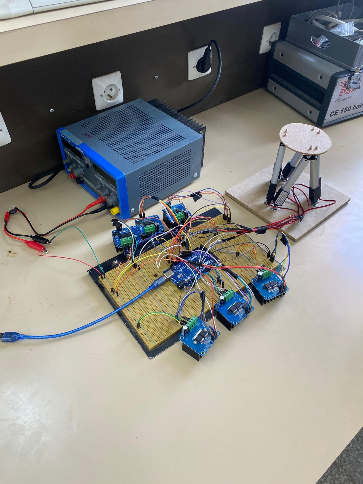

    i ordered another board and I tried couple more times to compile your esp32 code but i had no luck. Its still the same problem, line 185 and 186. Like i said before i google it and found in Arduino forum that some APIs were removed or changed. UGHH.
    So after failure with above i bought Arduino UNO (came today) and for last couple hours Im trying to figure it out.
    Code compiled/uploaded with no issues, Great. I wired 57BLF03 motor to BLDC-8015A driver as per your diagram from page 1. Got 2 microswitches, 10 turn potentiometer.
    This is my driver connection:
    Blue - W, Green - V, Yellow - U
    Red - Ref+, Yellow - HU, Green - HV, Blue - HW, Black - Ref-
    F/R to ard to 2, AVI to ard 3, Grd to ard grd which is also connected to power supply ground.
    2 microswitches and pot also wired and checked.
    When i turn on power, motor spins all the time without uno connected and even with uno connected it only spins. I tried to move potentiometer and press limit switches and nothing, just keeps spinning. BTW both small switches on the driver are in position ON. When i push switch nr 2 to off motor stops but still pot and switches not doing anything.
    I already started building 3dof platform and i was so excited about it.
    Please, any i will appreciate any help.

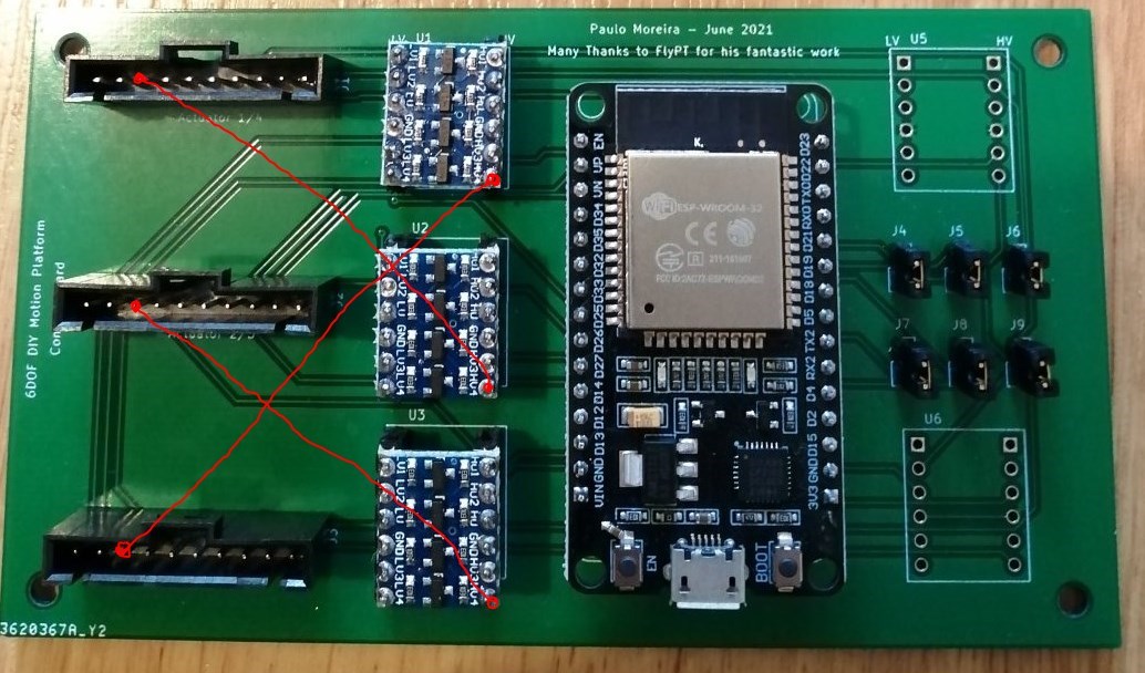

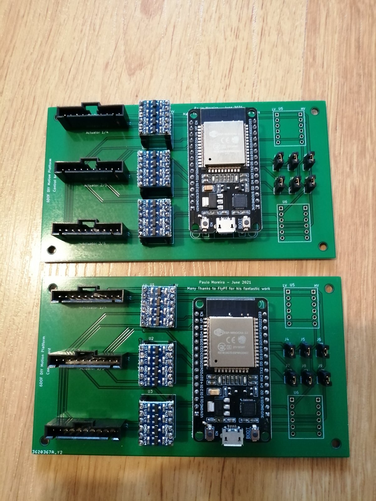

    Hi Paulo, I used your Gerber files and ordered the PCB boards from JCLPCB. I want to use it for 2 DOF FlightSim. I tried to do a Continuity Test on the board using the Schematic on the first page, and noticed that eg.
    - Pin 8 for Actuator#1 continues to HV side, bottom right of Level Shifter #2
    - Pin 8 for Actuator#2 continues to HV side, bottom right of Level Shifter #3
    - Pin 8 for Actuator#3 continues to HV side, bottom right of Level Shifter #1
    Can I use only 2 motor/controllers on this board and which actuator connectors should I connect them to? Thanks!
    EDIT1:
    Upon further continuity test with the multimeter, I see that Actuator #1 to #2 match, #2 to #3 match, but not #1 to #3, some pins were missing. So Maybe I should put my 2 motor/controllers on #2 and #3?
    EDIT2:
    To answer my own question, I connected Motor 1 to connector 1 and motor 2 to connector 2 and it does work, no issues.
