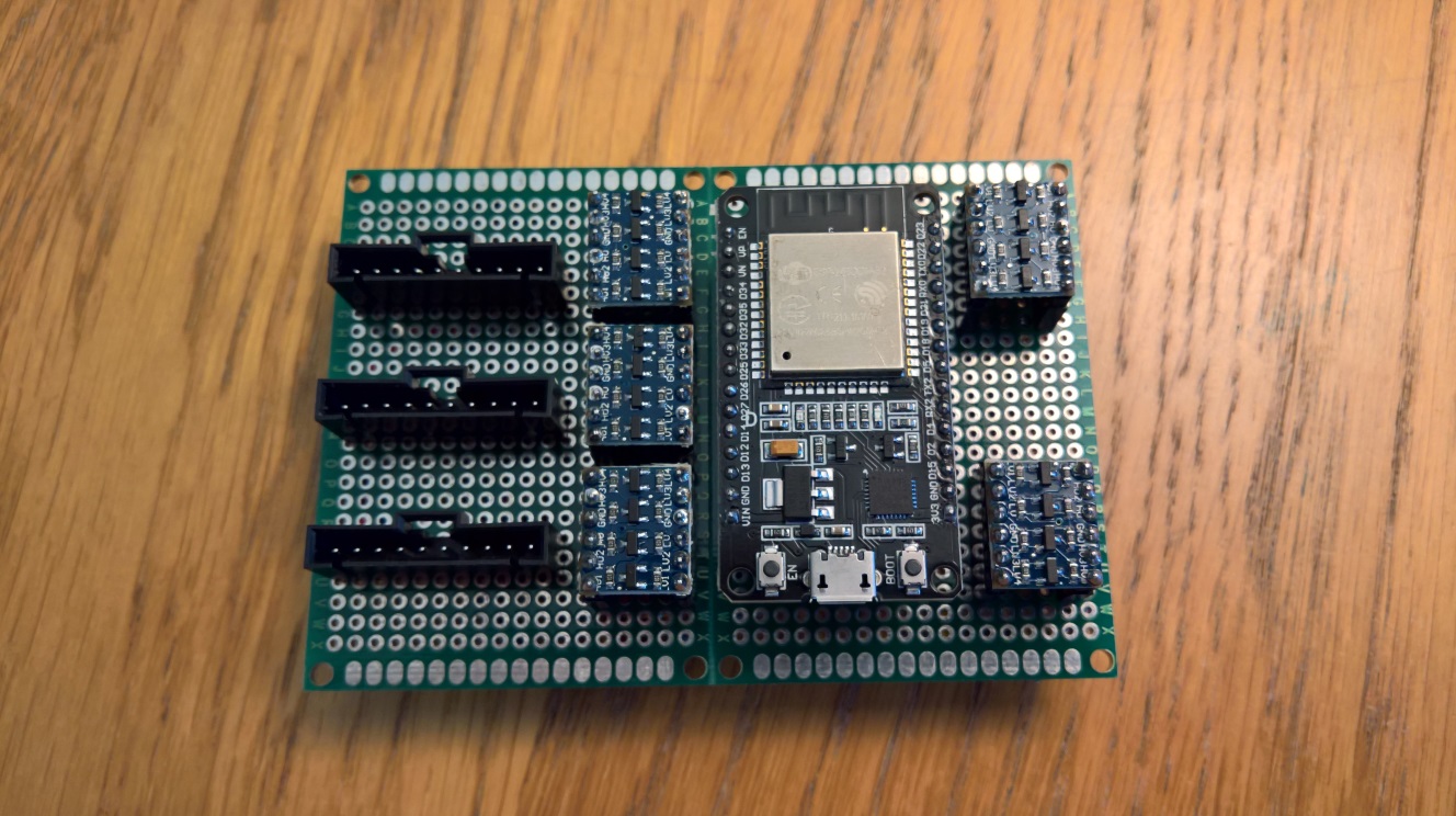

    i ordered up a ESP32 - just trying to get it configured
    did you find any tricks to get it to count an interrupt on one processor and run the main loop on the other ?
  3. pmvcda
    pmvcda aka FlyPT
    Nov 3, 2010
    2,225
    Portugal
    15,639Coins
    +2,662 / 17 / -0
    For a small guide on using interrupts, take a look here:
    https://techtutorialsx.com/2017/05/09/esp32-running-code-on-a-specific-core/
    I have not tried yet...
    By default, it seems that all interrupts run on core 0 (https://www.esp32.com/viewtopic.php?t=3689), so we can use core 1 for other code (setup and loop run in core 1).
    So from above, it automatically separates execution in the two cores if we are using interrupts.
    EDIT: Also this link: https://www.hackster.io/rayburne/esp32-in-love-with-both-cores-8dd948

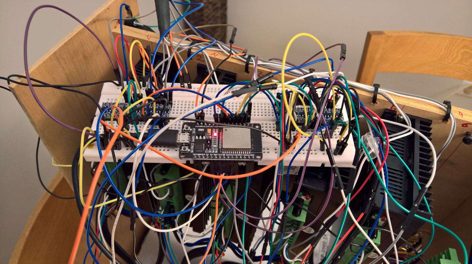

    Got some time,
    it works with 3 actuators! :D
    But I need to clean the mess :confused::

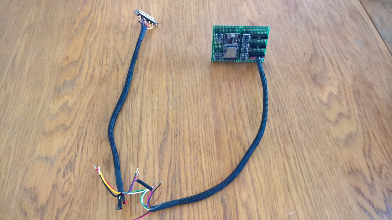

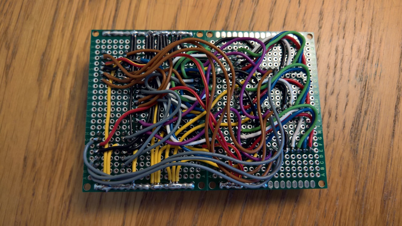

    OK, I got some parts and started cleaning the mess:
    Well, more or less...
    One done, need another one.
    And 6 looms/cables...

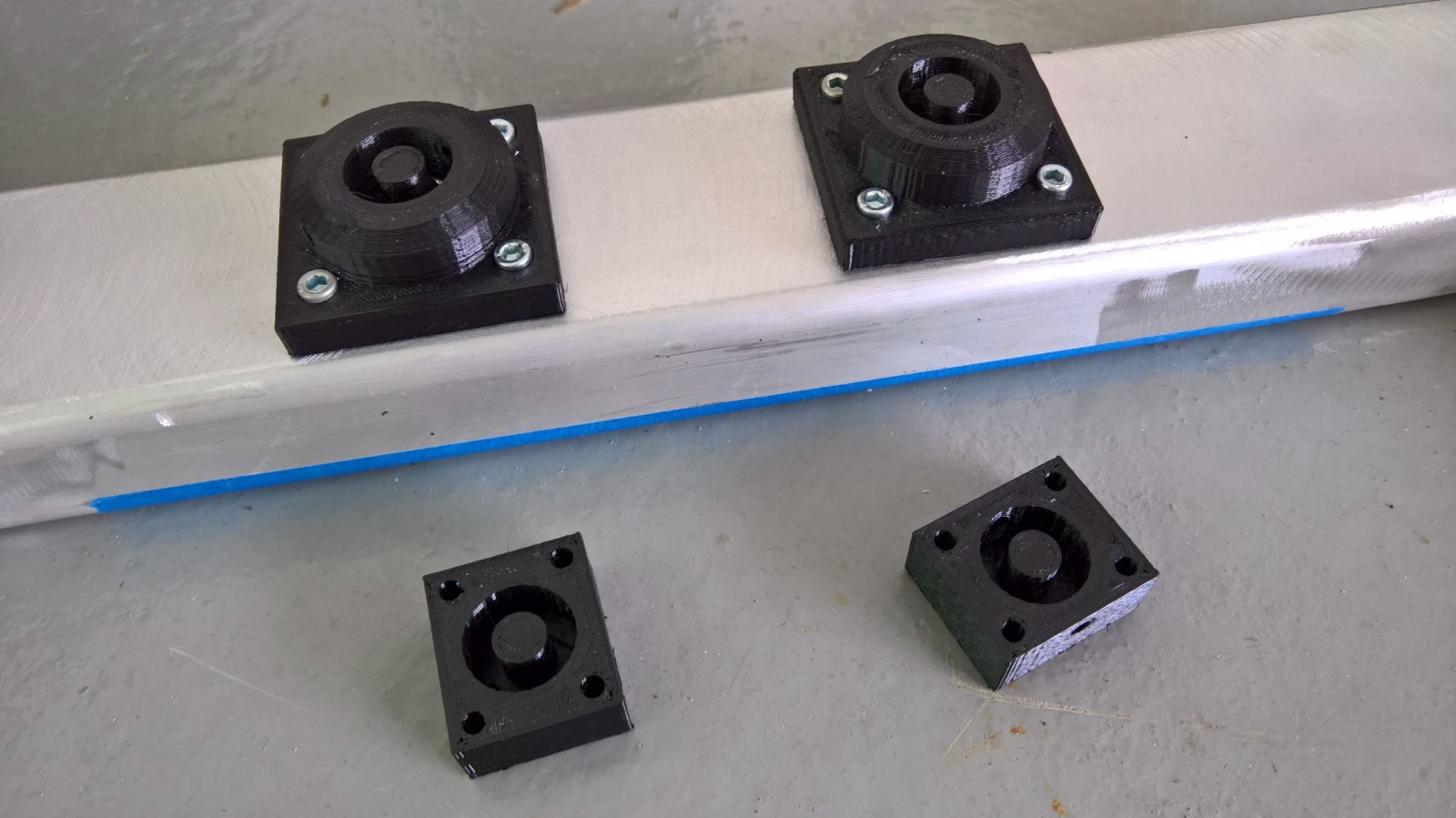

    1 of 6 made:
    I'm also printing the remaining parts to hold the actuators, since I got the base:

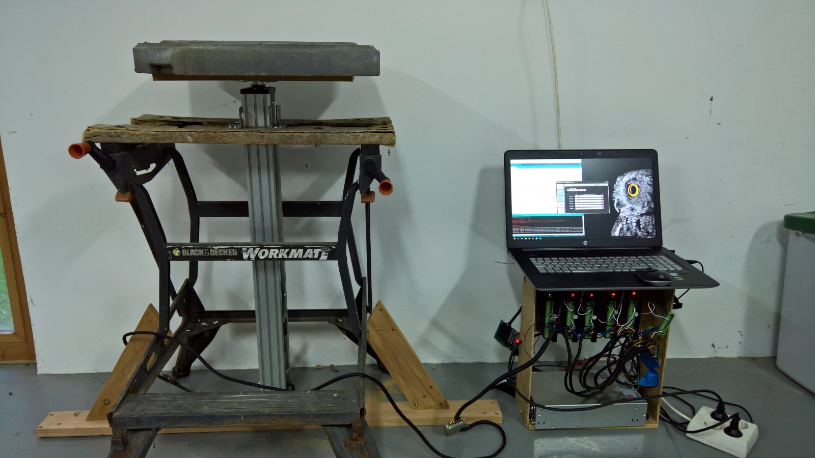

    Well, I made it today:
    Used some weights to hold down sun umbrellas.
    They have 26kg each.
    Unfortunately, I had no space in the phone to make a movie, only pictures.
    I will repeat and make a movie, but the weight was a bit unstable.
    I had 3 weights, and it lift the 3 so 3 x 26kg = 78kg more than enough... :)

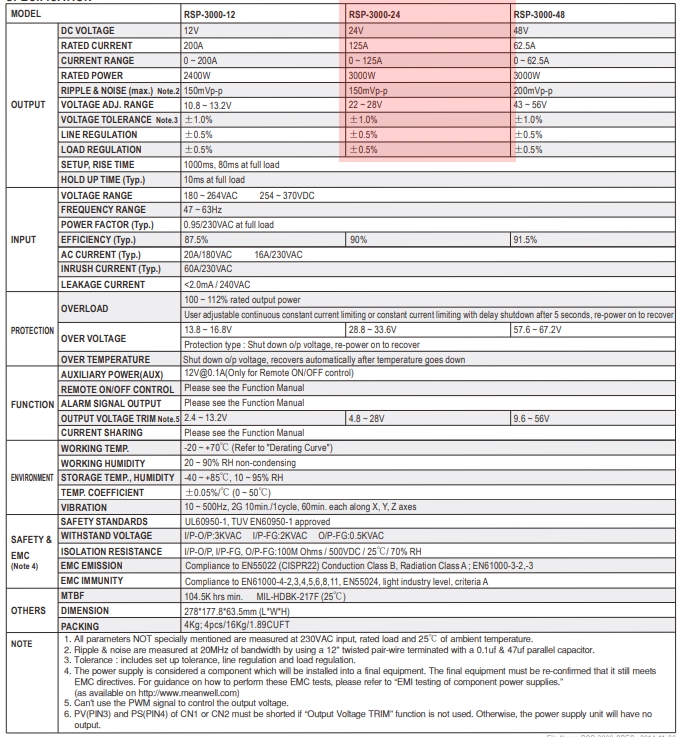

    I have to say that I really love that Workmate. She was stored in the outside for 3 years, at rain and sun, but she's still useful, but I have to replace the wood...
    And, I made one of those stupid mistakes! :blush
    Until now, since I have been testing the actuators without big loads, I had no protection for the power supply, so in the hurry to see the results, guess what...
    78kg going down and some bad PID values = Lot's of EMF.
    So I have to send the power supply for repair :eek:
    What should I use? Diodes? Witch type and values?
    (Taken from: https://www.designworldonline.com/using-power-supplies-with-dc-motors/ or https://blog.uk.tdk-lambda.com/uk/2...-external-diodes-be-used-with-a-power-supply/)
    HELP! :eek:

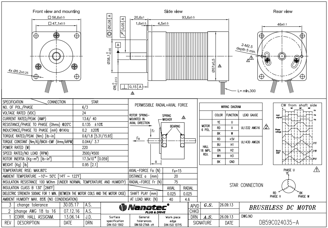

    Motor specs:
    Power supply (in red):

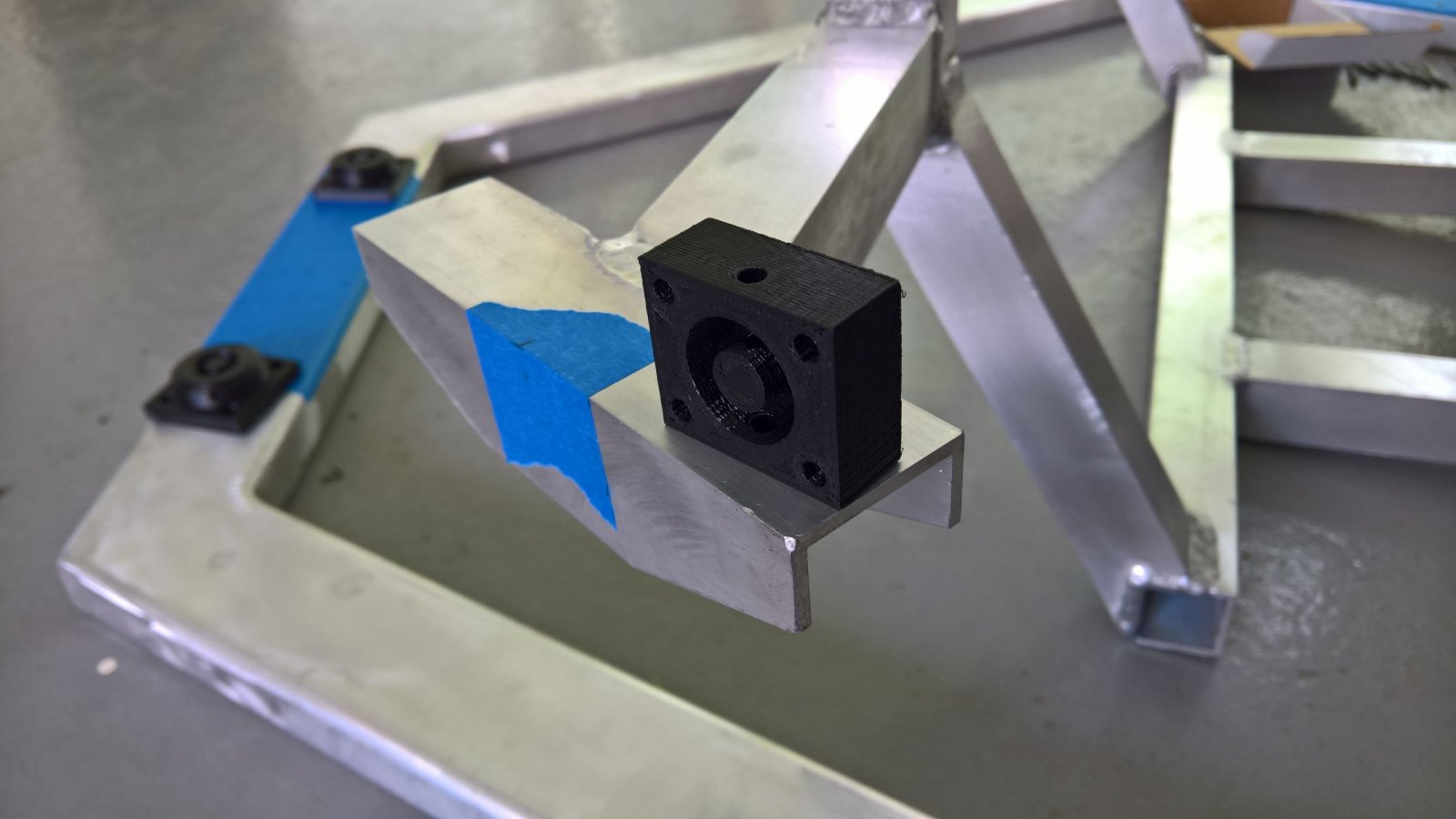

    Meanwhile, I got some diodes, made the new cables, replaced the pots with resistances in the actuators, printed the supports for the actuators...
    Top mount:
    Bottom mount:
    Waiting for the PSU to make a new load test with video.

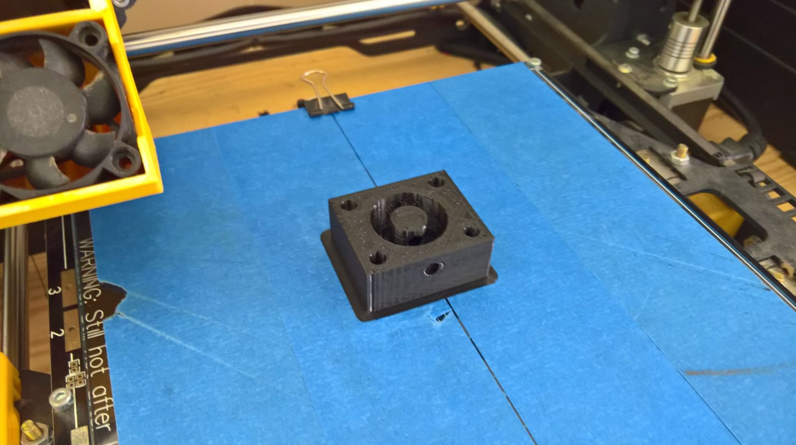

    Looks great. Not long now before I can justify buying a 3D printer. The 3D printed brackets/supports are a big part of the appeal of this build for me as many other actuator designs seem to require complex machined parts. Its also great that you can share the design as I have very little experience of 3d modelling.
    Tell me - does it use lots of filament to make blocks that big? Most of the 3d printed stuff I've seen is quite small. These look chunky. How does it equate in terms of cost of materials?

    I calculated those values as well for my own design, but come to a different result:
    If you apply 0,6Nm to a SFU1605 they should reach a push force of 754N (75Kg). Or did I miss something? The speed of 292mm/s is correct though.
  20. Dirty
    Oct 15, 2017
    746
    All the way up front.
    7,963Coins
    +884 / 3 / -0
    ...could it be that you used the diameter (16mm) instead of the radius (8mm) in your calculations?
