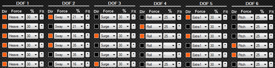

    for example, these are mine for dirt rally, but yours will be different because you have a different distance between mount points of actuators...

    Why Extra1 instead of Yaw?
  10. SeatTime
    2,572
    Yaw is good if you have a 360 degree yaw capable sim, as it is just a direction of heading. For everyone else use traction loss, which in this case is available in Extra 1.
  11. SeatTime
    2,572
    It also depends on how you have numbered and placed your axises in relation to the 'front' of the sim.

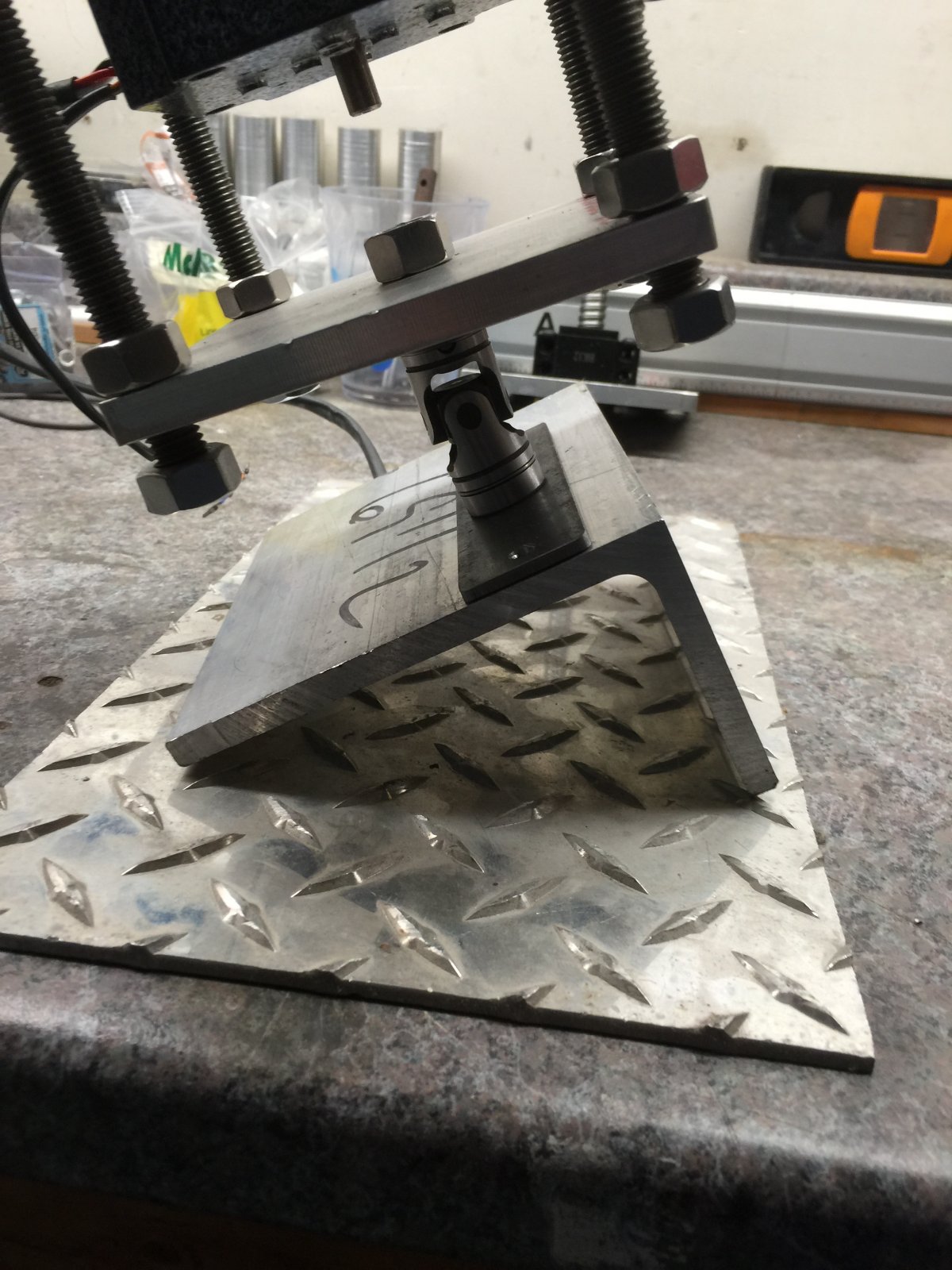

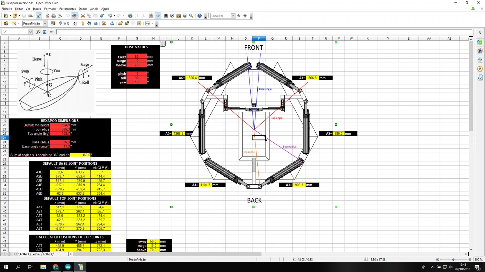

    Now that I have to wait for the encoder card, I will start the base platform .
    I wanted to compare your dimensions with them (photos) I have 570mm of travel but with the limits switch and lineaire bearings the reality is 470mm total.
    The total distance to flexible joints top to bottom is 950mm ( when the actuator is at minimum position).
    When I see your video , the base move a lot with you on your seat !:grinand may be I will do like this for the bottom joint ! ( see pic below) !!

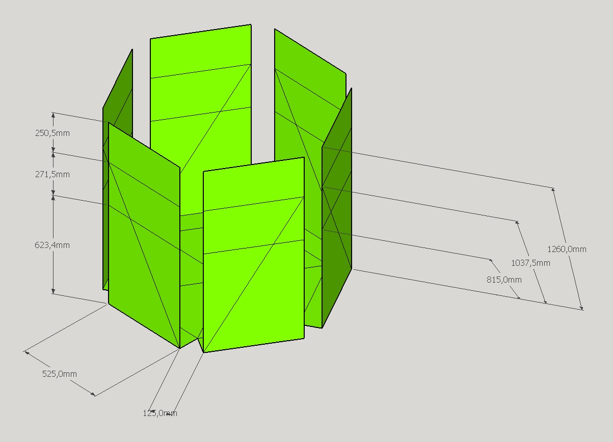

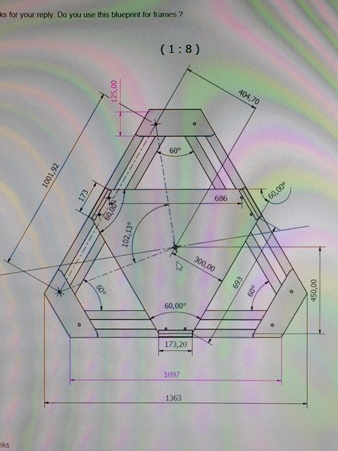

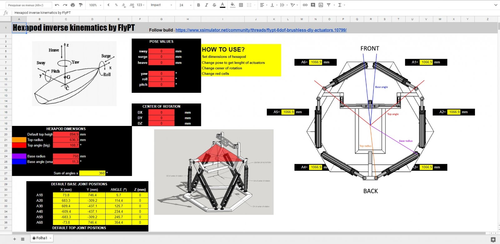

    Those are my dimensions:
    Took a while to make them.
    I wanted to make a "perfect" hexapod.
    Top is equal to bottom with a travel of 445mm (less with limit switches).
    On the right are the actuator travels: minimum, medium and maximum.
    On the left the height of the top structure: minimum of 623,4mm up to 1145.4mm.
    The corners are the centres of the u-joints.
    The actuators are mounted to be on those planes

    Made some tests to find where was the speed problem.
    I thought it was in one of my boards, but after looking better, there are two actuators slower than the rest.
    So the problem is on the controllers.
    I have 2 from ACT motor and 4 from Wantai. So here's the reason.
    Although the specs seems to be equal, they are not.
    Ordered two more from Wantai and I think I will introduce a speed calibration when I calibrate for limits.
    I hope a simple linear adjustment is enough.

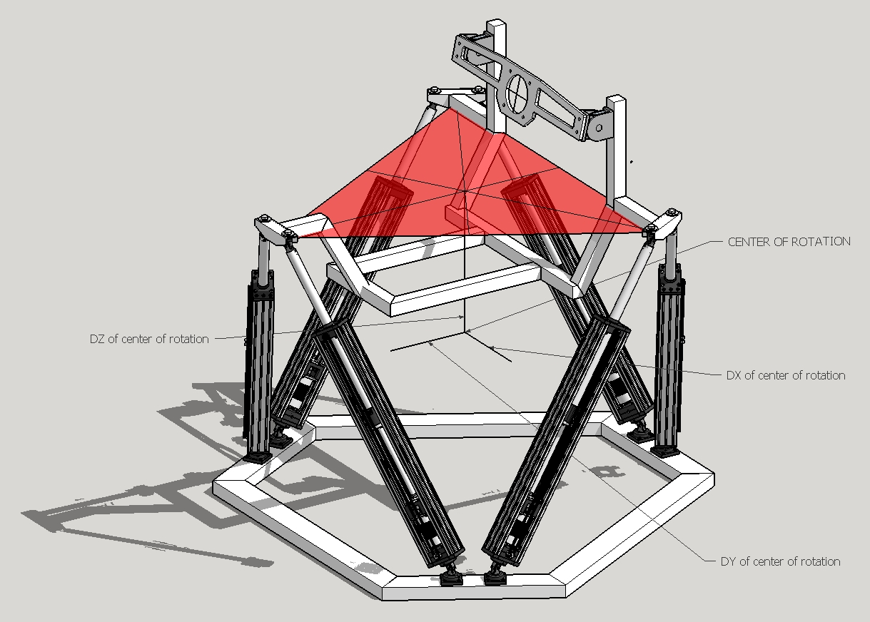

    I got a question for you. When designing your frame is there a rule of thumb to use for your actuators, like at their center value they should be 90 Deg where the 2 join the seat frame or something? If that makes sense?
  20. pmvcda
    pmvcda aka FlyPT
    Nov 3, 2010
    2,225
    Portugal
    15,639Coins
    +2,662 / 17 / -0
    Thank's
    Well, my thoughts where:
    -Smallest size possible, and I think that's almost impossible to make it smaller in this configuration.
    -Made design thinking that with platform at lowest position, actuators still have more than 45º relative to the floor (they have almost 50º, they are made to have axial loads).
    -Distribute evenly all the forces, centring the load the best way possible (seat more at back to compensate weight of wheel and pedals).
    -Actuators at vertical position while having maximum rotation was also something I desired, avoiding all load in one direction (of rotation)
    -Leave space (125mm in my case) so actuators don't colide between them
    -Lower the seat, the maximum possible for access reasons and also lower the CG
    But:
    -At some poses, the actuators can have angles lower than 45º
    -Having the seat lower will reduce some angles compared to the centre of the top platform, since I will also change the centre of rotation
    Check first page of this thread for more dimensions.
