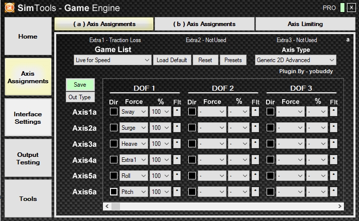

    Just looking at your SimTools mappings. They're all mapped to absolute angles, no Extra1,2,3.
    Do you derive the accelerations in your interface? If so I may have a problem with Aerofly FS2 as the plugin for that has a broken Roll DOF. I always use Extra2.
  7. pmvcda
    pmvcda aka FlyPT
    Nov 3, 2010
    2,272
    Portugal
    15,902Coins
    +2,716 / 18 / -0
    In my interface, you see the pose of my rig.
    What I get from simtools are axis.
    In a pure conversion, I have only 1DOf per axis, so let's say I put in axis 1 100%sway, I will get only sway. My interface interprets axis 1 as sway. axis 2 as surge and so on...
    But I can put in axis1, for example 50%sway 10%Extra1 25%Surge for example. That mix is sent to my interface and she looks at it as just physical sway.
    If I want sway to be affected by Extra1, I just have to add it in simtools.
    I can limit the range of sway. Simtools sends values from 0 to 4095 and they are converted to the range I specified in the interface. For example -100mm to 100mm.
    It's more basic than it looks.

    Thank you – yes I follow. Your diagram showed only the options of setting 100% absolute DOFs but i understand that any normal DOF supported by the plug-in is possible.

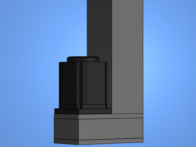

    Hello: pmvcda
    I plan to use your Arduino UNO code to control the actuator. Since the motor mounting hole is not reasonable, I want to install the motor in reverse. If so, the motor will rotate clockwise when searching for the minimum value. Can I change the direction? I need you to give me some help.
    This is the location I plan to install.

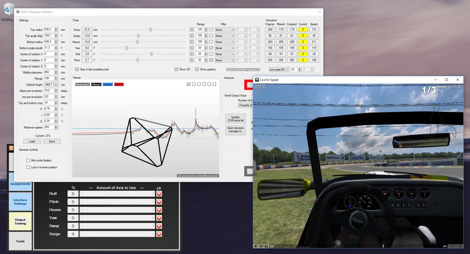

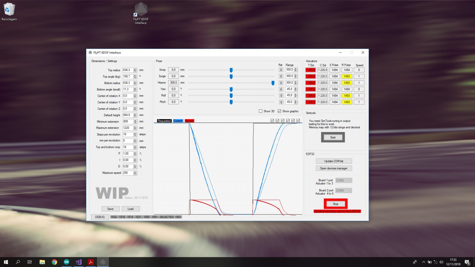

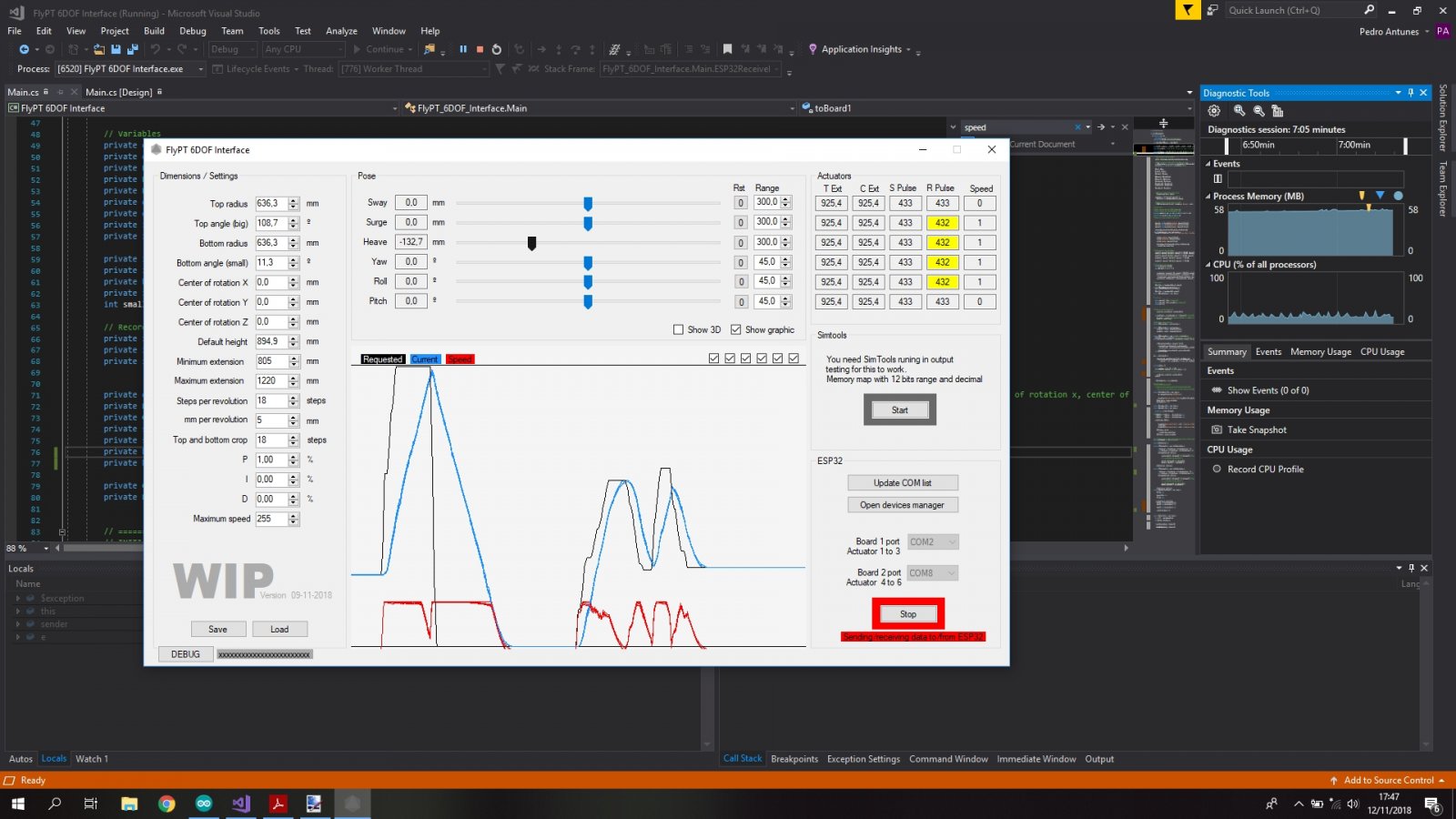

    Well, I thought I could share the software I made to interface with the Hexapod.
    So here's my FlyPT Hexapod Interface (still some bugs and tests).
    What is it?
    It's an interface between SimTools and the 6DOF rig.
    It allows the calculation of actuators lengths, to obtain a determined pose.
    It also calculates the speed of each actuator, so they all reach destination at the same time.
    You can apply filters in the pose components and in the actuators.
    You can change the ranges and invert the pose components.
    There's a 3D visualiser and a graphic visualiser for each actuator.
    All parameters can be changed in real time.
    It's made to work with linear actuators.
    How to setup?

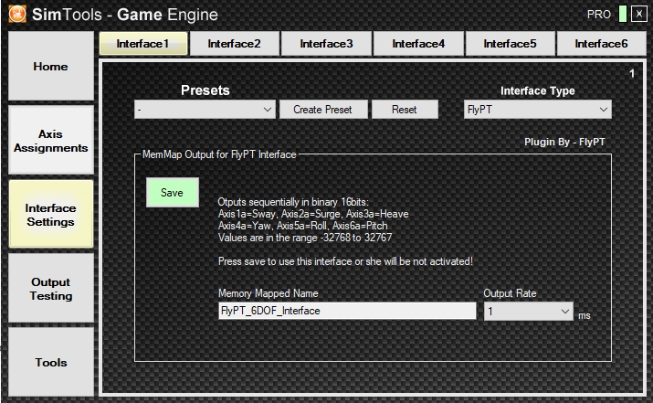

    First of all, install the FlyPT_InterfacePlugin.dll plugin in SimTools.
    For that, just drop the dll in the SimTools Plugin Updater.
    This type of interface, creates a memory map wit 16bit values that are read and recognised by the FlyPT Hexapod Interface.
    Select that interface and press save.
    In the axis assignments put those values:
    The FlyPT Hexapod Interface, uses axis 1 to 6 as sway, surge, heave, Yaw, Roll and Pitch.
    You can for example, add in DOF2 Yaw for Axis4a with 20 value and make Extra1 with 80 to compose the resulting yaw.
    Open LFS for testing.
    Now run the FlyPT Hexapod Interface. (download bellow)
    Connect with SimTools to receive data and see the result.
    You can also play with the sliders.
    Serial is working, but for that you need specific code I will share for the boards.
    I made some recent updates to allow more or less boards and make it more universal.
    Known problems:
    I'm in doubt if heave should be vertical or perpendicular to the top plane (with rotations)....
    In this file, it's perpendicular.
    Some bugs...

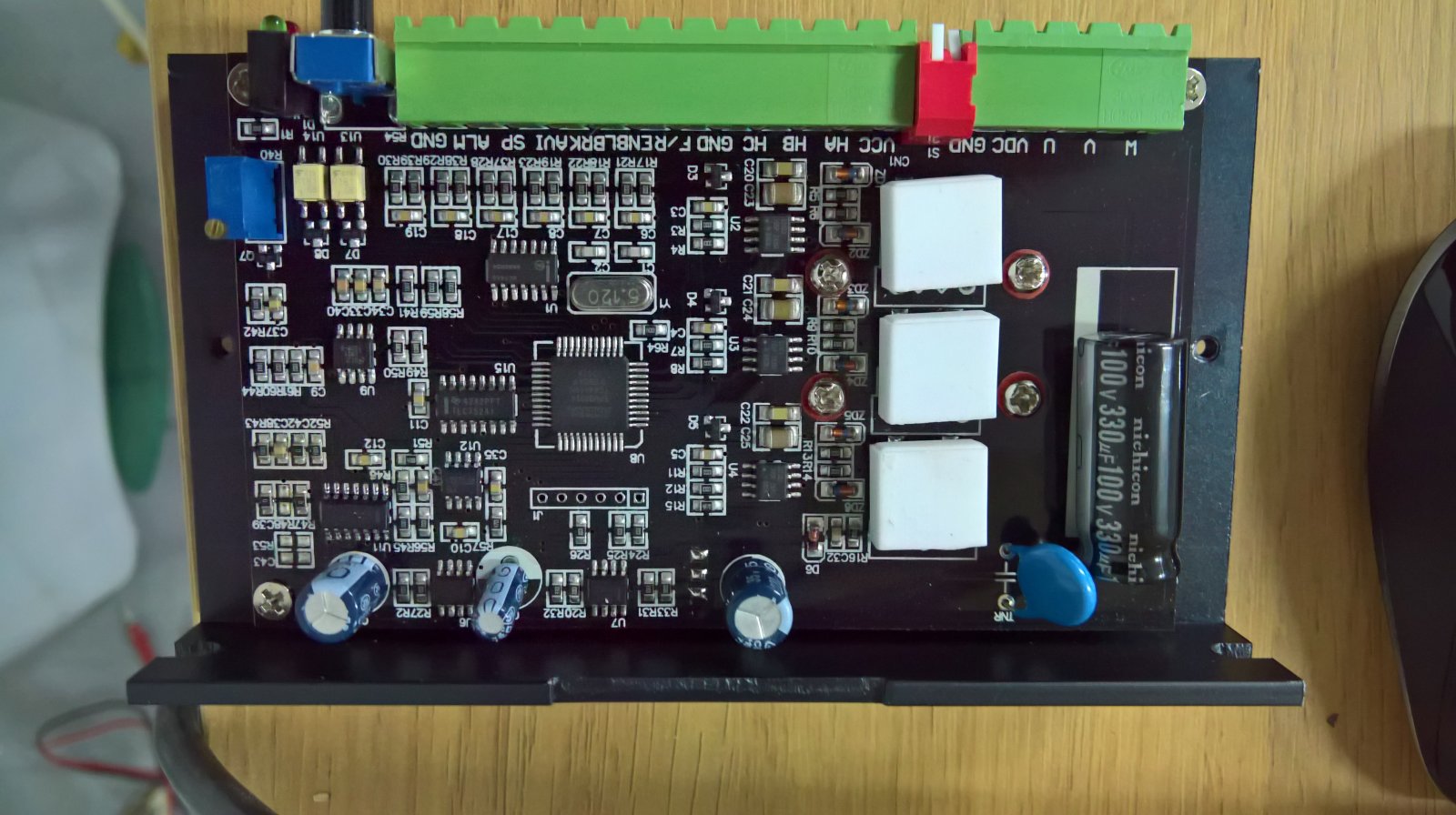

    Hi @pmvcda I have it all setup and installed hexapod utility is receiving all the data from simtools and everything is moving in the animation as it should however my actuators are not moving. I've set the com ports and set them to 500000 as they were when they were in the interface setup before I put your interface in there. Everything says its connected but no movement at all
    Is there something I'm missing ? I'm using SMC3 Sabertooth
  14. pmvcda
    pmvcda aka FlyPT
    Nov 3, 2010
    2,272
    Portugal
    15,902Coins
    +2,716 / 18 / -0

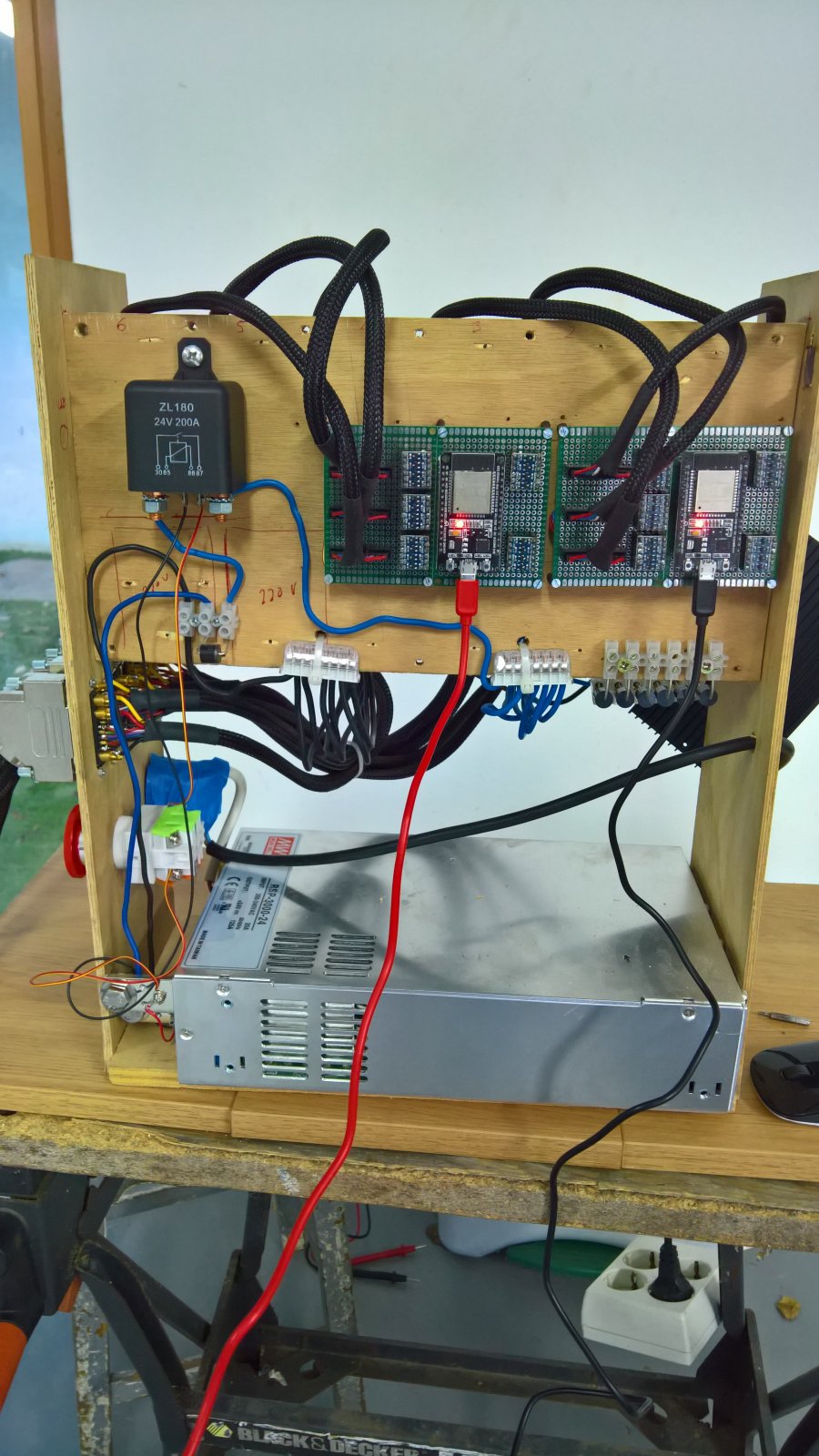

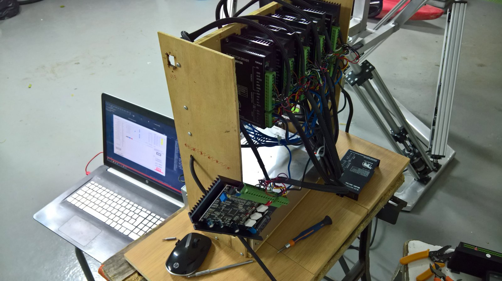

    The current serial output is made for a specific ESP32 code that should be compatible with Arduino.
    But since your controllers are different from mine, part of the code will be different.
    If you can share the code on your Arduinos, I will try to make a compatible version.
    Here's what I'm using right now (but will not work for you):
    Code:
    // DIY 6DOF MOTION SIM BY THE FLYPT
    // SimTools2 ESP32 code to control actuators
    // Actuators use brushless motors controlled by BLDC8015A drivers
    // Position is obtained from internall hall sensors
    // This code is made to handle 3 actuators in one board
    // To use with the FlyPT interface you need two boards with the same code for 6 actuators
    // This code is made to receive position and speed from the FlyPT interface

    OK, I'm making some changes for a serial output without feedback on position and using a user defined string.
    That way, you just have to put your current serial string format in the interface.
    Give me some time...

    Why not STM32?
    ESP is bad in real time staff and interruptions to Chinese WiFi communication code
  18. pmvcda
    pmvcda aka FlyPT
    Nov 3, 2010
    2,272
    Portugal
    15,902Coins
    +2,716 / 18 / -0
    From what I read, the ESP32 is way faster in a single core. Even more using two cores.
    And it's in the same price range. Less than 5€.
    I'm not using Bluetooth or WifFi.
    The main reason was speed and price. Because I count the steps of the hall sensors inside the BLDC motors.
    I can count on 3 motors in real time without problems since I moved this task to another core.

    Well, now it's done and working...
    But I might use the STM32 for my future semi DD wheel and pedals. Have some ideas... some different than the usual ones.
    I'm using my own program to control the hexapod.
    I calculate the extension of the actuators to get the pretended pose. So it's a mix of settings between simtools and my program.
    I use my program to handle limits, ranges and filters(I can make it real time with my program).
    And simtools to mix values and washout.
    But I have not finished the rig, I need to mount the wheel and pedals to make the tests and create profiles.
    Hope it's soon.
