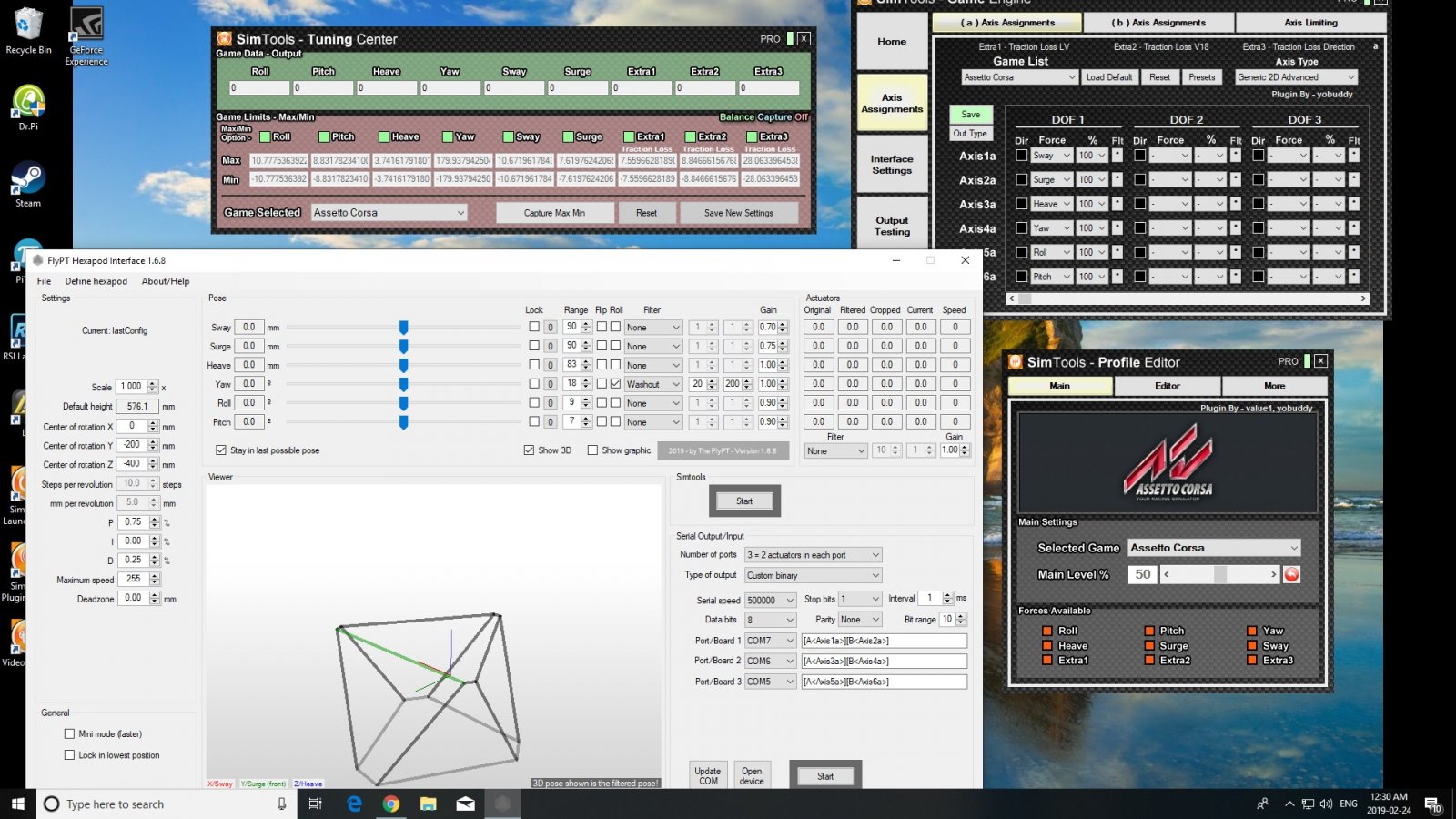

    Works like this (but there's something I will change in next build, see last paragraph):
    Angle is increasing
    If angle bigger than range/2, angle starts decreasing
    When we reach range, we are again at zero
    Angle decreasing
    If angle less than -range/2, angle starts increasing
    When we reach -range, we are again at zero
    So there's a problem here.
    The rig doesn't jump from one side to the other, but while you are expecting to rotate right, she might be rotating left if the angle is to big (more than half the range)
    So if you use the roll over, you should avoid reaching the limits of the range. If you reach, the rig doesn't jump to the other side, but starts moving in the opposite way.
    That's what happens with Yaw on a car sim or any rotating DOF for airplanes.
    So, what the hell is that for?
    Well, you should use it with the washout.
    With the washout, you don't reach the limit easily, because the rig is constantly returning to zero.
    Try the values I have in the image for washout, it was working for me in LFS.
    If you find it to soft, change values or just apply gain.
    There's something wrong here. I noticed after uploading the build.
    I should let go to the maximum range, not just half range and then reverse.
    So for this build use the double of your range value.

    In reality, the function of washout is to remove the need for roll over.
    Roll over is there to use if you are not 100% sure you might not go over the limit.
    That's the reason I say to use both at the same time.
    Next evolution of washout, should take into acount the limits, and calculate washout so everything works in the limits without need for roll over.
    To test this, please make a simple axis assignement with 100% for each axis and DOF
    Axis1a - 100% sway
    Axis2a - 100% surge
    Axis3a - 100% heave
    Axis4a - 100% yaw
    Axis5a - 100% roll
    Axis6a - 100% pitch
    No filters in simtoolos
    washout and roll over in the interface for yaw
    Try making a lap on a track to see waswhout working.
    Try with roll over and with and without washout.
    In the end, it's more important to use extra1 for Axis4a.
    Also, don't forget to change those settings for the profile of the game you are using!
    You might be changing the default instead of the Assetto Corsa profile.

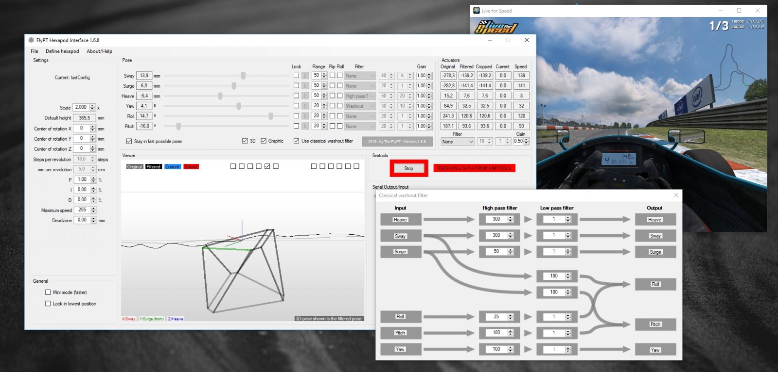

  18. pmvcda
    pmvcda aka FlyPT
    Nov 3, 2010
    2,272
    Portugal
    15,902Coins
    +2,716 / 18 / -0
    :eek:
    The idea is to make it more simple. But that's not an easy task.
    I don't know if my next update is going to help anything.
    I'm implementing a classical washout algorithm.
    For that we are going to have a new window:
    We can choose between this or the previous model.
    Range, gain and flip are still used in the main window, while filtering will be used in the new window.
    Still needs some work because of the roll over.
    Before next weekend it might be ready for testing.
