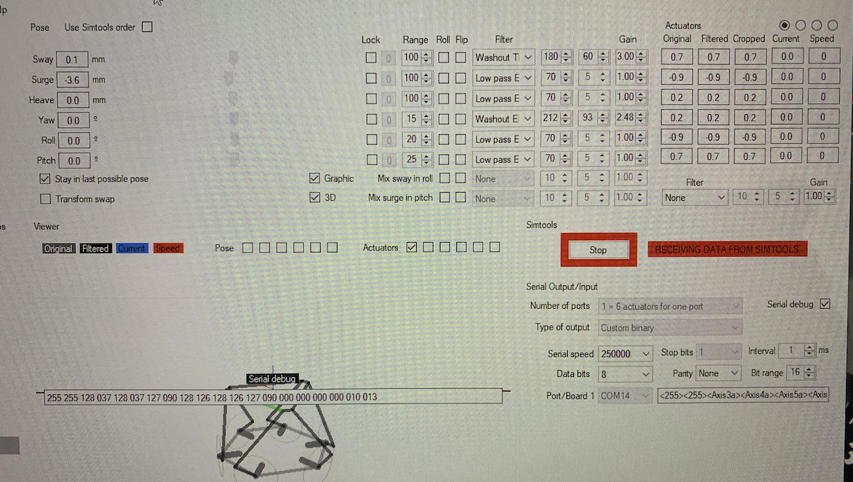

    I am not so far yet.
    Tell me, is there something you can do to make the return of your washout, band pass, less grainy?
    Can it be that the resolution is quite low or there is something wrong tuned in my servos?
    Is it suppose to use all 16bit steps?
    Slower it gets more steps I can feel. Do you understand what I mean ?

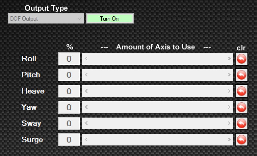

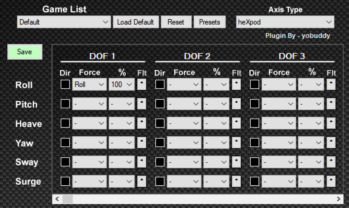

    Hi again,
    Would you agree to change your simtools interface to follow simtools AND heXpod dof interface order?

    There is something strange in your comport speed.
    When you choose 10ms it becomes extremely jerky. The transmission is certainly not updated 100 times a second.

  11. hexpod
    hexpod http://heXpod.xyz
    Apr 18, 2016
    1,222
    berlin
    7,864Coins
    +378 / 5 / -0
    DC motor, 6DOF
    If it’s not unified It can lead into a nightmare while sharing presets and config files.

    I'm just reordering the controls.

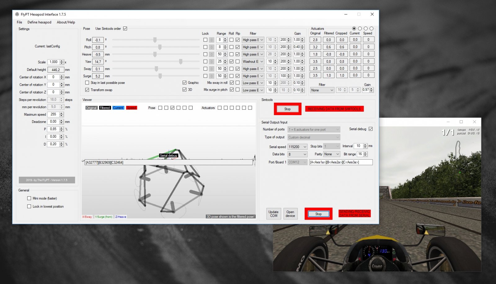

  14. C1500
    C1500 Active Member
    Nov 19, 2018
    165
    1,120Coins
    +86 / 1 / -0
    AC motor, 6DOF
    Hi FlyPT
    I had only short time for testing.
    But...
    Only one thing happen when I press on the start button.
    The Rig goes in lowest position an stops there.
    There was no movement on any slider activity
    I copied the *exe over the existing one.
    The last Version i used was 1.7.0
    Do I have to configure it completely new in every new version or can I use my settings from the older version?

  15. pmvcda
    pmvcda aka FlyPT
    Nov 3, 2010
    2,272
    Portugal
    15,902Coins
    +2,716 / 18 / -0
    Old config should work.
    But you can load the old one and save a new one to remove the garbage (some values where removed from the config).
    Look at the left down corner and see if you have "Lock in lowest position" checked.
    Even if it's not checked, try to change the value and see if it works.
    Also, confirm that the serial config is OK.
    I will take a look to see if there's something wrong, but I was receiving data in my test.

    DC motor, 6DOF
    - serial communication got better,
    - the dofs fits the simtools order.
    The washout still returns in a bit jerky way but it could be my Pid/servo accel parameters.
    Or serial speed, or output resolution, No idea.
    You could maybe try to isolate on a single core.
    Maybe it makes sense in your case
    If you like you could dig into it on your side.
