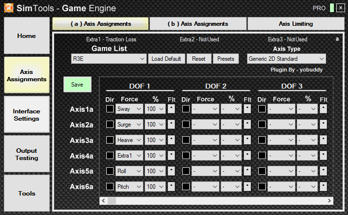

    EDIT: What axis assignment do you have in Simtools?

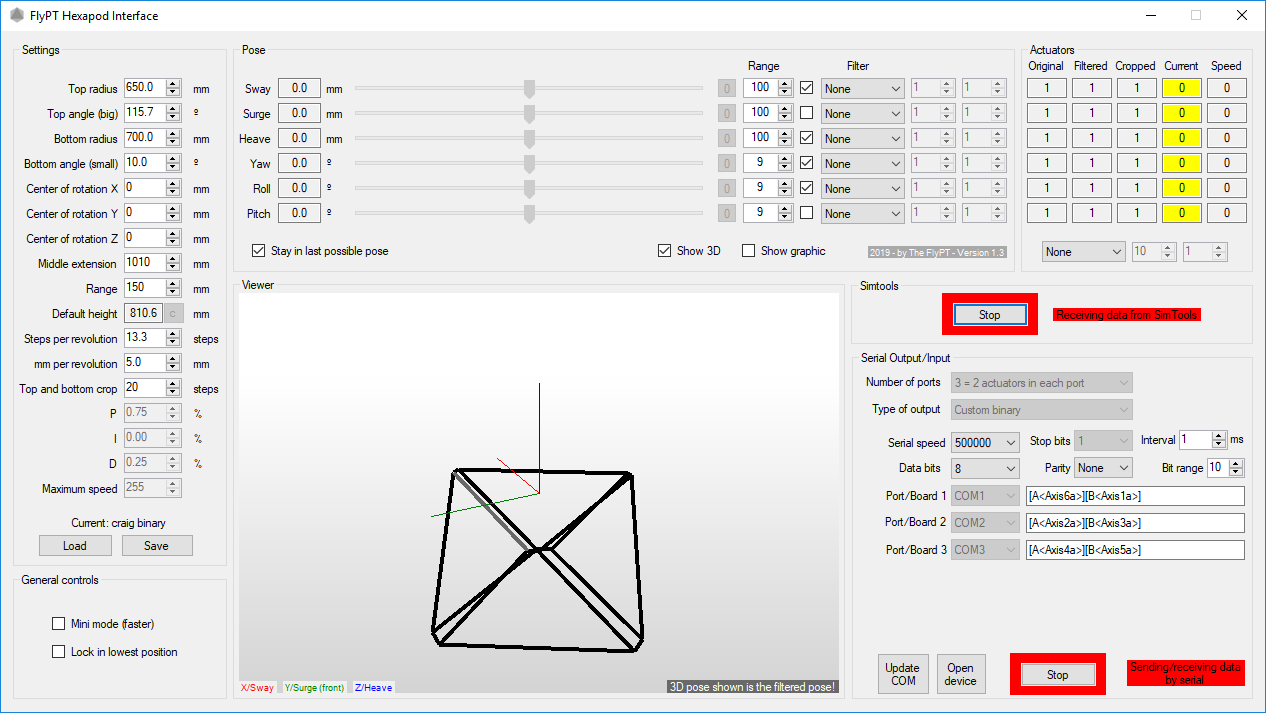

    Ahh yes the filter was turned on I have turned it off will test again in a minute.
    Heres my axis settings
    And my hexpod settings
  6. pmvcda
    pmvcda aka FlyPT
    Nov 3, 2010
    2,272
    Portugal
    15,902Coins
    +2,716 / 18 / -0
    9º on rotations seems low. But I still have to try it on RaceRoom.
    I'm still a bit lost on setting the values.
    Maybe add some Yaw with washout on Axis4a.
    Would be a good idea to compare the movements you have on the rig with what you have on the interface.
    For example, you have 100mm range on yaw. If you move it 50mm in the slider, how much does it moves on the rig?
    You could adjust the steps per rotation value until the values match. >>> Ignore this, it's wrong!
    Then compare degrees of rotation also.
    If you can do that, I can verify if the conversion is being well done or if it needs some change on the code.
    But before that, be sure you have the correct dimensions of your rig.

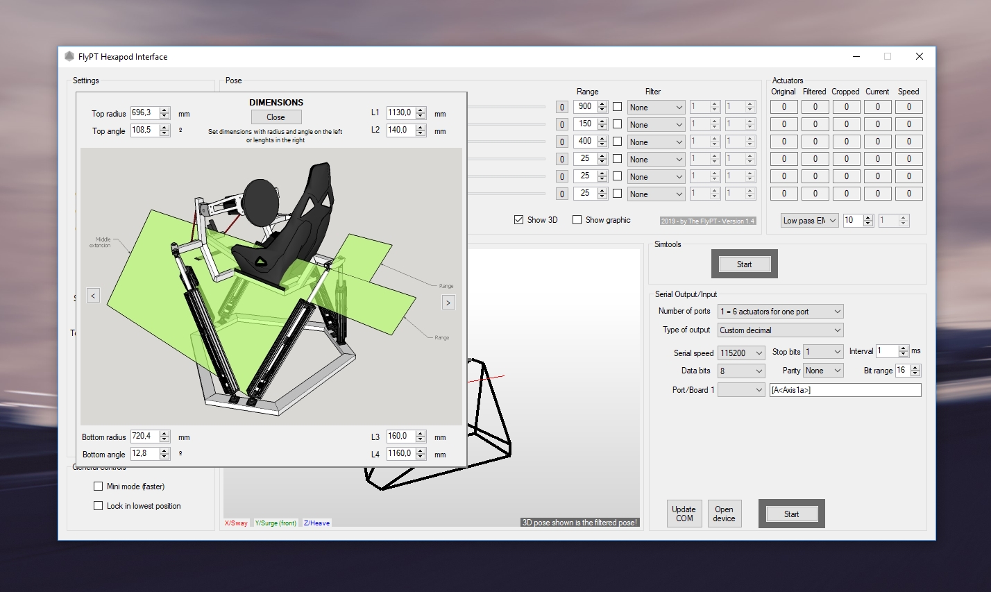

    New version 1.4:
    Added another way of setting dimensions.
    Now we can use angle and radius like before or distance between joints.
    Please insert correct dimensions to get a corresponding movement between the interface and the rig (if sway is 100 mm in interface, it should be 100 mm in the rig).

    Yes, I'm working on rotating actuators.
    I will release a new version, maybe today, with scale adjustment. To adjust values from the program with values on the rig (100 mm in interface = 100 mm in rig).
    I was a bit confused, mixing my rig with usual serial output and was missing this to "properly" calibrate the rigs.
    Meanwhile, I'm adding the rotating functionality in the background.
    But it's not so simple, it must take into account the direction of motors/levers.
    We can have many variations, and the program should be made to handle them all.
    Follow this thread, for the update. Would love you to try and make some tests, since I don't have a rotating servo rig to test.

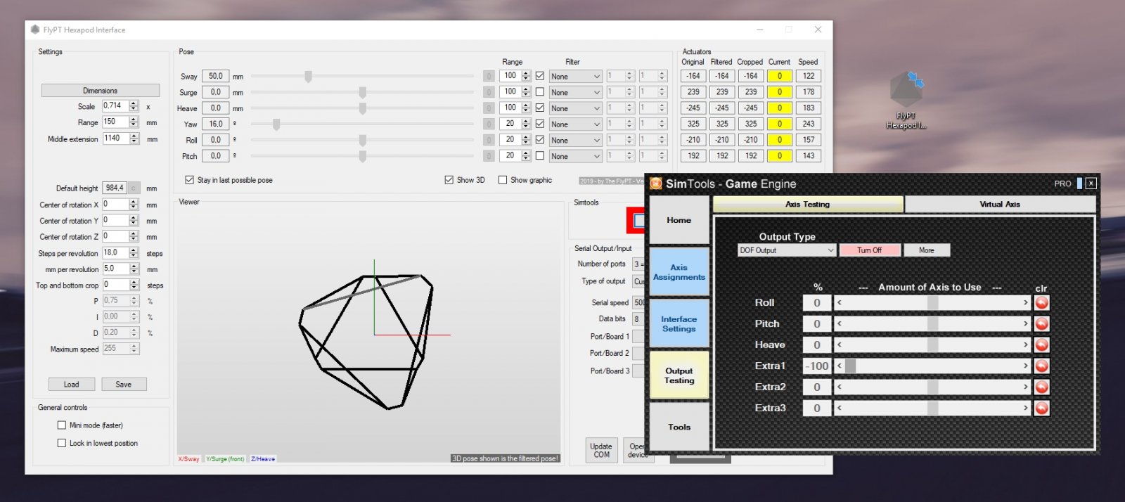

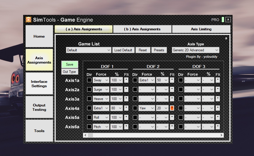

    Just an heads up on using traction loss with this interface.
    I don't know how Simtools obtains traction loss. For me it should be reproduced naturally from the physics obtained in the games.
    Even so, we can use the following setup:
    To make the rig rotate around an axis at the front, reproducing a rear traction loss.
    And if it was a front traction loss? Well, how Simtools calculates traction loss? Have no idea. I thought it would come naturally from the games pose. I'm confused.
    I have to make a game plugin to understand it better.
  16. SeatTime
    2,572
    To me it just another sway, that you set higher so that it take move sway to get a noticeable output. Maybe it's the best that can be done with the available data?
  17. pmvcda
    pmvcda aka FlyPT
    Nov 3, 2010
    2,272
    Portugal
    15,902Coins
    +2,716 / 18 / -0
    I have to take a look at the LFS plugin to see what is being used for traction loss.
    I don't know if it's calculated/estimated by simtools or a parameter received from the game.
    I doubt the game would output such data, at least for a sim.
    If it's calculated, might be sway affected by speed, the same value of sway from the game at low speed might have a gain to increase it's effect and is treated as rotation. I don't know really.
    But I'm really curious and I will know.
    Like I said above, if someone wants that effect on the hexapod, mixing Extra1 in sway is currently the only option for my interface.
    Using 50% Yaw(extra1 as traction loss) in Sway results in rotation around the front of the hexapod:

    Its calculated. It uses the vehicles orientation vs global orientation or something like that. When they aren't the same the vehicle is experiencing traction loss.
