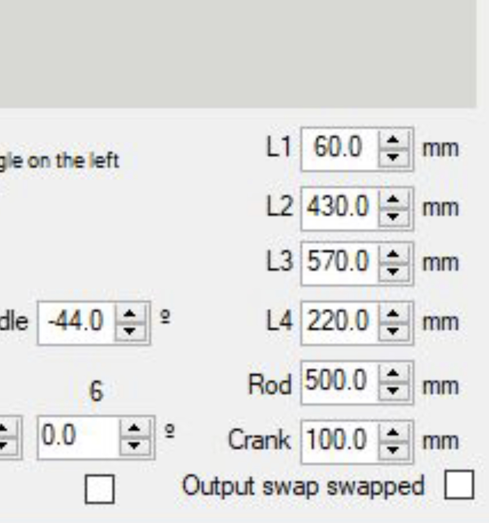

    Hello guys. Still I can't figure out why my DOFs are swapped to AMC1280USB. Roll is pitch, yaw is heave... Etc.
    I use hexpod interface from @hexpod without any problem so I don't want to change settings on AMC board. What do I make it wrong?

    Double check your string:
    <255><255><Axis3a><Axis4a><Axis5a><Axis6a><Axis1a><Axis2a><0><0><0><0><10><13>

    +89 / 0 / -0
    I've checked it more than double :) And I've tried lots of different motors order. It's weird yaw and heave are always swapped, but with your hexpod interface everything work well. Honestly :) I have no idea whats wrong with it. My rig is upside down, I mean front side back, :) but yaw and heave cant be swapped because of that.

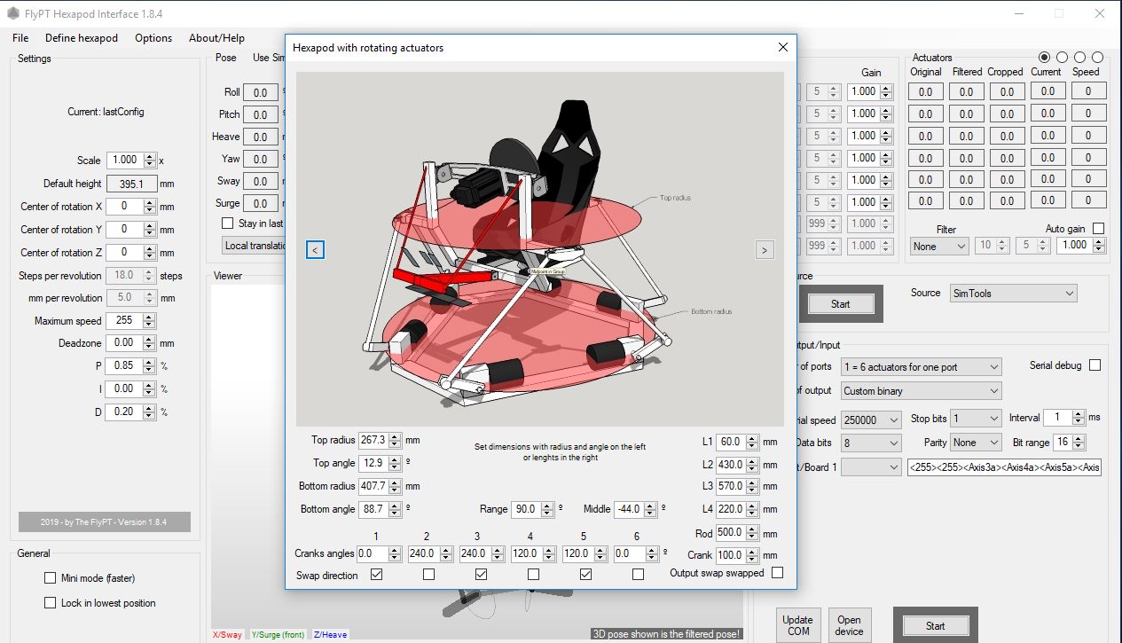

    +89 / 0 / -0
    I changed geometry in the actuator setting, like in attachement.

    Ok, in FLYpt there is a checkbox to invert the bit output 135, 246.
    Output swap swapped. try this

    +89 / 0 / -0
    sorry I can't find that. Where is that checkbox?

    +89 / 0 / -0
    OMG...I found it finaly.. thank you :rolleyes:
