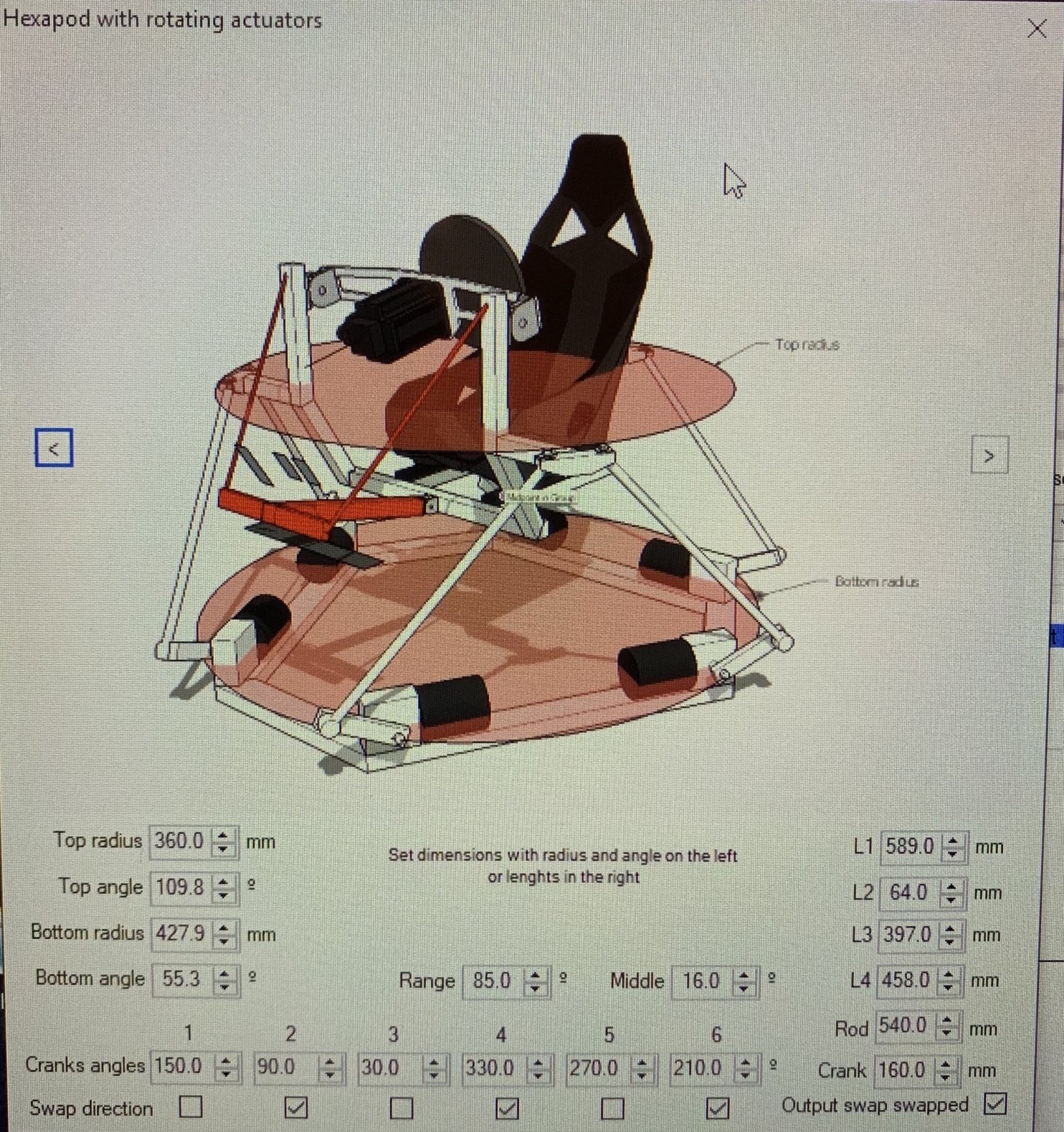

    Can you show me the rig measures.
    I might have to change the way I calculate the angles.
    In some positions we have more than 1 solution. So I cheated a bit to make it faster by ignoring that.

    More or less this is it:

    Was testing with measures you gave me and the values I can see in the video.
    You have 109º range for roll (the value you are changing).
    I don't think you can achieve that value on the rig. At least with the seat mounted on the top platform.
    Since you have a smller top platform compared to the bottom one, maybe it could be possible.
    I can't achieve the same you have. I think the dimensions are not the same.
    But I'm taking a look at the formula to see if I can limit it to the maximum angle specified. I think that in the video you have more than 85º range.
    But I saw a bug already. I'm not correctly identifying when the rig is out of range. So the program is showing some crazy poses as possible while they are not possible.
    EDIT:
    Also you have stay in last possible pose checked.
    So what happens in those jumps is that you where in impossible positions and when you reach a possible one it seems like the rig jumps.
    Look at the thin lines to see it moving.
    If you uncheck last possible pose, the crank/rod are shown in red, specifying an impossible pose.
    I have a new build that also makes them red when you have an angle beyond the specified range (it was not happening).
    I want to verify some more things before posting that build.

    Yes I pushed the intensity to 109 only for testing purposes.
    Also I use greater angle as 85 to use full kinematic range.
    Indeed in my software I have a complex equation for out of pose which is independent from dof limitations and doesn’t need the arm limitations either.
    You seems to deal differently with this
