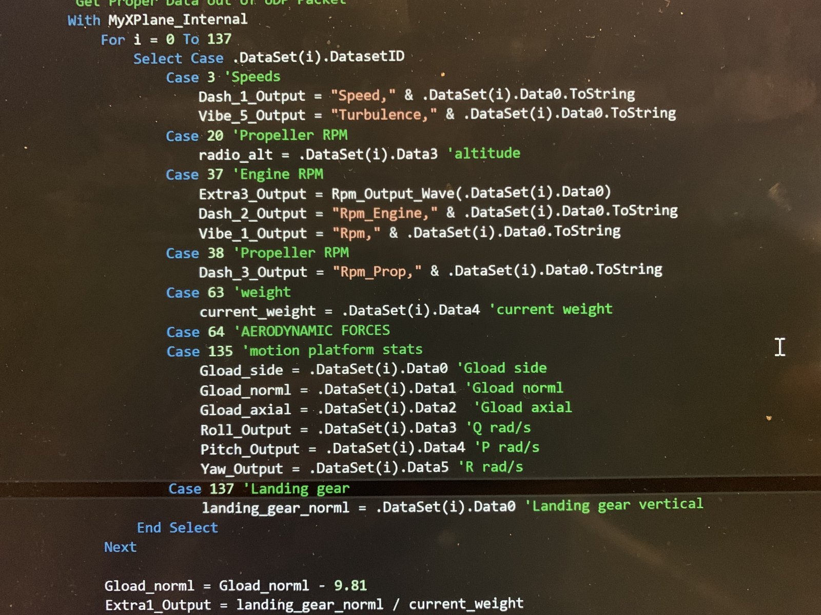

    Sorry, I gave wrong info from memory.
    Landing gear is nr. 137, I am dividing the current weight (nr. 63) to make it aircraft independent and mixing it with Gload norml from “ motion platform stats” (nr135)

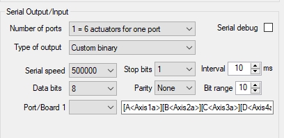

    I don't know if it works, but maybe try this:
    Put in port the port you are using and
    [A<Axis1a>][B<Axis2a>][C<Axis3a>][D<Axis4a>][E<Axis5a>][F<Axis6a>]
    I don't know if you really need the start/end sequence.
    Taken this from videos of other DOF rigs on youtube.
    Don't forget to update the rig dimensions.

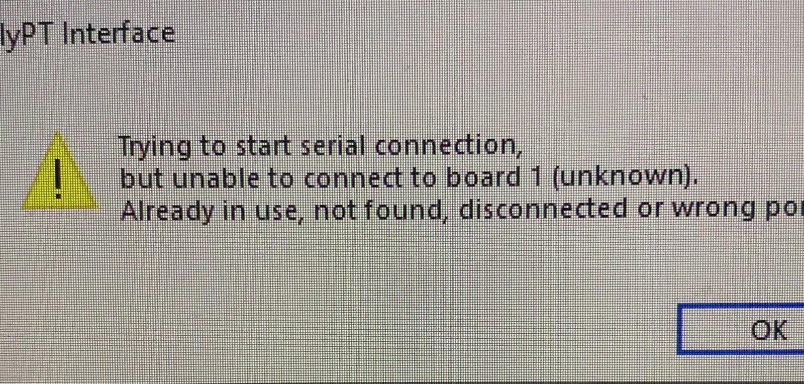

    Do you guys have connection or re-connection issues of the comport or it’s only me ?

    No issues at all here

    Thank you for your feedback.
    Shall I understand that you never getting this dialog,
    also when you close and relaunch FLYpt,
    or when you press multiple time start/stop button in the bottom right corner of the interface?

    I have never had that issue. Or any connecting to my controllers for that matter.

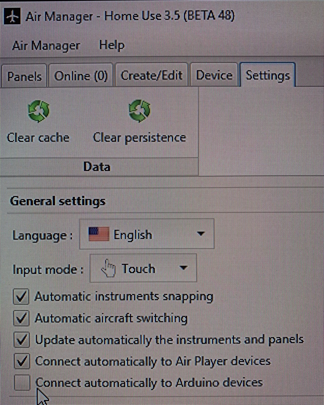

    I found it.
    My air manager soft was trying to auto connect to Arduino devices.
    Unchecking solves all issues.
    Thanks for your feedback
