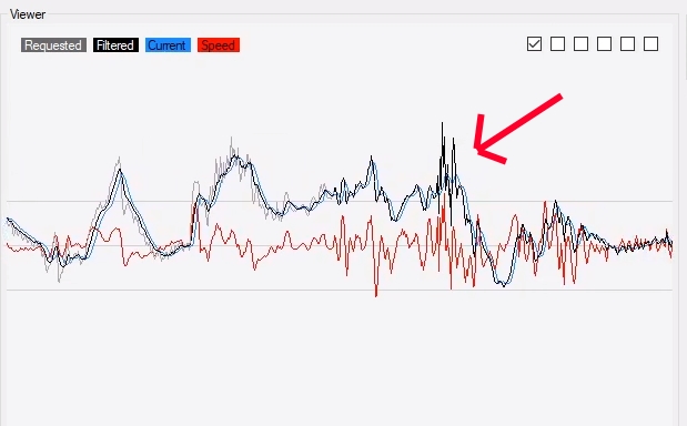

    Currently in the FlyPT mode, I'm using 16 bits, but I only use a small range. Since I needed 2 bytes to send the info, why not use all the bits.
    The way it works, needs the same bit range for send and receive, because I'm comparing the values to calculate speed.
    I think using the board for speed calculation is better.
    I don't know the board well, but it's certainly faster to make it there and without problems of communication.
    I even got a STM32F4 to make it, but I need some free time for that.
    Advantage of my method might be the PID tuning (real time adjustment/results), but that's something that we need to make one time and leave it.
    For those using Arduinos or something similar, my solution could be interesting, but mostly to achieve a speed calculation that relates all actuators (you can't connect all actuators on the same board).
    In practice, we receive so many position updates from the games, that this speed calculation might not have any interest in this application.
    But imagine another type of application that sends periodic positions and needs smooth transitions between positions, then we need that feature for sure. Something like a CNC hexapod based machine.

    Yes, that's the reason I made that speed control.
    What I make is pretty simple.
    I only have speed control on my controllers, so since P is the predominant factor in PID, if an actuator lags behind, in the next loop of calculation he might get a speed increase.
    With cheap controllers, I can't get them to have matching speeds. They don't answer the same way to the speed input, there are differences.
    Only match is steps I get from the hall sensors. So if one is getting behind in steps, the distance to travel increases and I increase the speed.
    What I make is test witch actuator as more distance to travel.
    Calculate the PID for that one (can be maximum speed or a low speed if near destination)
    Interpolate that speed to the other actuators, depending on distance to travel.
    That way, if one of them goes to fast or lags behind, he's corrected in the next loop.
    Data is sent in bytes. Each byte is 8 bits, so blocks of 8 bits. One byte can send a value from 0 to 255.
    That's what I show in debug.
    When you send in decimal/text each char uses 1 byte also.
    To send a bigger value you need more bits.

    The AMC1280USB calculates the PID position internally based on calibrated values. Its not receiving the position calibrations from the PC, but rather the target positions of the actuators.

    No, the PID loop in closed inside the AMC. It only accepts target positions. Send to is more detailed target positions closer positions to each other and you will get slower speed. Send to it large differences between positions it will go max speed. The speed is handled by the PID.
    @pmvcda sends pre-calculated steps to his servos so half of the PID is open and thus he is sending the speed as well to manage the rate of the steps to the servos based on the pulses feedback from the servos. At least that's how I see it work for his servos.
    Thanos

    It's different, I don't see how to use it and no benefit.
    What I make is calculate speed with PID.
    PID uses the current position received from the board and the position we want to calculate the speed.
    I could send just speed to control the board, but, I also send position.
    My controller has one input for speed and another one for direction. So it made me go that way.
    I'm using position just to decide direction, But It's a stupid consequence of how I started the code.
    I could make it faster and with less data needed, just by sending speed.

    I understand what you mean.
    (I'm going to repeat myself, but for those who doesn't understand what we are speaking)
    What I have done with speed, was because I can't have the 6 actuators in one board.
    To adjust speed between 6 motors, you need to have info from the 6.
    It's preferable to have speed control on the board instead of the PC. That's why I got an STM32F4. Just to try that.
    As I said before, only advantage to have PID on the PC is to have a easy way of tuning it, because I can make it real time.
    In my build, there's no "PID adjustment".
    P, I and D have fixed parameters specified by the user in the interface.
    What is adjusted is speed and that adjustment depends on PID parameters.
    It works pretty good in my opinion. We could adjust parameters, depending on travel, load, .... but it's an unnecessary load for the calculation, at least on my build.
    What I have right now, doesn't make that rotary compensation.
    And it's almost impossible to do it real time. I think you need inverse kinematics for that, and it would not compensate to use it.
    It depends on relative position of top joint and rod/crank joint.
    But I think for our kind of application, it's not necessary.
    There's a way to solve this.
    Imagine you want to make a displacement between two far apart positions.
    If you jump right away from the start to the end. without speed adjustment, you get the nearest actuator to reach destination first and last the one further.
    With speed adjustment it's "soft" for linear actuators, but "oscillating" for rotary actuators, but they reach destination at the same time.
    The rotating actuator produces speed variations dependent on angle and top joint position. That's what originates the oscillation.
    But if you split that translation in 100 steps, you don't notice that oscillation. More steps, less oscillation.
    What I mean is calculate intermediate positions of the top joint, not intermediate positions of the rod/crank joint rotation.
    So to solve it the idea would be to calculate the intermediate positions and pass by all of them to reach destination.
    But for our application, we are constantly receiving position updates, mostly small, some big.
    The small ones you might reach the position, but the large ones, you never reach them, because motors can't follow that update speed.
    When using the interface with the sliders, we move the slider and stop at a certain position. But that doesn't happen while playing a game. It's always moving.
    In practise we are already making those 100 steps.
    When speaking of load distribution, in my case it's automatically adjusted, because I increase speed if actuator lags behind (if I increase speed, I also increase torque).
    He might lag behind, because of load or because the controller is not so good, but the idea is that he recovers the position by increasing it's speed in the next update.
    This is my point of view right now, from what I feel on my rig.

    Took this picture from one of my videos:
    In blue, actuator position (real one)
    In black the position we wanted
    In red the calculated speed
    You can see that the actuator is unable to reach the asked destination, and there's always some lag.
    Oh, in grey is the calculated position, but I was using a low pass filter on the actuator, because with so much variation, the red led on the controller was always on. To many changes of direction and to fast.
    Something I learn in Engineering, is that real world is not a basic math world. There's always something more interfering.
    You can go near and near, but the cost of math would increase exponentially.
    So calculating ultra precise motion cues and all that and in the end we forget the mechanical/electrical part of the equation.
    All this is interfering in my next update, and I'm struggling with the auto calibration, (but also some other minor things) where those peaks should be ignored.
    Most of the out of range alerts we receive in the interface are of positions we never get near mechanically due to the lag we have in the motors...
    We have to look at the big picture, not only a small detail.
    Note:
    That position feedback for the interface could be good to calculate motion cueing. But since most people don't have that feedback, I'm completely ignoring it for now.
    It's already hard as it is.
