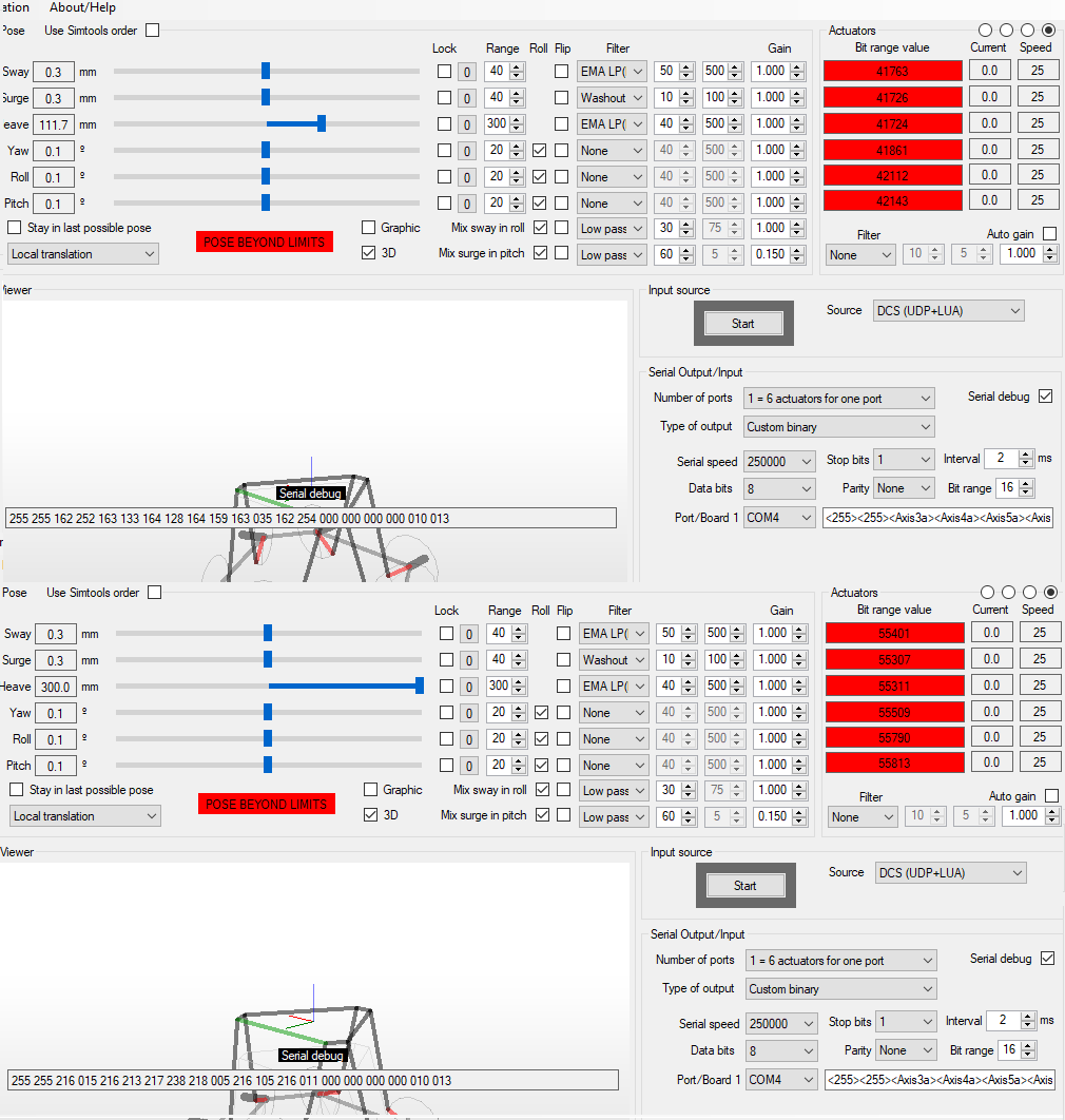

    <255><255><Axis3a><Axis4a><Axis5a><Axis6a><Axis1a><Axis2a><0><0><0><0><10><13> <<<< CORRECT STRING!
    I don't know why I couldn't find it. Walked away for a while and sat back down and boom, found it. Still haven't found it on the first page though, where I kept seeing posts direct me to find it!
    I'm so excited, the graphical sim has me very very optimistic that this may solve the last of my smoothness issues. Amazing work FlyPT. Just positively outstanding. What is looking to me like it should work is the triple LP filter.
    I need to really, really ease it into motion, but then let it accelerate up as fast as possible before slowing down to stop. Short of the triple LP the start of the motion still looks far too sudden for my rig. I'm bouncing up and down in my chair with excitement LOL.

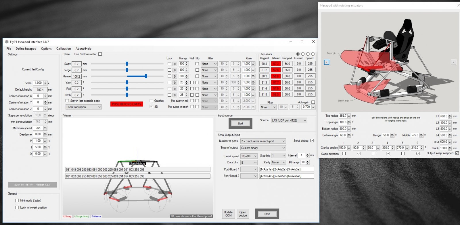

    This is your rig at upper limit, you can have almost 100 mm heave up, around 65º
    In red are the calculated values, at their right what is sent to the actuators. It's cropped to the limits defined.

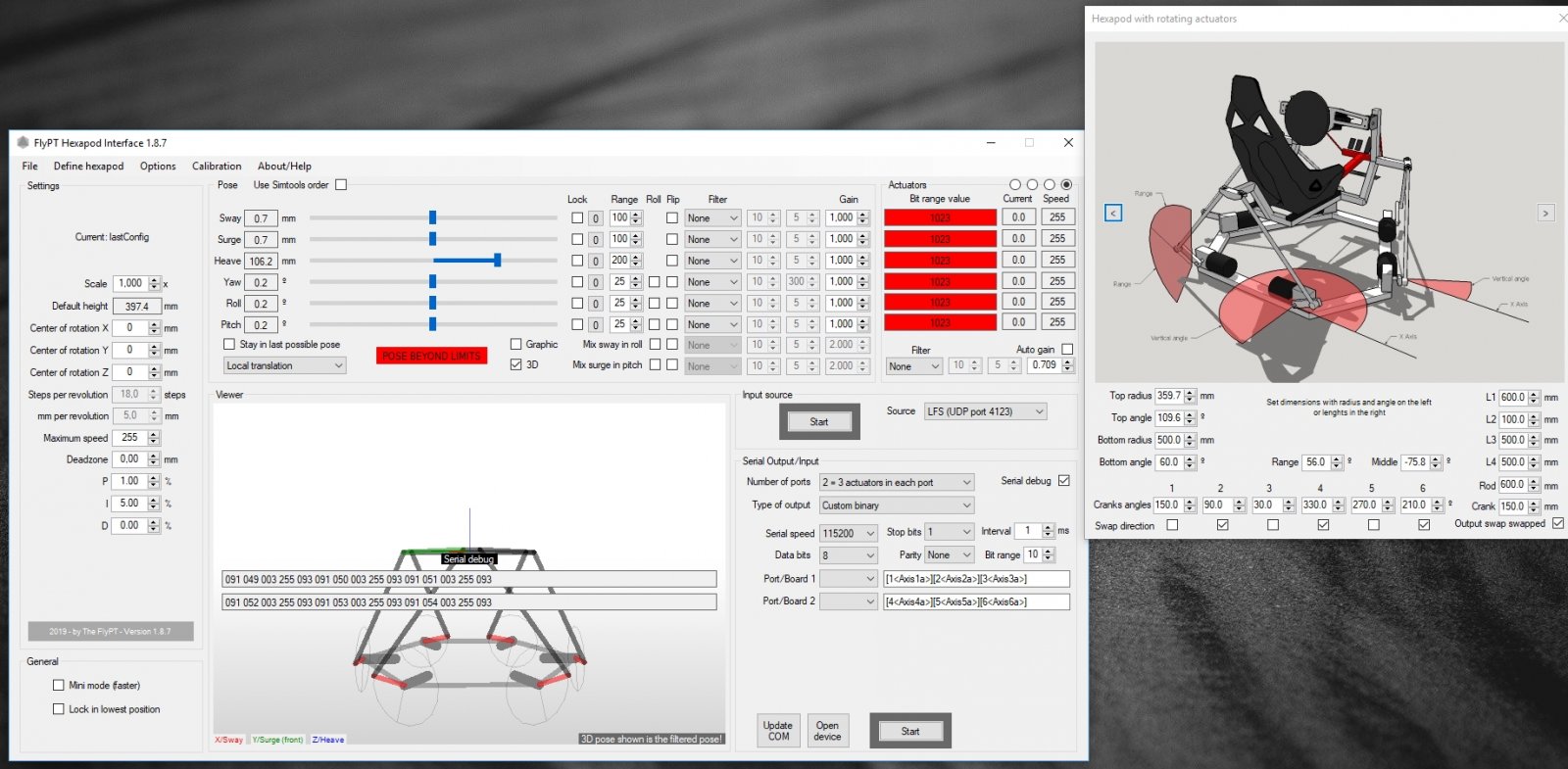

    This is the same position, but showing the bit values sent to the board (bytes over the 3D view)
    In red the bit range (I made it for 10bits)
    The value is cropped. When you move outside of range, the actuator as always the same value. Not the ones inside their range.
    There's some differences due to rounding and maths simplifications.

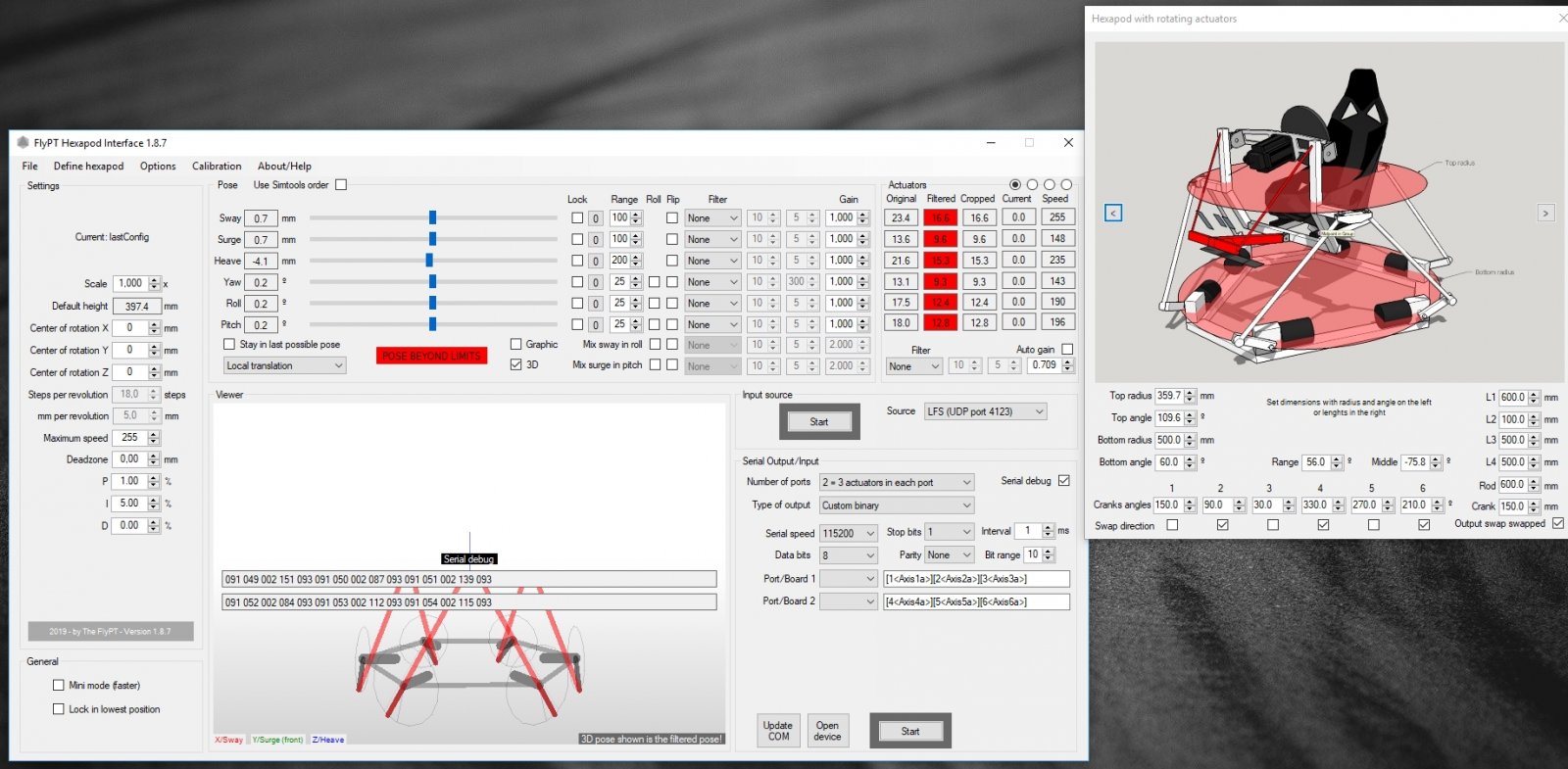

    Here, the rig at it's lower position:
    That light green line in the circles is the middle.
    You can't even reach the middle without going through an impossible position.
    At around 13º (-4mm heave) you have an impossible position for your geometry.
    You need to change this.
    I would remove the springs that limit your travel, and make 10 to 15º your middle and something like 80º range.

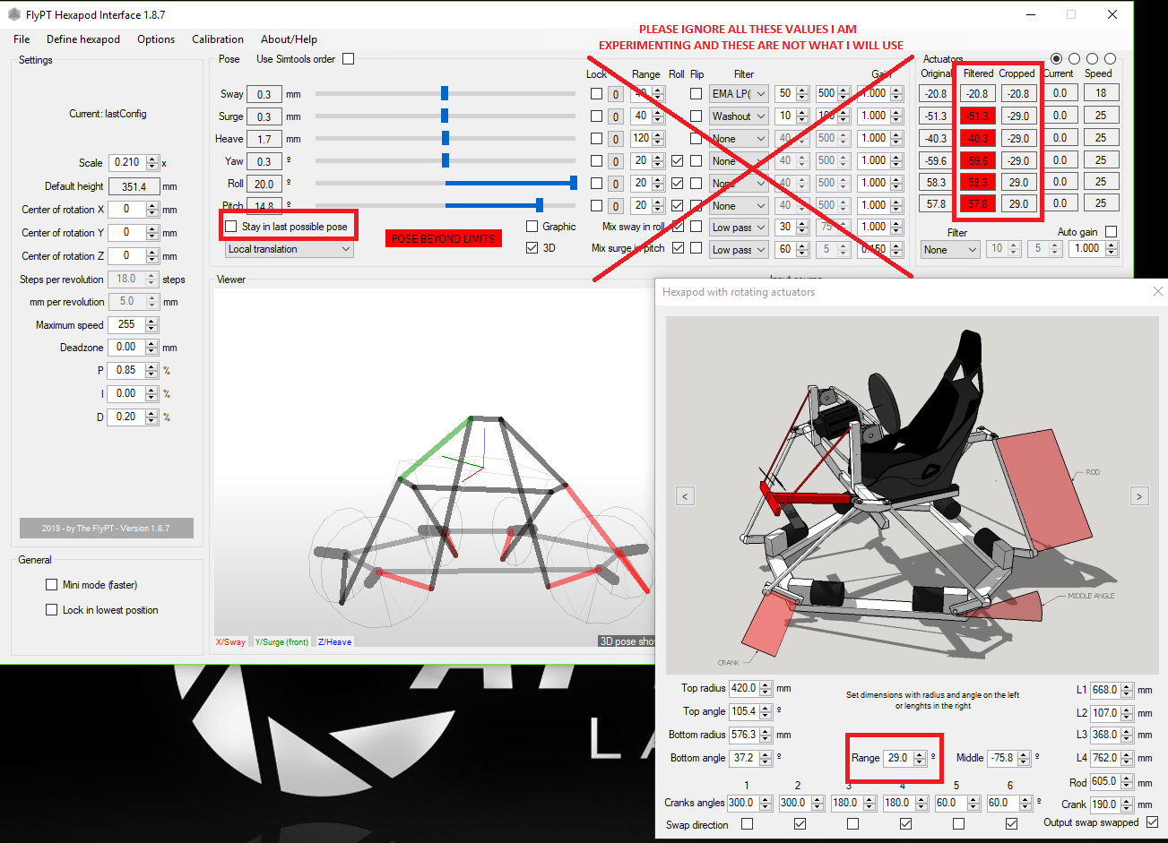

    We can discuss the rest later, but right now the problem is that what you said here is not happening. When I move the actuator outside the range the value continues to change. Unless I misunderstand, this image should show it.
    I moved it to out of range with heave, that is first screenshot. Then I moved the slider farther over and isn't it showing that the bit value changed? And I can tell you, actuator keeps moving!

    I can not remove the gas struts at this time. The simulator works well for me! I just need to not have actuators go out of range and I'm happy. =)
    The way you suggest it is the way it was for over two years! It shakes and vibrates like crazy without the struts. Now it is nice and smooth and I find the range adequate. In the future when I have more time I will try again without the struts and with correct angles using your software and the filters, but I think it's going to shake no matter what I do with software.
    If the image I posted just above does not show the problem, then I am very confused. =)
