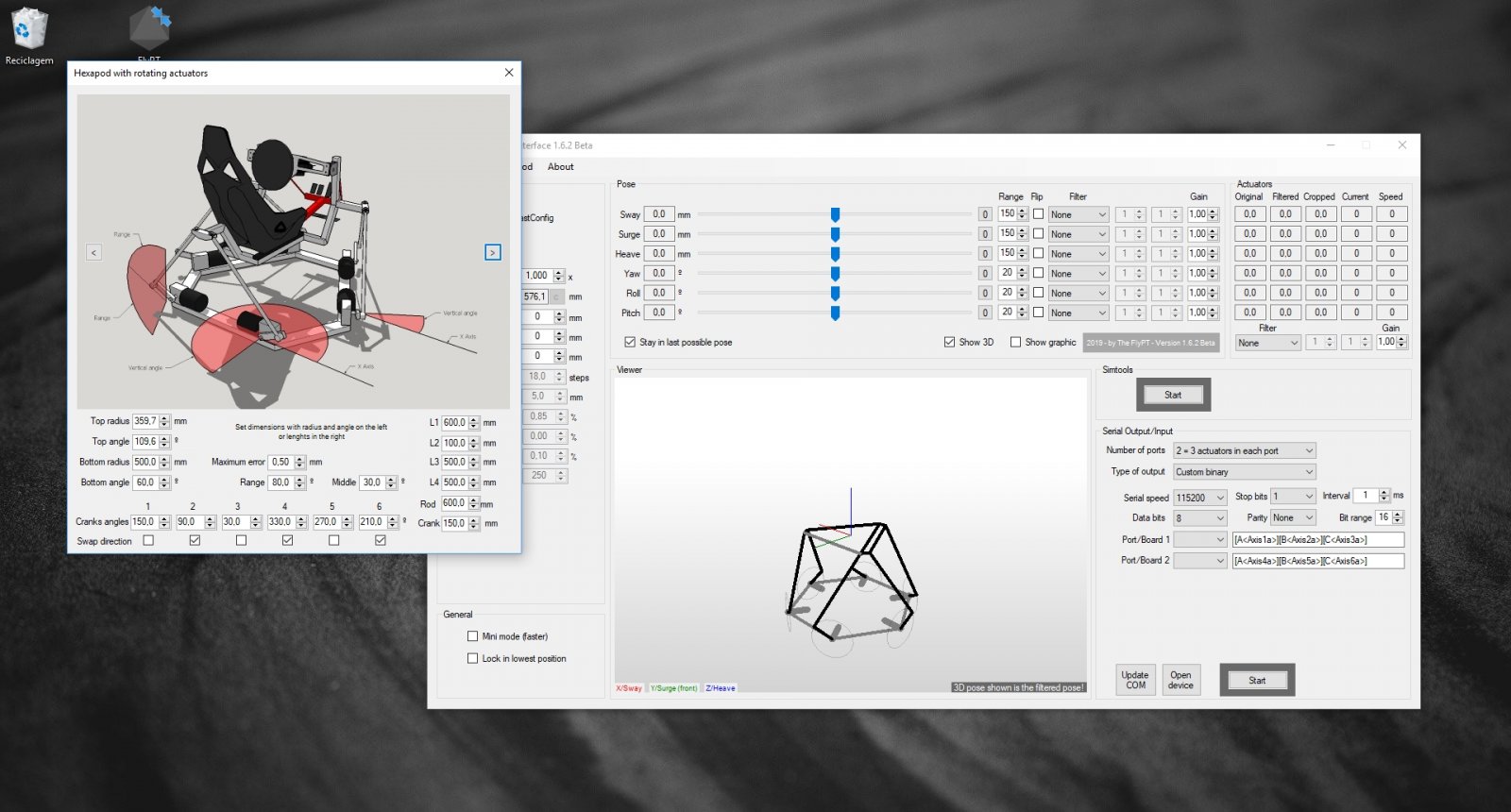

    Ne version 1.6.2 Beta
    -Solved the error with the axis of rotation pointing to the outside in rotating actuators (don't ask it was a really stupid error...)
    -New images for rotating actuators dimensions
    -Minor corrections
    NOT WORKING --> <255> is not replace by a byte with 255 value. To be corrected
    Waiting for testing feedback, specially with serial communication. ;)
    DOWNLOAD in the first post of this topic!

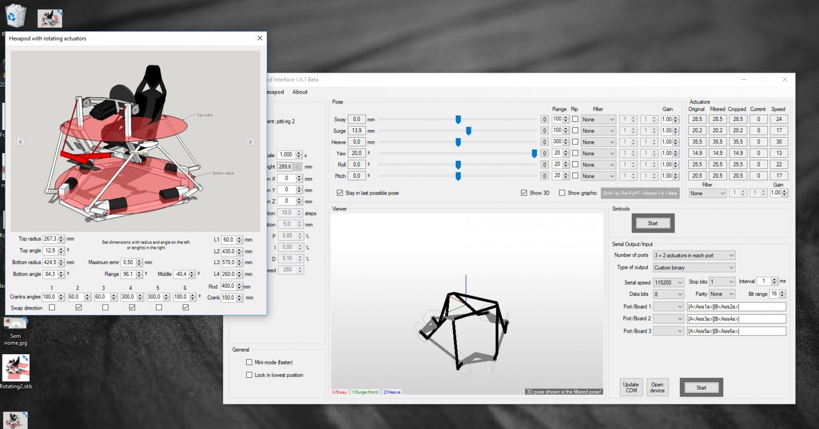

    Version 1.6.3
    Download in the first post of this topic: https://www.xsimulator.net/communit...face-for-linear-and-rotating-actuators.12859/
    -Corrected serial output, now we can send <#> values. It was not working correctly. AMC should now work.
    -We can now output speed on the serial by using <Speed1> to <Speed6>. It's a one byte value (0 to 255).
    -Send back position to the interface.
    New features will be explained on a guide update with sample code.
    Those new features can allow full control and adjustment of PID, only with the interface, but require code changes on the boards.

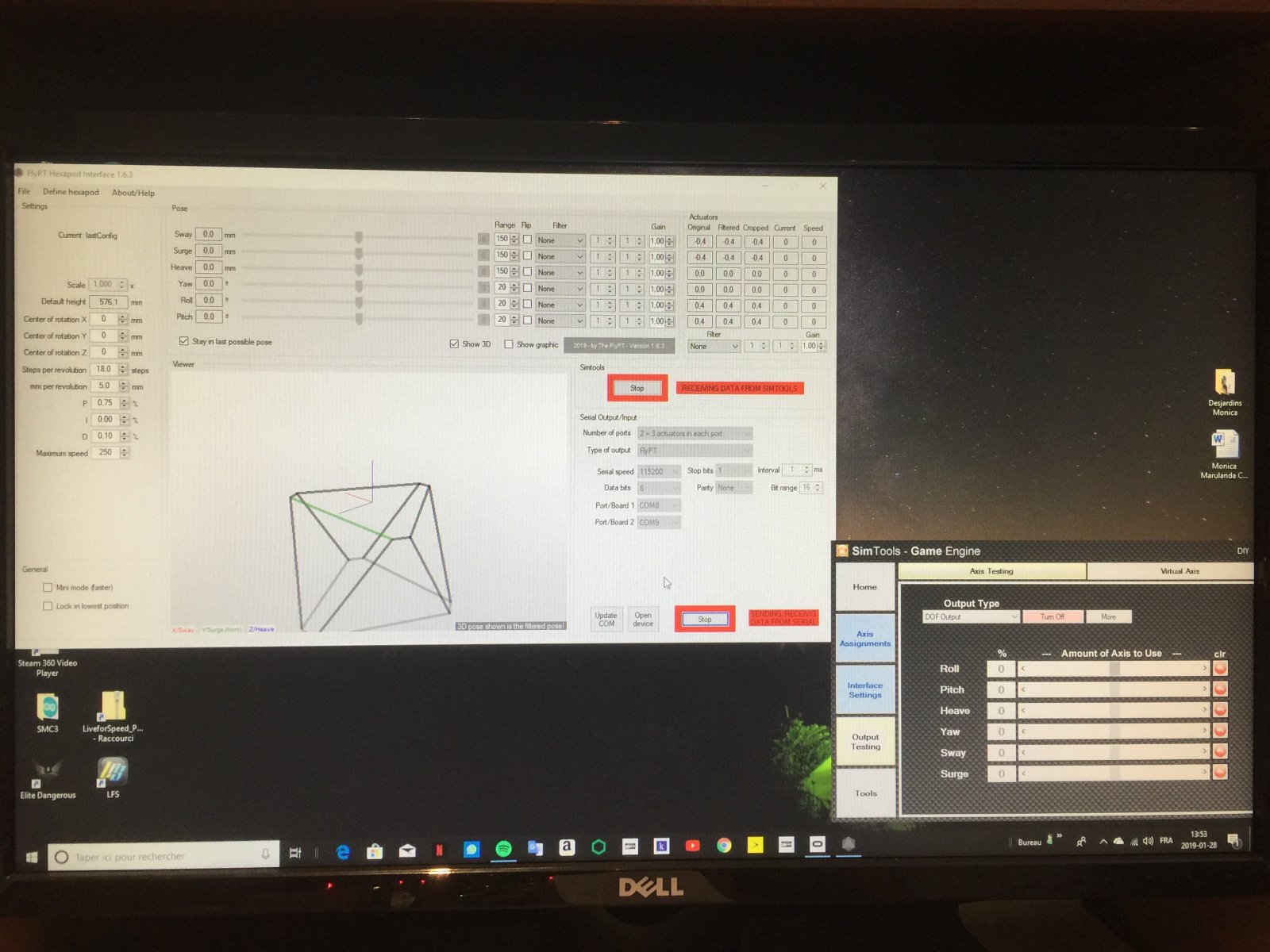

    I'm realy near but missing something ….
    the com/port are ok ! everything move with( simtool to Fly Pt) but not the Rig …!!!
    With SMC3 each arms work well !!
