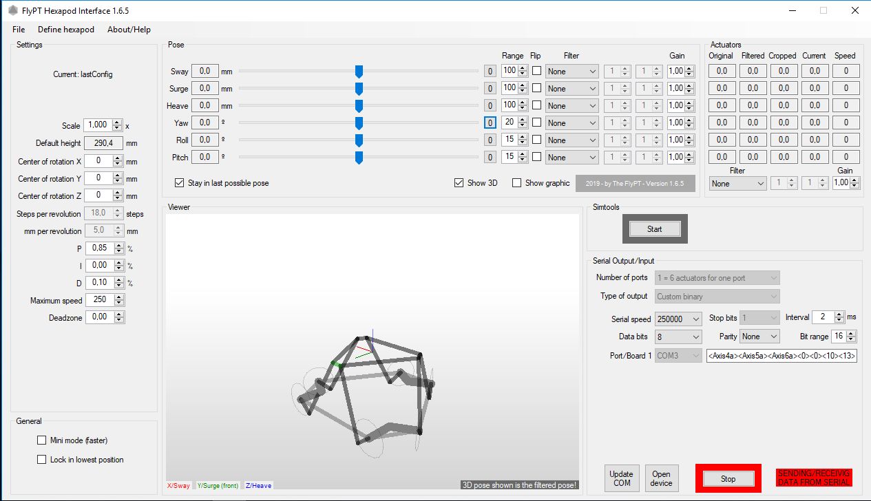

    @Thanos & @Gabor Pittner,
    I think I found the problem.
    When you put <0> or <255>, I convert this to a byte.
    Thanos board expects 16 bit (2 byte values) for the axis, so when the 7 and 8th axis are send, it receives only one byte for each axis on the last string I told you.
    So we are missing two bytes (the board expects 20).
    Try this:
    <255><255><Axis1a><Axis2a><Axis3a><Axis4a><Axis5a><Axis6a><0><0><0><0><10><13> <<<< Correct string but in wrong order, see first page of thread!
    It should now work.
    Sorry, because I didn't look as I should.
    For starting I didn't see Axis1b and Axis2b. I don't send those values right now, but I can start passing them directly from Simtools (maybe in next version).
    Then I forgot it has to be 16 bits values on the axis...

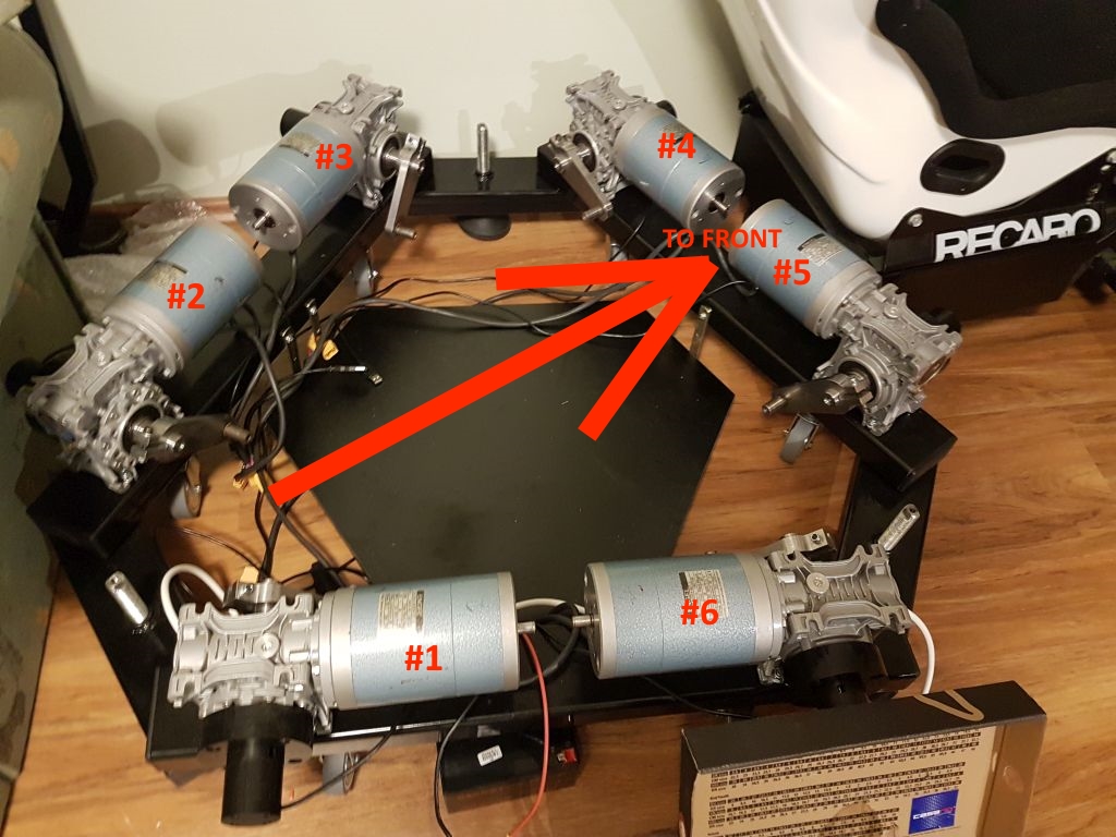

    Yes it works now, but wrong motors order :) The first actuator on the AMC board is the front left and the second is the front right. But I can not find the correct order yet :)
    Anyway it works fine but all motion are mixed :)
    I tried this
    <255><255><Axis6a><Axis1a><Axis2a><Axis3a><Axis4a><Axis5a><0><0><0><0><10><13>
    its almost good :)

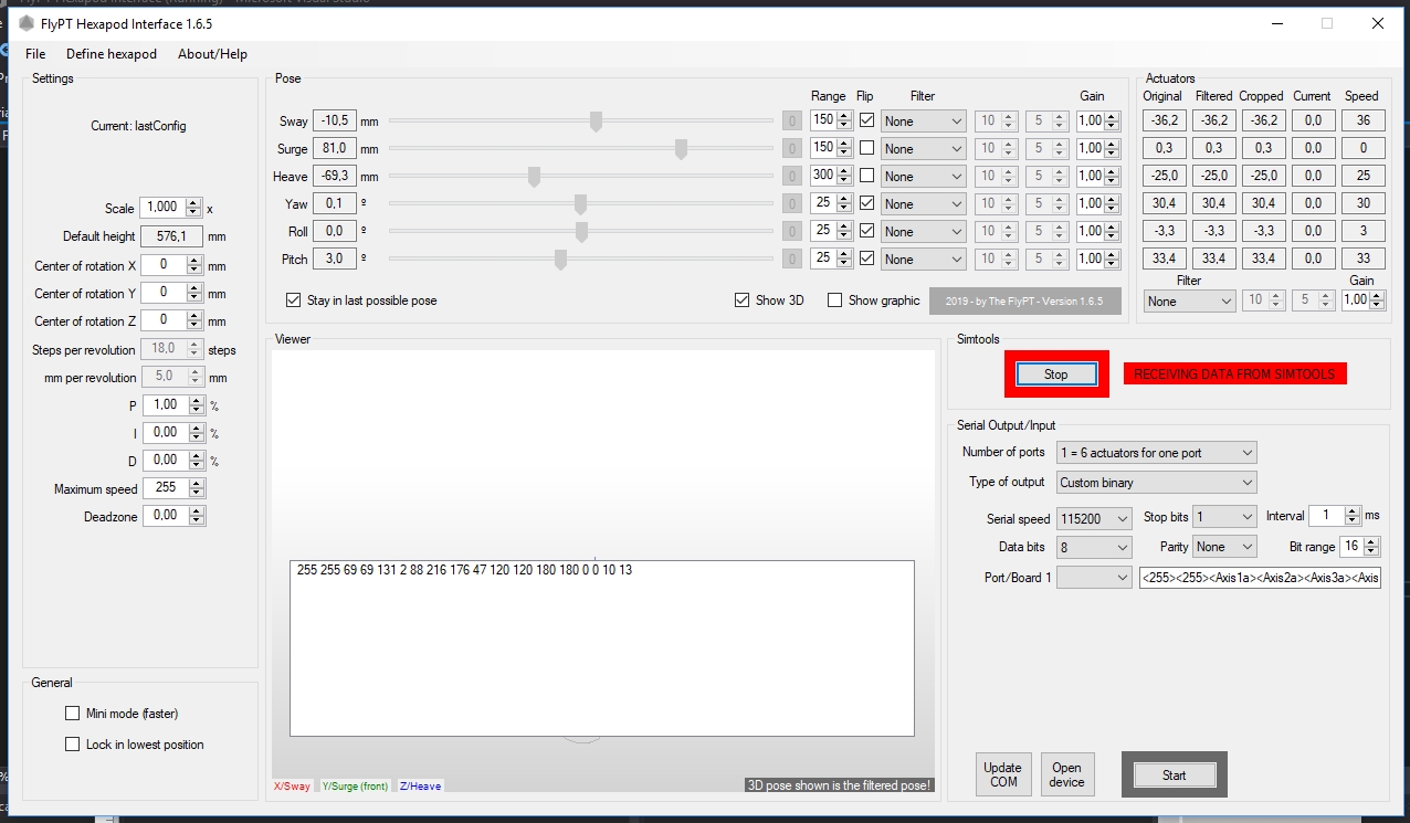

    I'm generating a byte array (in this case 20 bytes) and send it at once.
    I was sending this (look at debug textbox over 3d visualization):
    But as you can see the zero in axis1b and axis2b are just one byte.
    So it was missing an extra byte for each I had only 18 bytes in that image. With the new string it sends the 20.

    Good!
    I think you can change the order of the axis.
    The AMC board uses the first axis as number one, second as number two and so on.
    Just put your correct order.
    But you should not repeat axis! And you are sending 8 axis!
    Use:
    The 4 zeros at the end represent axis1b and axis2b. In this interface, I don't pass those axis and I think you don't need them for your rig.
    I don't know for what Thanos uses them. Maybe for vibration, that idea of mixing vibe and motion.

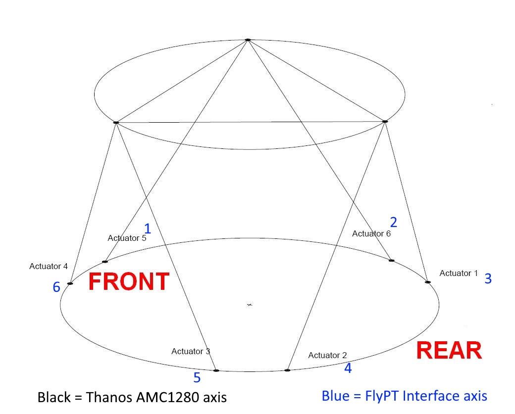

  9. Thanos
    Jul 6, 2017
    1,373
    Electronics Engineer
    United States
    2,871Coins
    +1,075 / 10 / -0

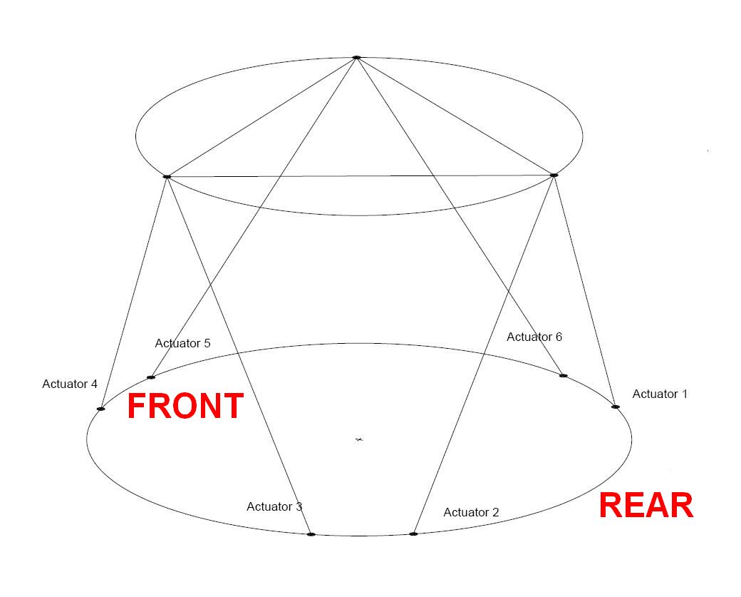

    The order is wrong because of the numbering is not same... I used Ian's numbering on Hexpod plugin to have one common order for all software so users don't have to rewire their hardware for each software... Here is the standard order of the actuators:
  10. pmvcda
    pmvcda aka FlyPT
    Nov 3, 2010
    2,228
    Portugal
    15,647Coins
    +2,664 / 17 / -0
    In this interface it's:
    So correct string should be:
    <255><255><Axis3a><Axis4a><Axis5a><Axis6a><Axis1a><Axis2a><0><0><0><0><10><13> <<<< CORRECT STRING!

  12. Gabor Pittner

    Im getting confused with axis order...
  13. pmvcda
    pmvcda aka FlyPT
    Nov 3, 2010
    2,228
    Portugal
    15,647Coins
    +2,664 / 17 / -0
    My error.
    When I made the rig, took a look at the forum and saw some rigs with that order, so decided to make everything based on that.
    It's not even described on the badly written manual on this thread.
    I will update the first posts with this info
    Try the last string I posted:

    It works this way
  16. pmvcda
    pmvcda aka FlyPT
    Nov 3, 2010
    2,228
    Portugal
    15,647Coins
    +2,664 / 17 / -0
    You still have the X and Y axis swapped.
    Sway is swapped with surge and roll with pitch.
    Witch one is your #1 actuator? The one connected to the AMC board?
    Should be like this (for your rig):

  19. Gabor Pittner
    Gabor Pittner Active Member
    Oct 25, 2018
    203
    Szekesfehervar Hungary
    1,395Coins
    +89 / 0 / -0
    My first actuator is front left and the second is front right. You marked them #4 #5
    And the others are clockwise. 3 4 and 5 6
    Should I rewire them on AMC board?
  20. pmvcda
    pmvcda aka FlyPT
    Nov 3, 2010
    2,228
    Portugal
    15,647Coins
    +2,664 / 17 / -0
    Maybe to be less confusing and since you are using the AMC, use that order, the one I posted in the picture.
    If you use that order, just use the last string I gave you for connection.
    If you want to keep that connection, I can see take a look a make you the string. Give me a minute...
