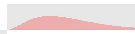

    I assume the input signal is a square wave right?
    If you use a LP/HP ratio of 12.5 (1000/80), chances are the onset curvature is too tight to be visible because of pixelation.

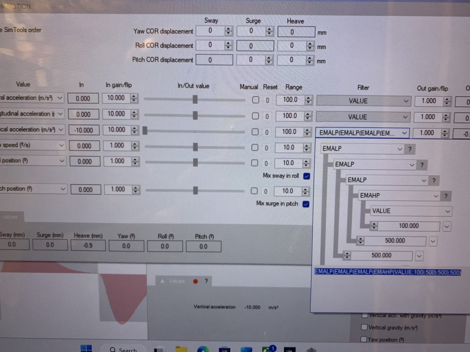

    Take the processinig framerate (500?), divide it by the number of LP filters (2?) and you get the initial filiter variables to start with. In your case I guess it's 500/2. So you start with 250...
    EMALP(EMALP(EMAHP(VALUE;250);250);250)
    This will give you a filtersystem with a step response that reaches its maximum deflection at exactly 1 second after the step.
    In the next step you pick a LP/HP ratio "R" to shape the relationship between the entry- and mid-curve section. 3-10 are typpical values (12.5 is a lot!). Multiply the two LP filter variable by √R (yes, both of them) and multiply the HP filter variable with the inverse of that factor (like 1/√R). Now the LP variables should be "R" times bigger than the HP variable.
    Then.....
    OMG, this is where it gets complicated....

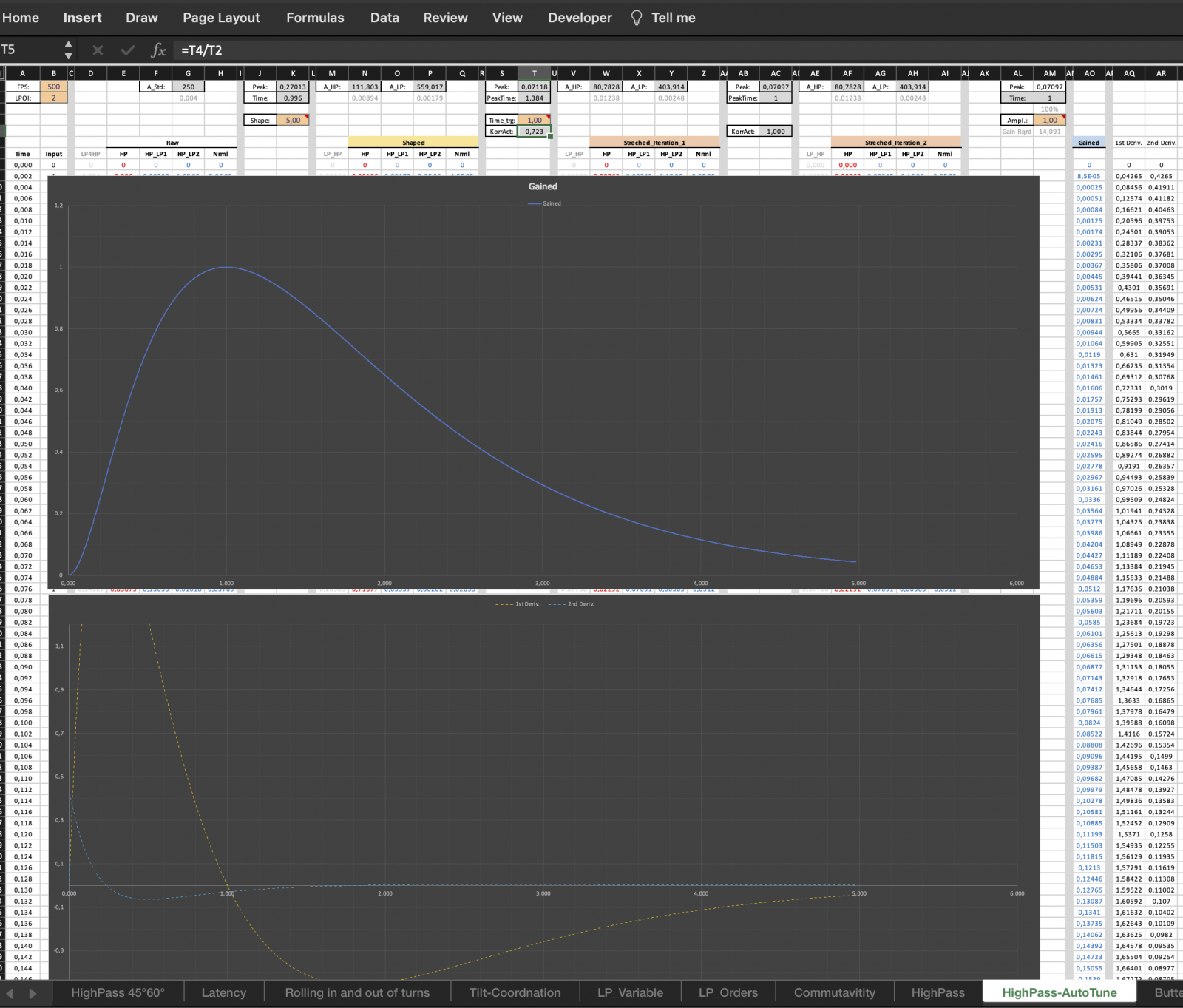

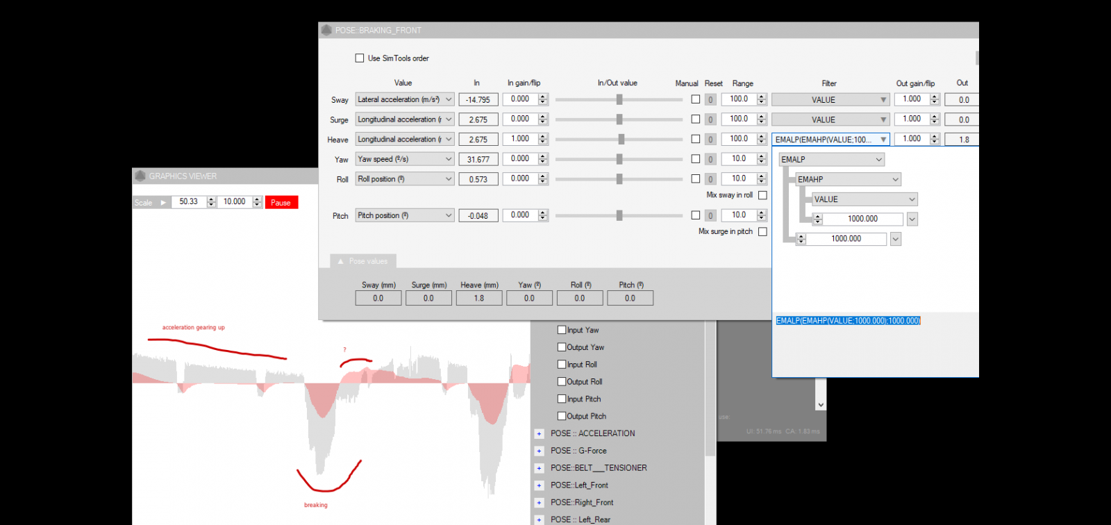

    Nevermind,... I am working on a little program that lets users define a custom response curve and it will give you values for HP/LP/Gain to get exactly this response. So people could change the shape, the amplitude and "time to peak deflection" independently from each other.
    It's gonna take a while to put together but I already have it modelled in Excel and I have been using it for about a year now:
    I hope I didn't overpromise here....
    Let me know if LP/HP @ 250/250 will give you a response that peaks after exactly 1 second!

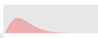

    You understood but the graph looks a bit strange.
    Edit:(…) Lower the HP filter more you squeeze the output. You don’t use any gain or something?

    Note plz:
    3x EMALPF 500 is a very big smoothing - maybe suitable for coordination channels (without HP in that case) otherwise such a big values might take out every detail from your signal. Anyway you have to experiment with the weighting factors of the filters as well as with in-gain in and out-gain values.

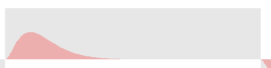

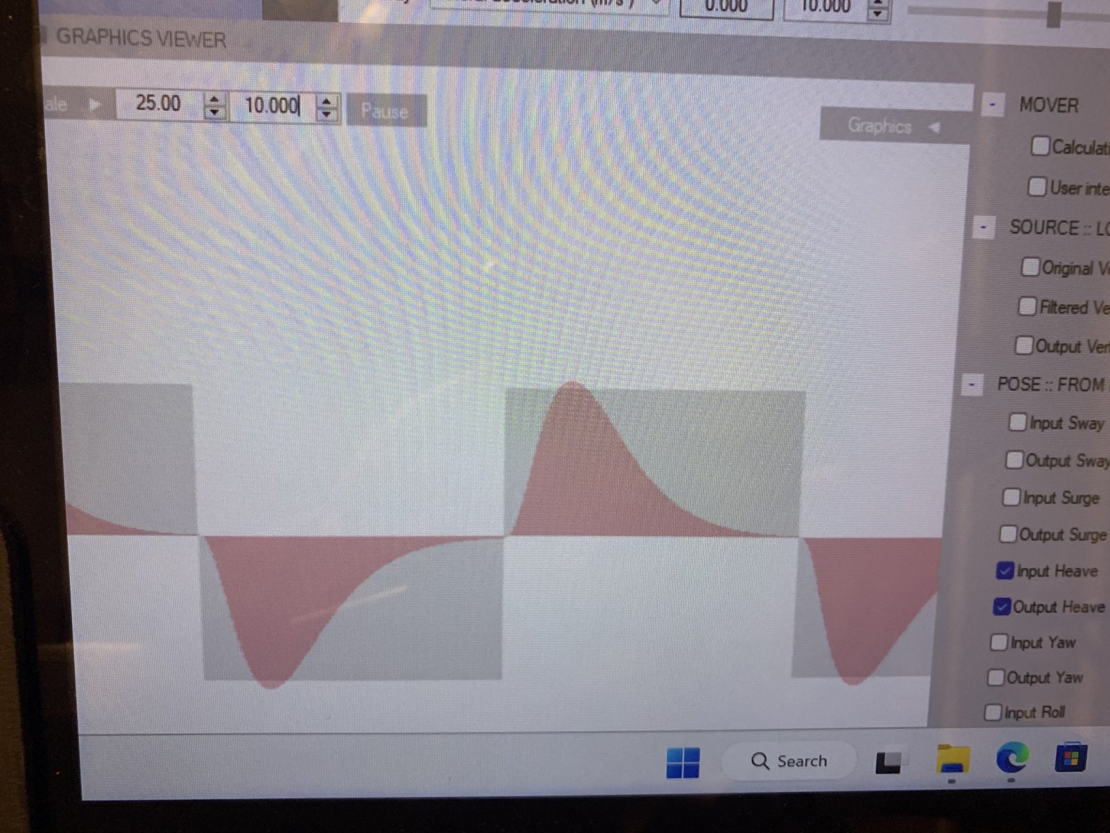

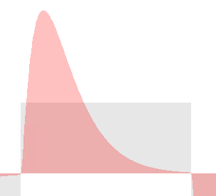

    Looking good:

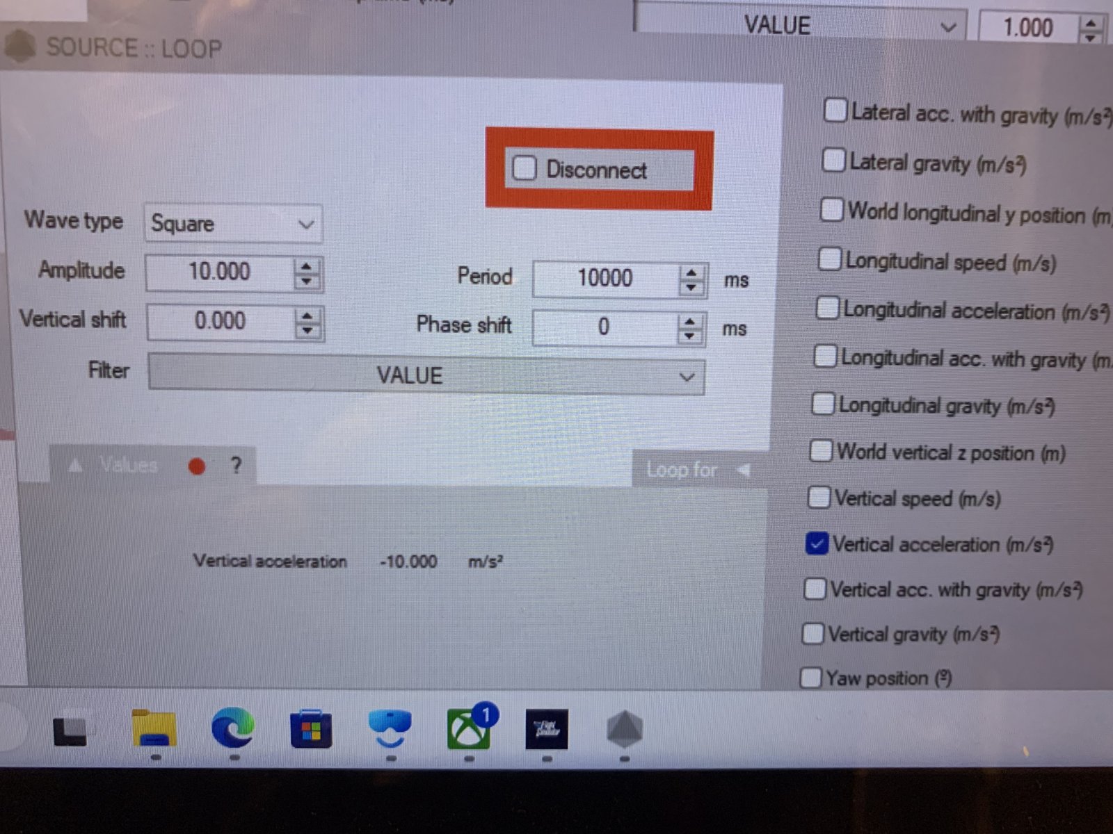

    The period time of the loop source is set to 10s, so the width of the large grey rectangle represents 5s, which means that the maximum is reached at 0.5s. The curvature at the beginning looks good, which can be seen better in this screenshot, where I have set the horizontal scale of the graphics viewer to 3:

    I noticed,.... and I am a bit baffled o_O It should take 1s, not 0.5s
    The math on it is pretty straigh forward:
    Every EMA based filter (single order!) will decay to a value of 0.36787 (1/e) after exactly X cycles, with X being the filter variable here!
    Or put differently: After N seconds it will decay to a value of (1/e)^N if the filter variable is set equal to the processing framerate.
    I will have to investigate further.....

    The ''speed of the filters is linked to the controller transmission defined in the Mover options (2 ms by default). I'm just saying that, but it may have nothing to do with your stupor ;-))

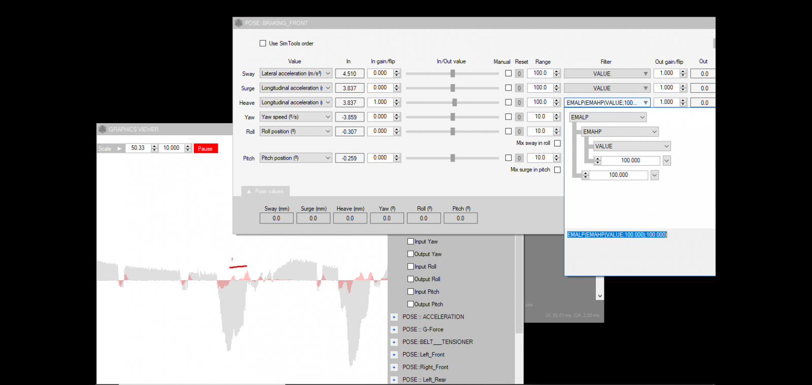

    Just same filter diagrams for discussion from real Rfactor2 telemetry data.The grew line represents longitudinal acceleration from game data, the red after filtering, high pass, low pass and combination.The upper part represents acceleration, value positive the lower deceleration ,value negative.
    In my view the lines should always be in the same orientation or in line, if not it represent a false cue, this happens with a HP especially when a deceleration decreases.

    When the cue with abrupt direction change add to the HPF it can get amplified. If this is what’s disturbs you, try to get the HPF return a bit slower. You can also try WASH function which behaves a bit differently
