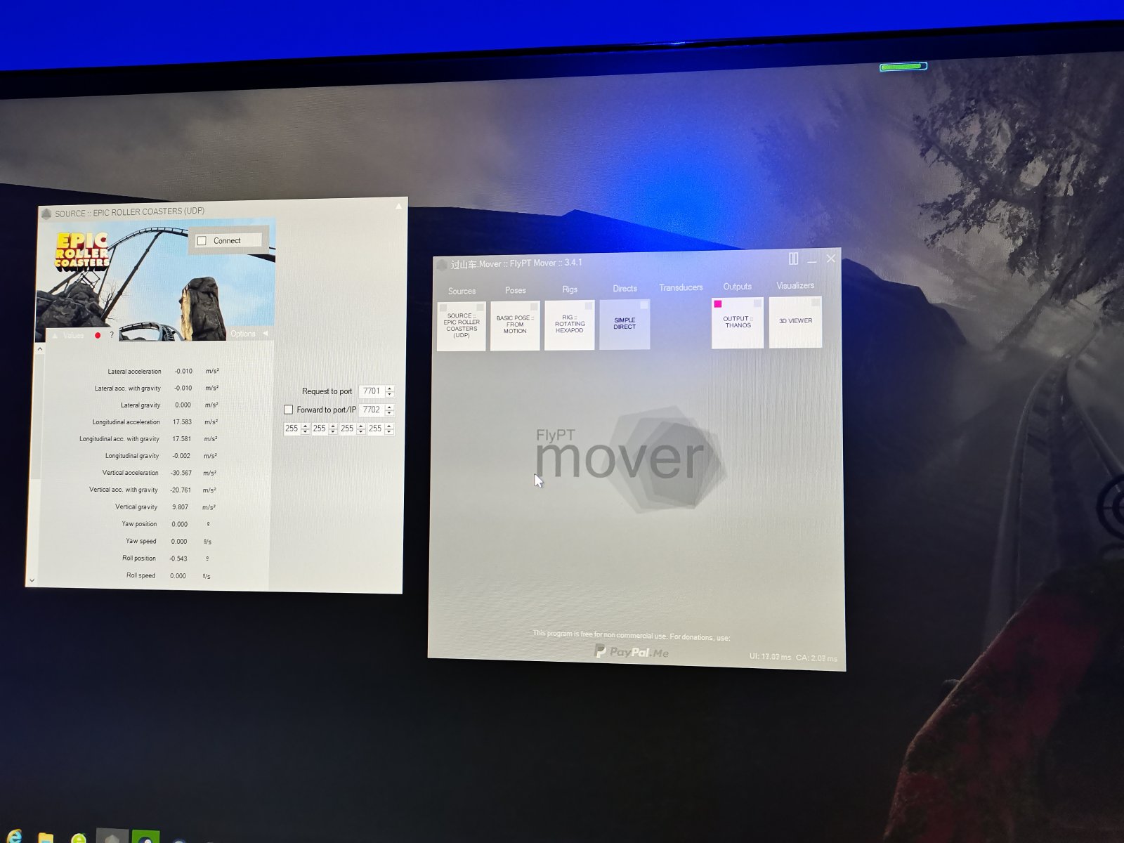

    AC motor, 6DOF
    FlyPT Mover3.4.2 / 3.4.1 / 3.4.0
    Why does the source stop automatically when the Epic roller coaster track is interrupted and dropped onto another track? There is no problem with continuous tracks.

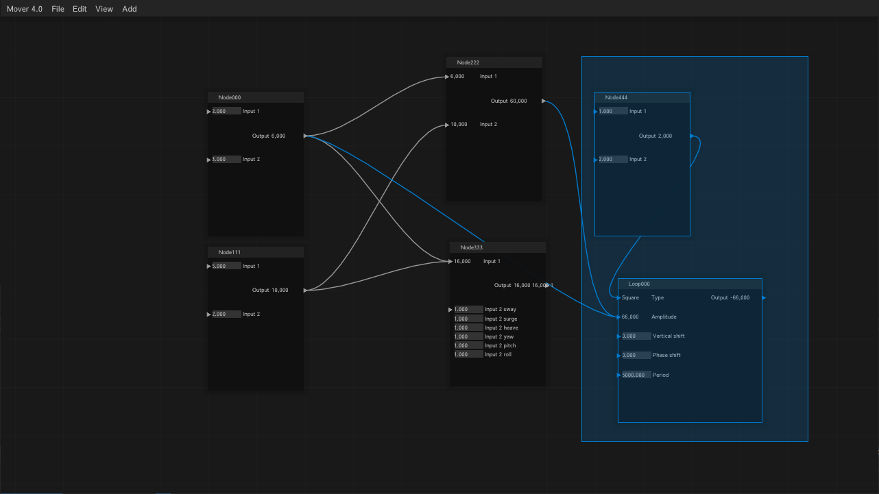

  12. pmvcda
    pmvcda aka FlyPT
    Nov 3, 2010
    2,238
    Portugal
    15,708Coins
    +2,675 / 17 / -0
    Not in current version.
    In Mover 4, I'm doing it in a way that makes it possible to be compiled for Linux and maybe OSX and Android.
    Working on it
    But it's completelly different from current Mover.
    That's an old image, no usable nodes in there. Just to get an idea.
