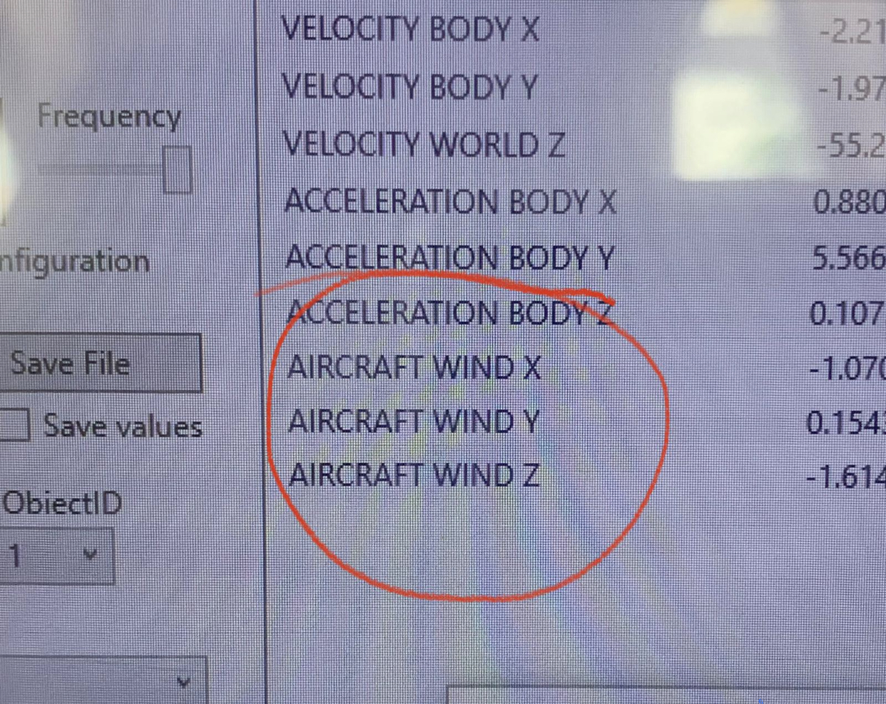

    Once in developper mode you download the sdk and you have real-time access to all variables through a dedicated tool 377DD156-B60B-43E0-8530-8780322262AA.jpeg
