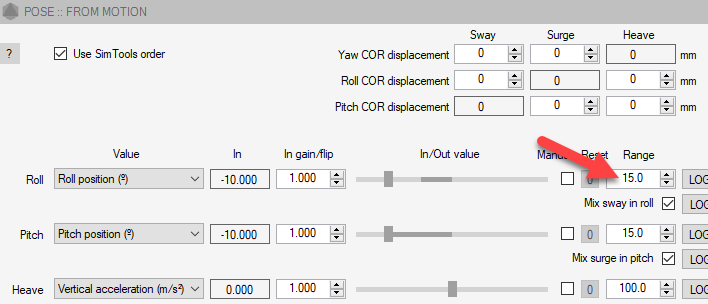

    If you can go -10 to +10º, range is 10º
    Heave and linear poses are mm.

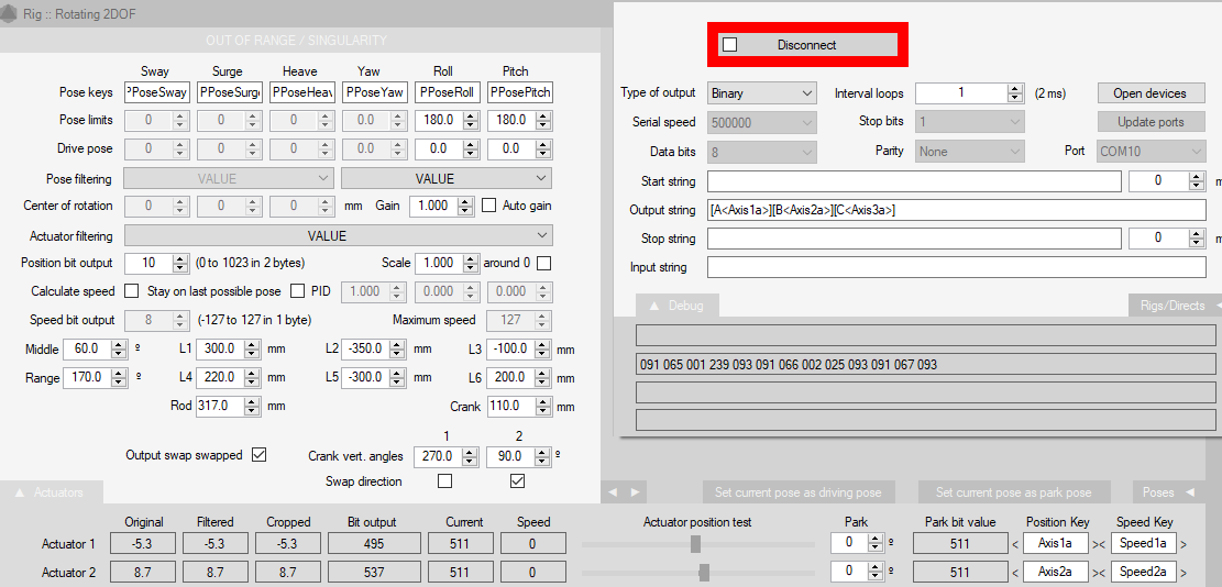

    I think SMC3 needs 10ms between data sent.
    You are using just 2ms.
    Change the interval loops to 5ms.
    See here: https://www.flyptmover.com/outputs/smc3-and-sps

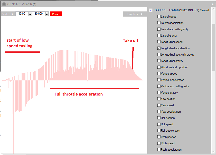

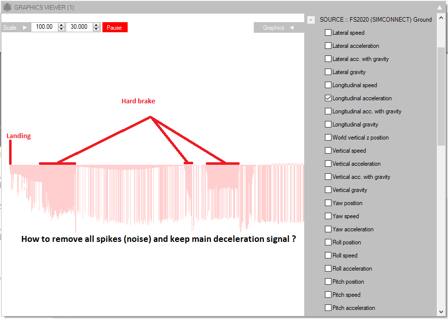

  6. Olivier beaujoin
    Olivier beaujoin New Member
    Aug 22, 2019
    21
    France - Roquefort-les-Pins (06330)
    187Coins
    AC motor, 6DOF
    I would like to simulate acceleration and braking on the ground in FS2020 (mix with pitch).
    My first idea was to use longitudinal acceleration, but this signal contains a lot of parasitic noise on FS2020 so it does not work properly.
    I have tried to filter those noises with EMALP but did not worked well. I'm thinking of a filter that would do an average of last x values but did not found such filter.
    Is there a way to write a filter that removes noises but keep the main signal?
    Below are the accelaration signals that I got during take off and landing.
    Any suggestion is welcome.
    Thanks, Olivier

    Sorry, missed your post.
    You can use the MALP, it's the median average.
    I call it LP for low pass since it works similar to that.
    But that noise is extreme, did you change the Cor?

    Thanks, i also needed to remove the third non-existing actuator from the string. When I did it started working. Now that electronics and motors are working I need to build the actual frame.

    Hello @pmvcda, thanks a lot for your reply that help me a lot to understand the issue.
    In fact the main issue is linked to 'Flight Recorder' addon that I used to record/replay my flight.
    This tool is causing noises on longitudinal acceleration when I replay my flights.
    If I do fly in live in MSFS2020 there is no noises.
    So unfortunatly I could not use that very good free addon to benchmark FlyPt mover profile (I use a lot with P3D record/replay native functionnality to adjust my P3D profile).
    I do not have such noise on replay with the other input I used,
    I will have to wait the native FS2020 record/replay functionality that should come soon.
    Note: MALP did not help a lot in that case probably too much noise to filter this.
    Thanks again, Olivier
