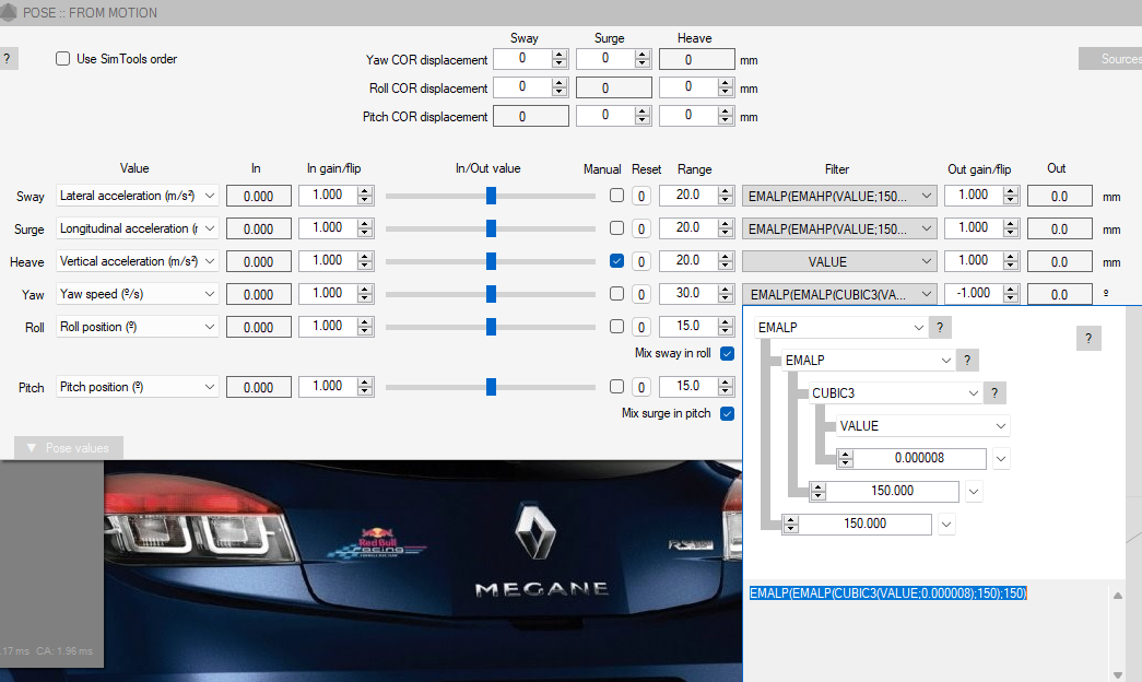

    Hi @pmvcda just a quick question regarding traction loss , i have made a working mock up of what im hoping will be a affordable traction loss module , to be made using eaisly obtained DIY material ( Other than the AASD15 Servo system setup )it will be constructed of 18mm MDF plates and 50 x 100mm Timber Beams for mounting the various ( 4 off Support plates) ,
    Ok so i have got this demo build up and running in mover But am using Yaw speed (deg/sec) as Value , is this the correct pose value to be used or Traction loss ..
    Reason i ask is that during my initial testing the movement was very aggressive ( make that whiplash inducing pain ) and seemed that i needed to tone down the Input data to achieve smooth sweeping Traction loss motion ..
    i'll be the 1st to admit even after reading im still not comfortable with my understanding of filters but do know that they can make all the difference to how a sim performs and smooth out agressive data .. so my question is which filter would you recommend and which value will best give me Truer traction loss ..
    My mock up platform has central pivot point at front and the TR actuator range is +/- 75mm can go up to 90 mm once im happy with how the setup performs ..
    i know your Busy so more a case of when you get a chnace or i can thorw this out to other members who mihght be taking the same journey to traction loss , all feedback greatly appreciated ... as always once things are verified and the operation confirmed as Good , then i'll release my CAD models and Drawings for all to use if they think it will help their Project :)

    I've been using the example in @pmvcda 's video on setting up DiRT Rally 2 with pretty good success.
    It uses a CUBIC3(VALUE;0.000008) wrapped in a couple of LP Filters to smooth it.
    It's in the online store under YawVR if you want to take a look in the Pose from Motion.
    Hope this helps.

    Actually, I'm at my PC again now, so here it is:
    Using "Yaw speed" on the Yaw DOF
    The Values for it is:
    EMALP(EMALP(CUBIC3(VALUE;0.000008);150);150)
    And the link to CUBIC3 is:
    https://www.flyptmover.com/basics/filters/operation-filters/cubic3

    @chandy21 ,
    Did not have much time to work in TL yet.
    But, some considerations, or what I think right now:
    Traction loss in a real car, can induce some yaw and also sway.
    You can have the rear end slip and make that yaw, or have the 4 wheels slide laterally generating some sway.
    Or even the 4 slidding, with the rear wheels slide more than the front ones and have both effects.
    On my examples, since I have a 6DOF rig, sway is already present, so my traction loss, or when i speak of it is mostlly related to yaw.
    That is not the case for a 3DOF rig with an extra actuator for yaw.
    What we want is to get some yaw to represent the traction loss, and that is both sway and yaw from the car.
    So right now, we can do it with 2 poses. The normal one where we use the real car yaw on the rig yaw. And here I think we should go with speed. But I will talk about some solutions for this later.

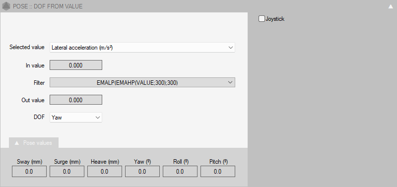

    And to add the car sway in yaw also, we can add a DOF from value pose:
    So I'm using the lateral acceleration to generate some yaw.
    If we add this to the other pose, we get some yaw from lateral acceleration and also from yaw speed.
    Ignore the filter I used. MAybe an EMALP would be ebough here. I did not test the values.

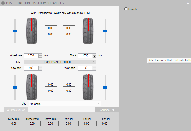

    I will try to add a module for traction loss, that uses the relation of longitudinal and lateral speeds/accelerations. Not sure it will work well. But using that gives us a different result for sure.
    Meanwhile, getting yaw on the rig from the car yaw, can be done in many ways.
    Using the CUBIC3 that gives us a dead zone, or a more complex filter i have in the new black box pose.
    Maybe you could try that one, disabling the other dofs in the check boxes.
    The idea of that pose is to make it easier by hidding the filters and trying to use a simpler "wording".
    Not sure that is the current module availlable in the public build... But it's similar.
    Also started a pose to get info from the tires slip. But most games don't have enough info for that.
    We would need slip angle and amount of slip. That one is availlable in Mover, but i don't encourage the use of it. I don't like it currentlly.
  8. pmvcda

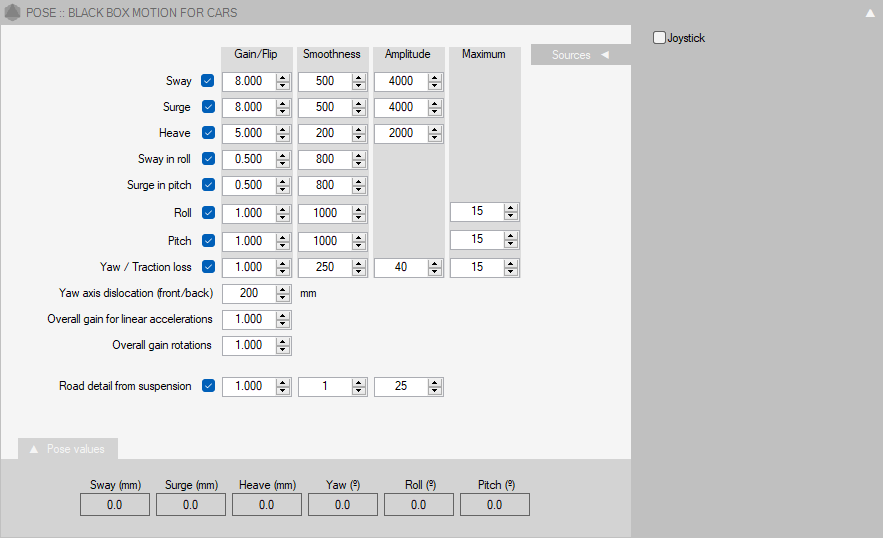

    Please try the black box. But the default values are not good.
    Meanwhile I will get the new module done.

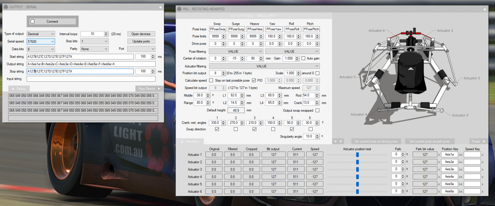

    Hi pmvcda,
    I wanted to let you know of something I found while prototyping, to me it seems like an error and I've since updated my code to handle the error, but would like your input.
    I had mover set up to output 8bit decimal data which I was reading into the serial port of Ardiuno, during the ramp-up and shut-down of serial output, Mover was outputting floating point values with 10 digits after the decimal point (for each servo position).
    My code was expecting integers so it was seeing erroneous data, so I piped the output into a second passive serial port and echoed the values, which lead me to the problem.
    I read through the documentation regarding outputs types, but according to my config I think mover should have only output 8bit ints the way I had it configured.

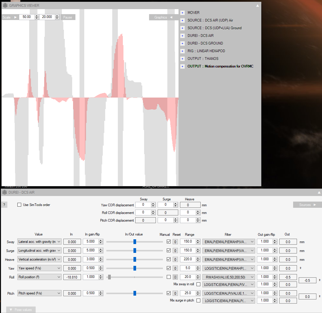

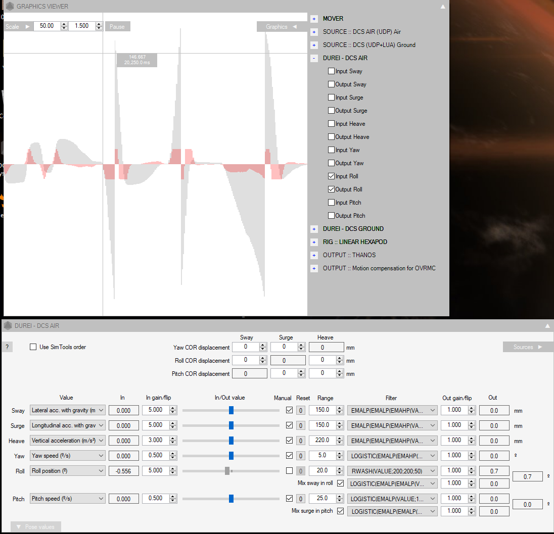

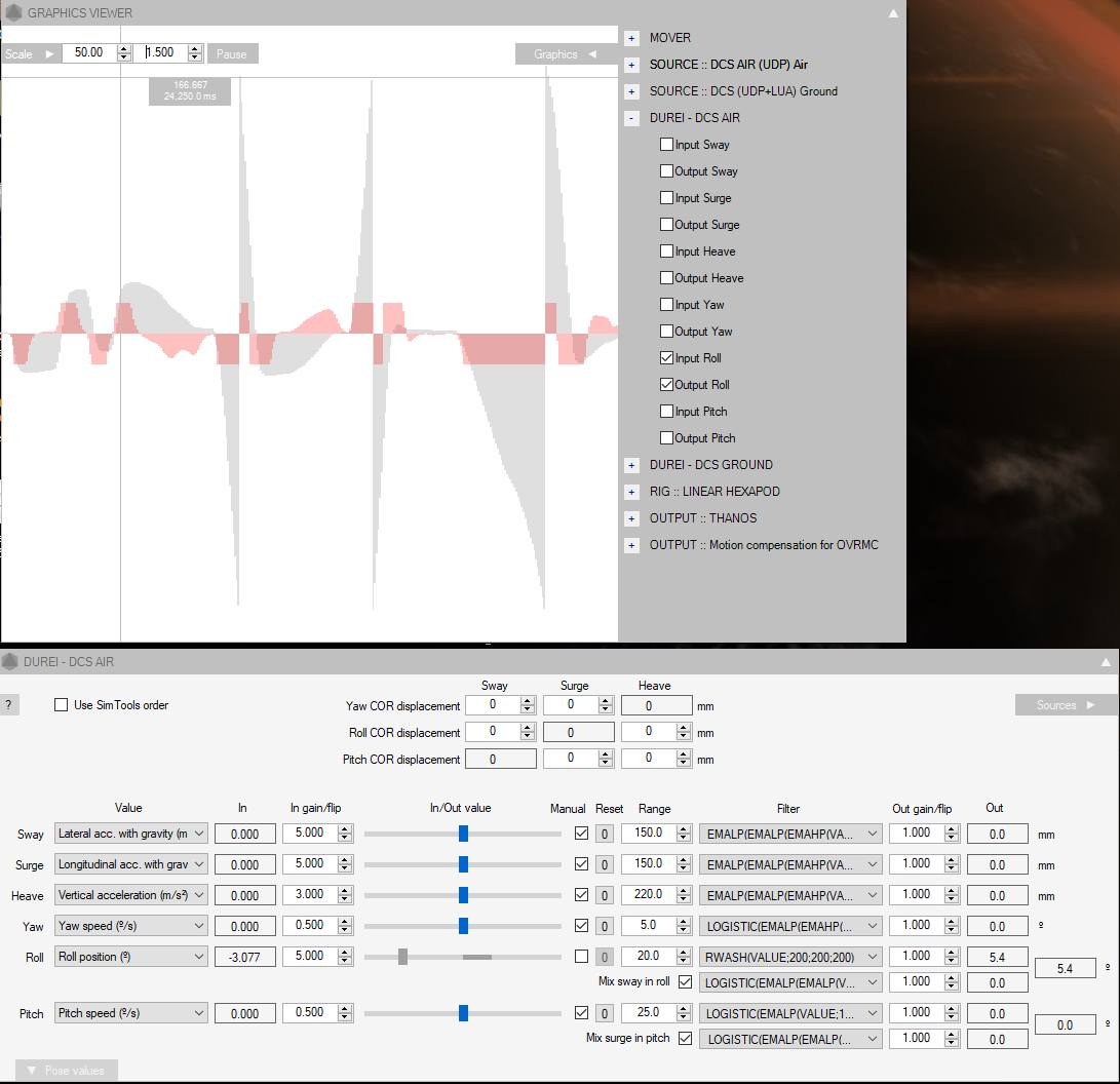

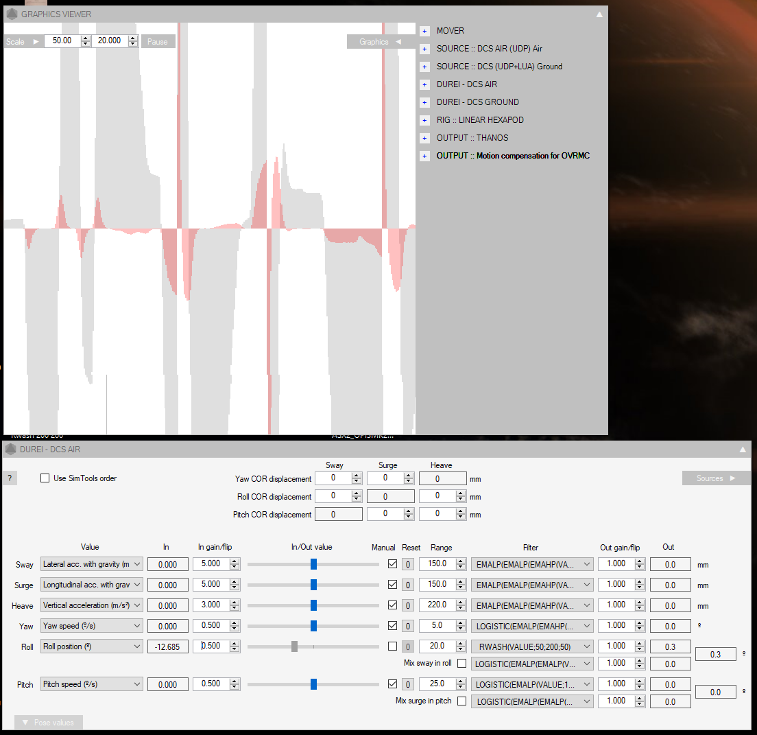

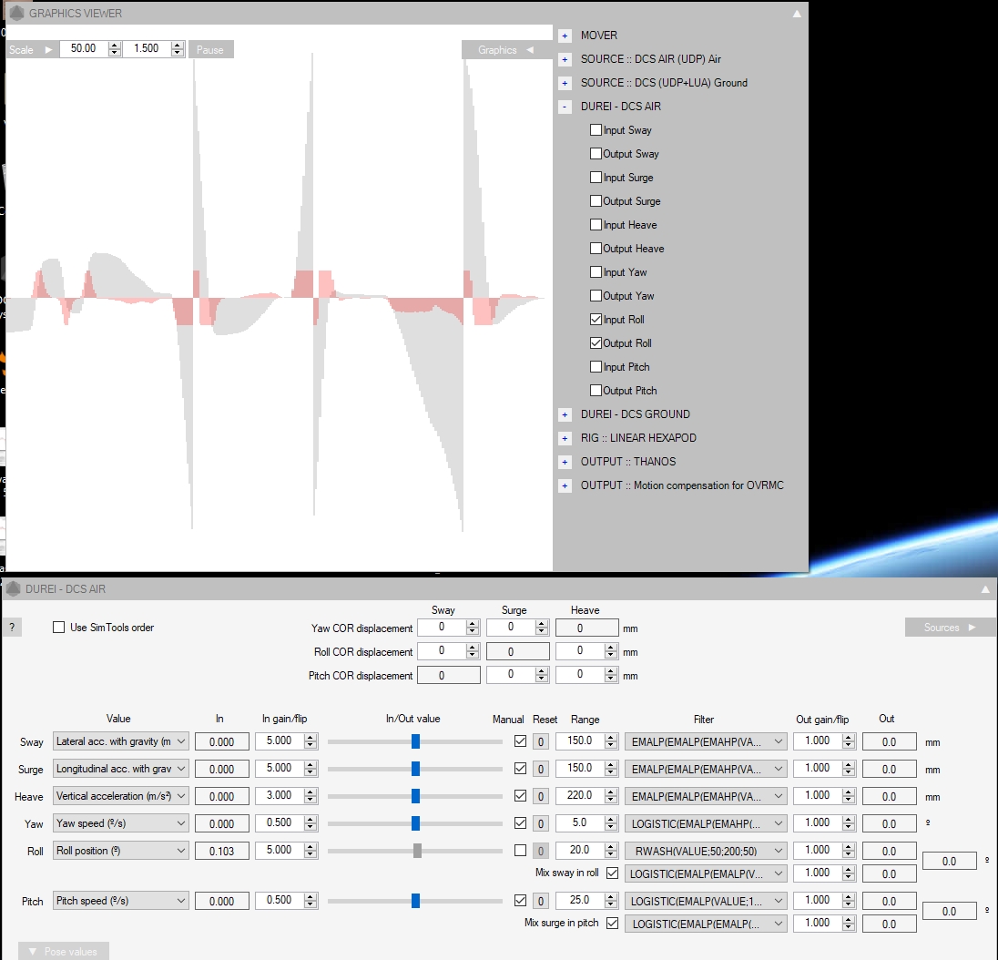

    Hi guys
    sorry to disturb you again with that, I am trying once again to make Rwash work under DCS, without sucess lol.
    As you can see on the different pictures under, 2 little roll and 3 full roll, you can see that even If I change Rwash values, the output is going 180° with position, and I understood it should'nt do that.
    If someone could help me ?
    thanks

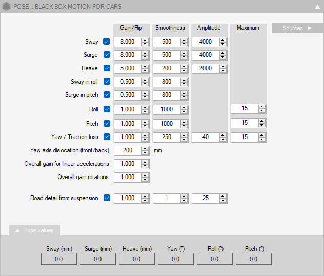

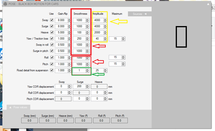

    Hi @pmvcda , another silly but perplexing quiery from me :-( been playing with the Black box option and trying understand what impact each section has on motion , when you hiver over the parameters you wish to update the Help info seems to indicate most most of the msoothness coloum as distance in mm where i thought things like Pitch and roll yaw were generally Angular dims . once again i may have missed this info describing the function of each of the sections in the black box module , if so can someone provide a link to the post if this has already been dealt with please.
    my main confusion is around the smoothness and amplitude coloums and what they equate to ref motion:) also i noticed that when i select 4dof rig & TL to enter my actual sim dimensions the L1 and L2 values seem to be swapped when i view them in the 3d Viewer simulation i.e L1 seems to be the width of actuators left to right and L2 is Distance Front to rear ? Cheers Guys

    Hi, thank's for the feedback.
    I just corrected the L1 / L2 swap. Did not notice that one.
    Yes, that's still WIP. The tooltips are there because of copy paste. Sorry.
    There's going to be some changes in the next build:
    The smoothnes is to smooth each effect.
    The amplitude gives you more movement.
  19. pmvcda
    pmvcda aka FlyPT
    Nov 3, 2010
    2,233
    Portugal
    15,678Coins
    +2,665 / 17 / -0
    Just tested it.
    Can't find any problem.
    I see that you are mixing sway in roll and surge in pitch.
    The graphic shows the result with those included. So what you think is caused by the RWASH might be the mix of sway and surge.
    Please check it.
  20. dureiken
    dureiken Active Member
    Sep 28, 2016
    251
    1,248Coins
    +170 / 2 / -0
    Hi, it does'nt seem to come from mix but from scale , I tried with scale 1 in entry and scale 0,5
