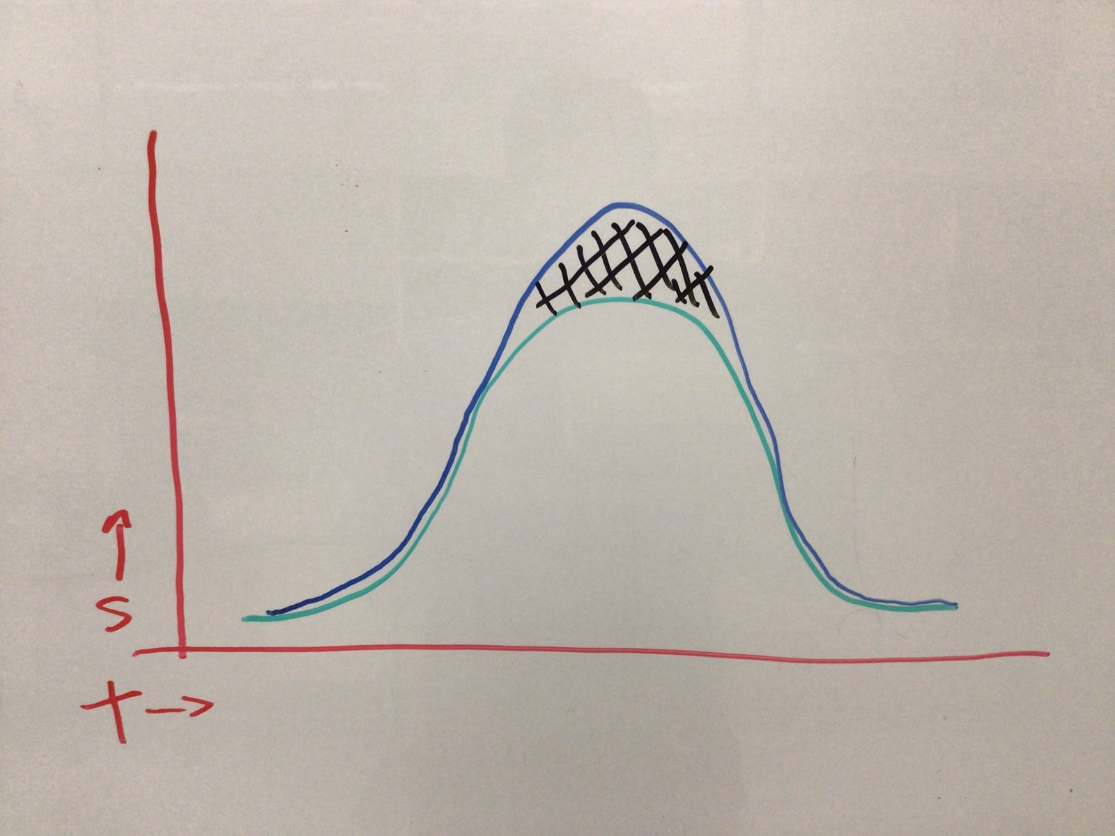

    Hi everybody ,
    Witch filter I can find for this graphic below ?
    The line or curve I want is the green one and my Sim do the blue one .
    How to erase the black region ?
    Thanks !

    DC motor, 6DOF
    Ok I find something … min or maxcrop.
