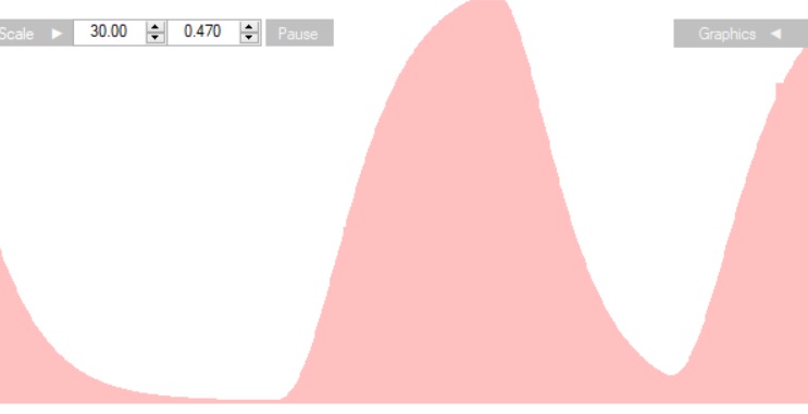

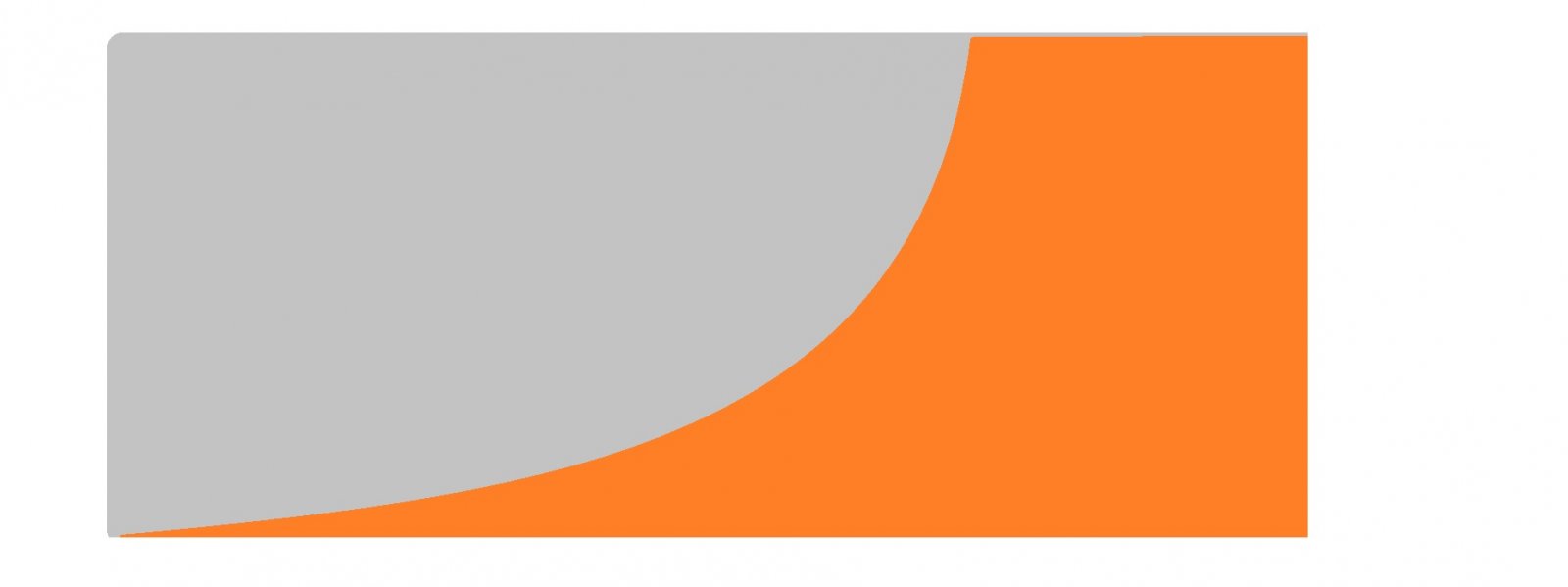

    Hello everybody,
    could someone advise how to obtain an acceleration curve? I mean if the input is a vertical ramp or infinite acceleration, how can I transform this input into an exponential acceleration output? Maybe the attached picture is a bit more clear, the gray there is the input and the orange is what I would to obtain? All the filters permit obtaining a good deceleration curve but not acceleration.
    Thank you a lot
  16. hexpod
    hexpod http://heXpod.xyz
    Apr 18, 2016
    1,218
    berlin
    7,840Coins
    +376 / 5 / -0
    DC motor, 6DOF
    Just put 3 EMA LPF in cascade. This ordering will give you a progressive entry curve.
  17. Marco Annunziata
    Dec 2, 2019
    130
    919Coins
    +19 / 0 / -0
    Thank you for the prompt answer but nope, I can't get the right acceleration curve, that's the best exponential curve I can have with the 3 EMALP filters which are far from the curve I would need. There is an easier way to have the exponential curve? Senza titolo.jpg
  18. hexpod
    Apr 18, 2016
    1,218
    berlin
    7,840Coins
    +376 / 5 / -0
    DC motor, 6DOF
    Did you tried to increase the values of 3rd order ema from standard 100 to something like 300 or 500 to see what happens ?
  19. pmvcda
    pmvcda aka FlyPT
    Nov 3, 2010
    2,238
    Portugal
    15,708Coins
    +2,674 / 17 / -0
    Working on it right now.
    I don't want to say a date, because I'm finding to many bugs.
    Not sure what you want, but simple exponential would be MUL(VALUE;VALUE)
    Edit:
    You also have the cubic where you can do a exponential.
    But not sure that is what you want
  20. Marco Annunziata
    Dec 2, 2019
    130
    919Coins
    +19 / 0 / -0
    My need is to achieve an acceleration of the actuators in order to reach at least 1G. Since my actuators are quite fast ( more than 1m per second) and the stroke is quite long too ( more than 800mm) I would need to apply the standard gravity formula (m*s-²). Actually doesn't need that the acceleration would be so precise just need to approach this diagram with a couple of parameters like the slope of the constant acceleration.
    Otherwise, I will get a burst instead of an acceleration
