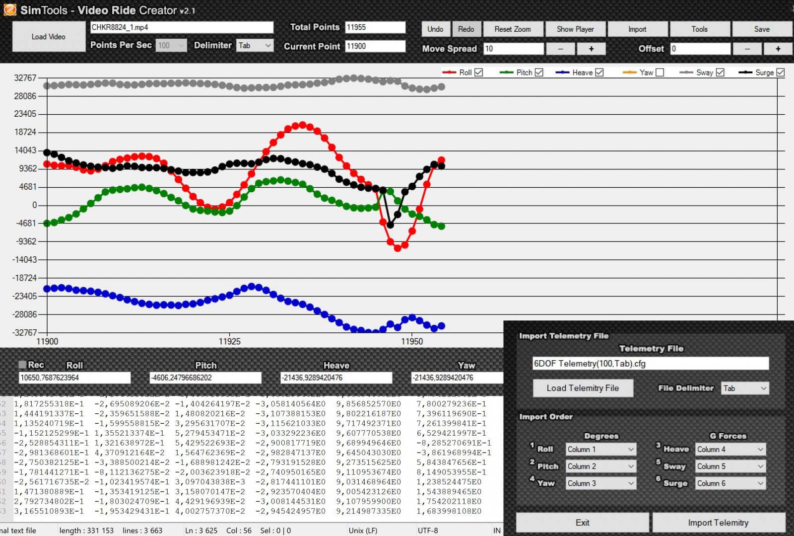

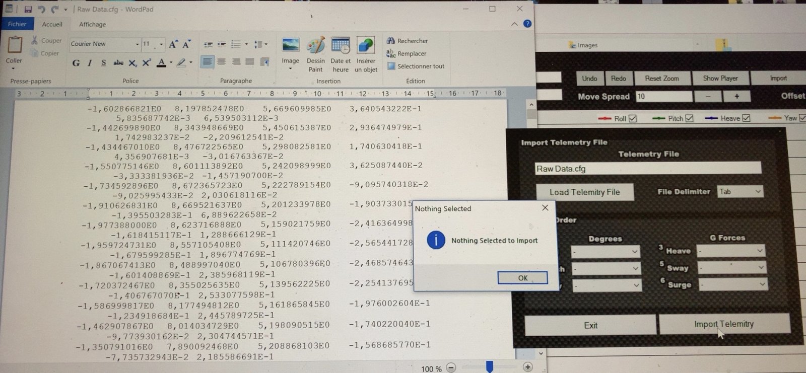

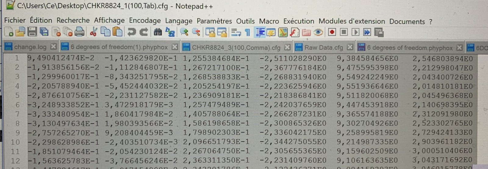

    @yobuddy ,
    It says that import of raw gyro accel telemetry from phyphox file in video ride creator was successful but I can’t see anything.
    It seems we have an issue with conversion to 16bit values or something.
    This is how phyphox looks like:
    Edit:
    It seems the renamed .csv file from phyphox has to include a parenthesis:
    file_name(100, Tab).cfg

    because the values are very tinny.
    Click 'Tools' please and post a pic.

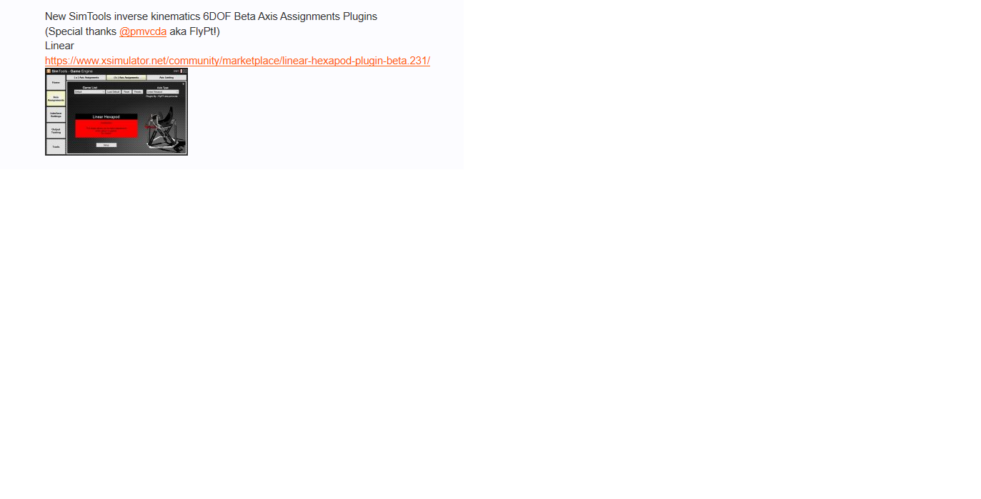

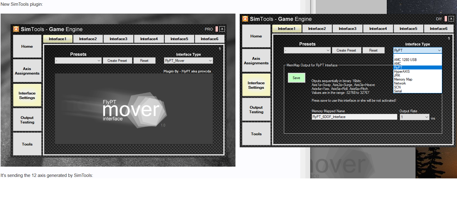

    DC motor, 6DOF
    No, you need to install a new plugin.
    Different and more data in new plugin (12 axis)[/QUOTE]
    @pmvcda
    where I can find a new plugin ? I' m a lite bit lost , Sorry !!
    Now I have a new version of simtool 2.4
    with this plugin ...
    Source simtools don't want connect .. missing FlyPt Mover

    You need a specific plugin for Mover
    It's the dll included in the download.
    FlyPT_Mover_InterfacePlugin.dll

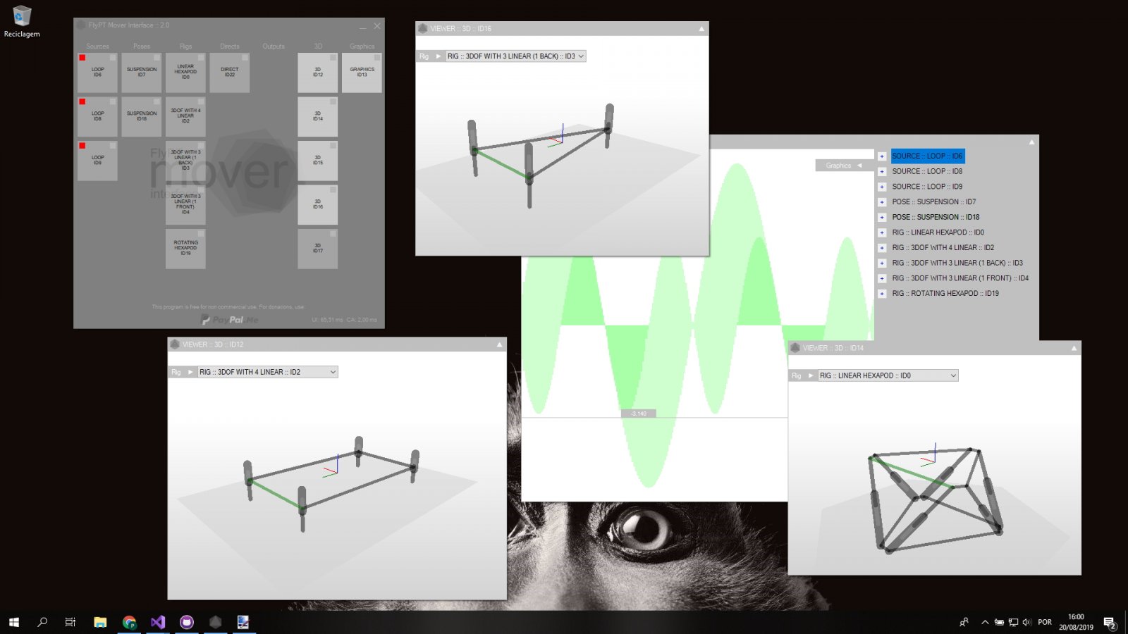

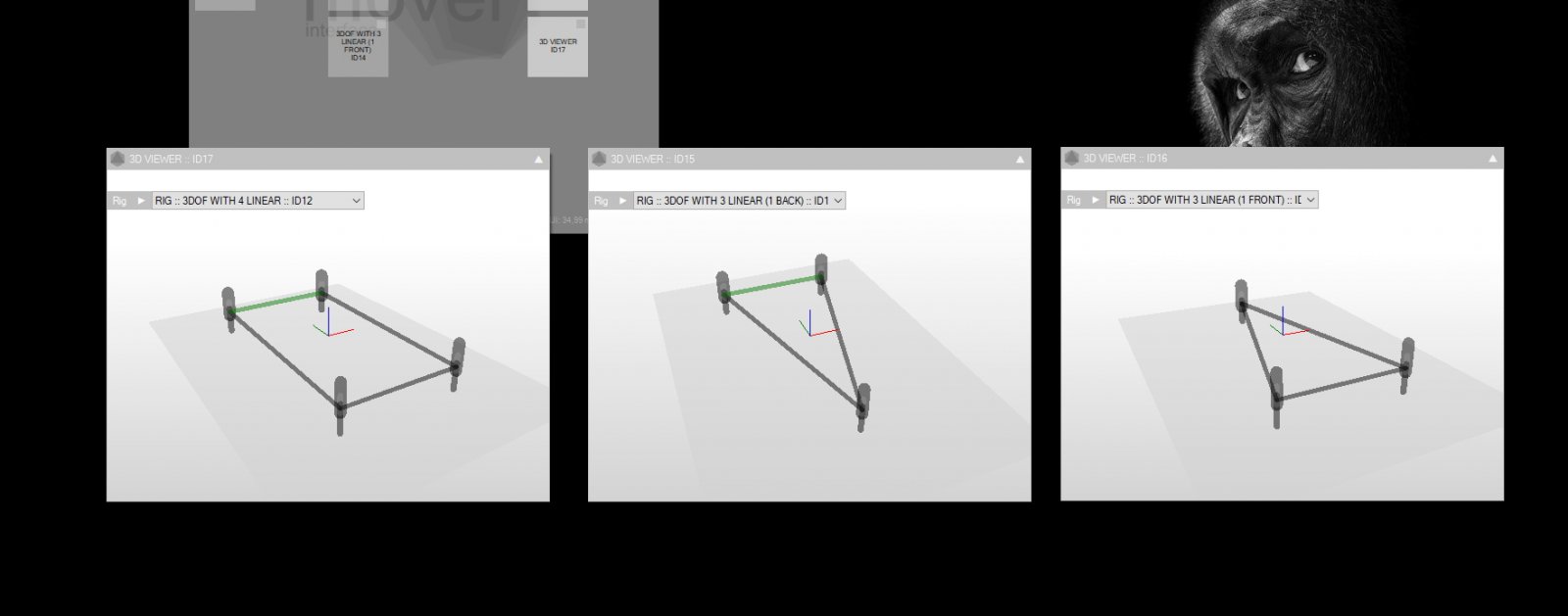

    Hi everyone,
    Sorry for being away... but work is progressing. Not as fast as I wanted.
    Some new features coming with the next version.
    Updated graphics and 3d models, new rigs, new sources and advanced filters.
    Some big internal changes on actuators, to allow user defined rigs in the future.
    Code seems to run fast with calculation and updates under 2 ms. Seems good for now, at least on the PC's I tested.
    Trying to reach the end. Really curious to get feedback on the updates.

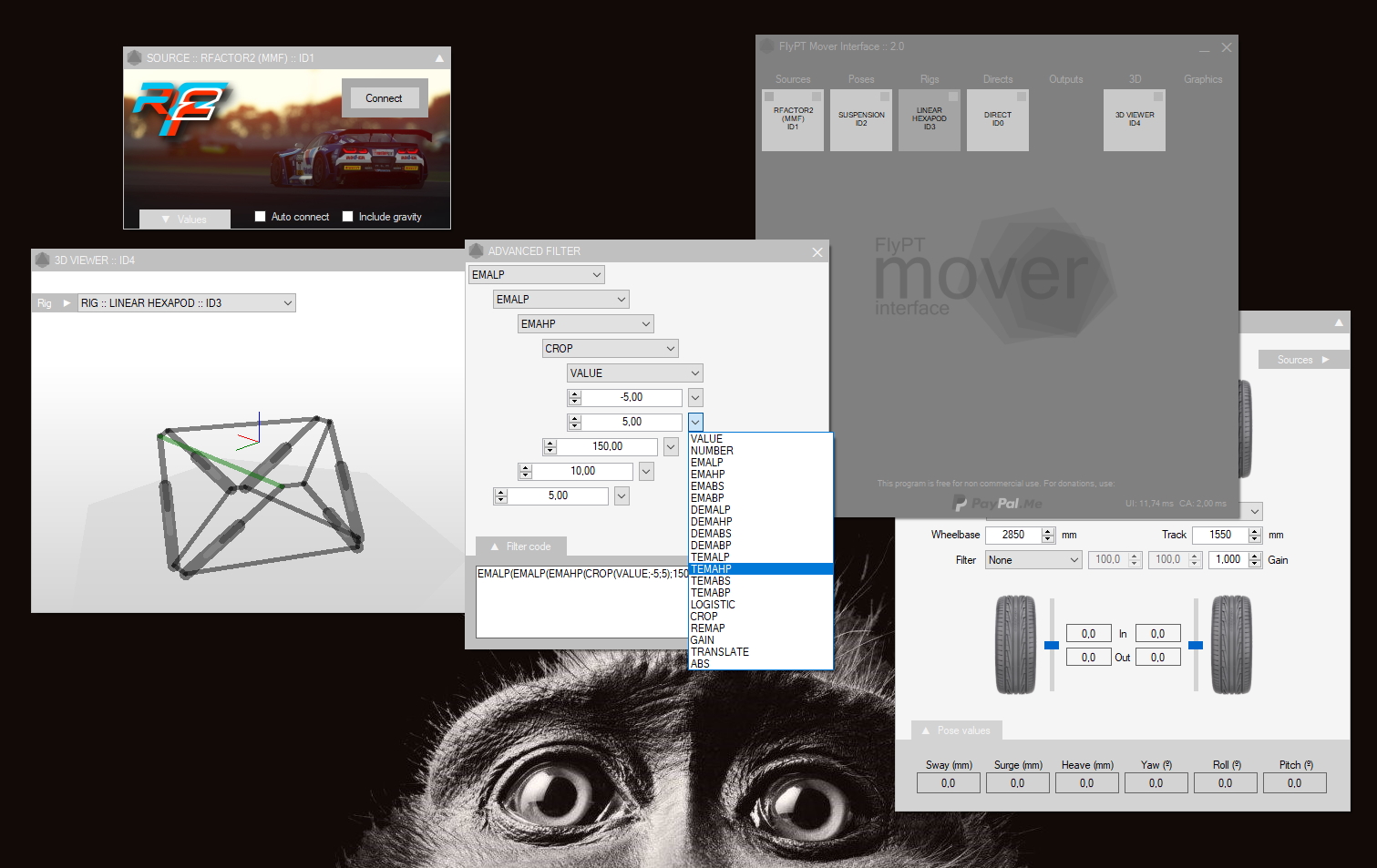

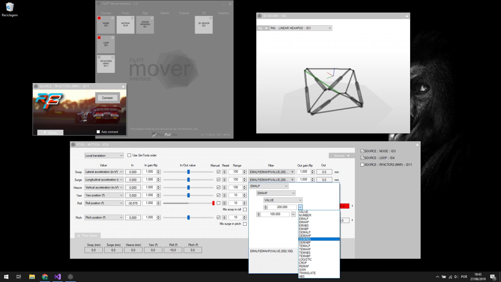

    New advanced filtering system:
    Now we can compose the filter with multiple operations and specific values.
    This allows users to crop/limit values received like @Trip Rodriguez requested.
    And also play with a multitude of filtering solutions.
    Filter can be generated in the combo boxes visually or by writing the code in the text box.
    Here's a quick reference of the filtering system (might change till release):

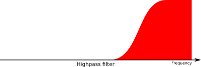

    EMALP
    Exponential moving average low pass filter.
    Parameter 1 is the value we want to filter.
    Parameter 2 is the number of samples used in the filter.

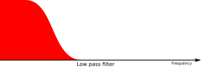

    Use this to smooth a signal by removing high frequency variations.
    Only low frequencies pass (look at figure bellow).
    The number of samples define where we have the cutoff.
    Cutoff is not a vertical line, only in ideal filters this happens. Reality is a progressive change like the curve shown in the figure.

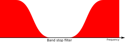

    EMAHP
    Exponential moving average high pass filter.
    The high pass filter is the value we want to filter less the low pass filter for the specified samples.
    So the number of samples specified, define the low pass filter used.
    Here, only high frequencie values pass.
    Low frequencie changes/smooth changes are removed, depending on the selected number of samples (see image bellow).
    The formula for this filter is:
    EMAHP = VALUE - EMALP(VALUE)

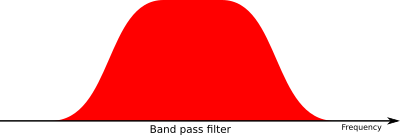

    EMABP
    Exponential moving average band pass filter.
    Parameter 2 is the number of samples used to define the start of the band (filter #1).
    Parameter 3 is the number of samples used to define the end of the band (filter #2).
    This filter, only allows frequencies between filter #1 and filter #2.
    So we remove low and high frequencies.
    EMABP = VALUE - EMABS(VALUE)

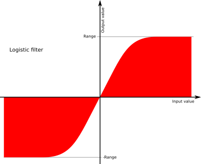

    LOGISTIC
    Logistic is a case of the sigmoid filter.
    Here we use a faster simplification.
    Parameter 2 is the range (minimum/maximum value allowed).
    Parameter 3 defines the S shape. High value makes is a more vertical slope while low values make it more horizontal.
    Use this filter to fit values to a specific range
    Reaching and surpassing the maximum range, values are "compressed" to fit the specified range.
    The S slope defines how fast and how much we compress the values.

    Working on the pose calculation...
    So many little things causing bugs!
    Seems to be good now:
    2ms calculation loops (lower right corner of main gray window)
    Showcasing the new filter control.
    And a small source change. No more gravity option. It's now on the list of values available. So we can choose acceleration with or without gravity included.
    It's getting closer to the new release.
    Big internal changes and reorganisation because of threads.
    Almost there!

    And some new rigs:

    Sorry for interfering but for the costistency and user’s understanding I wouldn’t make a parallel between:
    DEMA and second order EMA and
    TEMA and third order EMA
    as those are totally different things in my opinion.
    2*EMA is not the same as EMA of EMA
