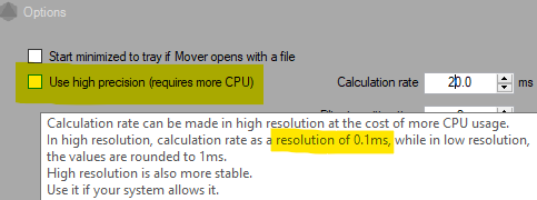

    You have to experiment with this. I use 2ms. Not sure you can get all fast frequency details if you use 20ms.
  2. J-1775
    J-1775 Aviator
    Jan 28, 2014
    179
    1,588Coins
    +51 / 0 / -0
    I agree, by the numbers you can't produce any frequency higher than 50Hz with 20ms interval loop. Or is 25Hz the theoretical limit?
    I actually use the RPM module, but more for low rev 'rumble' than high frequencies (for which I have a buttkicker).
    But apart from high frequencies, does a 2ms cycle like 'smooth' the movements of a platform compared to 10 or 20ms?
    Oh, another question: What's your recommendation/experience with the high res checkbox?

    Yes, sample based filters depend on calculation rate.
    You save resources by increasing the interval, but you have to adapt the filters and you get a noisier/low resolution result
